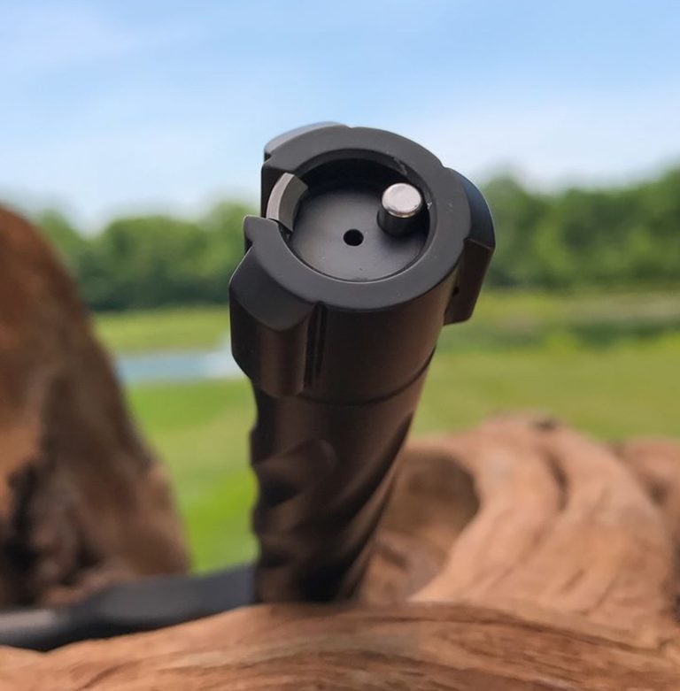

    I've got a Vector and it tosses the brass very consistantly. It shouldn't matter how fast you cycle the bolt. Check for debris under the extractor claw, if you are running brass with damaged rim, and make sure the ejector plunger moves cleanly without any drag.

    So follow Minnesotamulishas advice to clean out the recess. Should be a cross pin that keeps it retained. Drive that pin out but be careful when you remove the punch so that the ejector and spring don’t go firing out. Clean it of any brass shavings or dirt. Blast from an air compressor is good, again, just make sure you have already taken the spring out so that it doesn’t go flying out to be lost forever. When you reinstall it make sure that it can compress all the way flush again.
    Yes, it’s spring loaded. It will eject with the same force every time. Obviously how soon that force is cleared of the ejection port will change how much of that forced is put into the case vs dragging it slow letting some of the energy go into the action wall.

    Ejector moves in and out, doesn’t feel like it is binding up. Lot brass coloring on boltface. I’ll try cleaning out, wish the action came with instructions to tear bolt down clean and reassemble.
    I have this action. It isn't what I would call a strong ejection nor weak, but it is consistant. As advised above, clean ejector and check extractor to be sure a chunk hasn't broke off sending brass at a bad angle.
