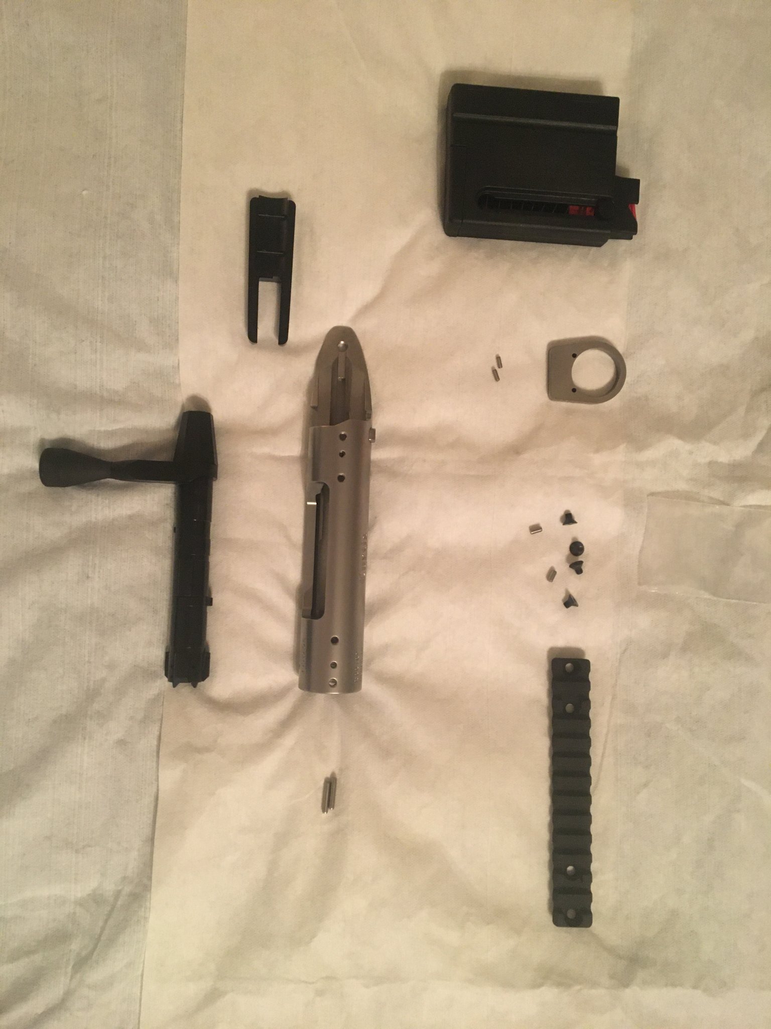

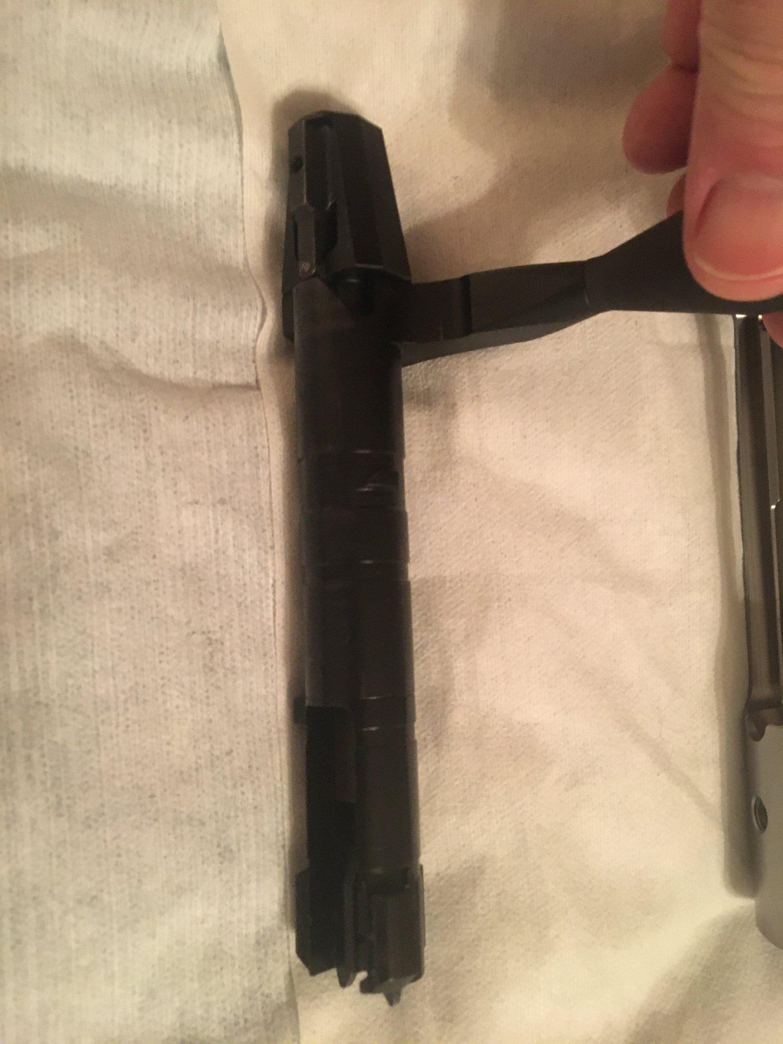

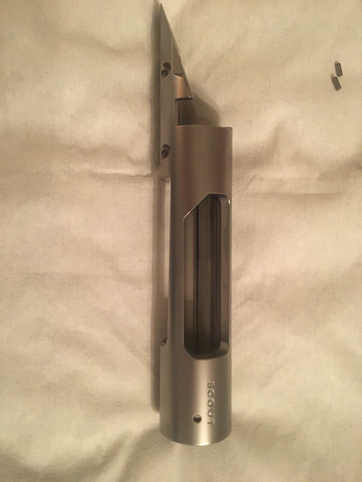

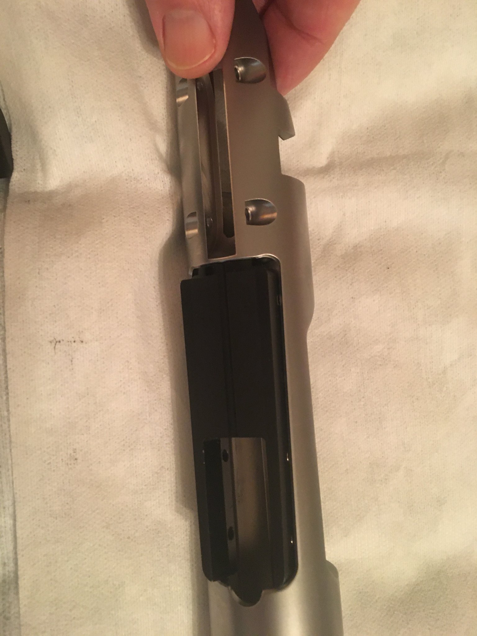

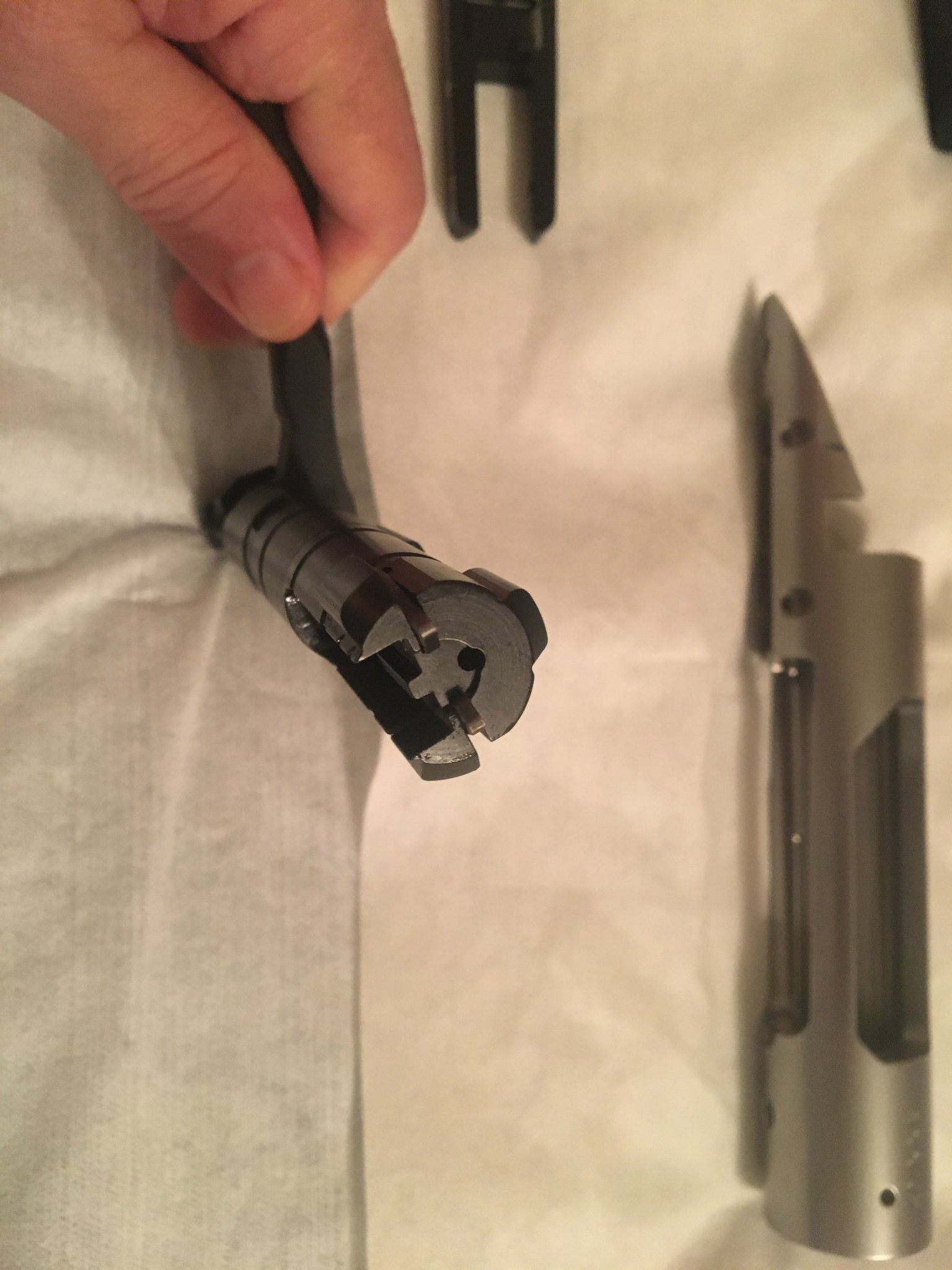

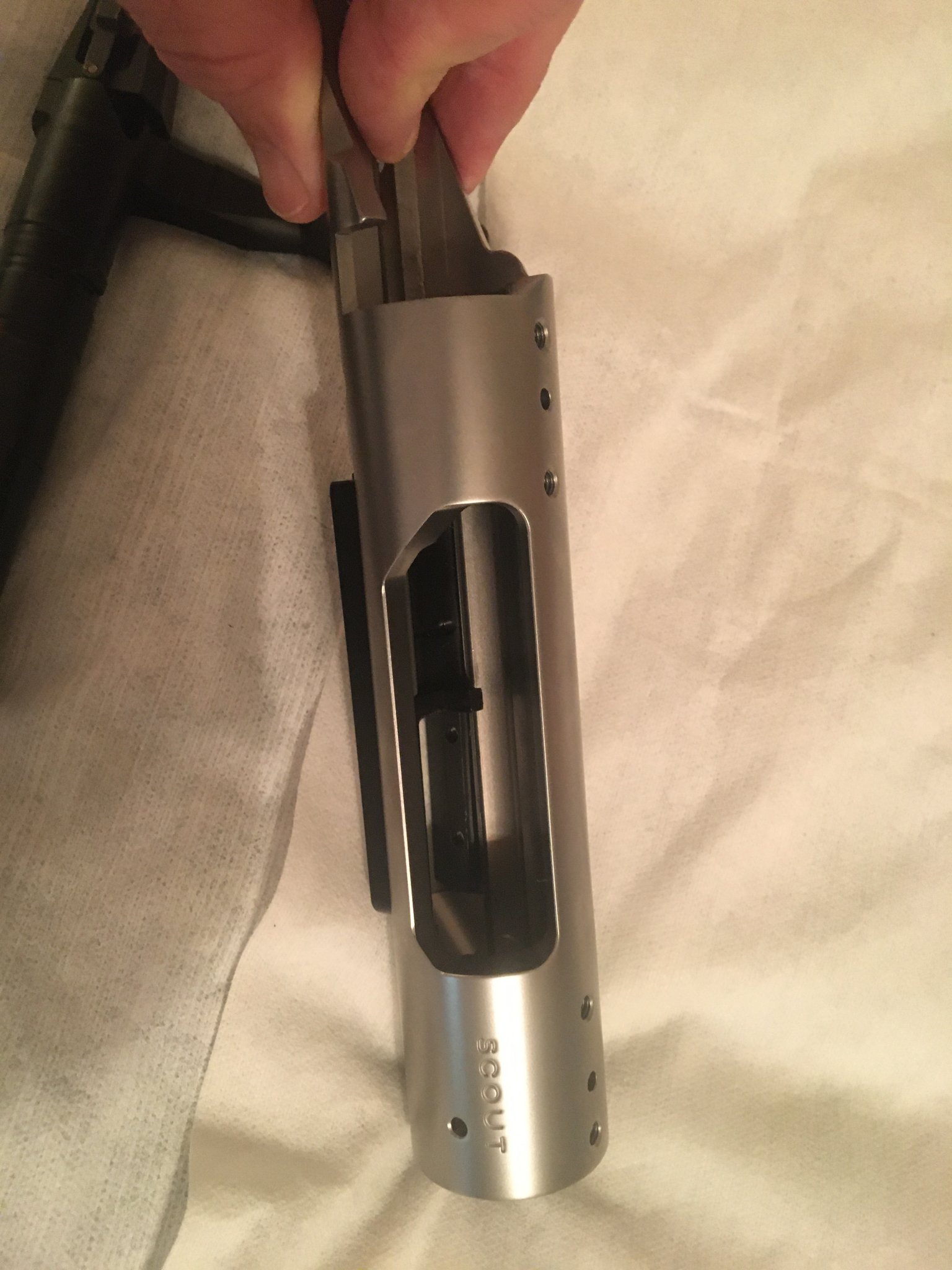

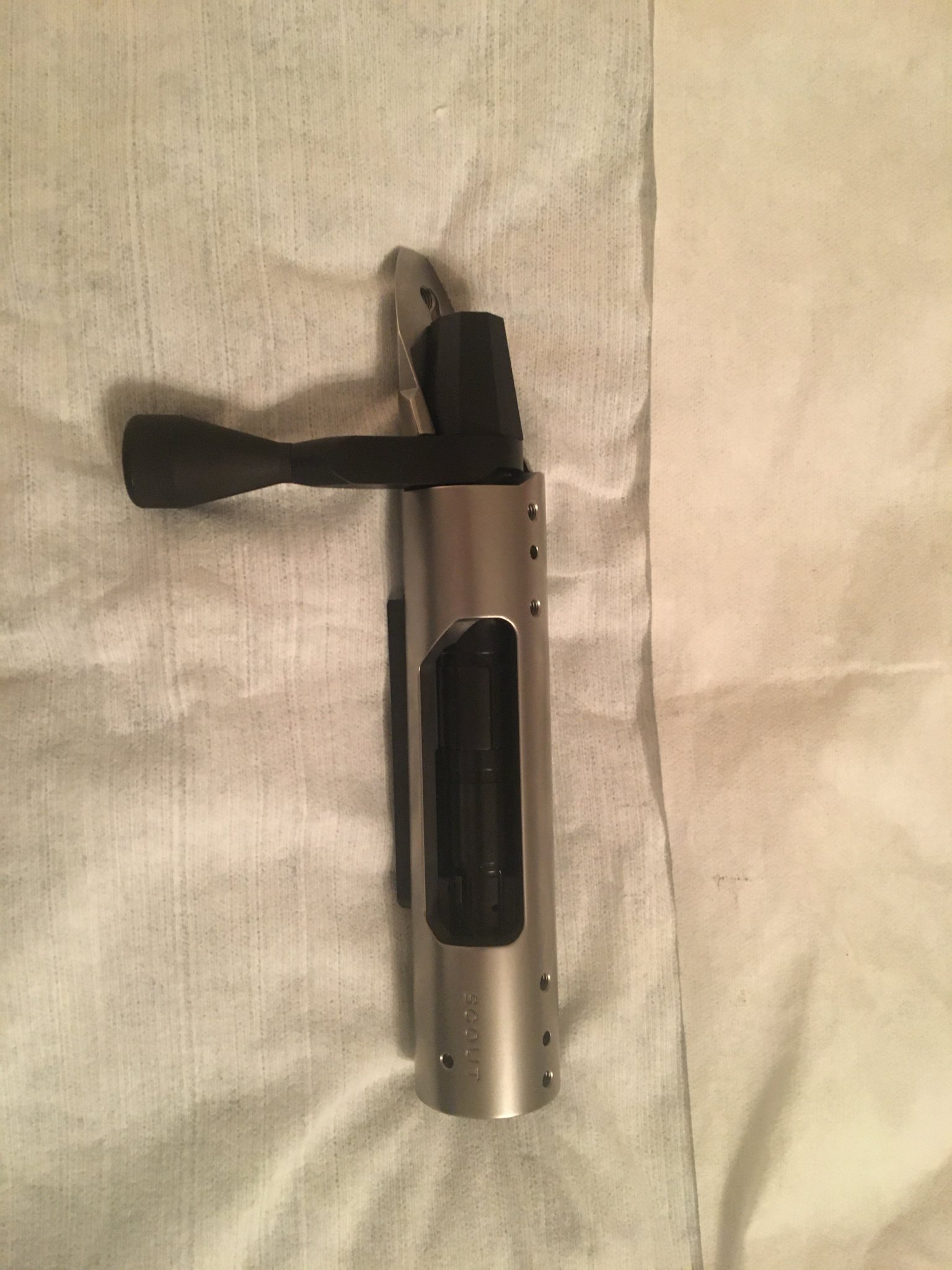

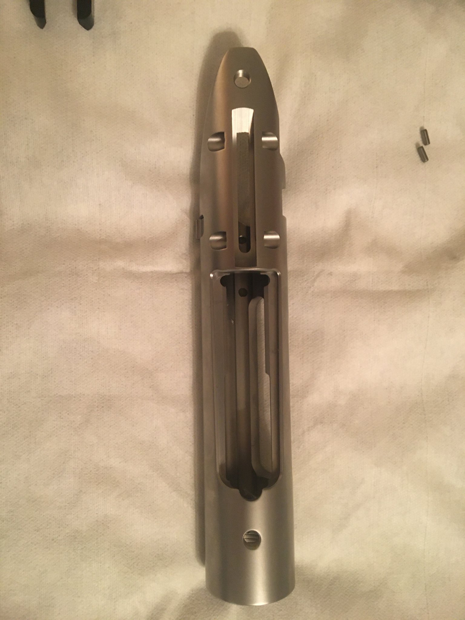

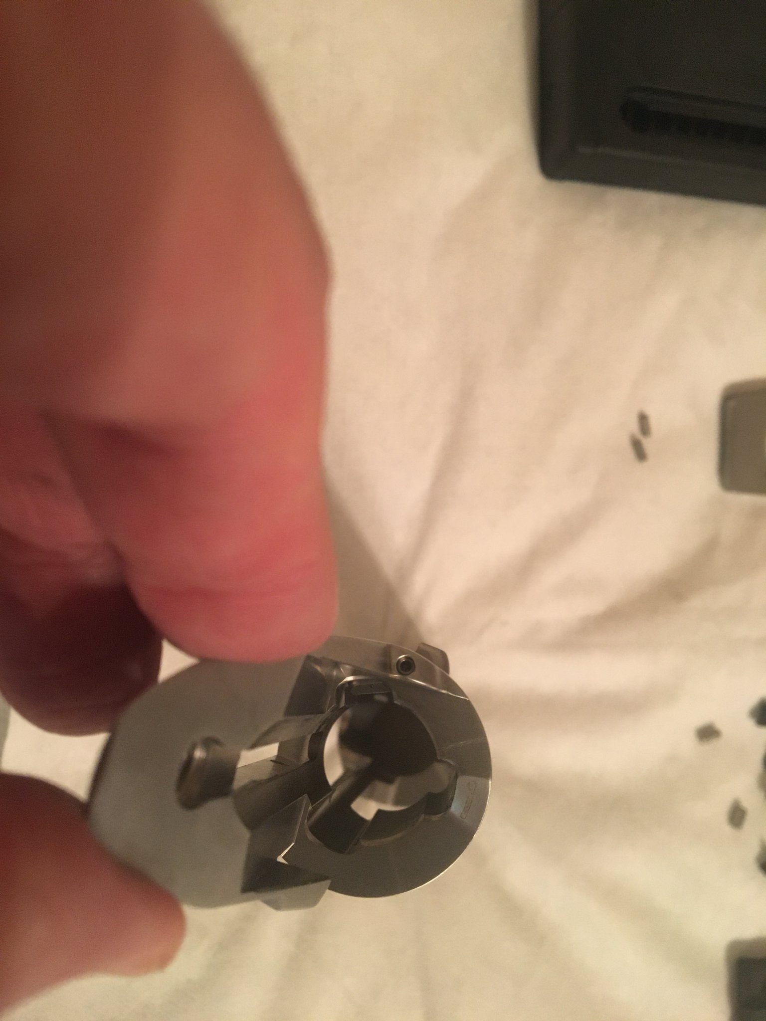

    Interesting, how does the mag adapter attach to the action? What is it like to cycle the bolt (same length as a short action centerfire or is it shortened for the rimfire length)? How tight is the bolt in the action, is it sloppy or does it seem like it may bind? What is the extractor configuration, pusher on the left and a puller on the right, or something else?
    thank you for posting
    Reactions: CBeck

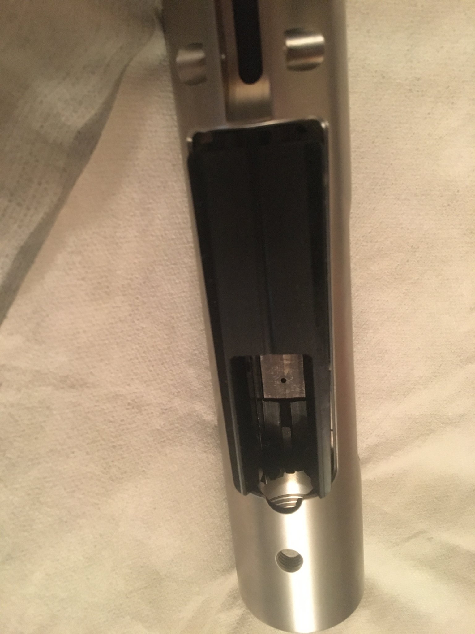

    The mag adapter fits into the centerfire opening and is held in by magnets
    2 1/8 open to cam close

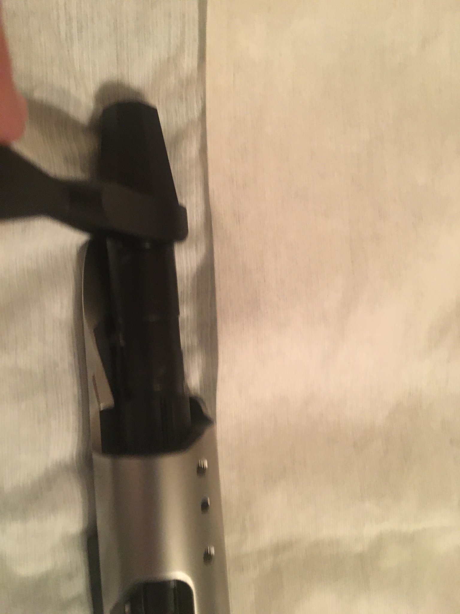

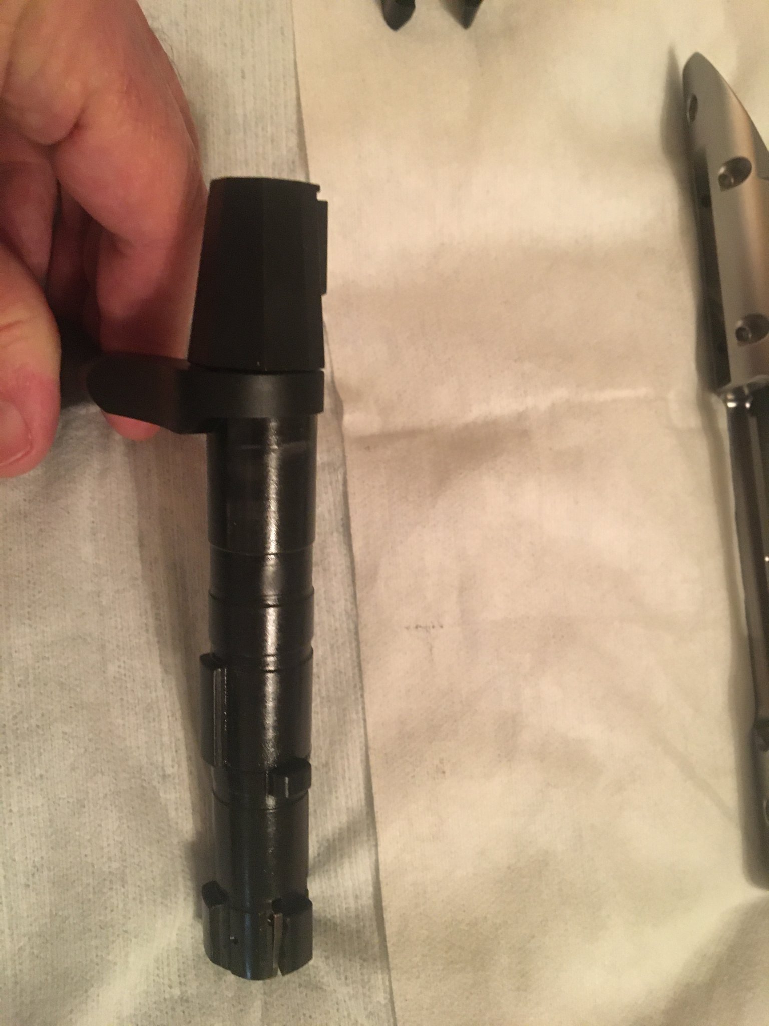

    Snug but a slight wiggle , with the guides on the bolt body and bolt head ingaging the three lug recessed it can’t flop around
    From behind , the left extractor ( inside ) is lighter spring tension , the right ( outside ) is way stiffer
    The ejector is part of the floor plate mag guide
    Reactions: jbell
    I shot one at the long range expo , I don’t have much time behind a 60* throw , they seem ,,,,,, tighter ,,,,, well you know your doing the same amount of work in 60* vs 90*
    I imagine when you in the moment it won’t matter much
    Jbell , if want any other specific pictures just let me know
    Proof is using vudoo actions for their custom builds
    Masterpiece arms ( chassis maker ?) is using Curtis customs 22 kit for their custom builds
    Reactions: jbell
    How does it lock?
    Is it just the bolt handle?
    Thanks
    There is a small lug that rotates from the side down to the bottom when you lock the handle down , you can see that lug when the center fire mag filler is removed

    I have a couple hundred rounds through mine so far. It's still a little finicky. I'm not wild about the Vudoo mag, I feel like it is inducing some feeding issues. Specifically a 3 point jam. I briefly tinkered with some L3i mags that I have, I'm going to revisit those and see if I can get them running better.
    I'm also having some extraction issues. It would extract reliably all cheap ammo I played with such as CCI Target and Aguila Target. But wouldn't extract SK Long Range Match or Lapua Center X at all. I spoke with Chase regarding the extraction issue and he sent me a new extractor that is much better, but still not 100%. I get a FTE about every 30 or 40 rounds. The nice ammo and match ammo mic out to the same dimensions. The only difference I can see is the Lapua product seems to be softer brass. The firing pin on this action is excellent, it hits quite hard, which is important in Rimfire. But its a possible theory for Lapua brass sticking in the chamber as it seems to cause more rim deformation.
    I'm not discouraged by any of this. Chase has been fantastic at communicating and helping me work through the issues. This is a brand new build from the ground up, so I expected some issues getting it running. Lord knows I've seen a multitude of the RimX/Vudoo/Bergara crowd struggling with these very issues.
    The build itself so far is quite promising. I have a Triggertech Diamond on the Axiom action, and used a Nevius chamber in a 24" Bartlien barrel, 11 degree target crown, unthreaded muzzle. Dropped it in a brand new XLR Envy Pro and topped it with a new XTR Pro 5.5-30. I shot a .8 moa 10 shot group at 100 yards yesterday.
    I'll keep working through it and periodically update.
