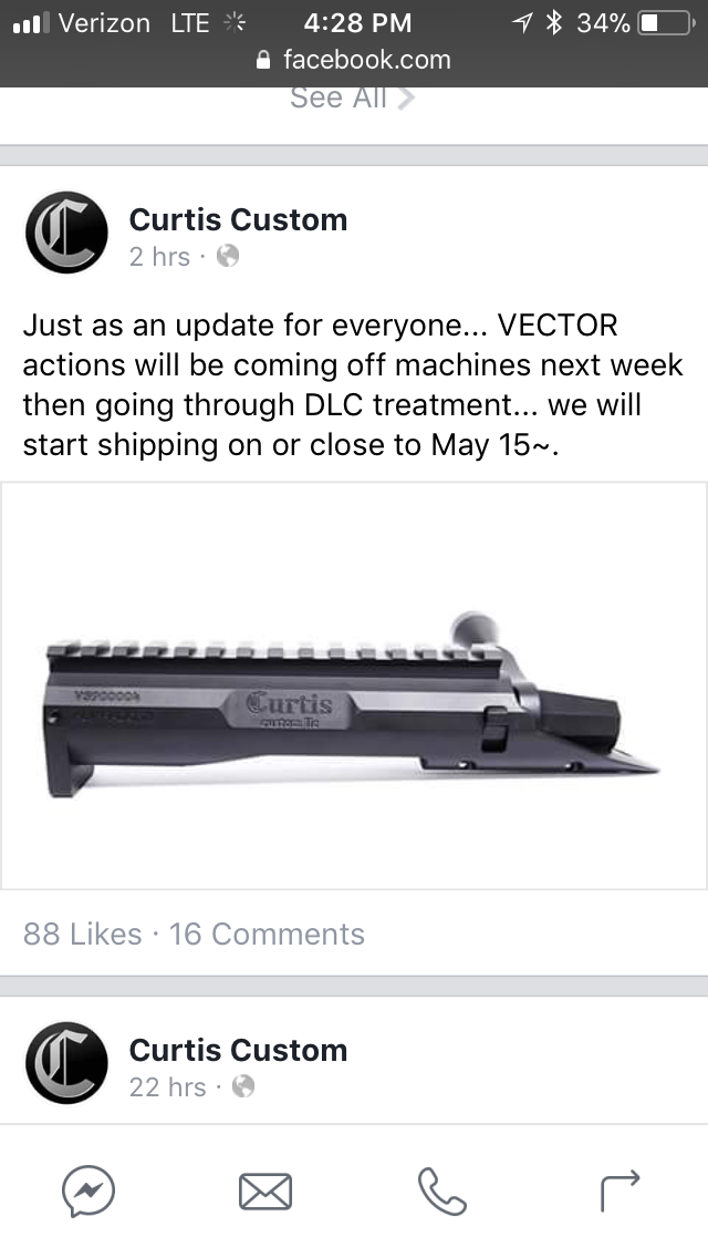

Correct I spoke w Joe last week. He said 3rd-4th week in April if you preordered one. Keep a eye on Curtis Facebook page!
Reactions: jb41291

Anyone receive their Vector yet??
I talked to Mcmillian and they recommend me sending the action in so they can scan it for inletting. I'm getting antsy.. we have a short shooting season in the northeast.
Joel said it was exact to the 700 when I asked and he's a stock maker so I thought hat was good enough. Hopefully it is
I told Mcmillian it was a standard Rem 700 footprint but they still wanted to scan it. i wanted to try the new A-6 stock
I can’t wait any longer I will lose out on this season. My order will be up for grabs. PM me if anyone wants my Vector w a Wsm bolt face. Was going to build a Prc.
