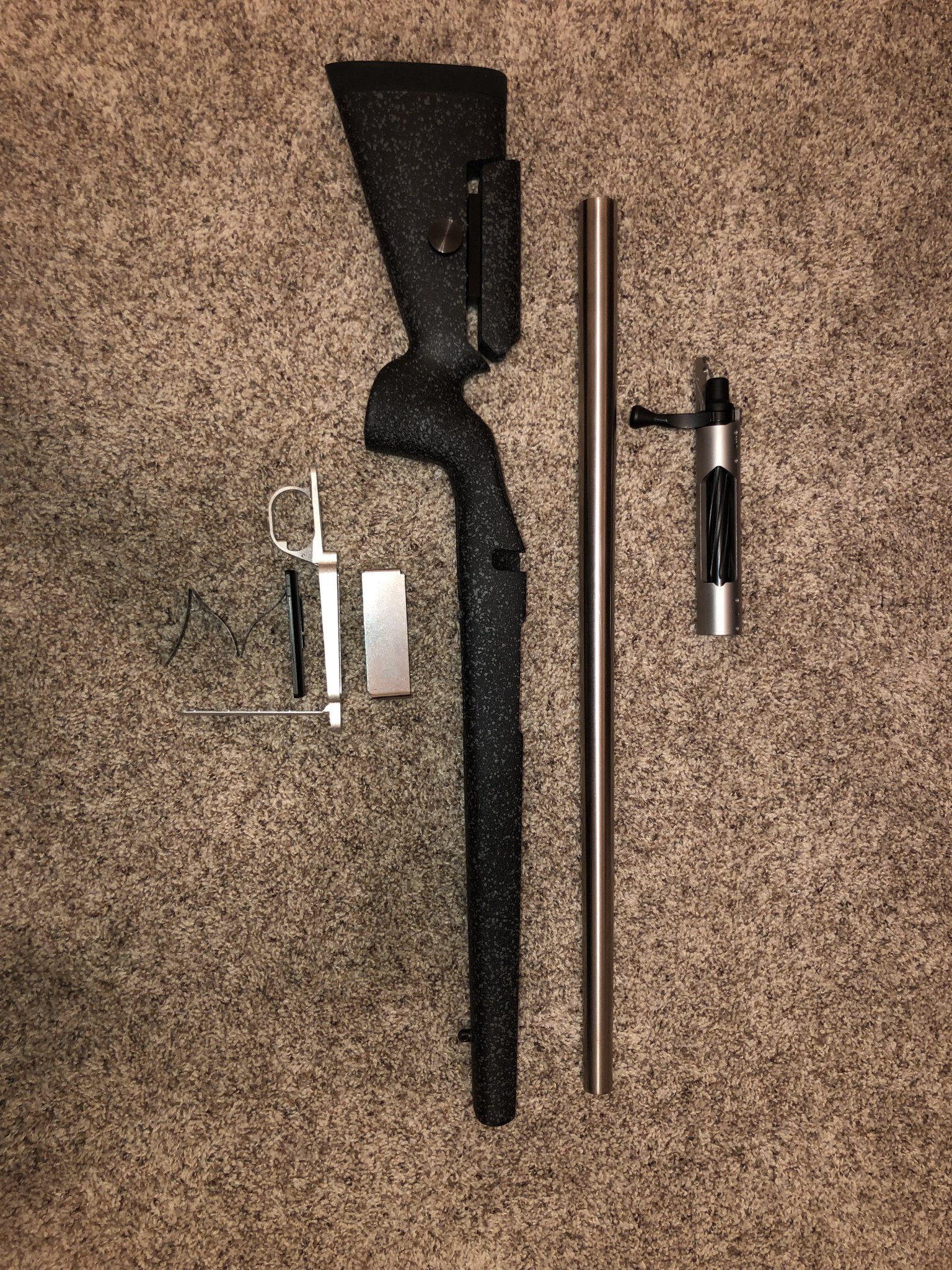

I’ve finally gathered the parts to have my first custom build assembled. The rifle will be chambered in 300 wm. Parts consist of Stiller Predator, Bartlien 5R .30 1:10, McMillan adj Game Warden, and a Wyatt’s MBE-02 box.
Objective of this gun: hunting, steel, and to throw the lead downrange as fast as possible.
Bullet of choice: 212 eldx, sitting in ADG brass.
Having the ability to use factory ammo if I ever got in a bind would be nice. 99.9% of the time I will be using my handloads.
My smith asked for me to bring dummy rounds so he can base the chamber off of the rounds. Factory C.O.L is 3.34”; the Wyatt’s box has 3.82” of space inside the mag.
What C.O.L should I load the dummy rounds too? I know I’m going to need some room to chase the lands as erosion occurs but, if I ever got into a bind, could I use factory ammo safely (not extremely accurately) if my chamber was based off of a let’s say, 3.6” C.O.L?
Thanks
