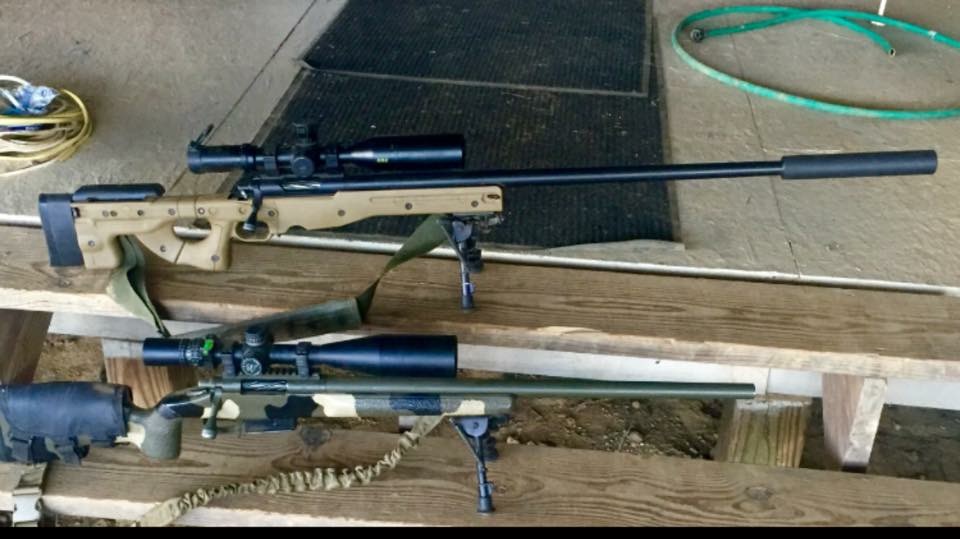

I built my first custom a few years ago. 28” HV Bartlein. Stiller Tac 30 action. Jewell HVR , AICS 1.5. Was 2700$. It’s the tan AICS.

I went with the Bighorn Origin. Bartlein m24 chambered in .260 using the Bugnut by SPR. Called Bullet Central, told them what action I was using, and they sent a BnA trigger with the propper sear installed. Worked out well.
