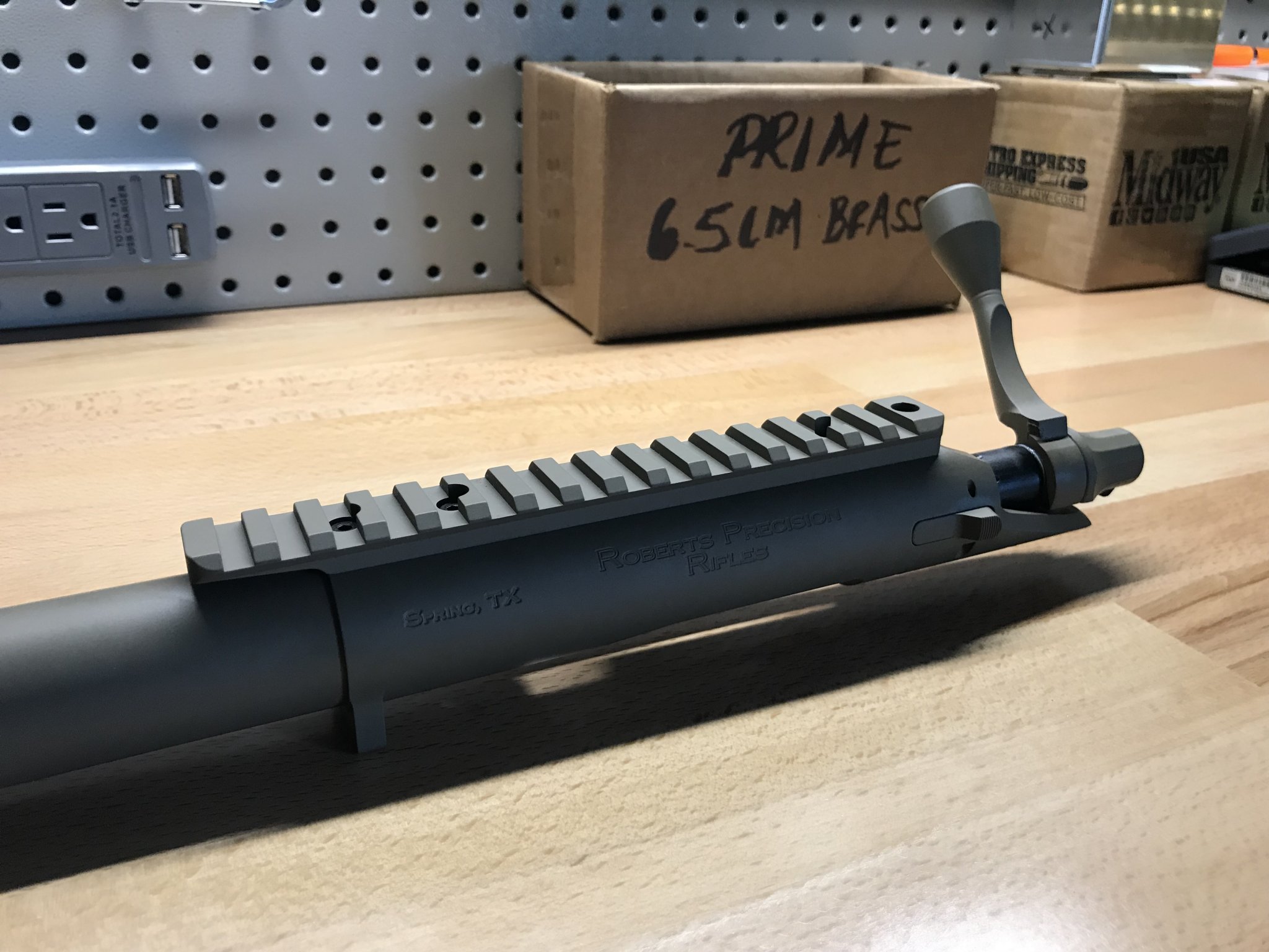

Just picked up mine yesterday, Defiance Rebel with integral lug. The workmanship and quality makes this worth every penny. I called Defiance with a bunch of questions a while back and they way they were excellent to deal with, I was sold after that.
