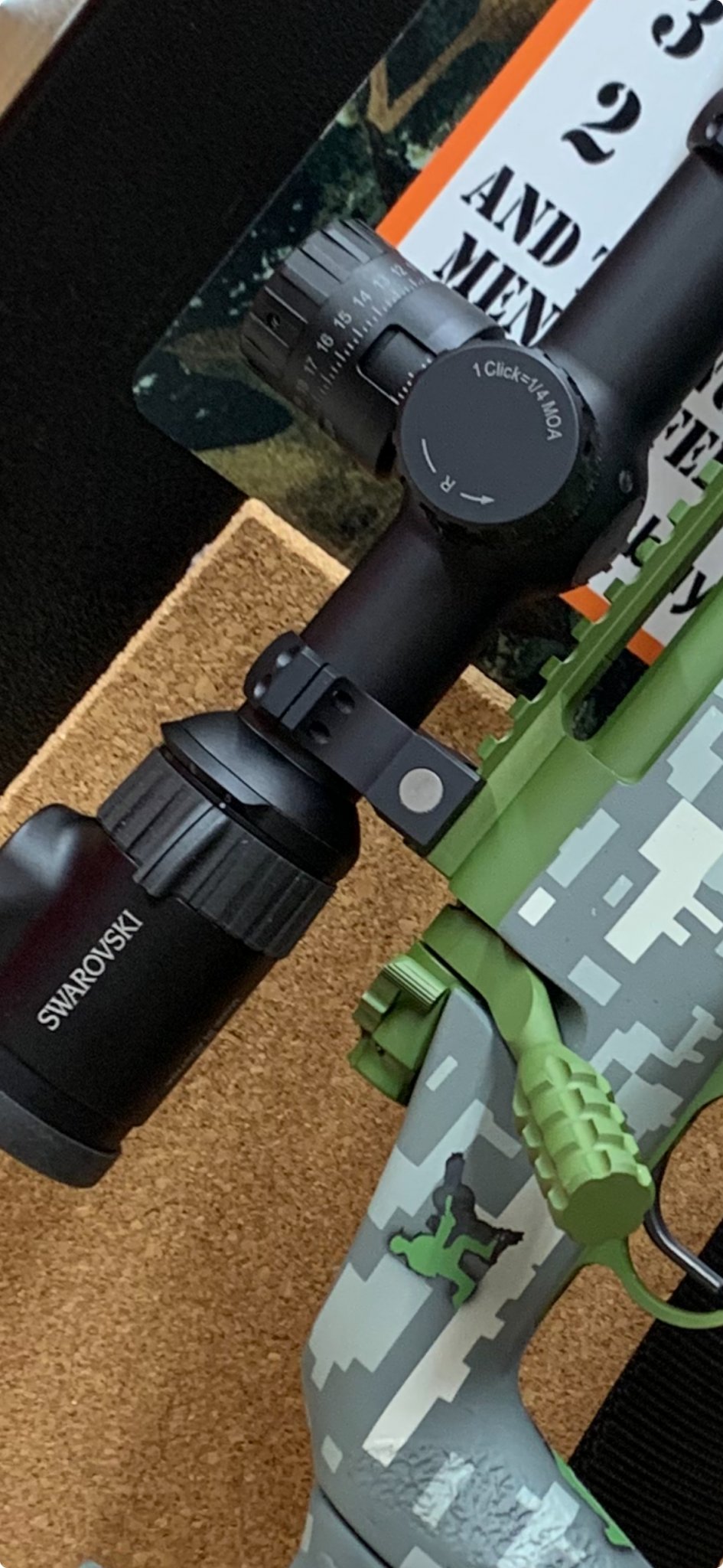

Here is the Gentry on one of my Remington 700's. This one has been tuned up...blueprinted, if you prefer. I have these on 3 700's and am in the process of putting them on every 700 I own. I'm also having the M16 extractors installed and on a couple of them, dual ejectors.
I am probably going to leave the 40X Ti unmolested.
I like that the firing pin is blocked, no way to fire. I like that the bolt can be locked so that it cannot be inadvertently opened by brush or whatever. You can load/unload the rifle with it on safe. It's too bad that Gentry was not able to secure a contract with Remington in the day as these are the way Remingtons should have been made. I am fairly certain these can be added to most of the 700 clones.
EDIT TO SAY: NO STOCK MODIFICATIONS REQUIRED.
