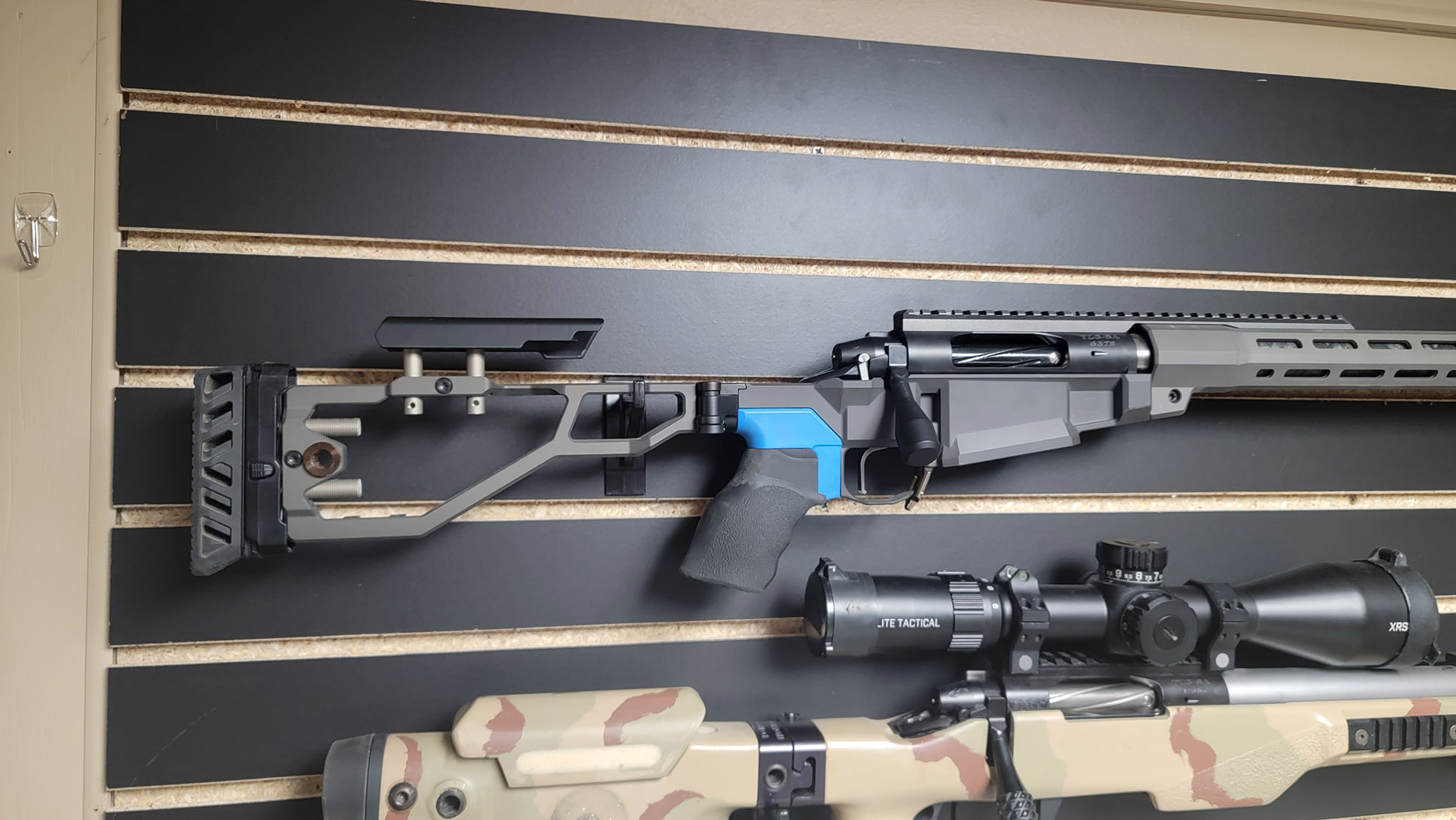

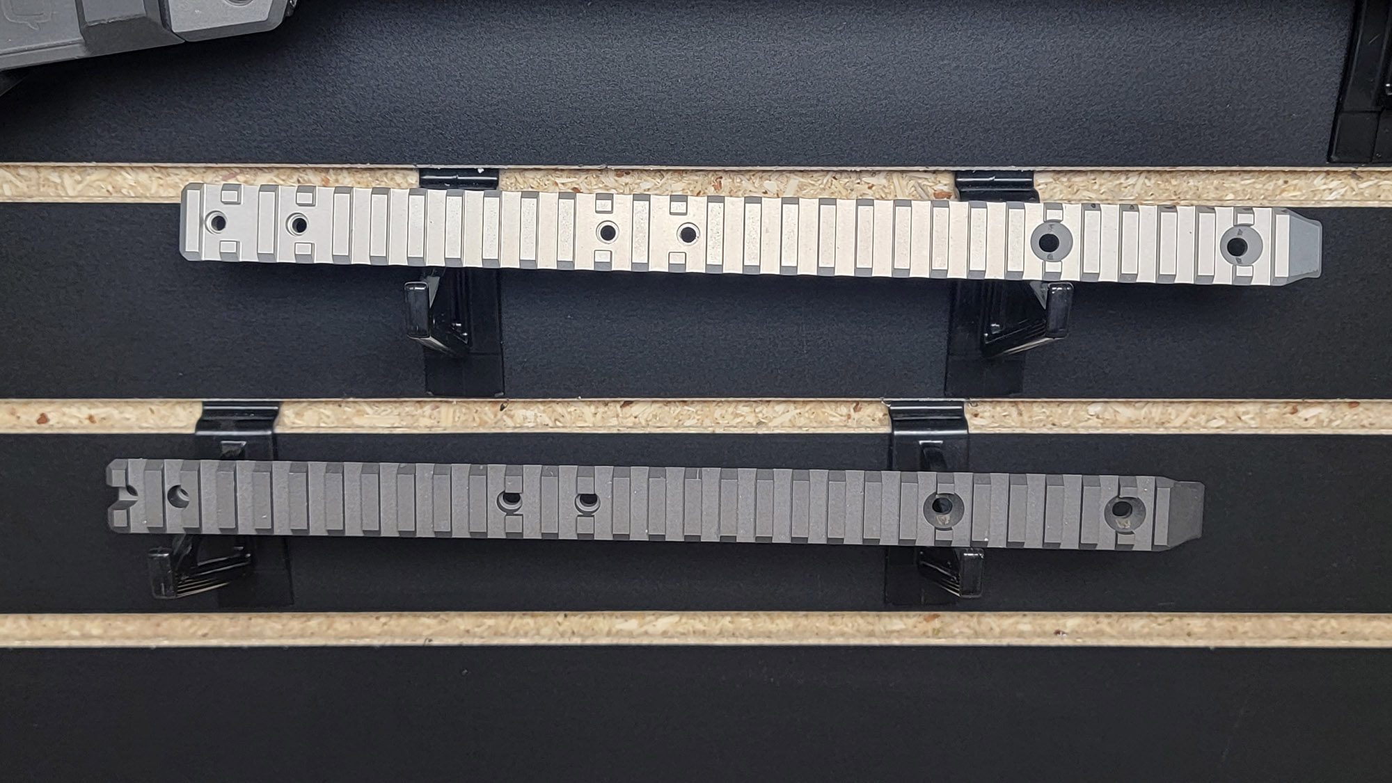

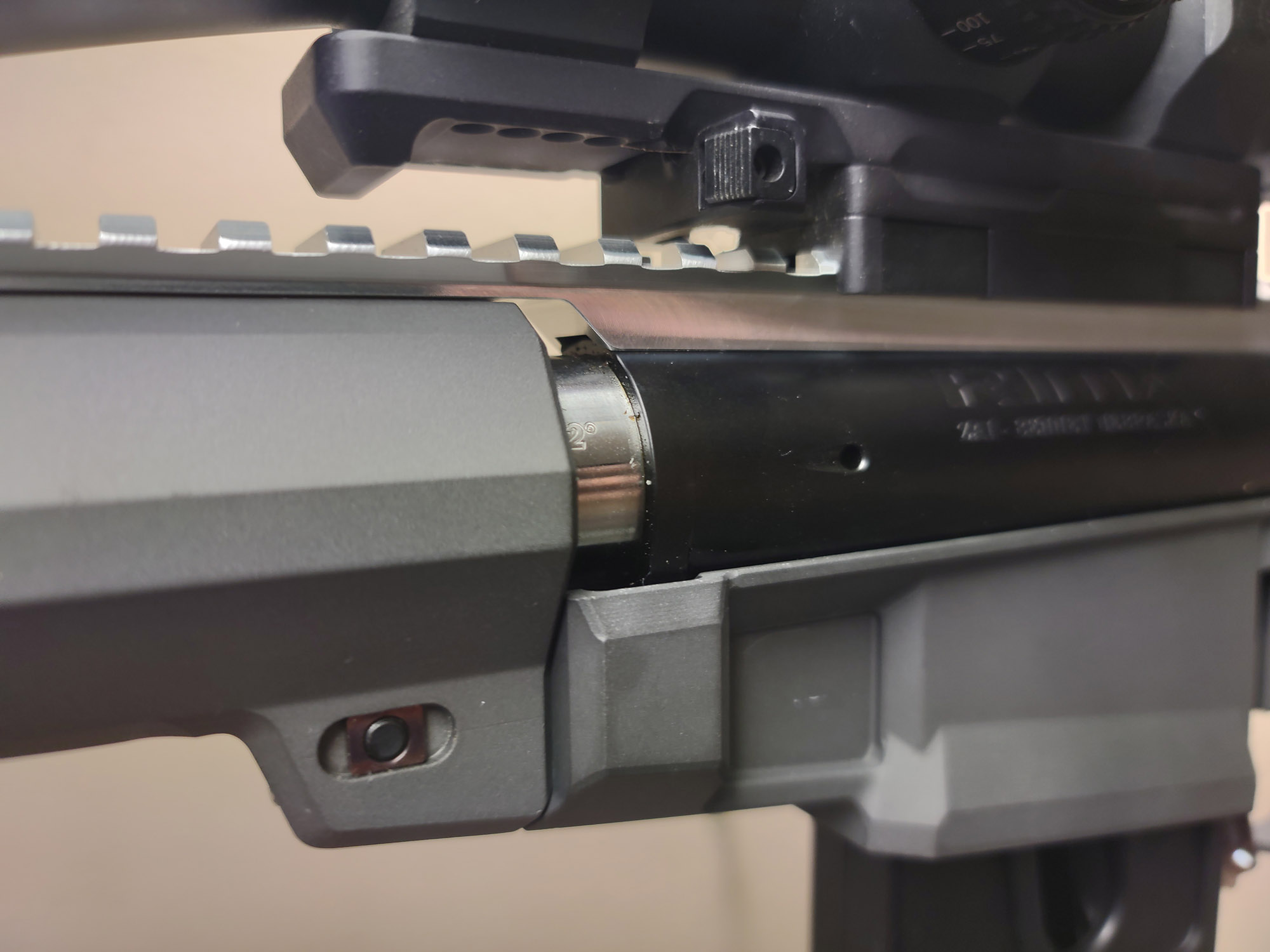

I had a pair of custom top rails made to interface with the Q hand guard and the Zermatt TL3 action. Essentailly reverse engineered the rail to have the Zermatt TL3 hole spacing and recoil pins....and still mate up to the screw holes on the SideChick hand guard. Basically doubles your usability options.
You can run a 700/Bergara as is...or a TL3 with any prefit barrel you want. I used it on my RimX for a few winter matches, had a Carbon6 18" 6.5 PRC barrel in it. had a 6 Creed prefit in it...etc etc.

Those look really nicely done! Did you machine them yourself, or have them done? While it would be 90% useless, I'd love to see a full length top rail for the SideChick.
Reactions: RickyRodney
Had a buddy make them. Full top rail wouldn't be bad, I thought about doing a night rig with thermal but don't think I'm gonna keep it long term
