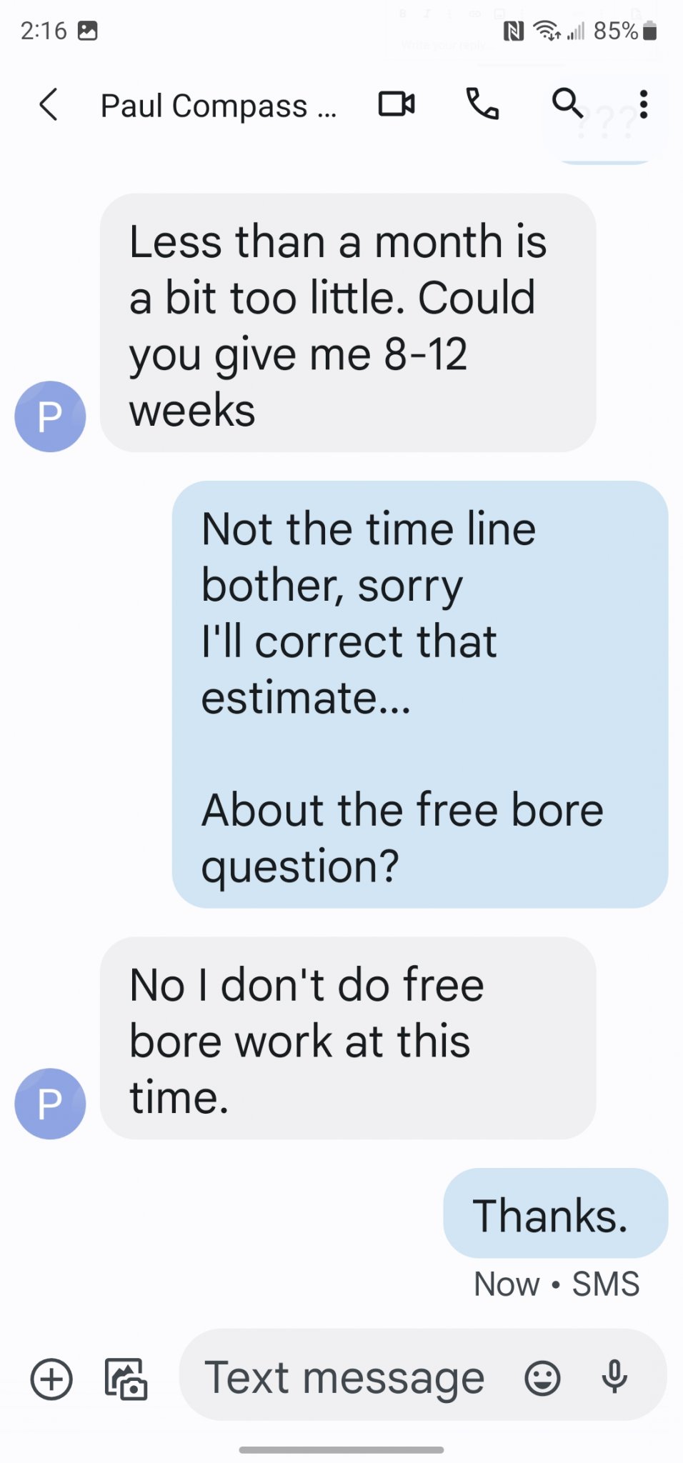

Do you know if CLE can do custom freebore work? I have heard from many folks that the SAAMI spec chamber, for AR-15 mag length, causes bullets to jump quite a bit and many have suggested shorter freebore to make it more jump friendly.
I'll find out and get back to you. What caliber specifically??
I was a little off with the turnaround times. I guess with Spring coming in they're picking up more orders but here's the answer to your question..
Ah darn! Well it probably won't hurt accuracy much if my hornady 105's are junmping 30-50 thou
