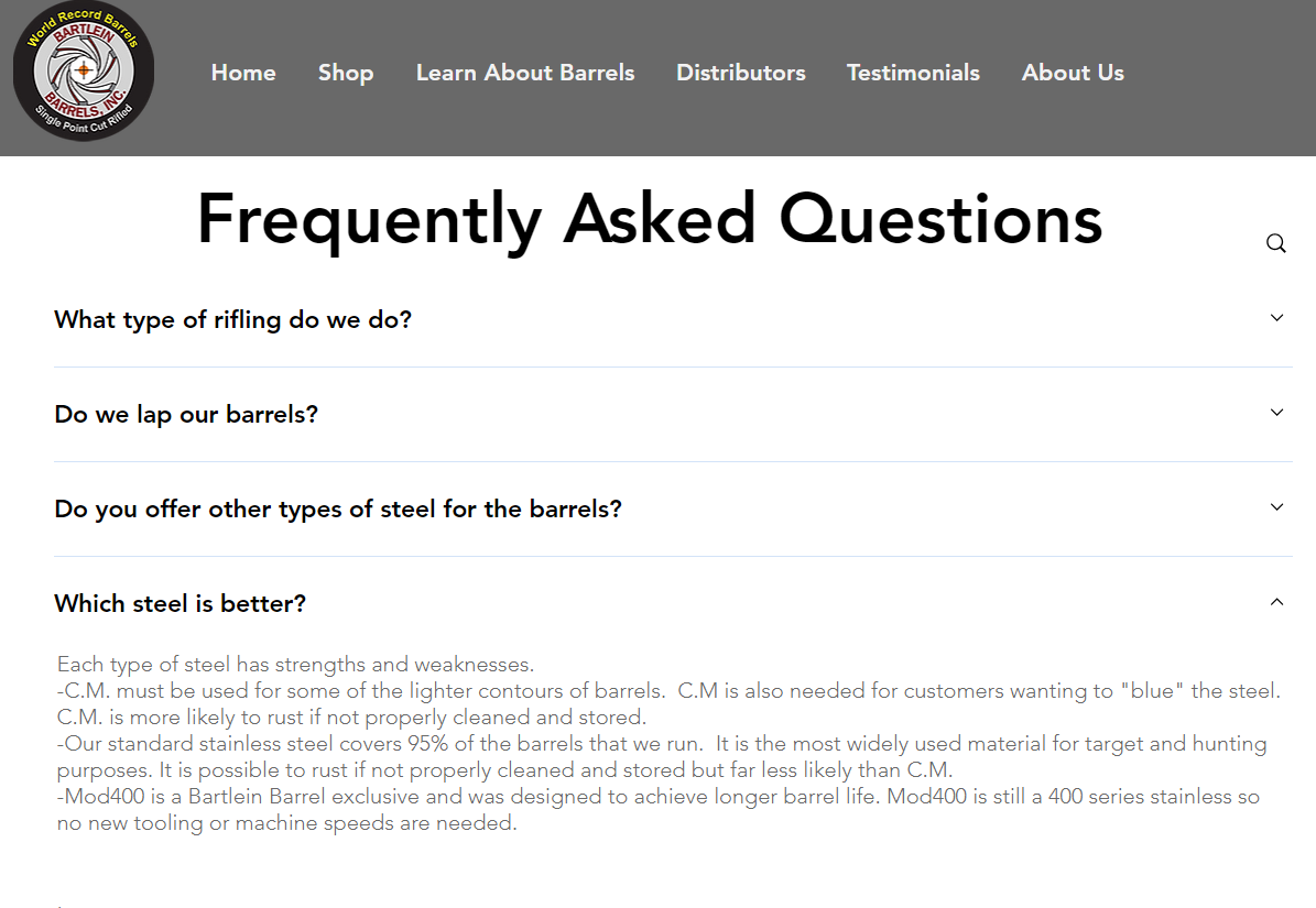

…and I think you’re confused between “chromoly steel barrels” and “chrome lined barrels.” I don’t think it’s something you have to worry about yet.
You may be correct as I am thinking of lined. You're saying they mean in entirety? Made of chrome Molly??

I'm curious how you call yourself a gunsmith and don't know anything about truing actions, barrel materials, muzzle brakes, triggers?
I've never trued an action, never lathes a barrel and most smith's outsource that anyway but materials what'd I miss? The chrome lining vs build material? Muzzle brake I know plenty about but I've never had to put one on an 11deg inset for instance so I'm not sure how that'd be done. Triggers I know plenty but mostly how to take a stock 1911 trigger assembly at 6lbs and slay that sumbitch down to 1.8lbs with no follow through and timing to match. Ya as I said in my bio I'm a pistol guy but I'm also a Smith with less than a year at what is a part time biz. Speaking of brakes I also milled a sweet custom bushing brake with an inline ported barrel that is just a tack driver. Tangents... I'm sorry but if there's anything I can answer for you please don't worry about asking and although I'm definitely a little gut punched by the paranoia or haze it's all good. Water off a ducks back.
I kind of forgot those kinds of smiths exist that just repair and tune fire arms. I'm used to smiths who turn barrel tenons, chamber barrels, true actions and install muzzle brakes. Carry on.
