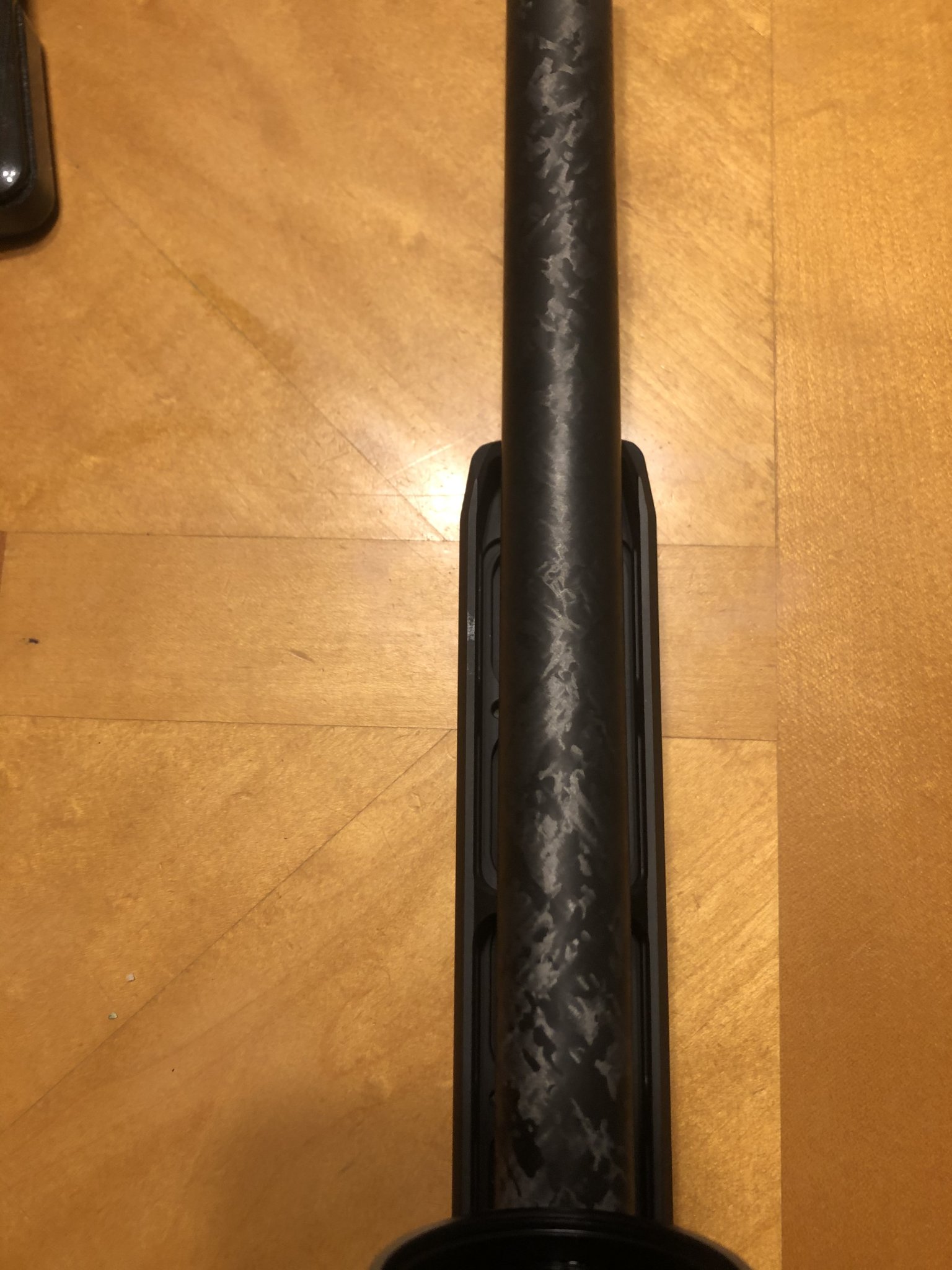

New shooter here. I built my first custom bolt action rifle. Xlr element magnesium chassis, proof 16.5” cf barrel, and a bighorn origin action. Just got it back from the gunsmith last week and noticed that the barrel isn’t centered with the stock. It is free floating. I shot about 50 rounds through it this weekend and got it zeroed. Groups weren’t super tight but about on par with how I normally shoot. I was just wondering if this could be an issue. I did have one round that wouldn’t chamber properly. But only one out of a little over 50. I could be nit picking because of how much the smith charged me but I just wanna be sure it is a problem. They did bed the recoil lug I think. I will attach pics. Any help would be appreciated.

Id be pulling the barreled action. Checking the bedding. And retorquing.
You see this with stocks like Manners because of the process in making stocks. But in a machined chassis this shouldn't be happening

I understand the frustration, but if it’s free-floated, it shouldn’t matter.

Why TF would they glass bed the recoil lug..
It’s ain’t a chassis issue. It’s either the barrel that off center or the glass shit they put.
Not 100% certain but I think that’s what they told me. They would glass bed the recoil lug. I could be wrong. It’s a gunsmith with a pretty good reputation around here. Looks like I’ll be contacting them to see what is going on
That’s what I was thinking. You think it might be over torqued?
Over torqued is not going to pull it to one side or the other unless it was over torqued to the point something was broke. Over or Under torqued will play with your accuracy but it isn't going to pull your barrel 1/8" to one side or the other. Agree with the above, pull the barreled action so see what's going on then re-torque to specs... Inch lbs not ft lbs 🤣

I mostly agree, but respectfully dispute the statement that removing and reinstalling a barreled action would constitute modification of hardware. I think I understand that you’re approaching this from a warranty kind of mindset, where the problem should be returned to the smith as-is for the best shot at effective troubleshooting. However, if the problem goes away with removal and reinstallation of the BA with proper torques, then it tells you something is off with the chassis, barrel shoulder, or action face. The action screws and chassis/action contact surfaces should be all centered on the midline of both objects, and torquing something down too hard on the centerline should only cause a bowing up/down, not left/right. Then involve the Smith with what you observed.
More importantly, removal and reinstallation of the BA is a basic task, and should not require the input or oversight of a smith.
I have an XLR carbon chassis with a Kelblys Atlas Tac action in it and there is no reason to bed an XLR chassis that i have found.

When you sighted the scope to the rifle, did the windage adjustment end up close to being centered? I would be more concerned the barrel was not in line with the action after it was installed.

If all else fails, check the bedding around the recoil lug. Typically if the barrel sits on one side or the other it may be the spacing/bedding around the lug..
Most likely a barrel that isn’t perfectly straight, or has a bore that isn’t concentric and/or straight, and wasn’t timed so that the curvature was at 0 degrees. Probably not a huge issue, but annoying for sure. I’ve heard a number of gunsmiths mention that proof barrels tend to have more issues with this than others as well.
Between the 20+ custom barrels I’ve had, only 2 have been noticeably off center. Both shoot great.
If you pick up a factory Savage or Remington, I’d say 50/50 chance your barrel will also not be perfectly straight in the barrel channel.
This was the first thing that came to mind, I used to dial all of my barrels in at the breech end and throat and would sometimes see barrels with quite a bit of curvature/bend before I “timed” them to 12 or 6 o’clock. OP, look at the trigger location, if you have a bedding problem that’s causing your barrel to be that far off center I bet your trigger won’t be centered. Just a thought

You may have to take a Dremel and remove some of the bedding around the recoil lug and redo it this time holding the barrel centered in the barrel channel

So I dropped it off with the smith yesterday and he called this morning saying that it’s not an issue with the barreled action. He claims everything is true but that the chassis is the issue and it’s purely cosmetic. I asked him if maybe the bedding could be the problem and he didn’t think so. I’m picking it back up from him today so I will take a look to see if the trigger is centered. I think that could very well be the problem. If no bedding is required by manufacturer specs, and then you bed it, i feel like it would probably throw something off. I reached out to xlr this morning as @XLR308 mentioned just to get their opinion on the matter. Sounds like they have outstanding customer service
I have a strong feeling the problem is in the bedding. The smith is claiming that it wouldn’t effect accuracy just purely cosmetic. Is that true? I feel like it would definitely throw off accuracy
Eh, it could but you never know. If you remove the bedding material yourself, you’ll probably have to re-bed it. If the mfg takes it out, they can probably do it on a mill and get it back to spec, unless your smith removed chassis material when he bedded it.
If the mfg can’t help you, I’d just Dremel out the smith’s bed and redo it with the barrel properly centered.

The job of bedding is to make a matched surface for the action to clamp against so there’s no pressure points, no bends, no room for movement and no stress on the action as it relates to the stock. With that said, if the bedding job is done well (without regard to the alignment issue, just yet), I don’t really think there would be an accuracy problem. I’m having a little bit of trouble understanding how the action screws would line up if the action was so far off to one side that the barrel was misaligned in the channel. I would take the action out and have a look myself. Is the action inlet centered behind the barrel channel inlet? Is there a measurable quantity of bedding material on one side that isn’t there on the other side? Is the action 8 let centered in front of the butt? Lay a straight edge along the chassis from butt to nose and see what’s not lined up. Are the action screw holes so sloppy that you can get the action off to one side and still get the screws to go through? If the action mates well with the bedding and the action screws go through and tighten without pulling the whole arrangement out of alignment and the barrel is truly free floated all the way back to the recoil lug then I wouldn’t worry about it. If you plan on shooting this stock off of a bench rest or in F class where the stocks tracking in the rest is of utmost importance, then I would say you have a problem. If you’re shooting it off of a rear bag and bipod arrangement or off of improvised positions in the field, I doubt you will ever know. I would definitely go out and shoot the gun a little bit before I got too carried away with any Dremel tool activities. There’s a strong likelihood that if you get in there and chip away at it with a Dremel tool you’ll end up having to replace the entire stock/chassis and it’s a 100% certainty that at this point any removal of material will require a re-bedding. There’s going to be no such thing as just milling out the bedding material.

Ok, so some of this is good and some not. First and foremost, you’re describing a full bed job, but I believe OP stated the Smith only bedded the recoil lug. Depends on the action inlet surfaces, but basically that almost certainly means the only bedding material is behind (and potentially also in front of) the recoil lug. This is different from bedding the action, and could certainly introduce a horizontal cant if done very improperly. Not sure I could do it intentionally, but I think I can envision it.
As to 100% for sure needing to remove material, if the smith just skim bedded the recoil lug, the mfg can probably just take that off by running their normal program, since the underlying material isn’t changed when you skim bed.

That’s fair…lug bed only….I can see it…but wouldn’t that be a rotation not a shift? And how do the screws get through if it’s rotated?
And back to the OEM for re-machining is getting into that “total replacement” territory I was talking about.
