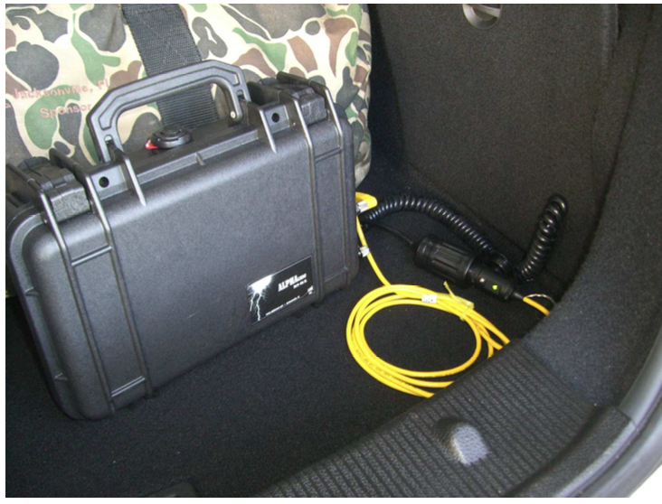

    The only other thing I can think of would be a hole or power coupling so you could have a battery in the closed case, and a cable that could be plugged directly to the case to power the LR (I did something similar for my kayak's fish finder, so the battery could stay in a dry box/pelican case and still power all the electronics I have in the kayak; i.e. fish finder, life well, etc).

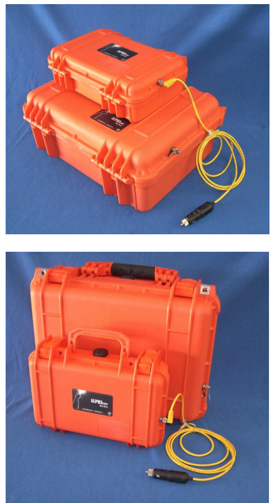

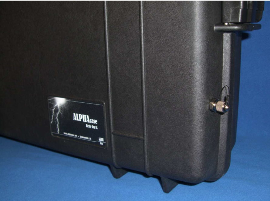

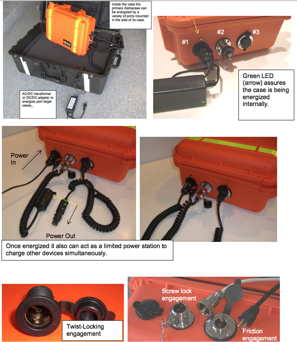

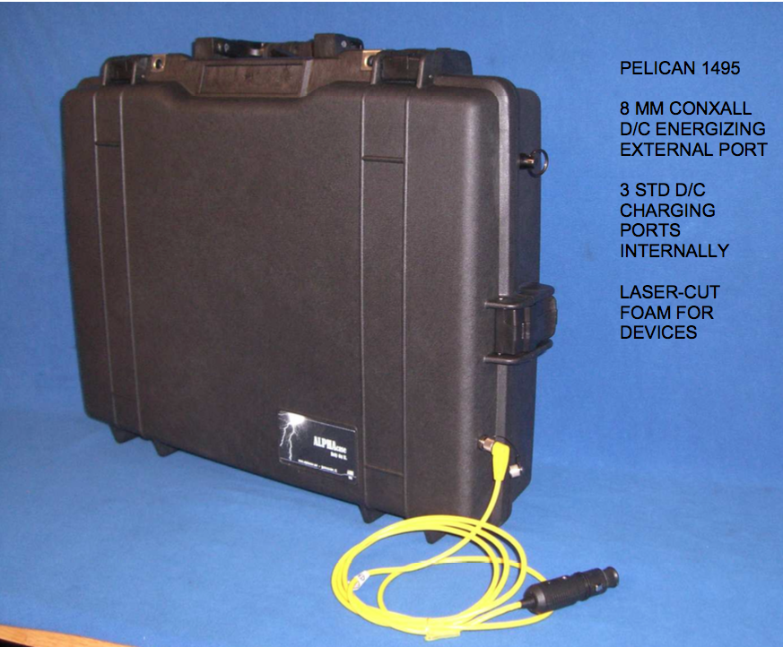

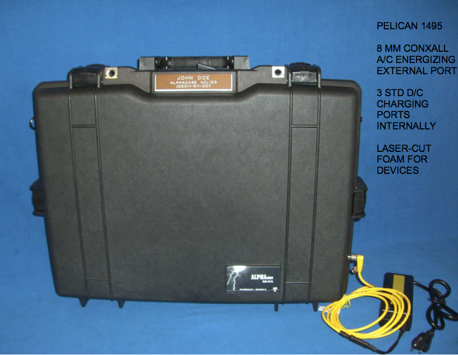

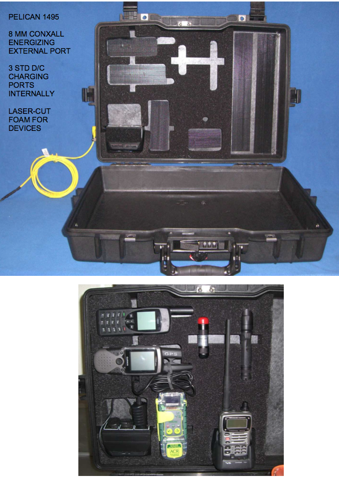

    Let the record show I did not initiate the power coupling idea. However, I have extensive experience in fabricating powered pelican cases for survival kits; the permutations for configurations are only limited by your imagination. The power (AC or DC) can be supplied to a variety of pelican case sizes via a variety of water tight charging ports; the LR could easily be secured to the outside of the pelican case with QD style ELS / QLS Safariland attachment systems for a stable mounting base. Look past the sat phones, VHF radio, GPS, EPIRB etc but all these devices stay eternally charged based on your availability of power, AC, DC, solar panels....just some food for thought. You would want to fabricate the case with laser cut foam or industrial strength-based velcro systems which are less expensive and even more modular for associated gear you might want to include in your kit.

    Bingo. #2 is what I used for my purposes (standard maritime waterproof power coupler used in the boat industry).

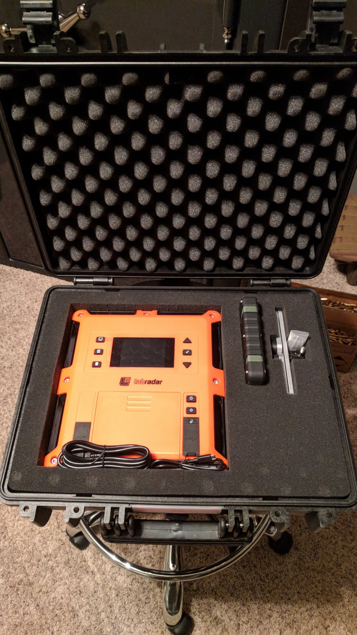

    $50 for a Monoprice case on Amazon. Closest thing I've found to a pelican yet. Also fits my battery and foldable stand.

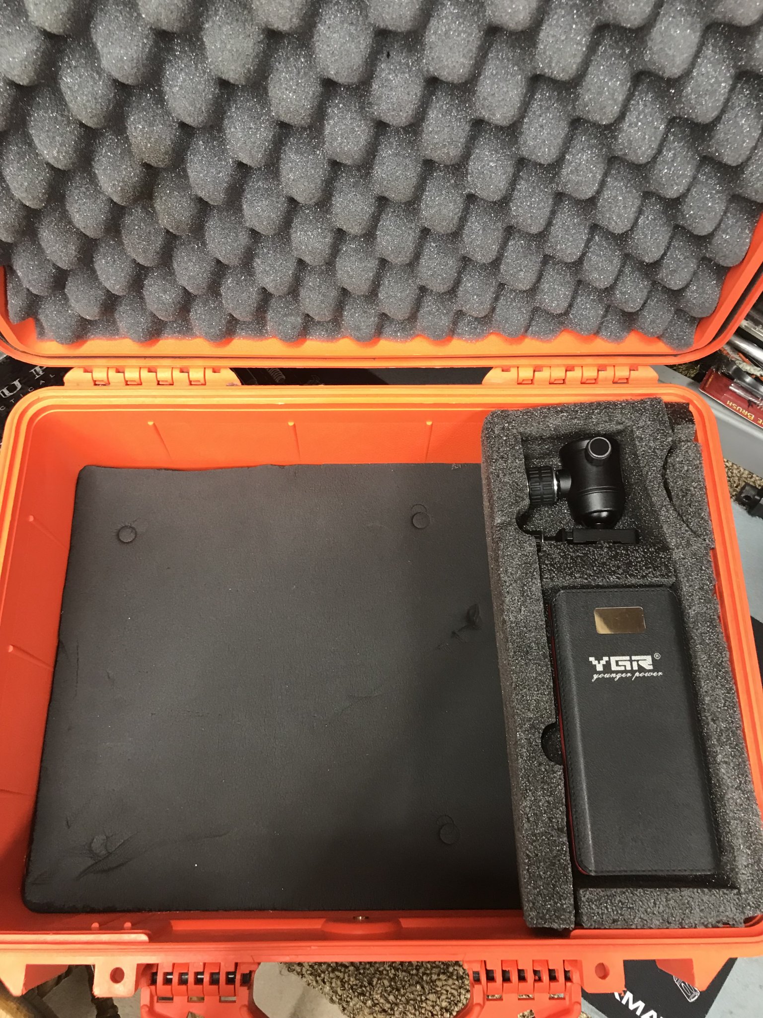

    Those look like great options for the price. I went a bit different and found a used Pelican 1520 case for sale for $50.
    Pelican 1520 case INTERIOR (L X W X D) 18.06" x 12.89" x 6.72" ,

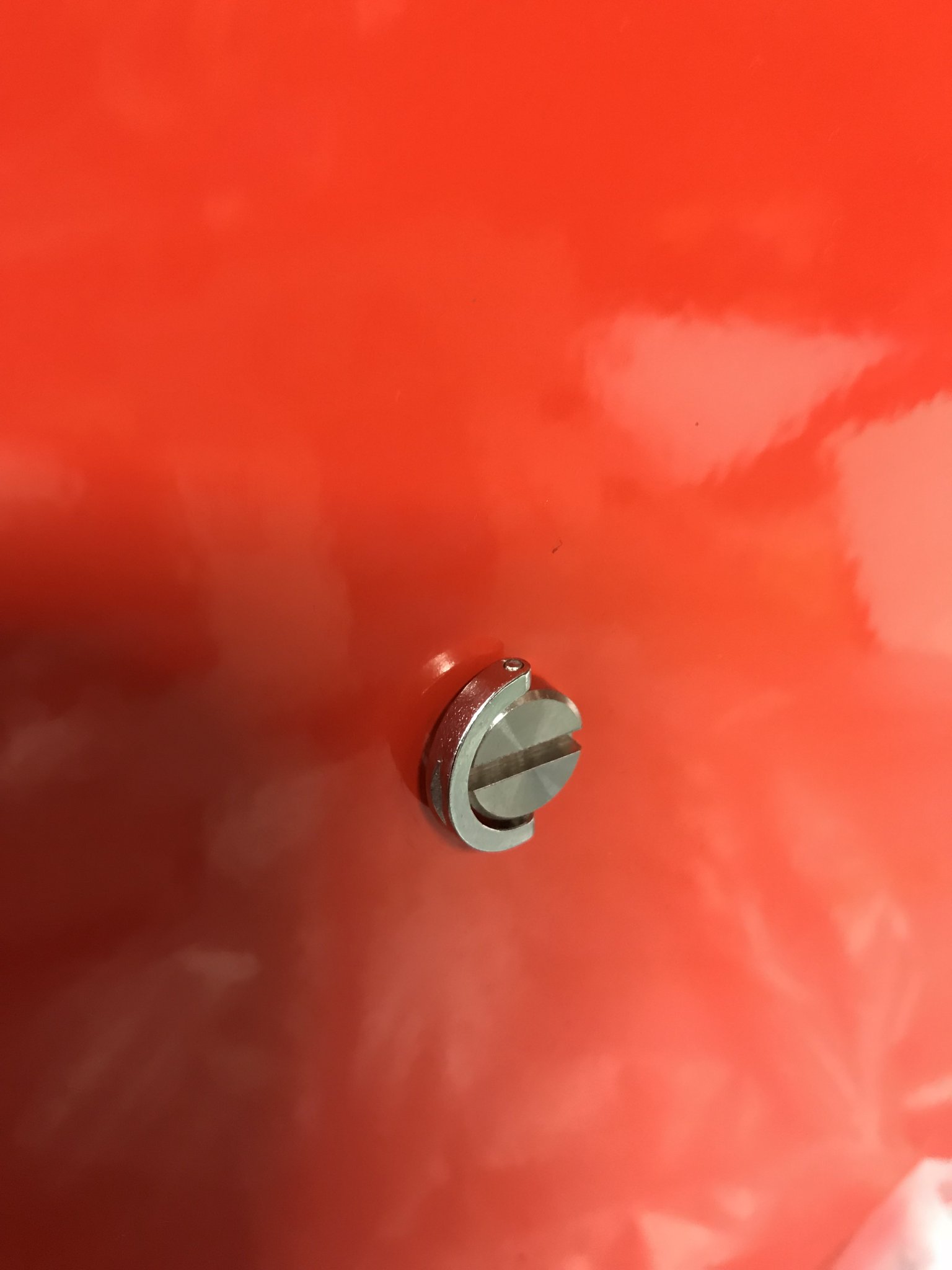

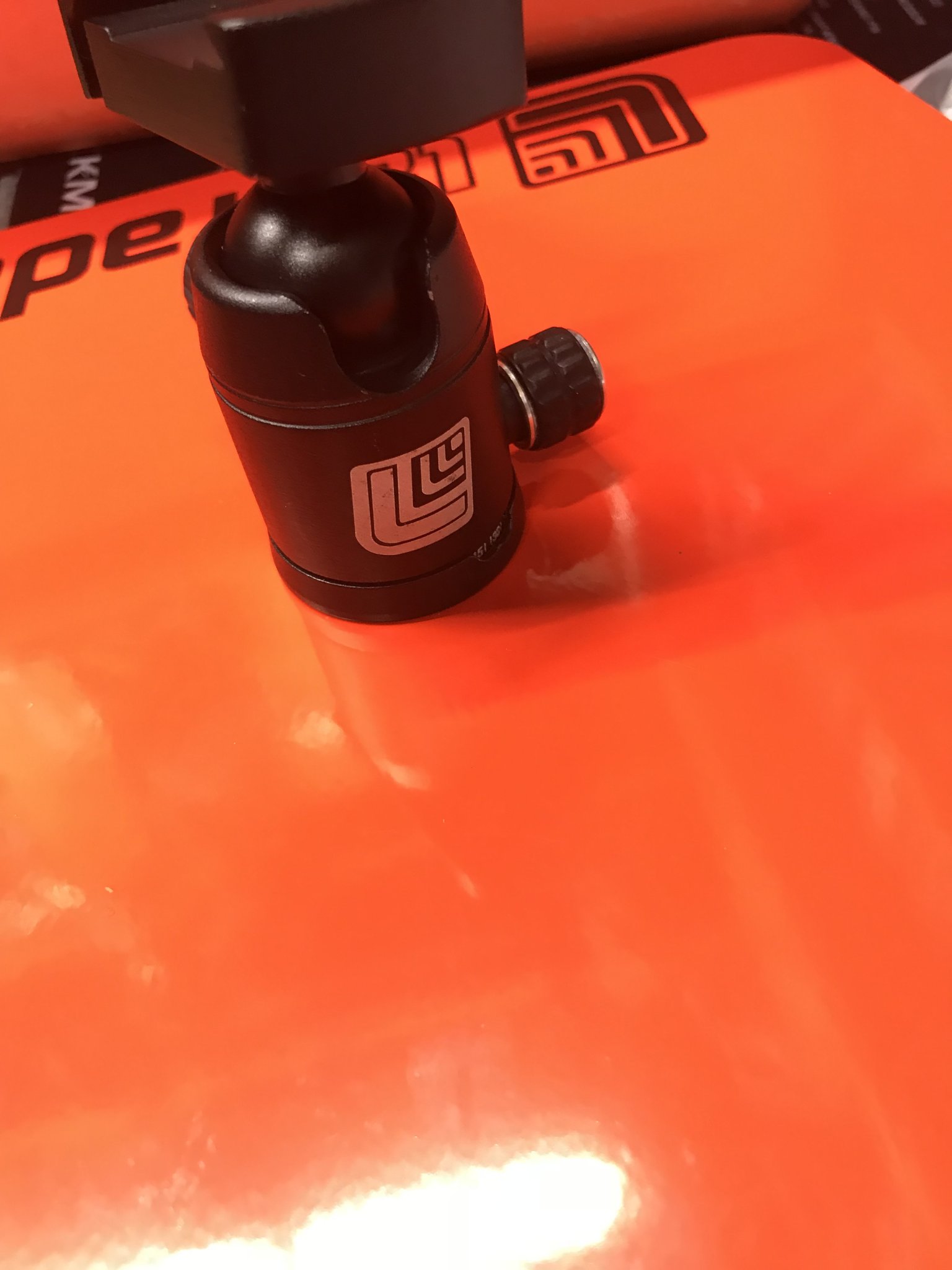

    I have the base under the soft case. I take the base "Ball Head" off. I then purchased D-Ring Thumb Screw Adapter 1/4''-20 Thead for Camera Tripod QR Quick Release Plate, 5 of them from for $8 from Amazon.
    I used a 3/8"-16 to 1/4"-20 Reducer Bushing Convert Screw Adapter for the bottom of the ball head, Amazon.
    I took the original screw out that attached the the ball head to the base and made it a where I could take the screw in and out for travel and setup.
    Added a Portable Charger Real 20000mAh with Lightning Input, External Battery Power Bank with 4 Port USB Output for $30.
    I thought about going with another quick discount mount between base and Ball Head but figured the D Screw was easy enough, but a quick disconnect would be nice also.
    Directions and cables go in the pouches of the Labradar soft case, could have done without the soft case and put foam around the unit like others above, and put cables below battery in the case. I like having the soft case and everything in one place.
