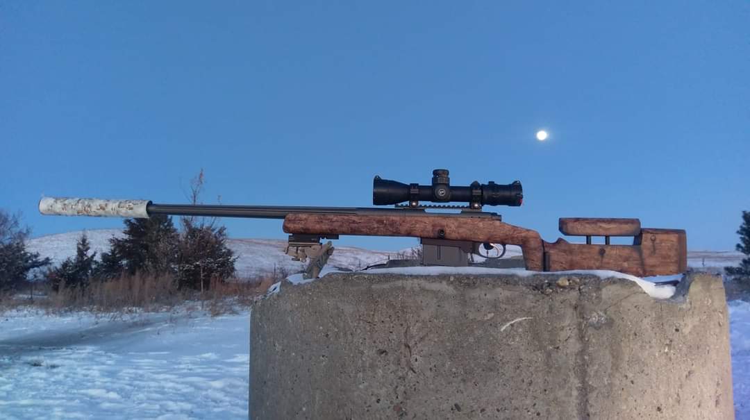

    The first barrel as done at 19" and I actually used it to compete for a year. Ran a solid 1100 rounds at 3100 fps and died mid shooting match.
    Took my SD Mule deer at 485 no problem

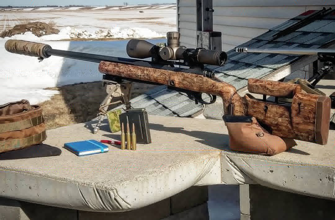

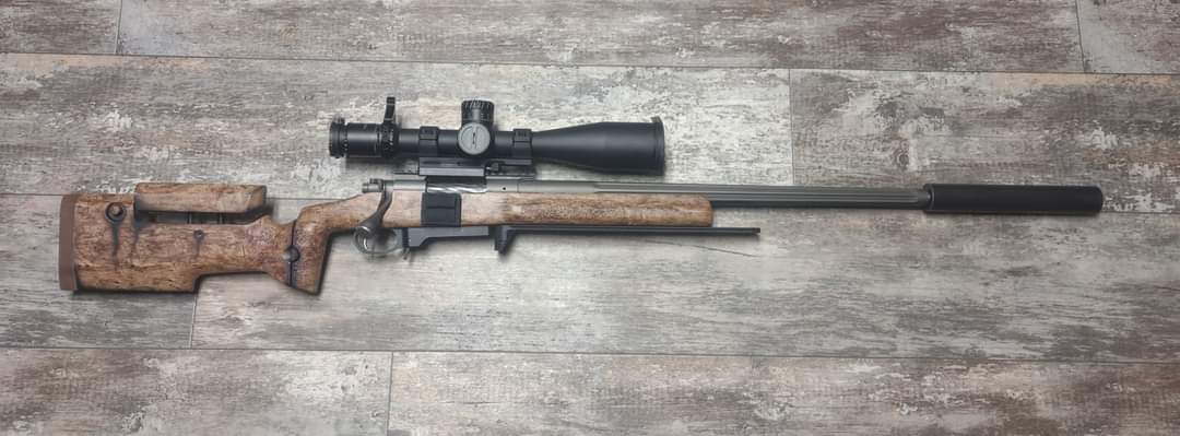

    2nd barrel was 22", swapped glass a few times, and added a Manners.
    This is how it sits today, with the last few rounds of life nearly exhausted.
