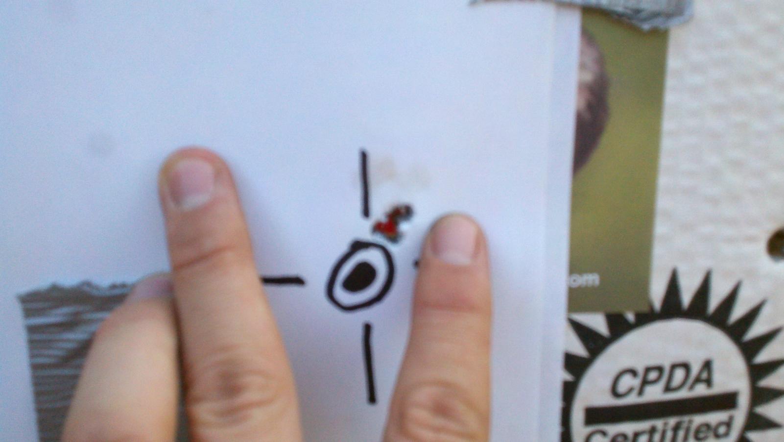

My few comments on the round is it's very accurate and fast. A couple days ago I shot some of the best 200Y groups in my life with it, both .2 MOA, the worst group was .5 moa. Velocity was 3828 fps and is a medium load. Less than a hundred rounds through the rifle so I have lots of testing to do still.
The only thing I'd done different on the rifle is build it with a heavier contour and braked it so I could see my hits better. I tried some 400Y shots yesterday and couldn't see where I was missing so couldn't correct.
