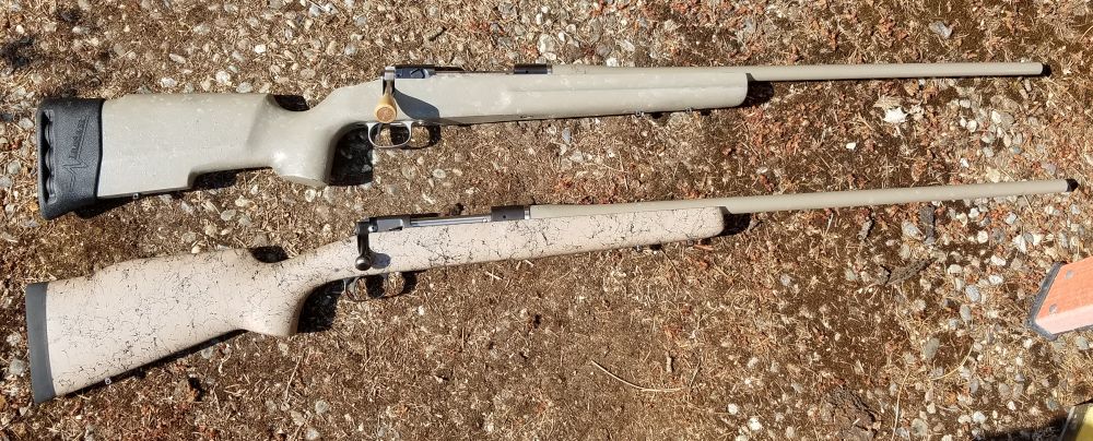

My first long range rifle was a Savage - it shoots well and I still have it. I rechambered/barreled it to 300 PRC a year and a half ago, put in the Accurate Mag bottom metal, and their CIP length mag and it will feed - though not at the seating depth I currently have my Berger 230s set to. I have the HS Precision stock, and I had added the KMW Loggerhead cheek riser to it (Joe Ducos @jducos - amazing work). When I can get out to shoot at a mile'ish, this thing does pretty well. I will never sell it as it holds a place in my heart.
Now, would I ever recommend for someone to build a custom Savage? No.
Why?
- Resale value is limited (if this may come into play)
- Aftermarket parts are nowhere close to the options available for R700s/clones - you can only take a Savage so far
- If you're going to spend the money on all the other parts to custom build, the small amount you'll save on a Savage action vs. others is just not worth it
Now for the closer: I love the 300 PRC. It's a really fun round to shoot. While not disappointed in what my Savage/HS Precision can do, I've gotten past the limit of what I can push it to. I'm having a custom 300 PRC built by Spartan Precision. I'll be getting another barrel spun up for the Savage in a TBD new caliber to play with (thinking 7 SAUM at the moment).
If @Steel head would chime in here (another Savage + other rifles owner), I think he would say something similar.

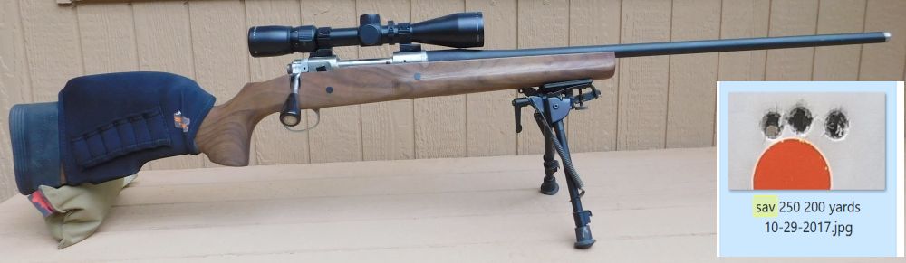

I have built a number of Rem700s and pre 64 Win M70s.
I have only built (4) Savage bolt actions; 223, 250Sav, 280AI, and 300WM.
In all 4 cases I cut a shoulder on the barrel and did not use a barrel nut.
The 223 and 250S shot better than I can. The other two not so much.
There are problems with any action, but I would rather build on R700 and M70 actions because of ; stock availability, magazine feed. and screwy bolt mods. YMMV
  • Sav 110 223 .250 neck LW CM barrel Boyds Tactical stock SSS recoil lug 9-29-2013.jpg
