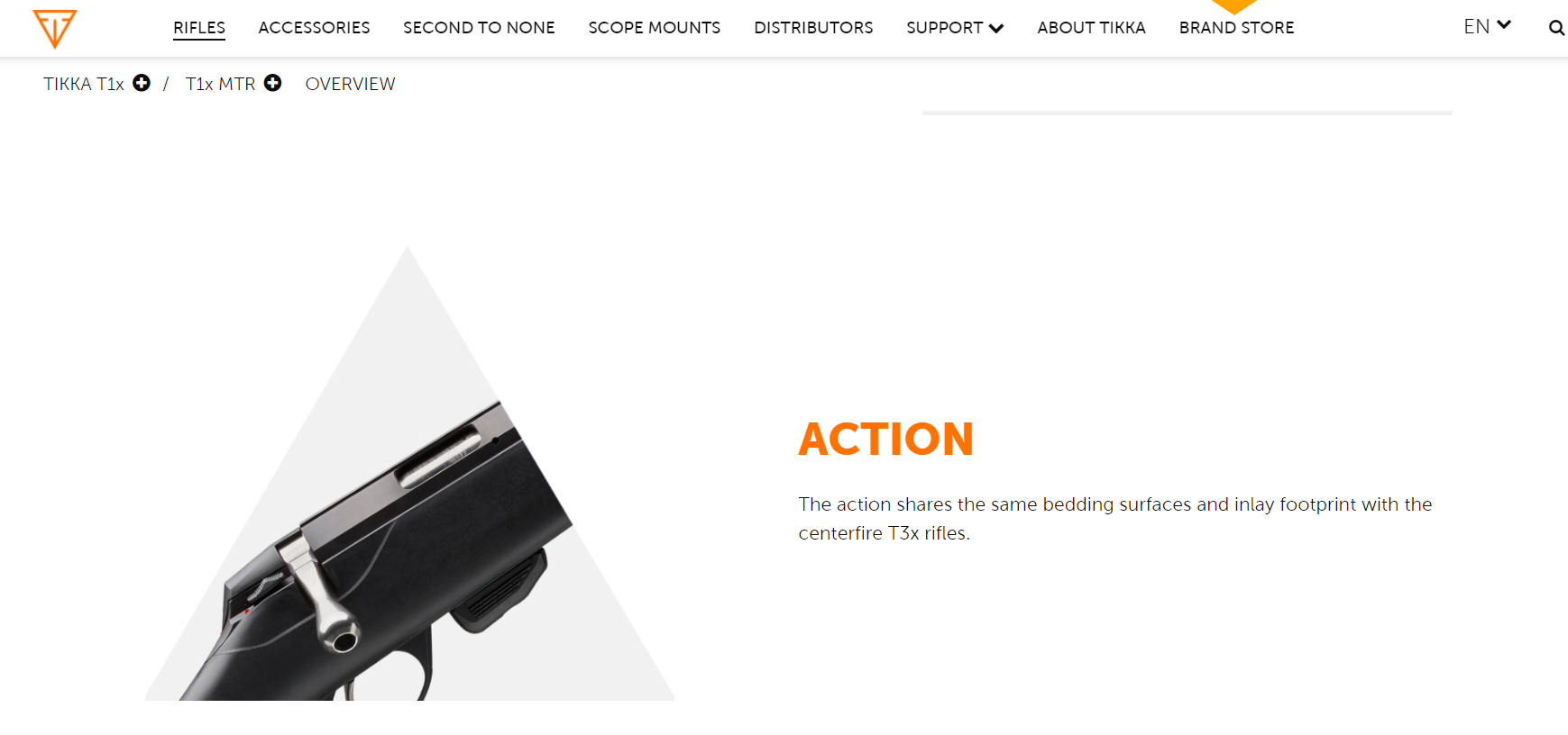

    Just snagged a new T1X in 17HMR and had a question. There doesn't seem to be many custom stocks out there for Tikka's rimfire rifles. The Tikka website site shows what is in the picture. If I were to order a Manners or something else with the T3X inlet, would it be good to go for a T1X?

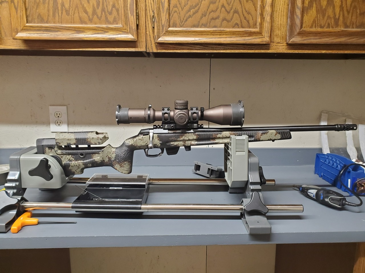

    The inlet is nearly the same. Below is a mcmillan game warden I took off a t3x and put on my 17. Only modification I had to make was extending the bolt stop cut, the bolt stop on the t1x is much further forward. The top of the inlet is identical, as is the bottom metal to the plastic tikka mag bottom metal. Where I can see you having problems is the mag well area on some stocks. It needs to be able to fit the fixed t1x mag well.
