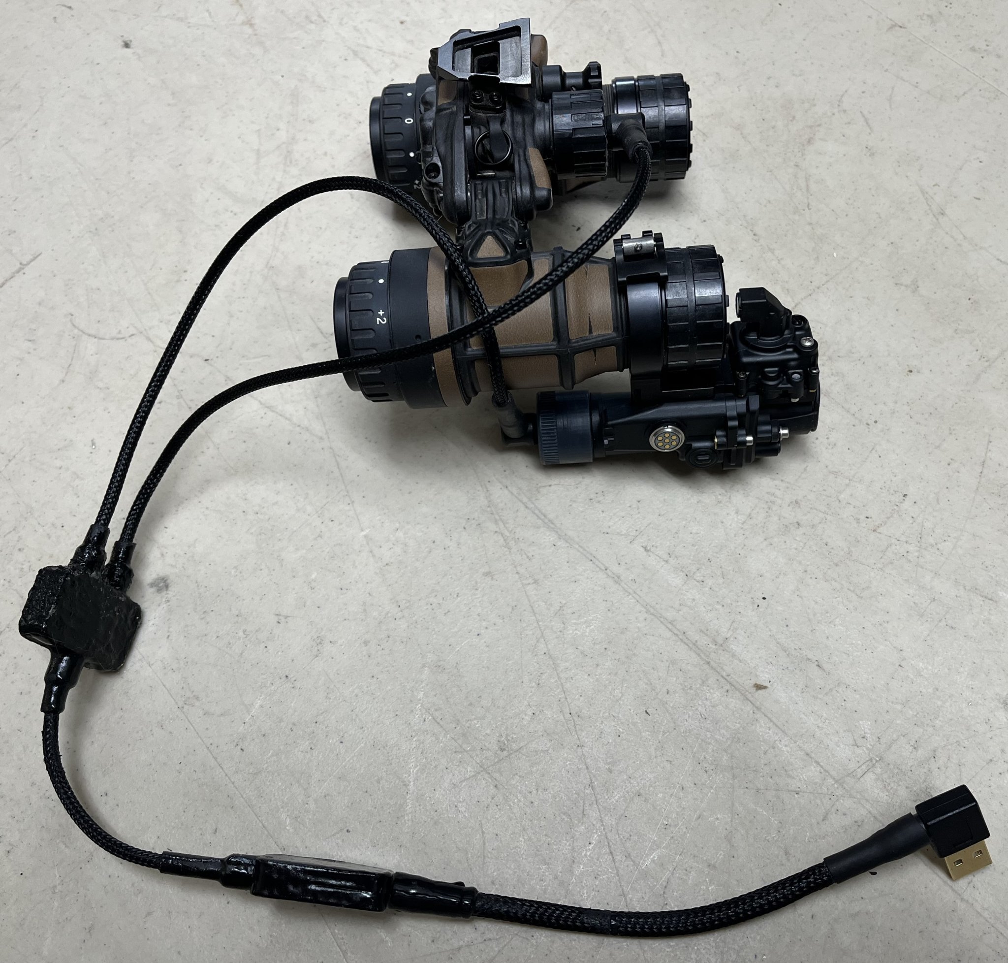

    With the success of the COTI USB Battery Adapter (CUBA), we are adding options for other systems. The CUBA distribution will continue to be handled by SOK, and I will deliver the one-off custom solutions for other systems. Currently, we can supply a cap and battery adapter for CR123A systems to include the Trijicon IR Patrol series, Skeet (units without the USB port), and DTNVG and DTNVS goggles. A splitter cable system for combining the DTNV- and COTI or IR Patrol/Skeet is also available. We intend to support goggles with a Fischer or Lemo port as well. AA battery systems can also be created, if desired.
    As additional systems some online I'll make a post here. If you have a system for which you'd like to get a USB battery adapter made up, please send me a PM and we'll see what we can do for you.

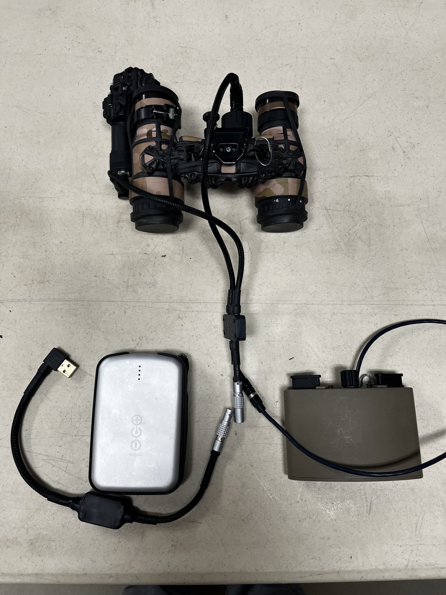

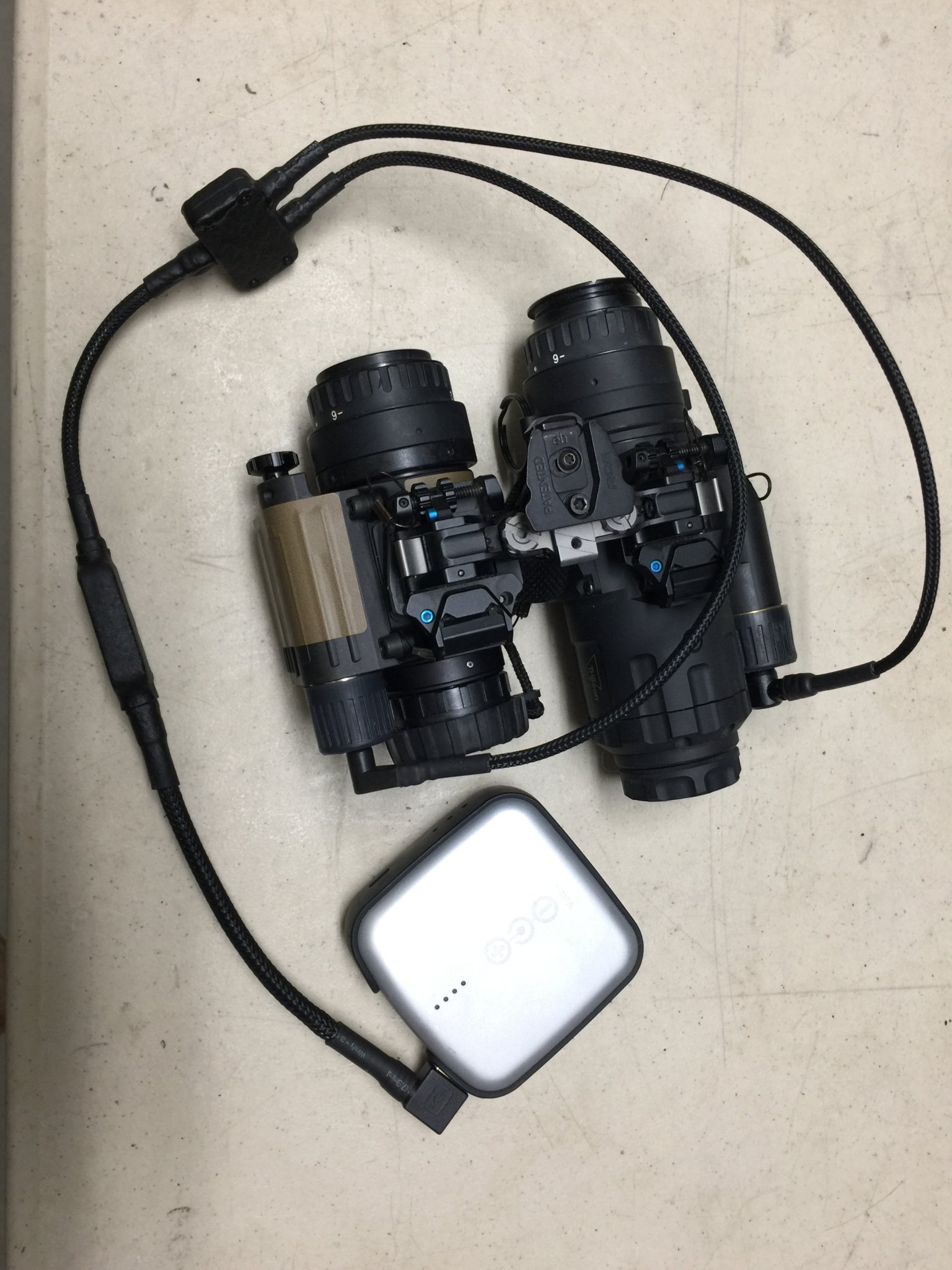

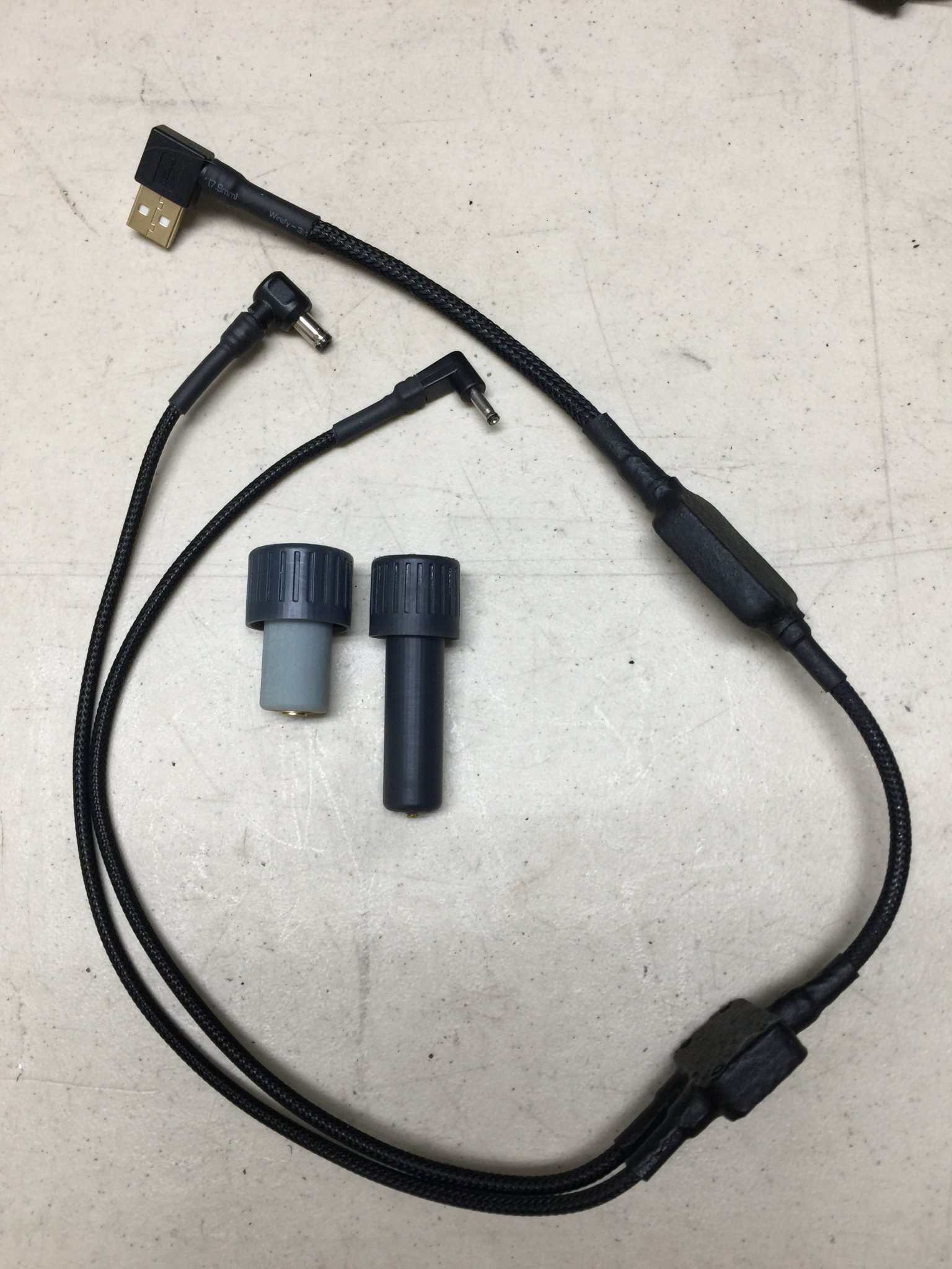

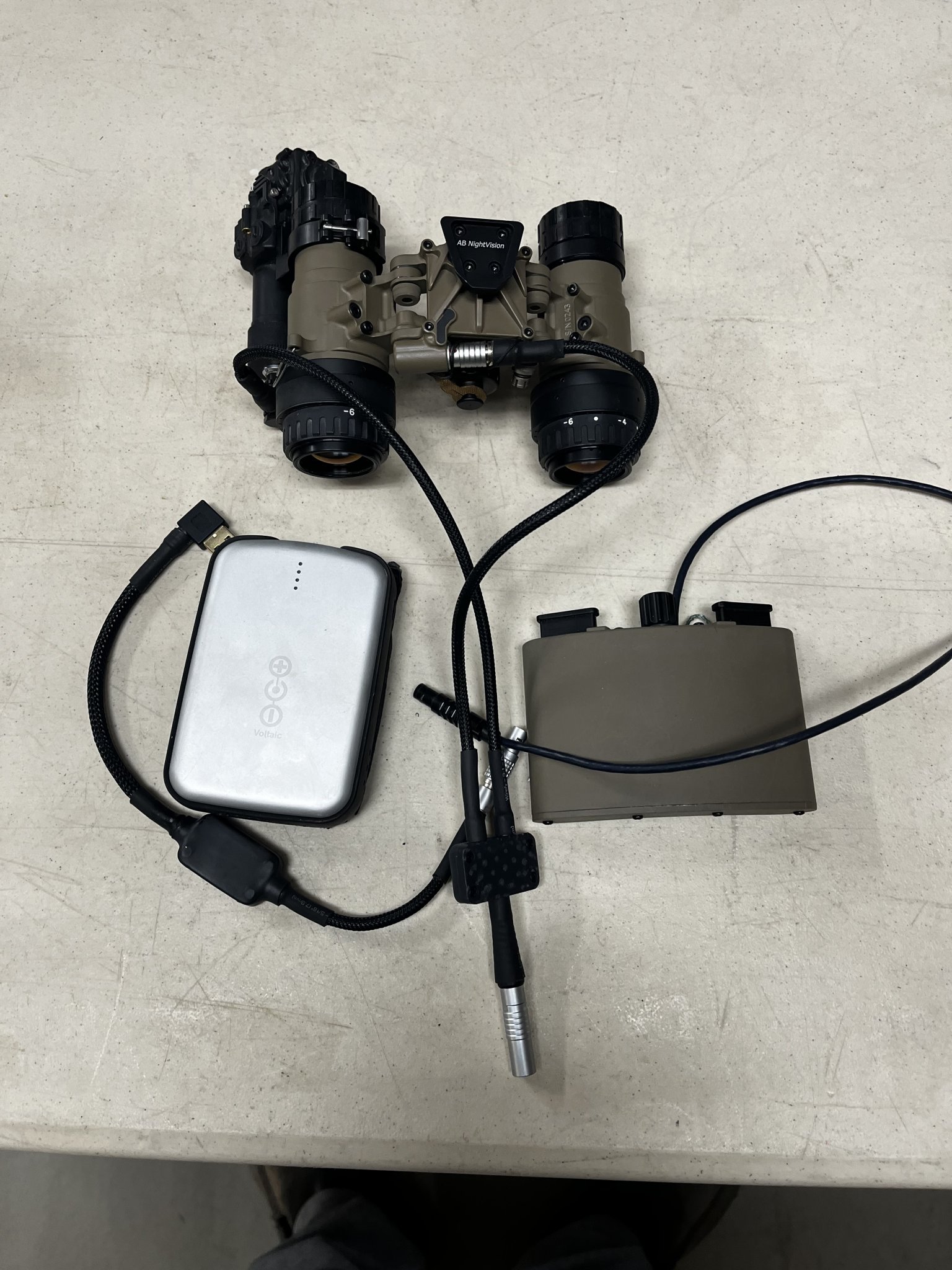

    Second dual cable system testing before delivery. Using FlexSeal on the splitter and regulator box, seems to be an improvement on adhesive heat shrink. No really good way to apply that on the splitter assembly.
    If you can do a cable that will allow both a TracIR/Raptar and external power to Trij/Oasys thermal, you will be the next Sith Lord.
    Well, I’d need a starting point. If I had a base set of cables that need to be combined we’d be able to figure out if it’s possible. Main challenge would be proprietary connectors. I’ll look into it.

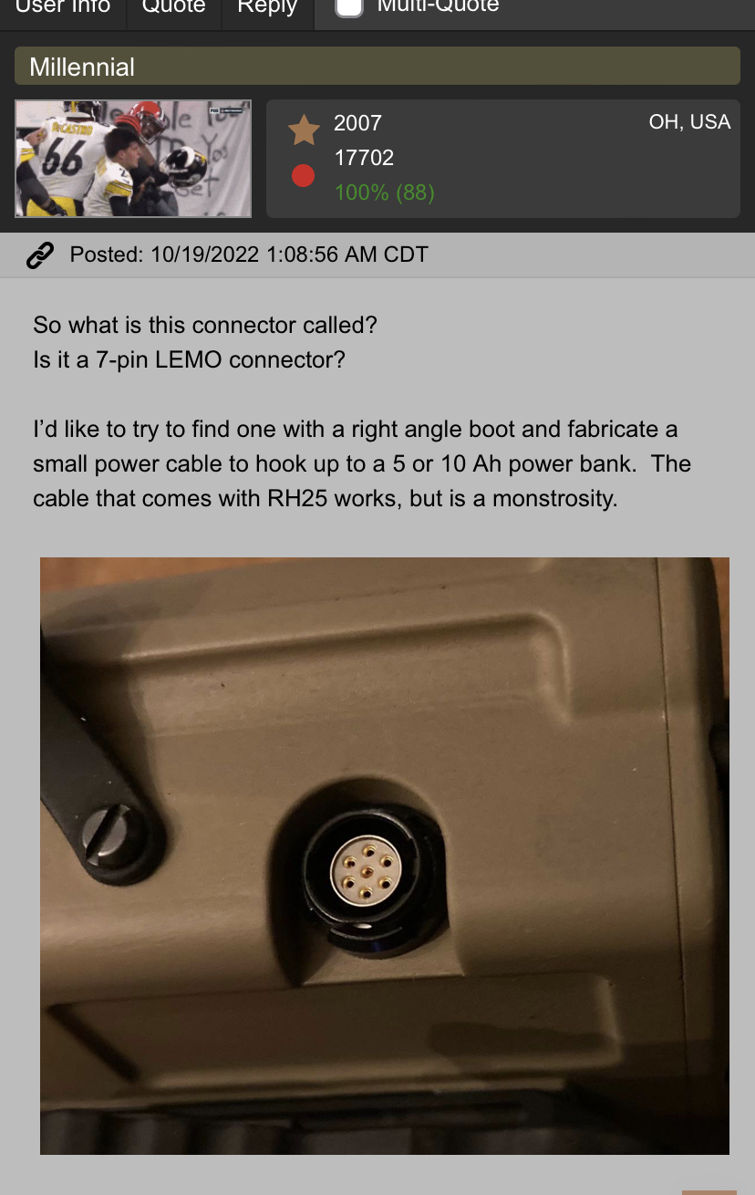

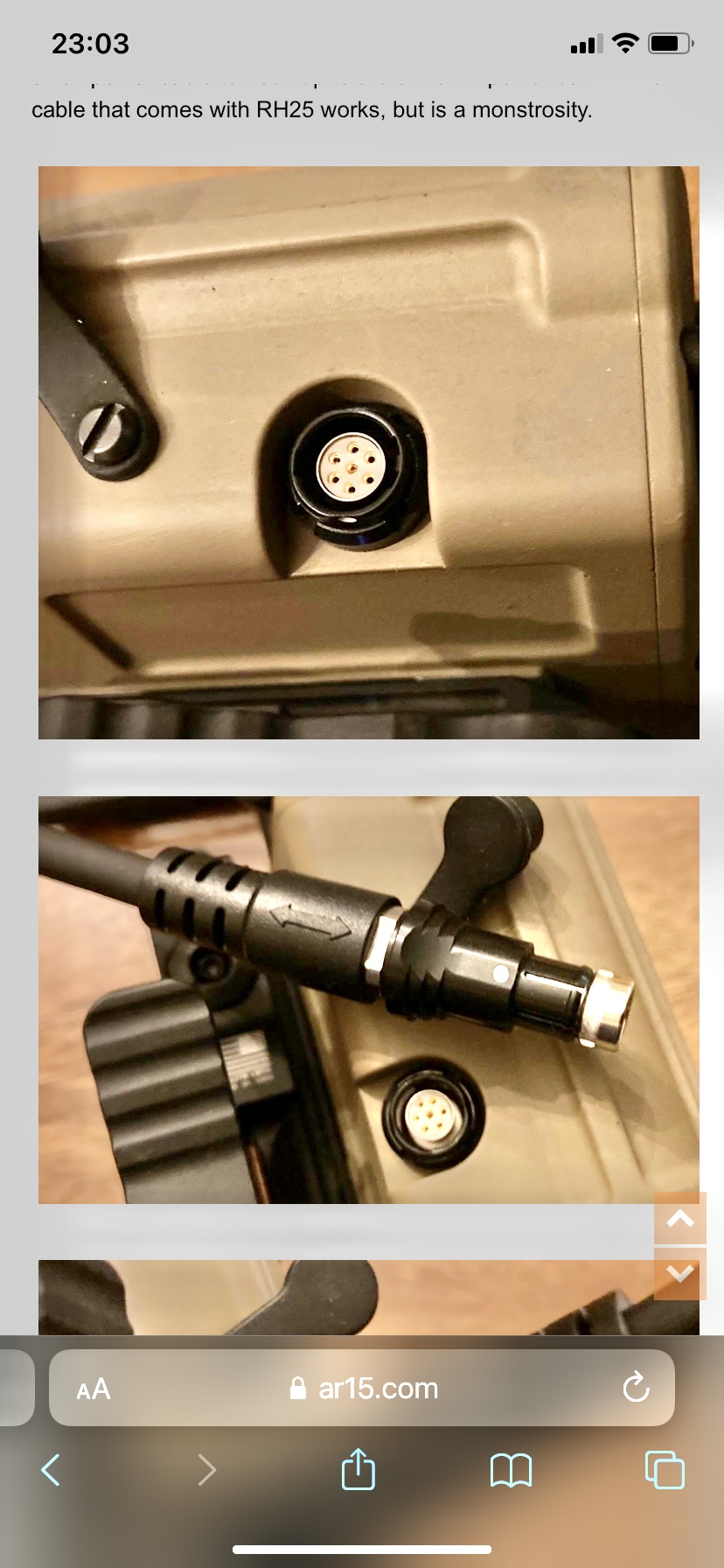

    How about the RH25 thermal? I’ll attach photos

    Since the RH25 already has a cable, what would we make for it? Might be a right angle option, but is that worth the expense for anyone? Those RA Fischer connector run about $50 cost, so it would turn out to be a pretty expensive solution to a minimal problem.
    Well the cable it comes with is 6ft long and has an additional connector for some type of video out. It’s not really meant for helmet use.
    I’m interested in having mine spliced potentially to eliminate the video cable and shorten the length. 90 degree would also be necessary in my opinion.

    Ahh, no plain cable available then. I'd need to borrow one of the factory cables for a few days to confirm pinout and connector type. It appears to be a Fischer, but there are other push-pull types out there. Most of them are available in right angle, cable exit would be towards the white dot. Let me know if you want to pursue this, should be simple enough, though it might take a week or two to get connectors.

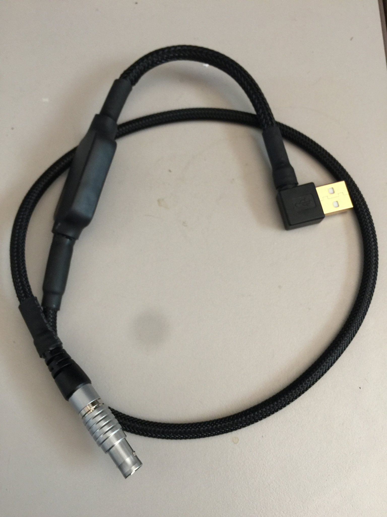

    Thanks @CoryT for taking my Iray RH25 factory 6ft cable and turning it in to something far more useable.
    His pricing is incredibly fair given the time it takes to do these cables and cost of materials.
    The cable is so well made it looks as good, if not better, than a factory cable.

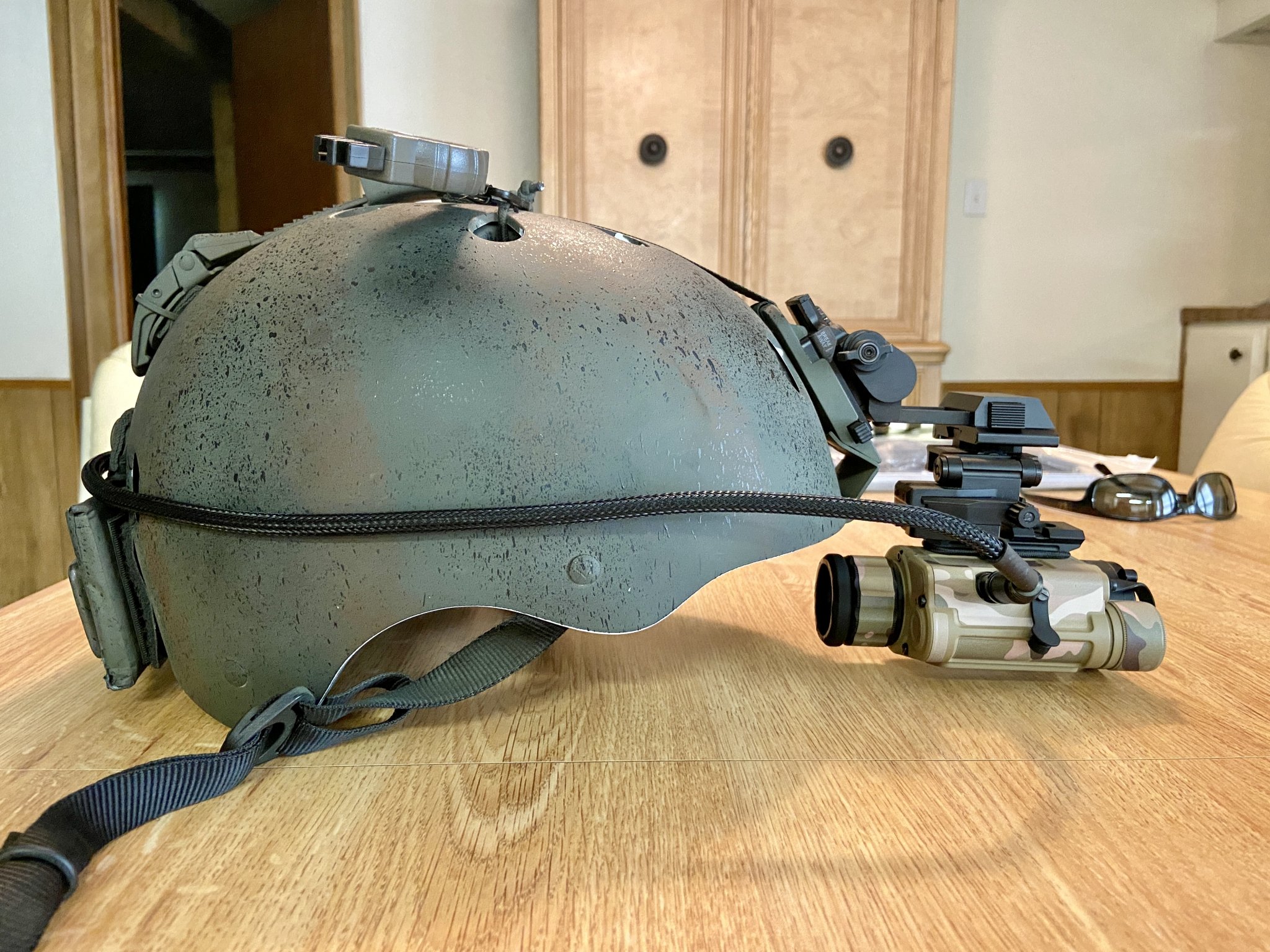

    The CNVD-T uses a threaded cap, so easy to print one. The LTWS would require modification of the factory lid, or replication of one and remove/replace. Either is doable, I'd need a unit in hand to create the parts.

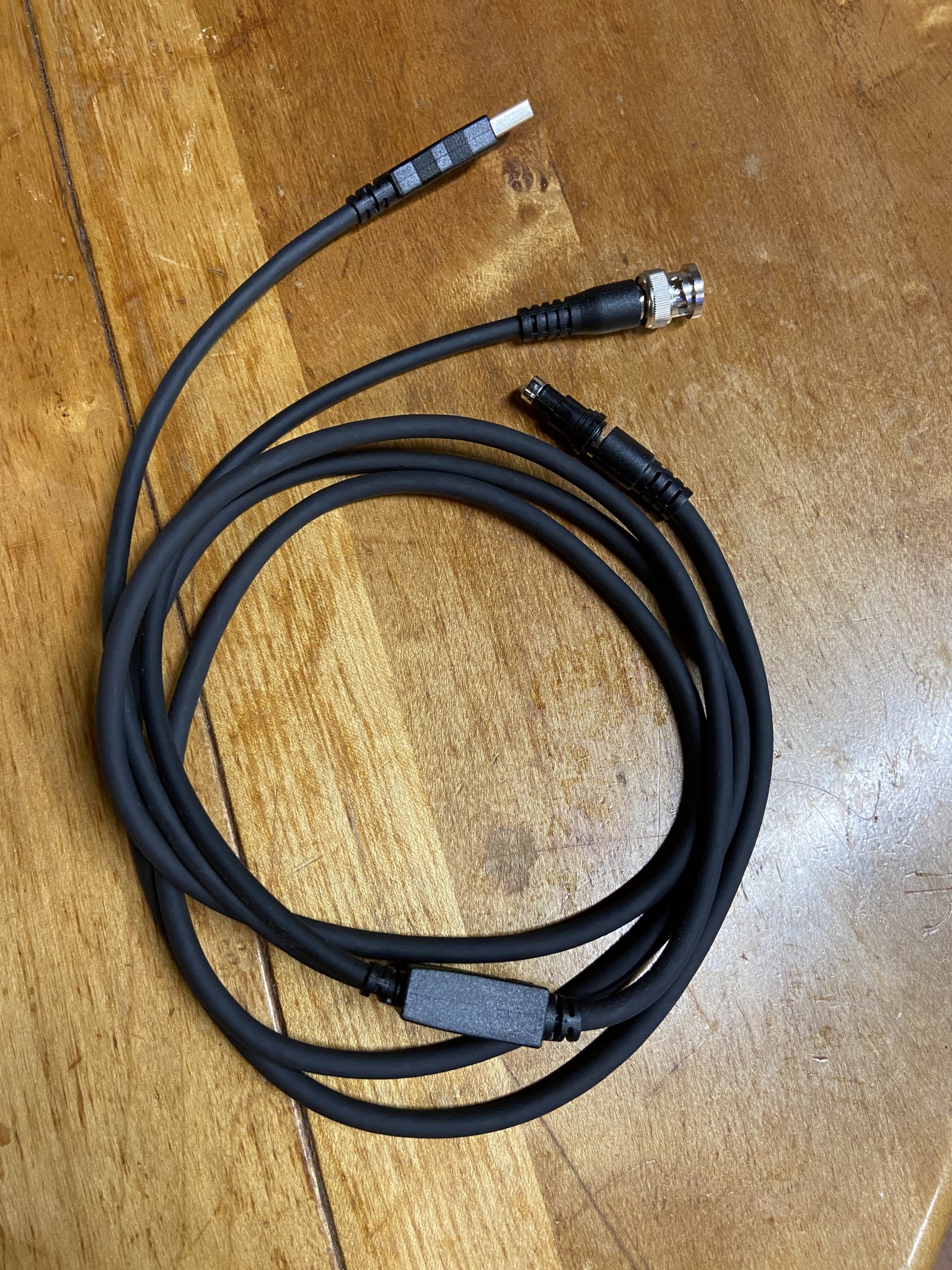

    I’m looking for a battery cable for my MH25. It is essentially a 180 degree USB-C cable, need it for helmet mounted use. What would it take to get that made?
    If it is not a splitter combined with some other cable, you just use a commercial USB C cable with the ends you want. Somthing like this would normally work.
