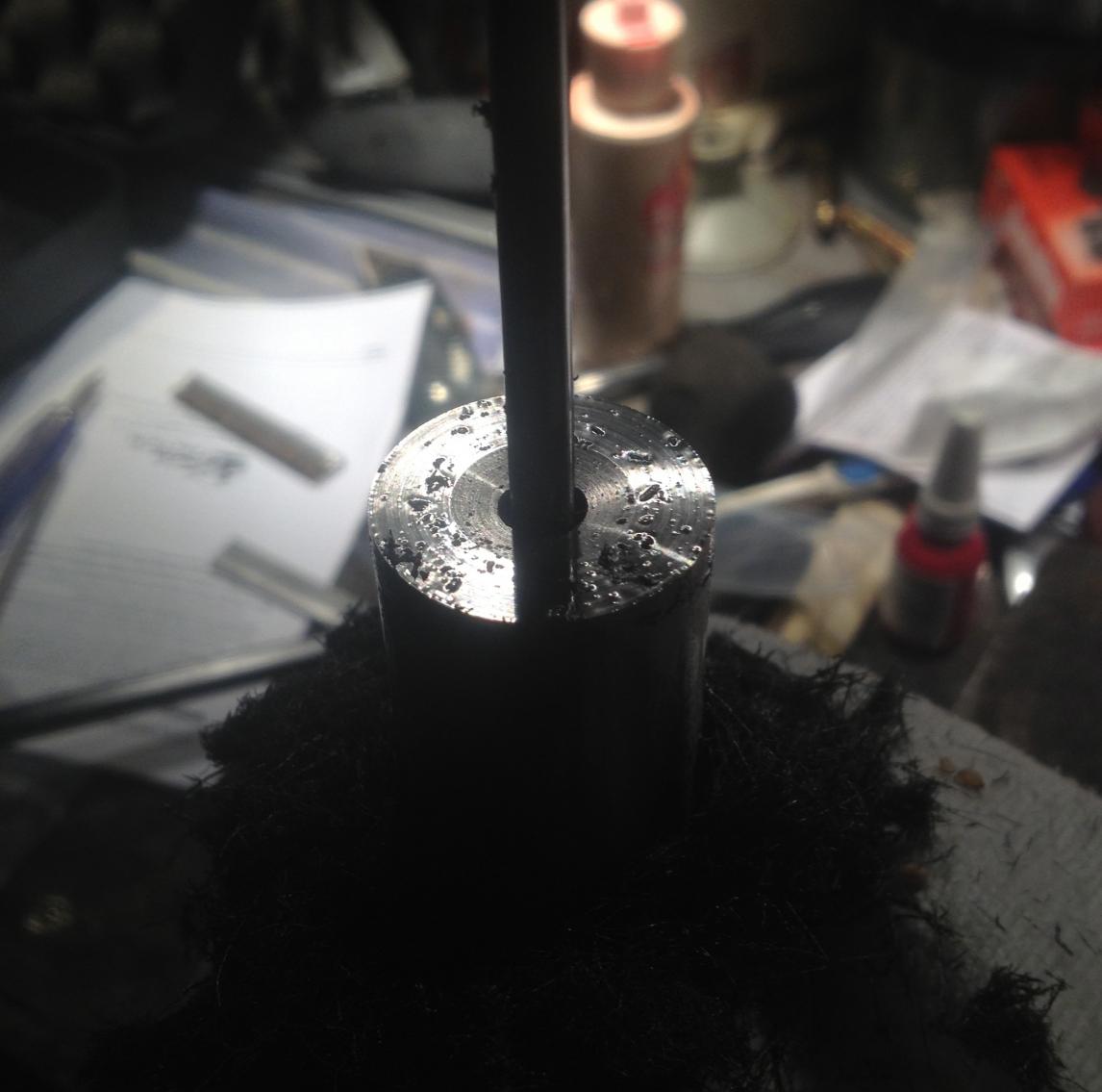

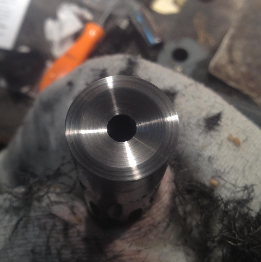

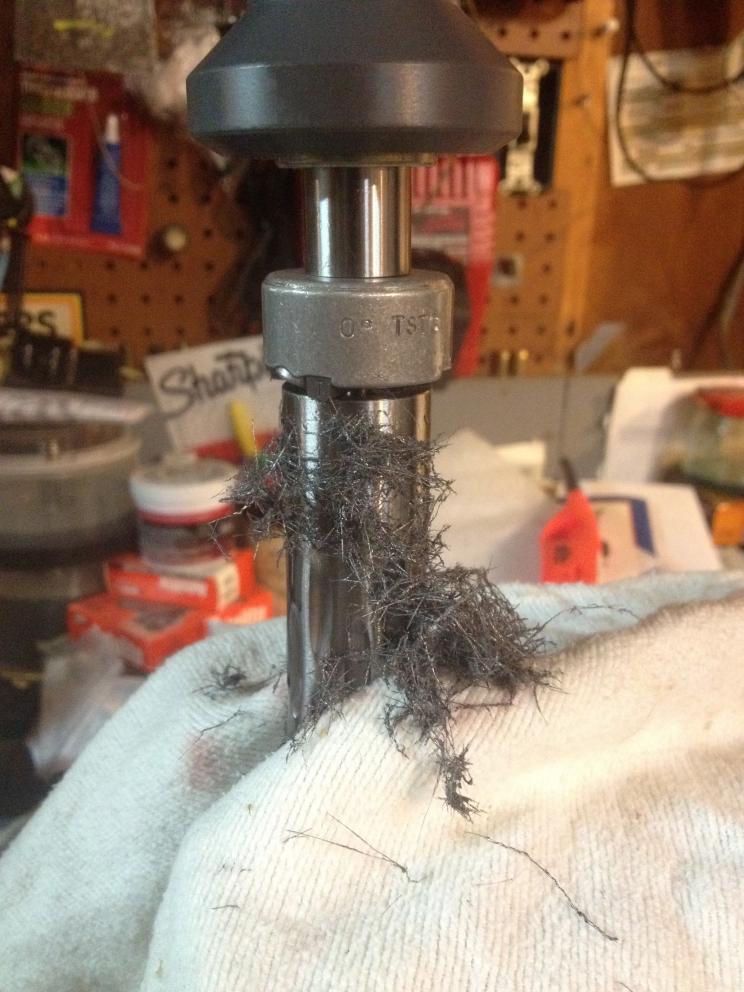

I was having issues with my 6.5-08 Imp. and was suspicious of the crown. I talked to the smith that did the barrel work for me and he assured me that it was done to standards. Regardless of what he was telling me I wasn't satisfied. I did a little research and called and spoke to Mr. Manson. He was very helpful. The process is pretty straight forward. It does a great job. I don't think that there is a gunsmith around here that can cut a crown with a lathe as nice as I can with the Manson tool.

The re-crowning job didn't fix the problem entirely, but it did remove a variable from the equation. The main problem turned out to be that I had my head up my ass when it came to powder choice for that particular rifle. I should have taken a before and after pic of the crown. The difference between the two is obvious when you look close. The crown my smith did didn't look horrible, just not as good as I thought it should - or does now.
As a control, so to speak, I had my smith chamber and thread a new barrel blank for my 308. I instructed him to leave the muzzle alone. After he was done with his part I cut the crown. I did it in a similar fashion to the pic's above except that I went deeper with the radius cutter, taking the outer edge of the radius cut out to the OD of the barrel. This was for esthetic reasons only. I couldn't be happier with the way it turned out, or the way it shoots.
As a final step I place some folded patches under the cutter bits and dab a little Fitz on the muzzle face. I can give it a little polish without effecting the edge at the bore. I want that edge to be razor sharp.
