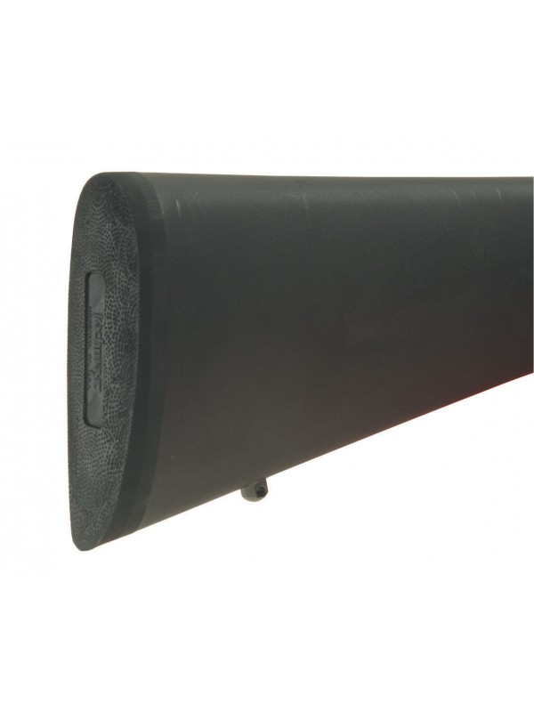

This would take you down 1/2".
1/2" Recoil Pad
