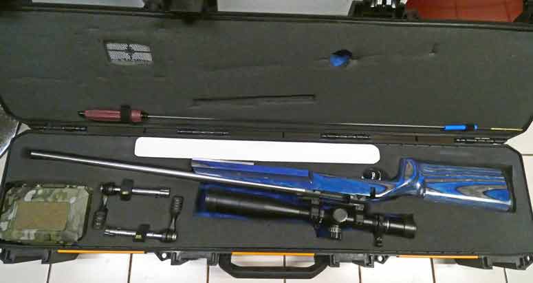

I use a soft case now and my rifle is pretty solid but I feel bad when something gets piled on it in the truck. Also I lost a magazine last week because I didn't have a dedicated place to keep them so this should help me keep better track.
Plus they look pretty cool which counts for a lot. I plan for the gun to be flipped over with the second sheet of foam cut out for the stock and maybe a little for the mags.
