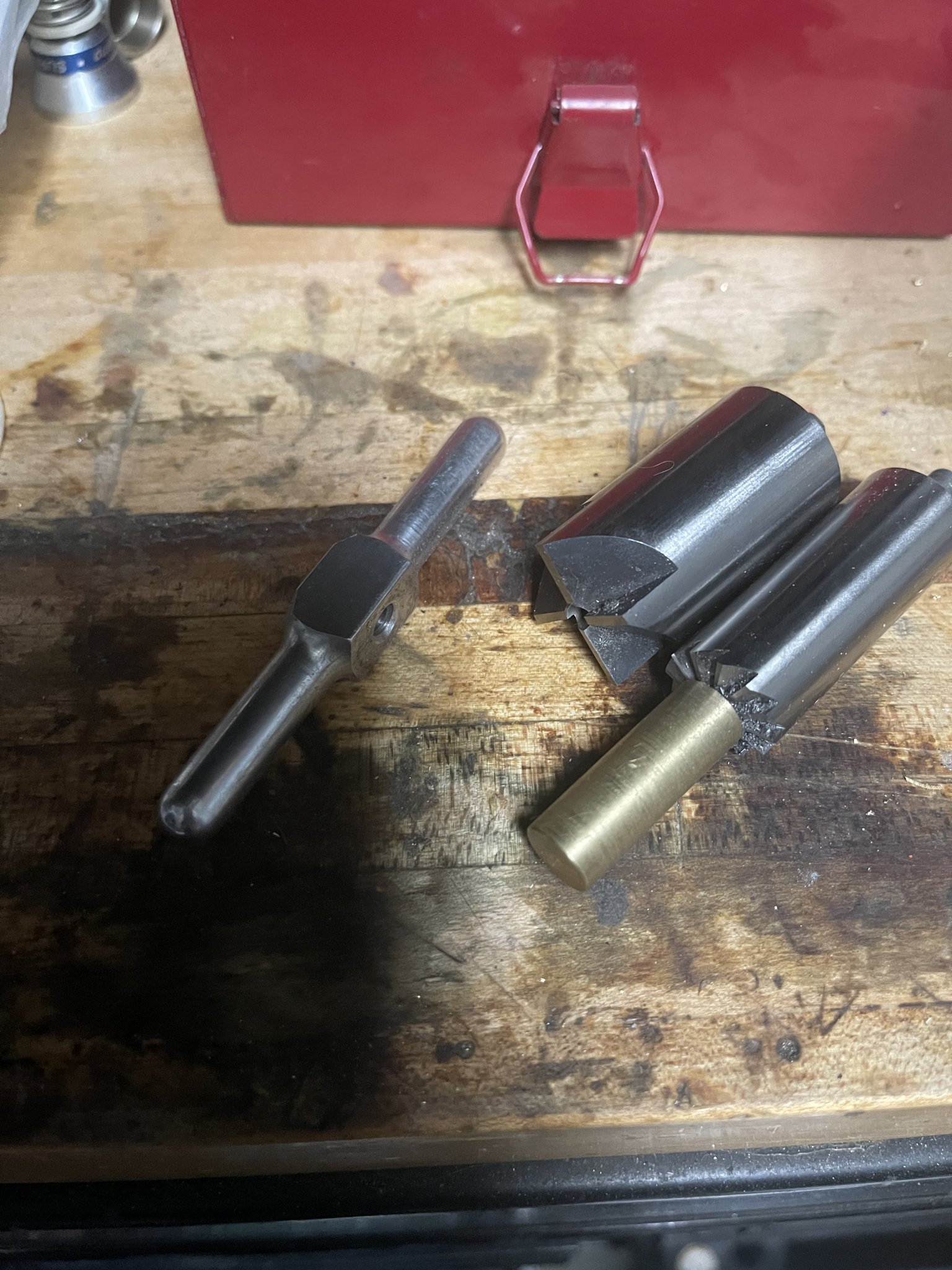

I’ve done a bunch with a hacksaw and the Brownells facing/crowning cutters. They work awesome.

I've purchased a number of used rifles that benefited from a quick touch-up of the crown. Sometimes, a marble with a dab of lapping compound is all it takes to address the problem, but if one encounters this on a regular basis and doesn't have easy access to a lathe, then a piloted cutter would be a completely reasonable purchase and well worth the money. I'd really prefer to use that on a barrel that was cut reasonably square, but if one had the patience and tolerance for a bit of tool wear, it'd work fine in conjunction with a number of different barrel cutting methods.
