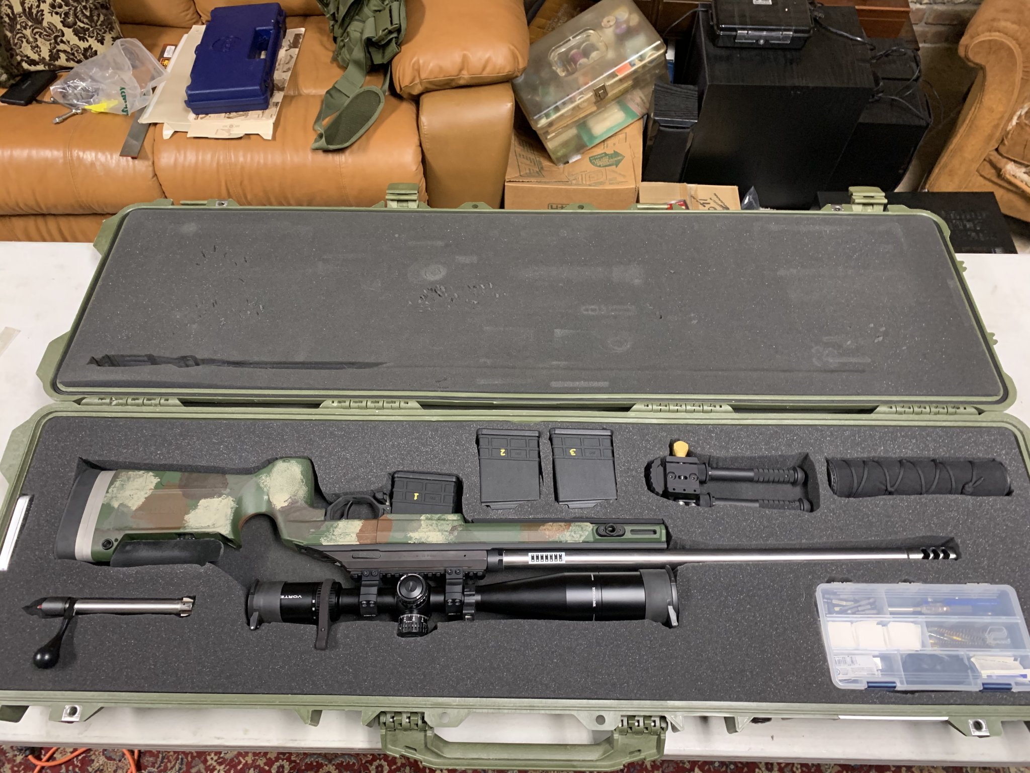

    I recently cut my cases foam with a pocket knife. Left it with pretty jagged cuts. What is the best tool to use to cut out foam to fit your rifle and gear snuggly in the case?
