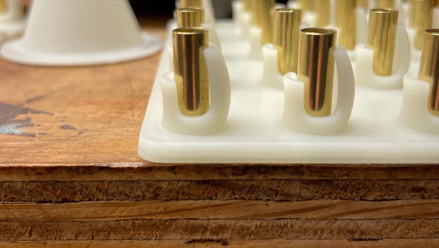

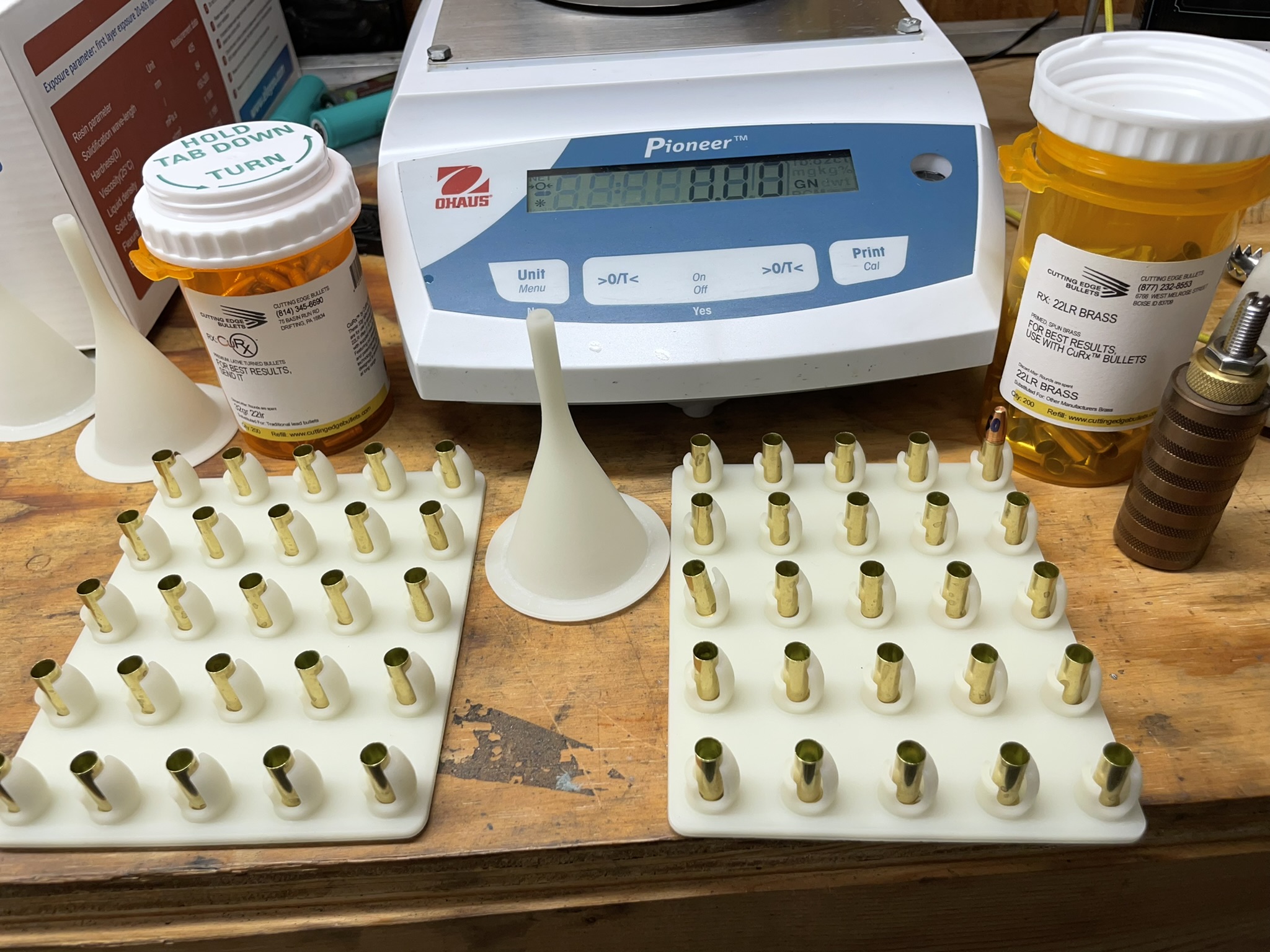

For those loading the Cutting Edge CuRx rimfire ammo. None of my standard reloading tray held the small cases safely and I've seen some comments that the CE tray isn't much better, so I've designed a tray that actually holds the cases securely and makes it easier to load the small cases.
I've also got a powder funnel that fits the case perfectly. PM me if you want to buy one, or more as it saves on shipping. Not trying to make a profit as much as trying to cover the costs and get some feedback from other users. They may be a different color that what's in these pictures.
I've had some outstanding results with the 32gr projectile and Viht N350 so I'll probably keep using them but I had to improve the loading operations significantly.
Here's a video showing how well it holds the cases. There is NO POWDER obviously in the cases. It will not stop you from shaking powder out.
