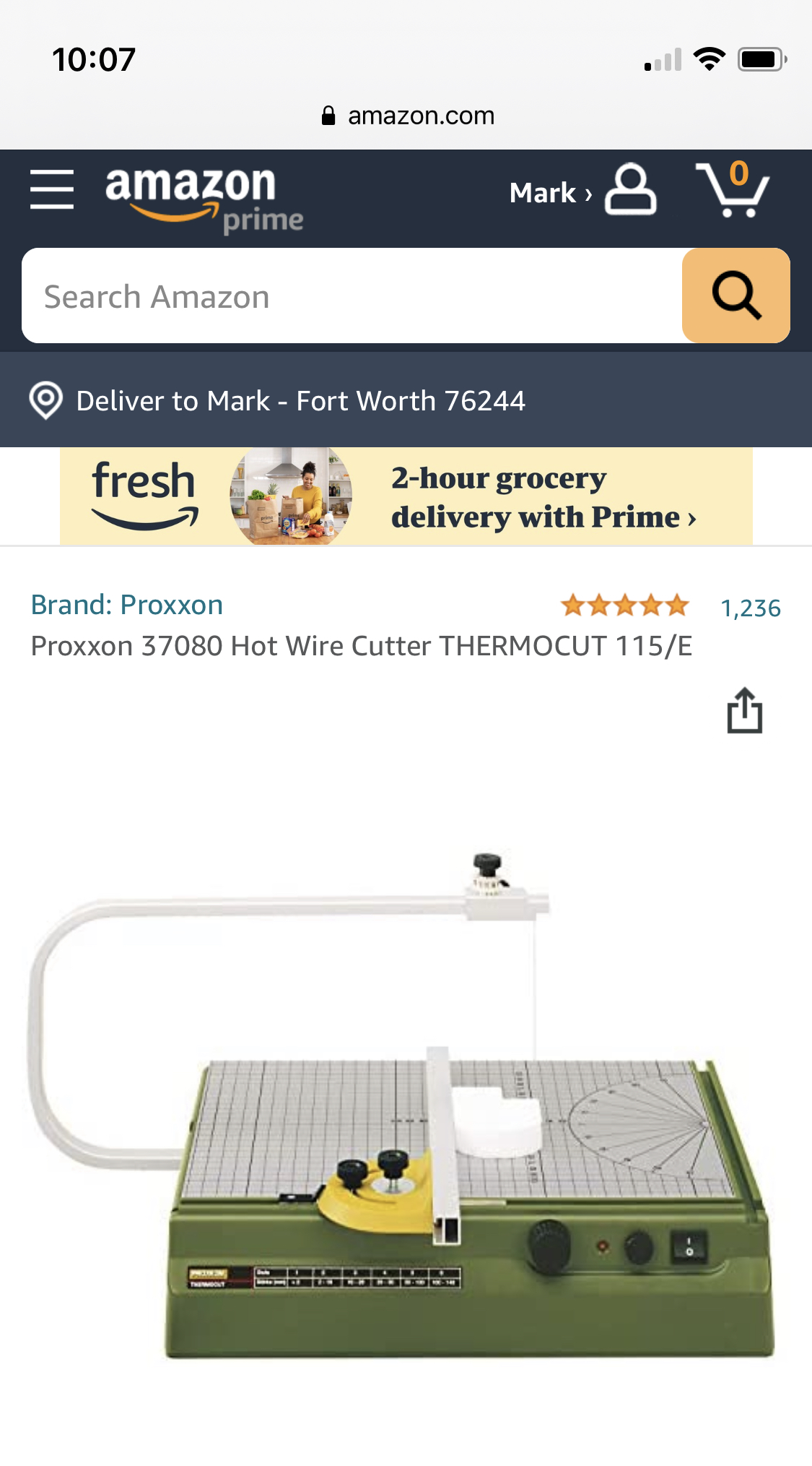

Hot wire cutter
I made one of these and it works great. Trace your gun or whatever on poster board paper then cut those out and run the hot wire against them for a template.
The arm on mine is a little short, as in I'm limited to like a foot and a half off the edge of the foam for cuts, so I end up having to flip stuff around more than I'd like, but still makes way cleaner cuts than a fillet knife or box knife.

yes, for long straight cuts, a bigger version works better. for kaizen layered foam, it is easier to cut to a certain depth.

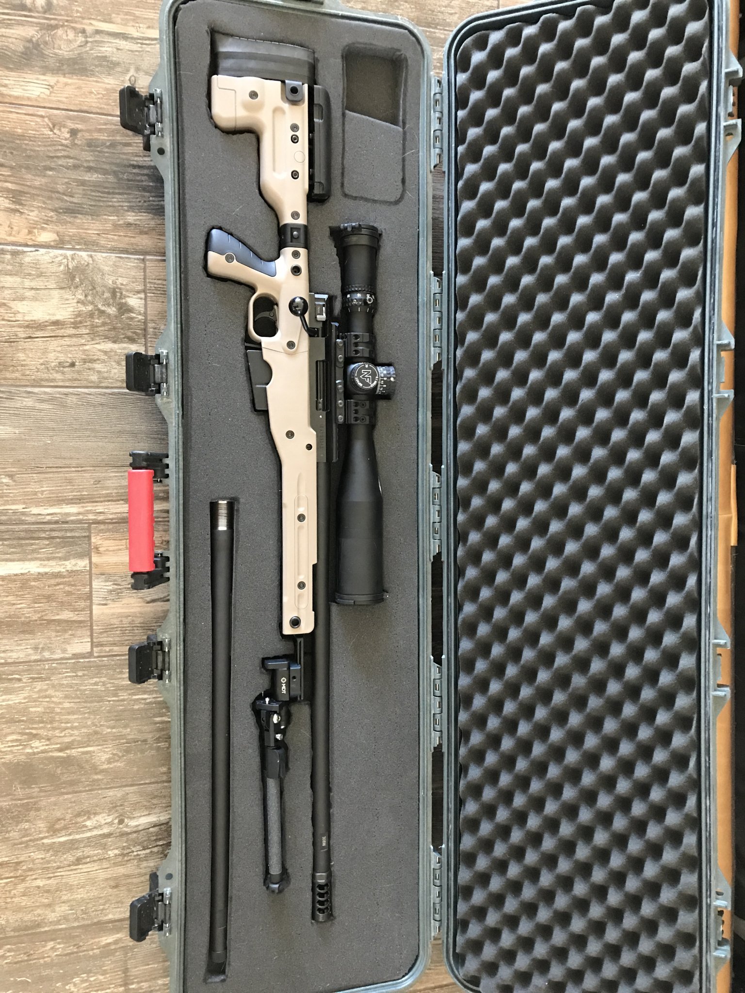

I use a fillet knife. But I cut my case to protect the rifle. Not to enter a dick measuring contest

This what what I use. I trace the cutouts on a piece of cardboard, then cut it out for a template. I have a large needle to poke the wire through in the perfect spot. I can then split the cut out piece for the bottom and it fits perfectly. I suggest closed cell foam. It doesn’t absorb moisture, cuts better, holds up better and looks great! I use 3M adhesive to glue everything in. I’m sure their are lots of ways. This is just mine. I hope it is helpful.
