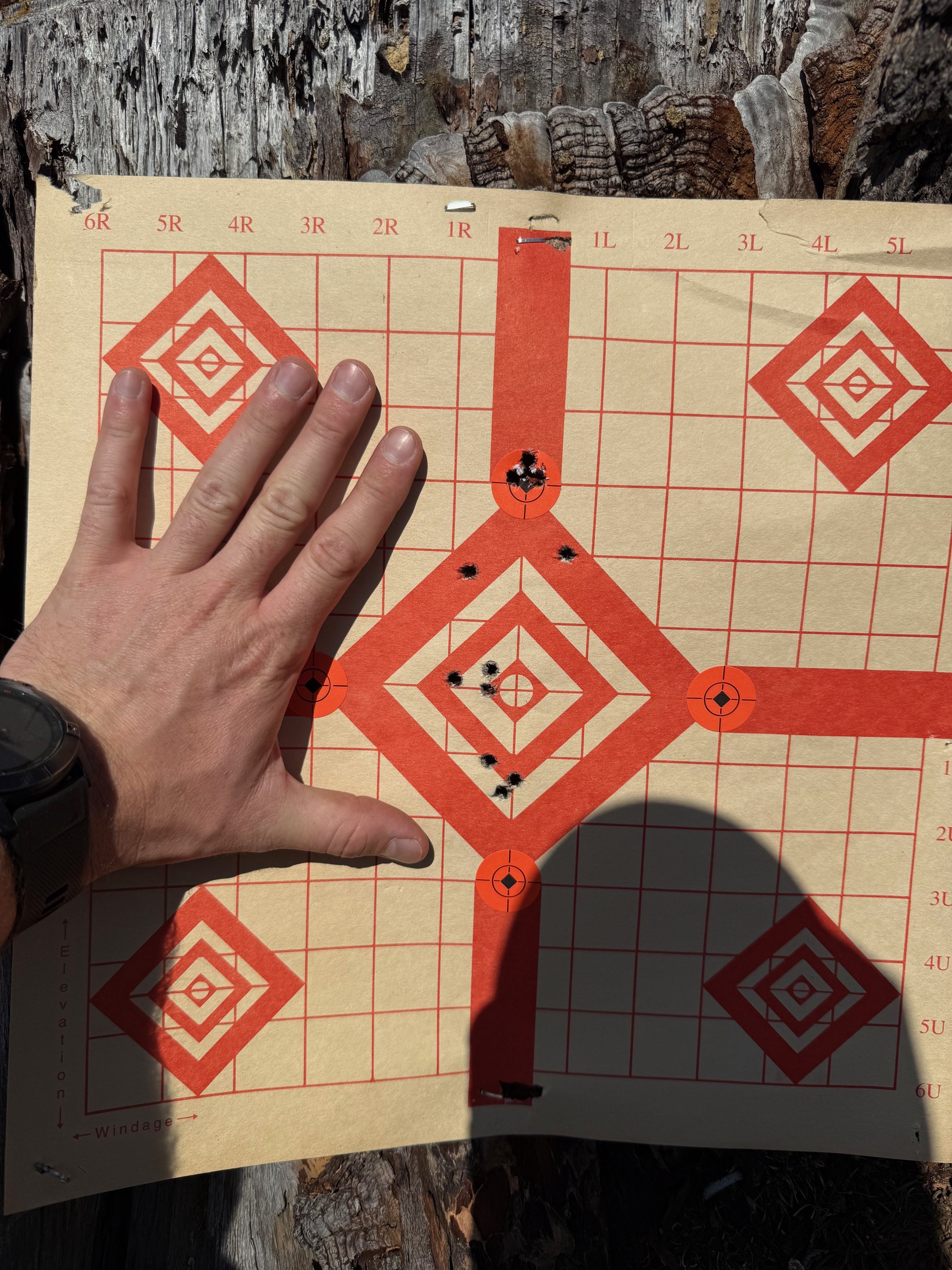

Finally put a 4 round group through the CVA Cascade and got a picture of the group. Why not 5 round?... we all know why lol)

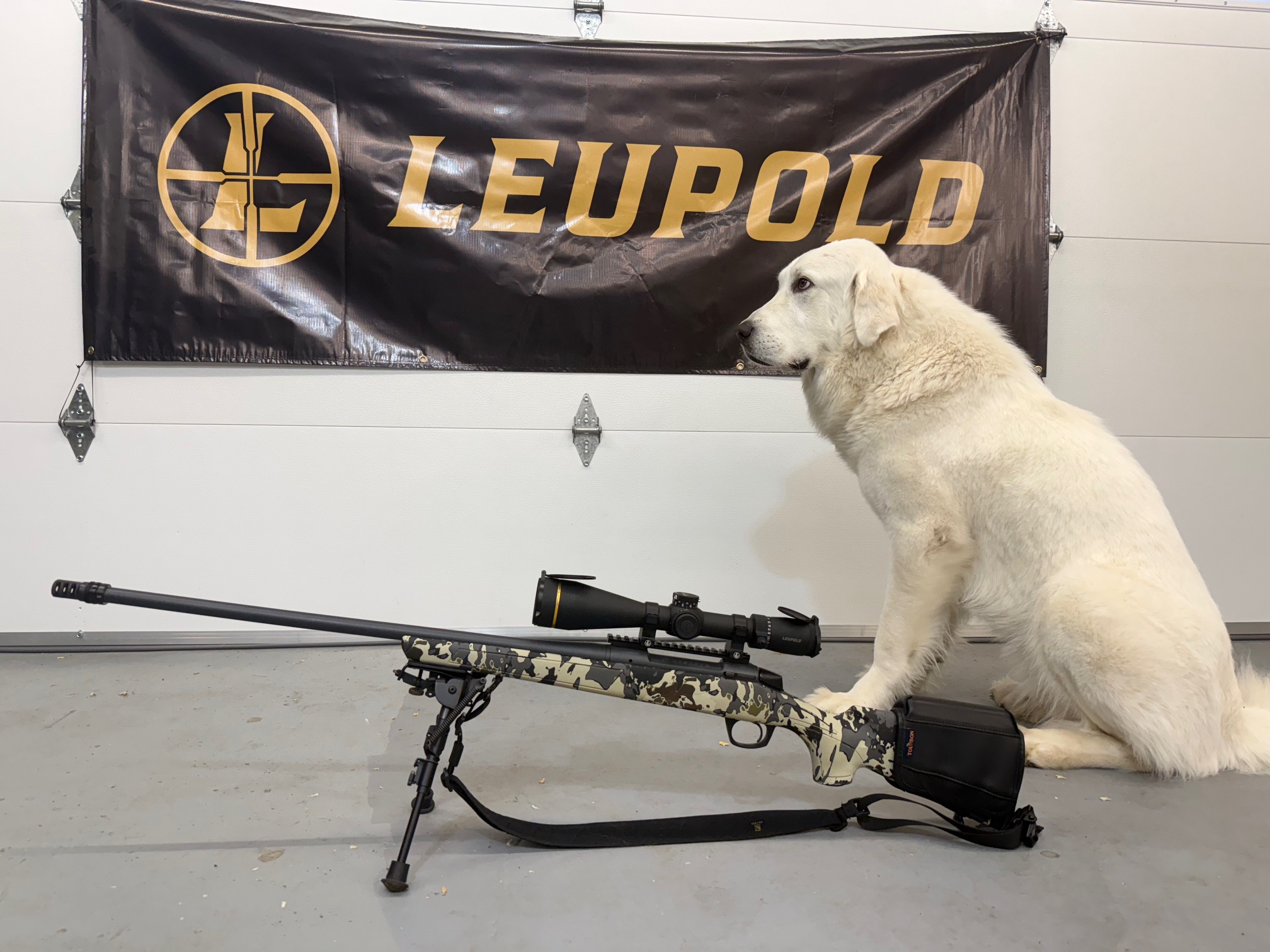

CVA Cascade 6.5 PRC
Leupold Gen.2 VX-5HD 3-15x illuminated firedot
Hornady Brass
Winchester WLR primers
57.1gn Vihtavuori N560
156gn Berger Elite Hunter
BTO=2.263"
2901 fps avg.

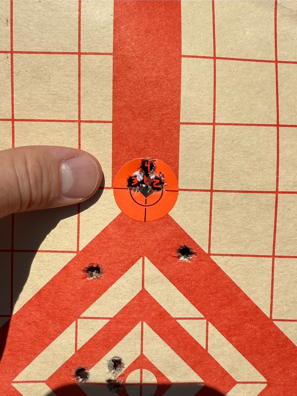

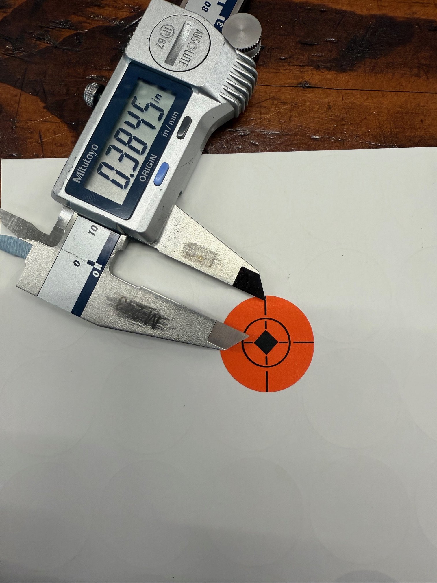

Failed to bring the target home before trashing it so all I have is a relative measurement for the group size.

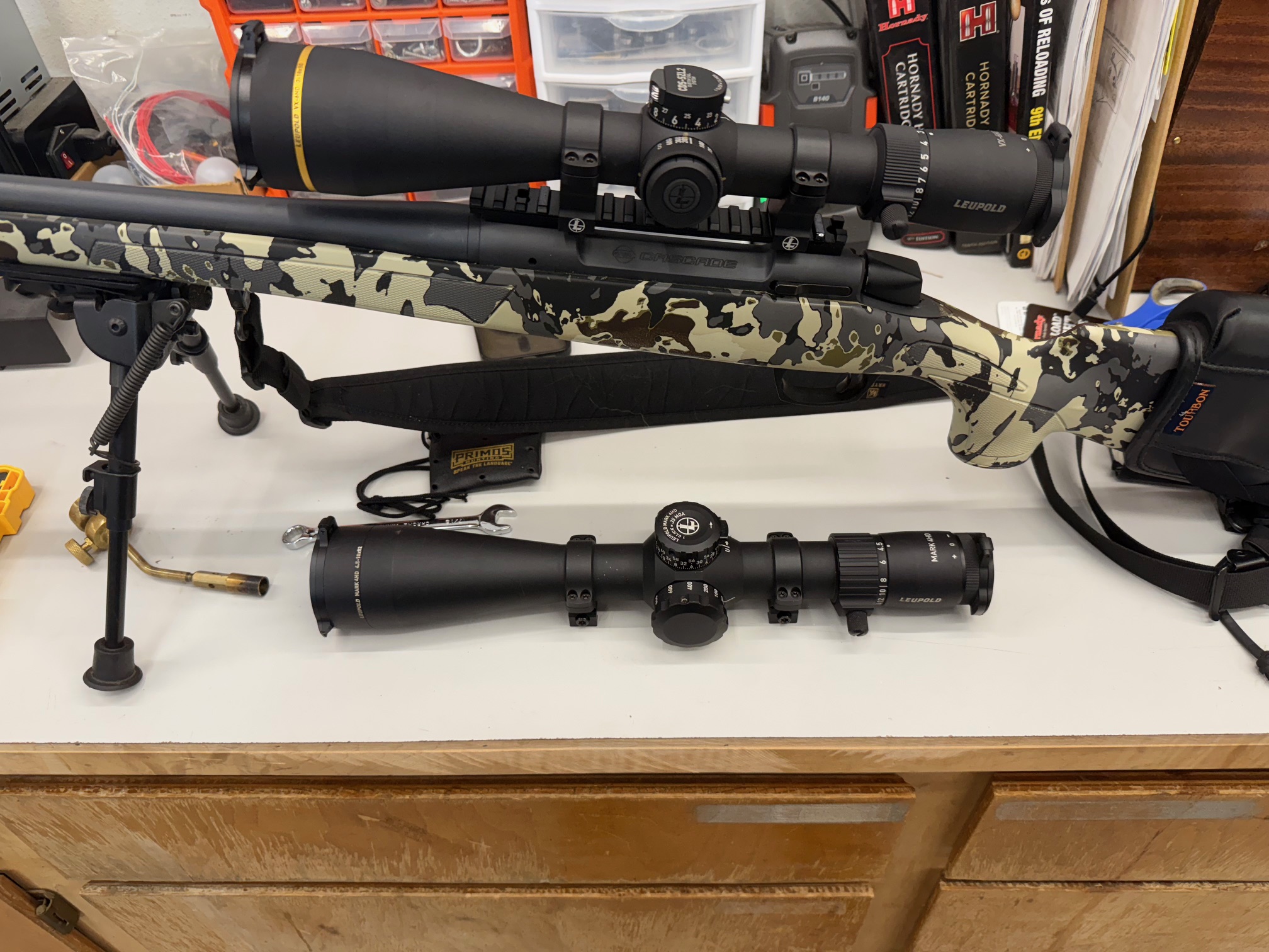

Going into this I know I needed to re-zero because I just put this scope on this particular rifle. Use to have the Mark 4 Hd 4.5-18 on top with illuminated reticle but it felt too busy for hunting and didn't have the low end I wanted
first group(very bottom): center POA, dialed up 6 clicks after, slipped zero with tool less speed set dial
second group(next group up): center POA, dialed down 1, slipped zero again with tool less speed set dial
windage confirmation before adjust shot: aiming top center of larger white diamond, dialed back up one click and slipped zero again. dialed 12 clicks right (double what I thought necessary, I like to "unload" erector system for my final adjustment (read as: make last correction leftward rather than load the system by making last correction rightward)
Windage correction shot: aiming top center o large white diamond, confirmed only need 6 clicks to adjust. adjusted 6 clicks and slipped tool less dial to zero
1 shot left in magazine aiming dead center on top 1" diameter target
load 3 more rounds, fire directly into same 1" target
decide to not take that 5th shot, because... well, you know

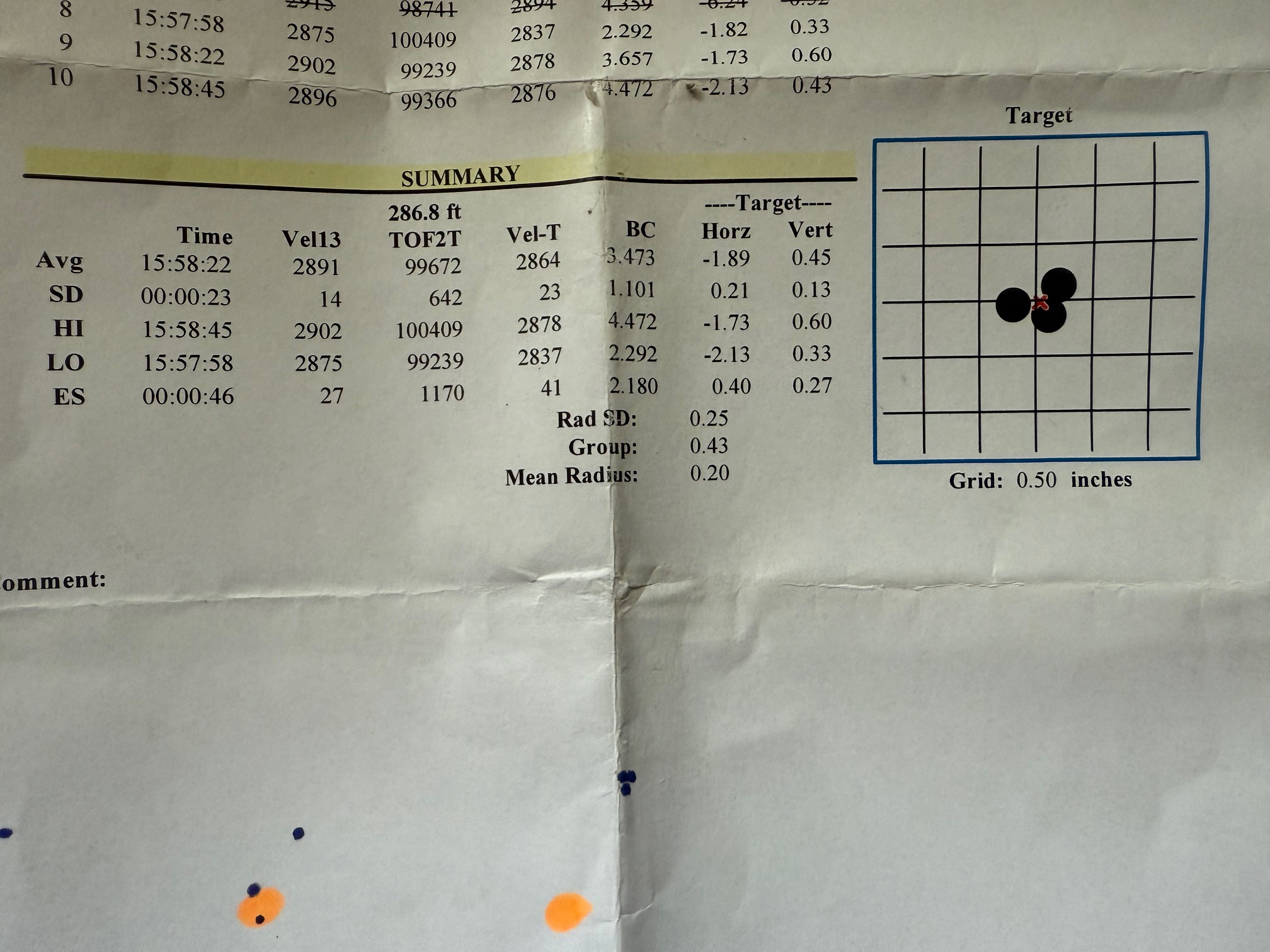

The other 3 shot group is from a while back with the same load that did have a direct measurement taken but failed to get a picture of the group...
