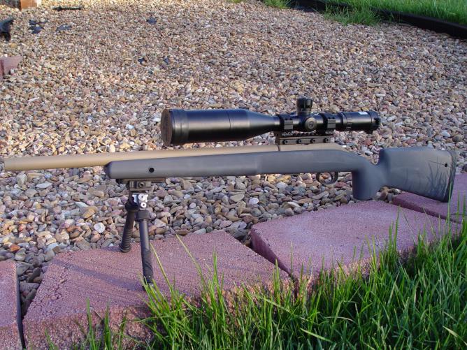

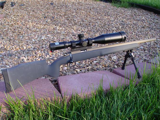

I wasn't ready to show this off as it is still in progress but here is my Whidden Composite Works model 140. I love this stock because it is the most versatile stock I have found. It has a vertical grip but is excellent off offhand use as well. The biggest thing is that it can be inletted for rimfire AND centerfire actions. The palm swell isn't too much and the forearm contour is pronounced yet subtle. I had more fill added to the rimfire so that makes a great trainer platform coming in at 12.4 lbs as shown. Aditionally, I got both stocks built to order, inletted, bedded and shipped in less than 3 months!!

That Whidden is gorgeous. Did you have to send in your barreled action, or do they have the measurements for a stock inlet price?
Cool. Looks like another nice option. I wasn't familiar with them before. Might make a nice stock for my MPR.
I didn't add that it was a $150 up charge for the nonstandard inlet but with a $400 base price for the stock I didn't sweat it.
Now that is a seriously great looking stock! That is a 455 correct? So I would have to send them my 452 to get it inletted? That is around the same price as the others and cheaper if it does not need to be specially inletted! Looks great!
Also what are the specs on that build???
BenY-correct 455. They can do any of the the 450's so that is why I chose to show it even though you asked about the 452.
Remington and clones are their only standard inlet so yes, you'd have to send them your BA, bottom metal, etc.
Full expense for stock, inletting, bedding, 3 flush cup & 2 studs= $715. Painting the stock is also included with any of their 7 standard colors.
I'm getting mine film dipped so I had them return it ready for base coat.
Build breakdown;
CZ 455 Varmint, stock barrel but threaded and capped
Whidden Composites 140 Heavy Fill, pillar bedded and skim coated
DIP Aluminum Mag well
DIP Extended Mag release
Factory trigger guard
Yo Dave trigger kit
UTG/Leapers DNT06 Compensated scope base
Seekins Low rings
Bushnell Tactical Elite 6-24 w/G2 reticle FFP
Accu-Shot BT-15 rail
Accu-Shot BT10-LW17 bipod
The UTG mount I chose for several reasons. The .68" height worked perfect for the
scope and rings which I already had and I like the full length clamping bar apposed to
the set screw style others use. In my opinion it has superior clamping ability. It has
approx. 30 MOA cant built into it as well so getting extended range is very doable at
least as far as a 22lr is concerned.
For now I'm using the factory barrel. This one is exceptionally accurate so I'll spend
my money on ammo....when I can find it. I used the stock trigger guard because a
DIP TG available at the time. After getting it all back from Whidden and checking
over the bedding work and stability of the BA in their stock that's $120 I didn't need
to spend after all.
