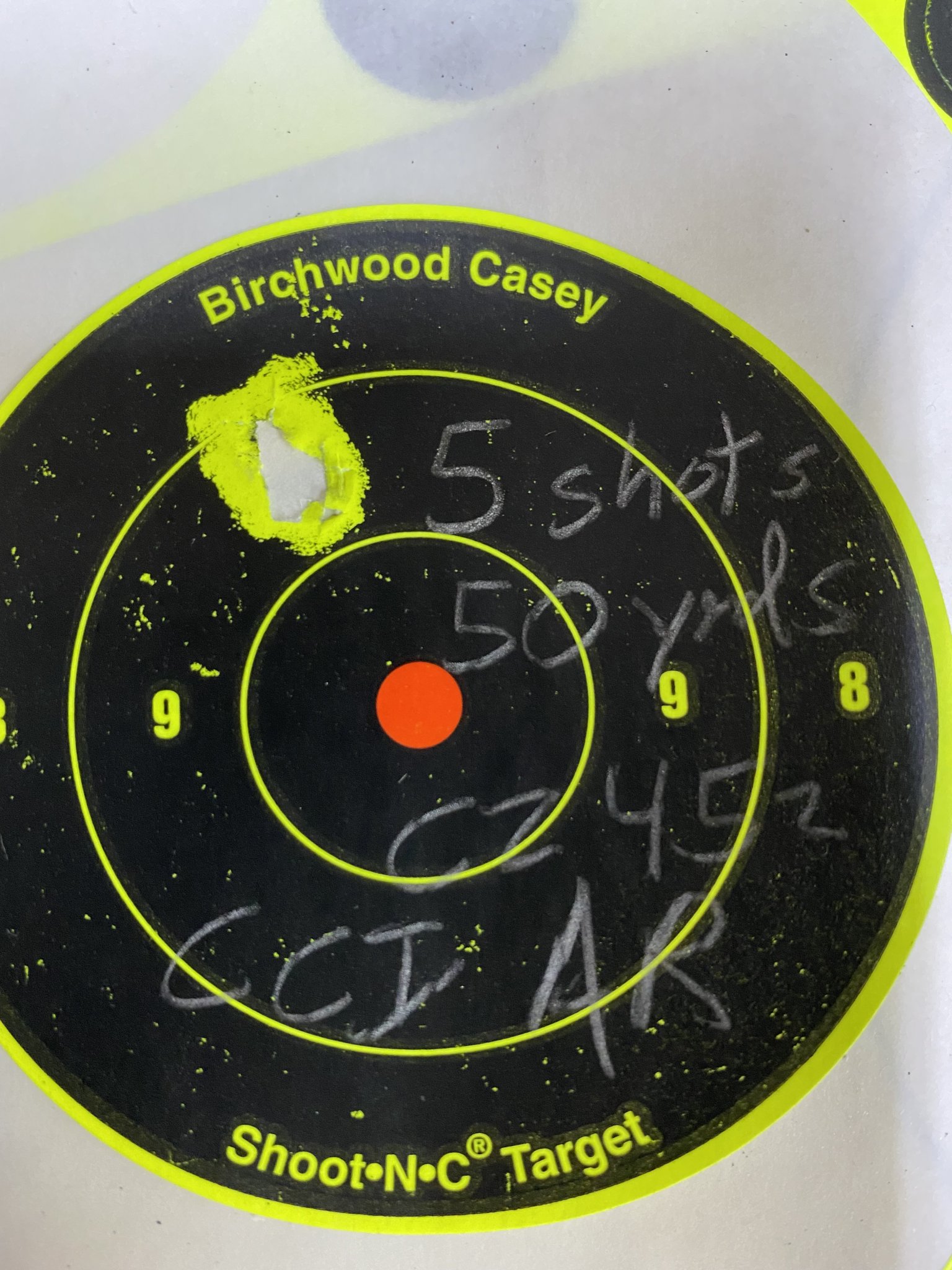

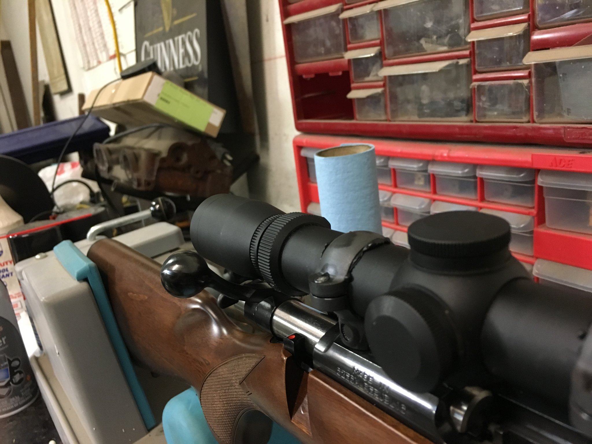

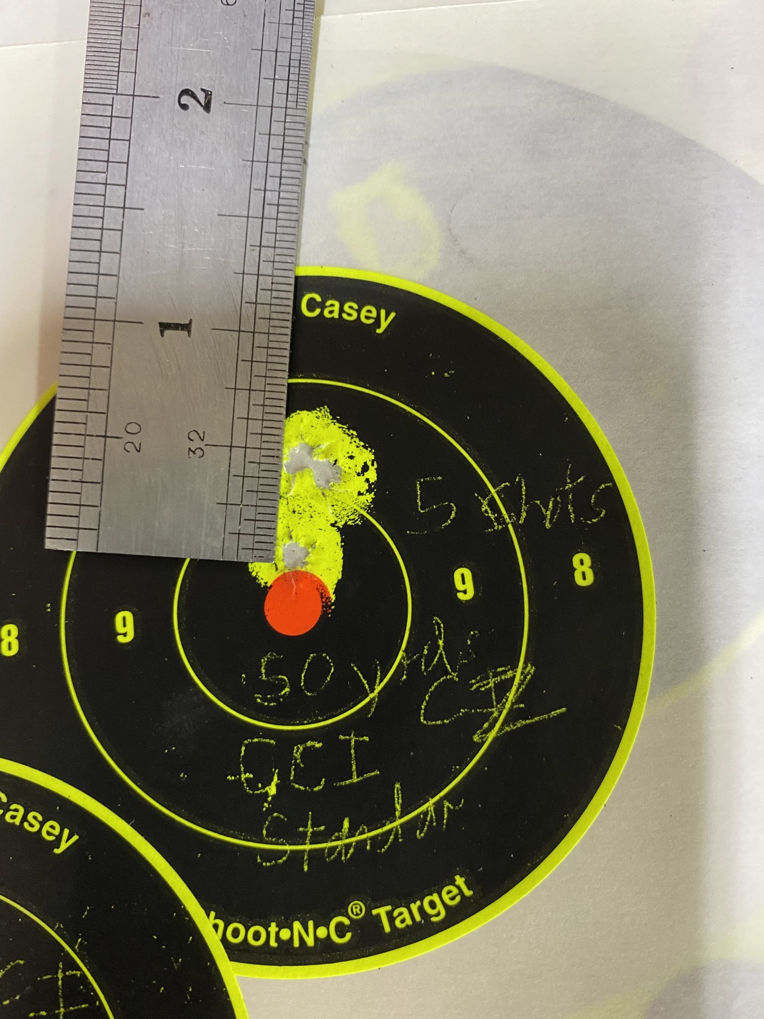

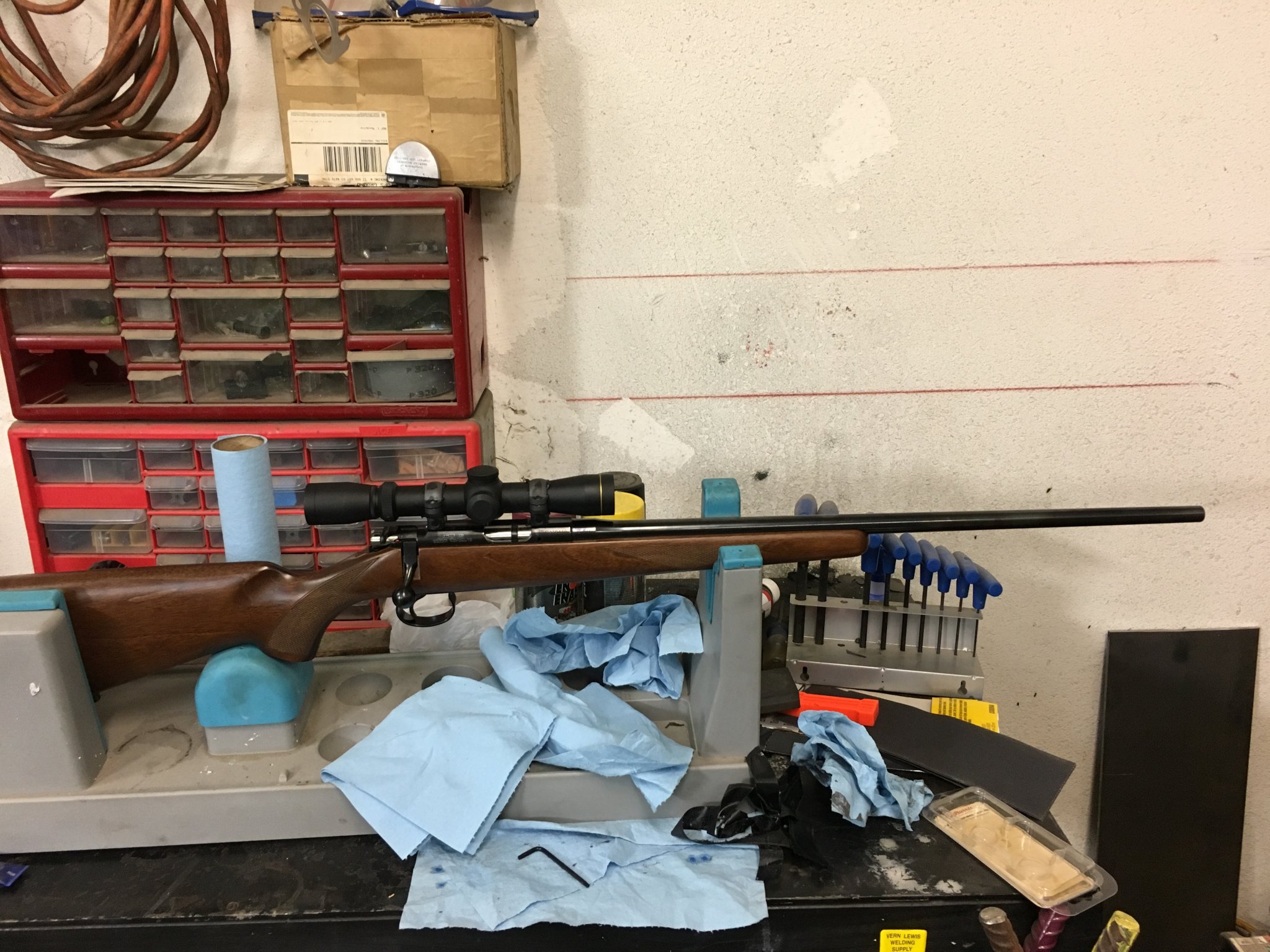

Bob at Accuracy Speaks over at Usery Pass has an excellent handle on tuning up the 452. He is a small bore specialist, stoning the internals of the bolt smooths the action a lot. My 452 shoots like this with CCI at 50yrds 5 shots pretty regularly. I’m afraid to touch anything on it right now for fear of losing accuracy. Mine only has maybe 200 rounds through so it’s not even broken in. That’s a 2-7x Leupold rimfire with Burris rings they fit really well, the rings were on the shelf at Sportsmen’s on Greenfield. I took the rifle in and they let me check fitment/bolt handle clearance with the scope. Be sure to break down and clean/rust prevention the bolt internals with CorrisionX really thin wiped down work’s excellent. The bare metal parts in CZ’s get touch rust really really easy even in AZ! Lastly do yourself a favor put in an order for the DIP Inc extended mag release and the metal mag well replacement do them both at the same time. The plastic CZ uses in that mag well is total garbage. Cheers, happy shooting a rifle that has a hammer forged barrel your great-great grandchildren won’t wear out!
