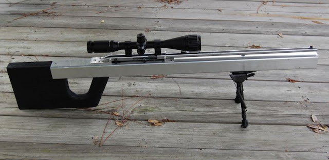

I'm going to take my barrel block, which produces consistent accuracy
because the barrel is integrally embedded in epoxy, in the linear channel,
I chiseled into a 9 inch section of 3x3 poplar, and held in place using
steel plates with leather pads to prevent barrel movement.
And fabricate a stock to accept the barrel block
and allow me shoot my 455 off the bench to determine
how much difference it'll make compared to the factory stocks.
So I attached the block to a mounting plate
and made some modifications to a section of 2x10
The plate/block will attach to the stock
with the receiver tang flush with the comb of the stock
So the bolt can be cycled
Some jigsaw work and there's a grip
Not going to worry about stock flex or barrel oscillations.
This is going to be a free floated action, not a free floated barrel.
Now, now, enough of the chuckling...it's not like it's an original concept.
Think about bench rest rail guns. Free floated action, clamped down barrel.

If this project produces positive results, great.
If not, I'm out about 5 bucks worth of white pine and a couple hours.
My wife just laughs at me, according to her, I have no fear of failure.
She blames it all on that defective "Y" chromosome.

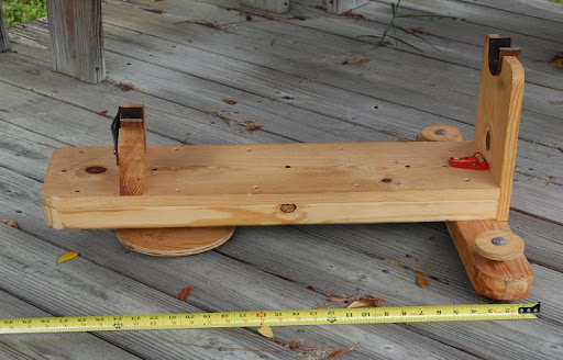

Needed a bipod to stablilize this fuglie beast.
My Harris wasn't going to get the job done.
Plenty of scrap pine laying around, so,
cut a couple open mortises, added 2 pan head screws.
The round head screws act as feet to allow recoil slide.
Drop the stock in the bipod slot and it stands up.
There's about a 1/4 inch of play to be able to adust to the bench.
I did ease all the edges, no splinters.
Just need to hang a scope on it and drag it to the range.

You mean, like a fully locked down barrel on a totally rigid stock,
No room to shift, no stock flex at all?
Too late, been there, built that.
My Savage 64 Heavy Metal
Heavy Metal was a project created so I could understand barrel whip.
After hand machining the inletting in the heavy wall aluminum tubing
it looked like this:
Results at the target were horrible.
Receiver didn't budge, but that pencil barrel was flinging rounds all over.
That's when I figured out "free floated" is just a suggestion, not a rule.
So I fabricated some barrel blocks and clamped the barrel down.
It shoots much better now.

On your "low tech rest" is that a level in the front? I may have to make one of those.
The low tech rest was built to remove my lack of skill
from diagnosing accuracy problems with my rimfires.
Also very handy for sighting in scopes. Fire one round,
dial the crosshairs to the hole, fire a second round to
check the adjustment. Building a low tech rest is easy.
Scrap lumber, scrap leather, zip screws and some carriage bolts.
28" long
22" wide
Butt vee and recoil strap
Vertical adjustment screw for leveling
sharpened carriage bolt and plywood wheel held by a nut
Found that the U-shape allowed for too much lateral movement
replaced with a 45 degree vee lined with leather for a more stable rest.
Cheap, effective way to test if it was me to blame for poor target results,
or something else on the rifle causing problems. Here's an example:
Groups 1 to 5 are me using a bipod. Frustrated and ready to blame the rifle/ammo
dropped it in the test rest. Same rifle/ammo/conditions from the rest, look at group 6.
Diagnosis: the problem is all me and my inability to use a bipod properly.
