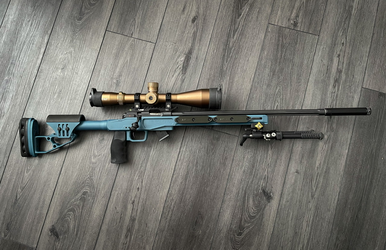

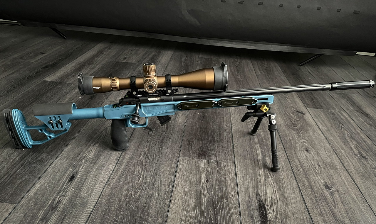

CZ 457 Build complete
RIGGS9985
  • Mar 26, 2012
    201
    469
    38
    Nebraska
    *Cz 457 lrp
    *XLR element 4.0 in titanium blue with full set of internal weights and 2 pair of external weights
    *area 419 30 moa rail and knob
    *yo-dave trigger spring
    *Nightforce ultra light rings
    *Athlon Ares ETR
    *Atlas with arca adapter
    *Surefire Ryder 22S

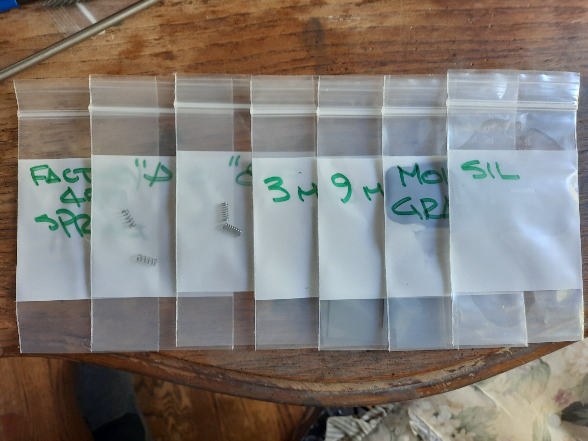

    Hey... I made a mistake on this post regarding the spring call-out. It will show up on every quote. Oh Crud !!
    In post #4, Appalachian pointed it out to me.... He offered the correct McMaster-Carr number. ( #9657K611 )
    Your .018" wire Yo-Dave spring can be replaced with the McMaster-Carr #9657K611 and that will yield 55% of Dave's spring rate. A 7 oz. 457 trigger is pretty easy to achieve. The #9657K611 spring has a length of .375" and an OD of .148" and a wire diameter of .014"

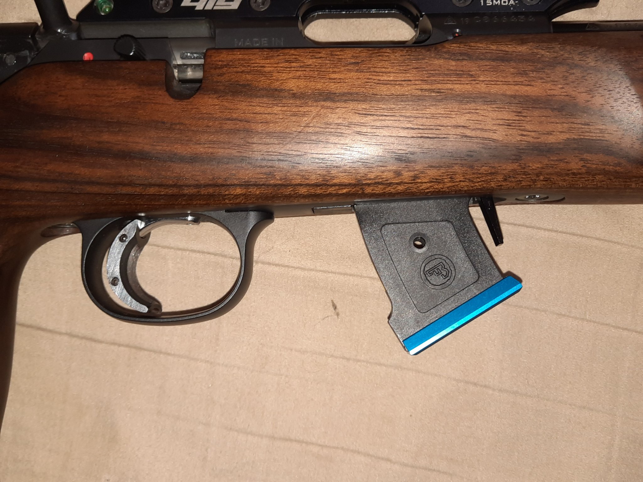

    You can also lap the trigger sear with some 9 and then 3 micron aluminum oxide lapping film for a mirror finish. With your black trigger it would take less than 10 minutes. The chrome trigger is closer to 40 minutes. You may also consider the Anarchy Outdoors extended magazine release.

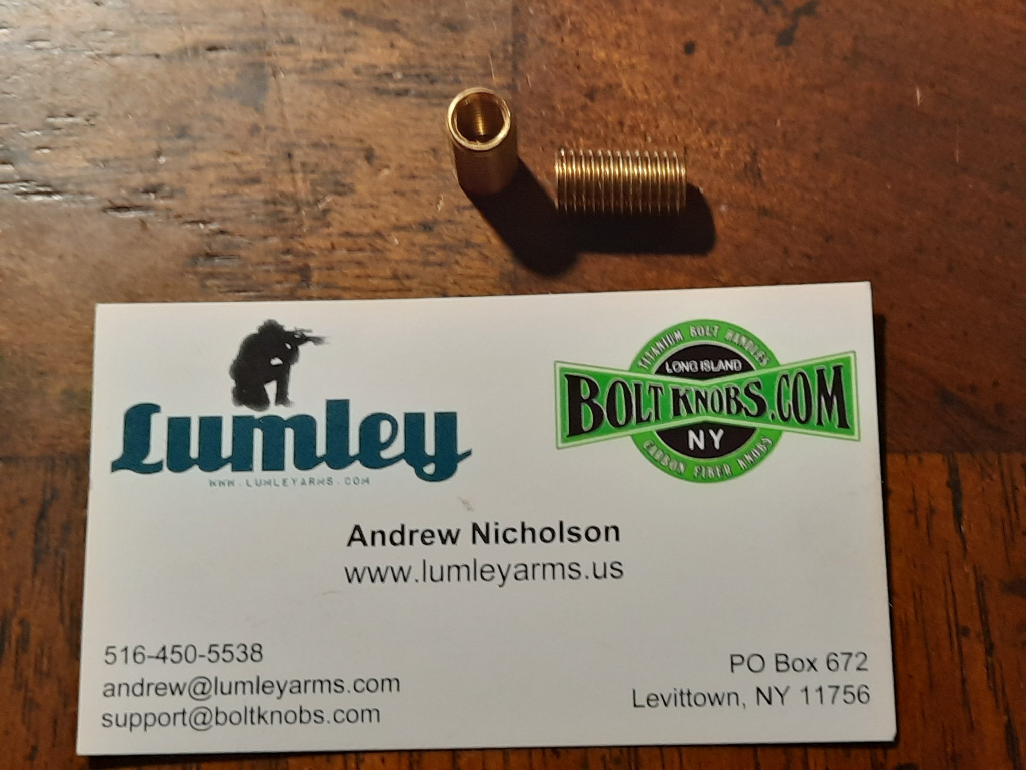

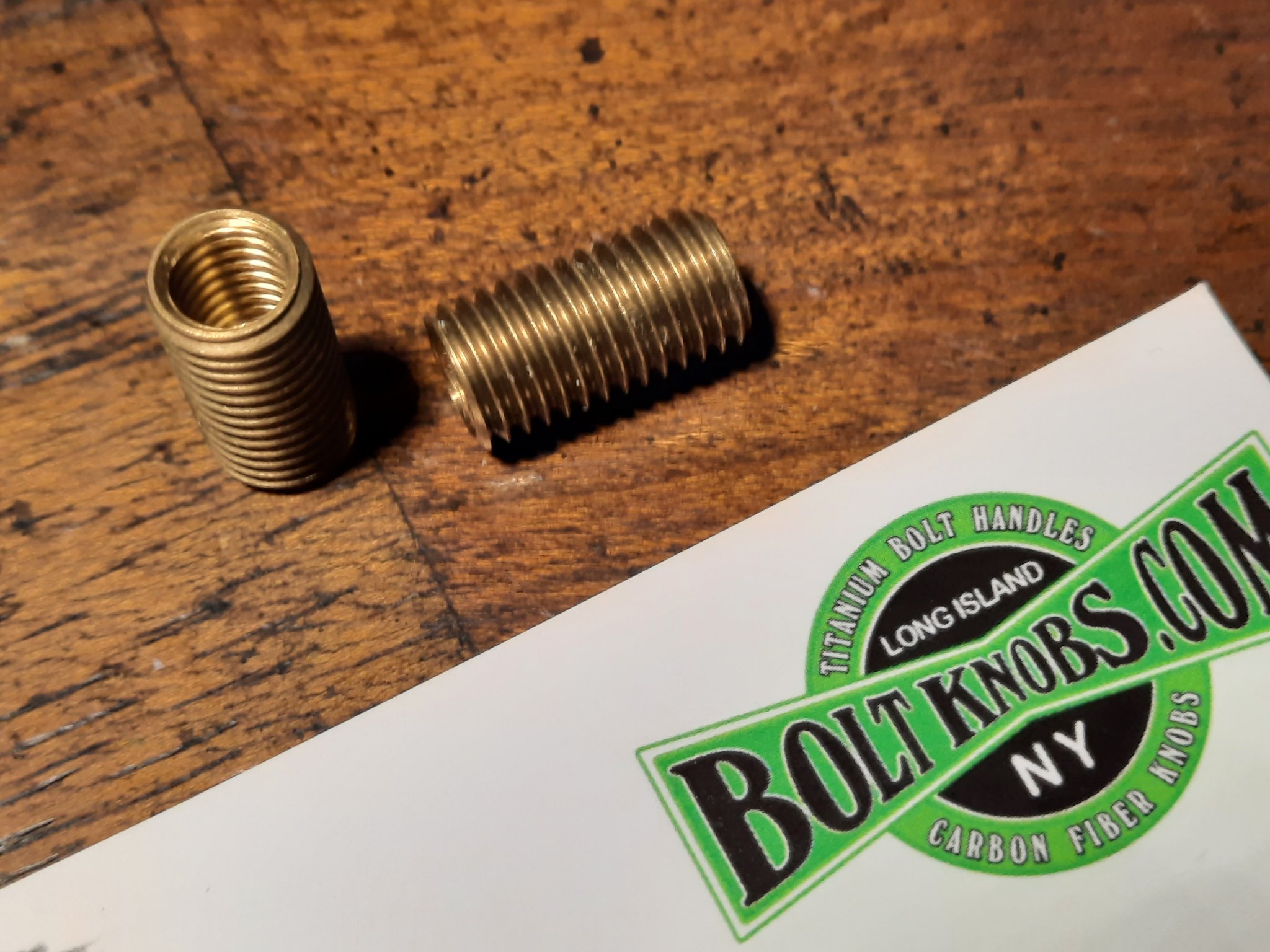

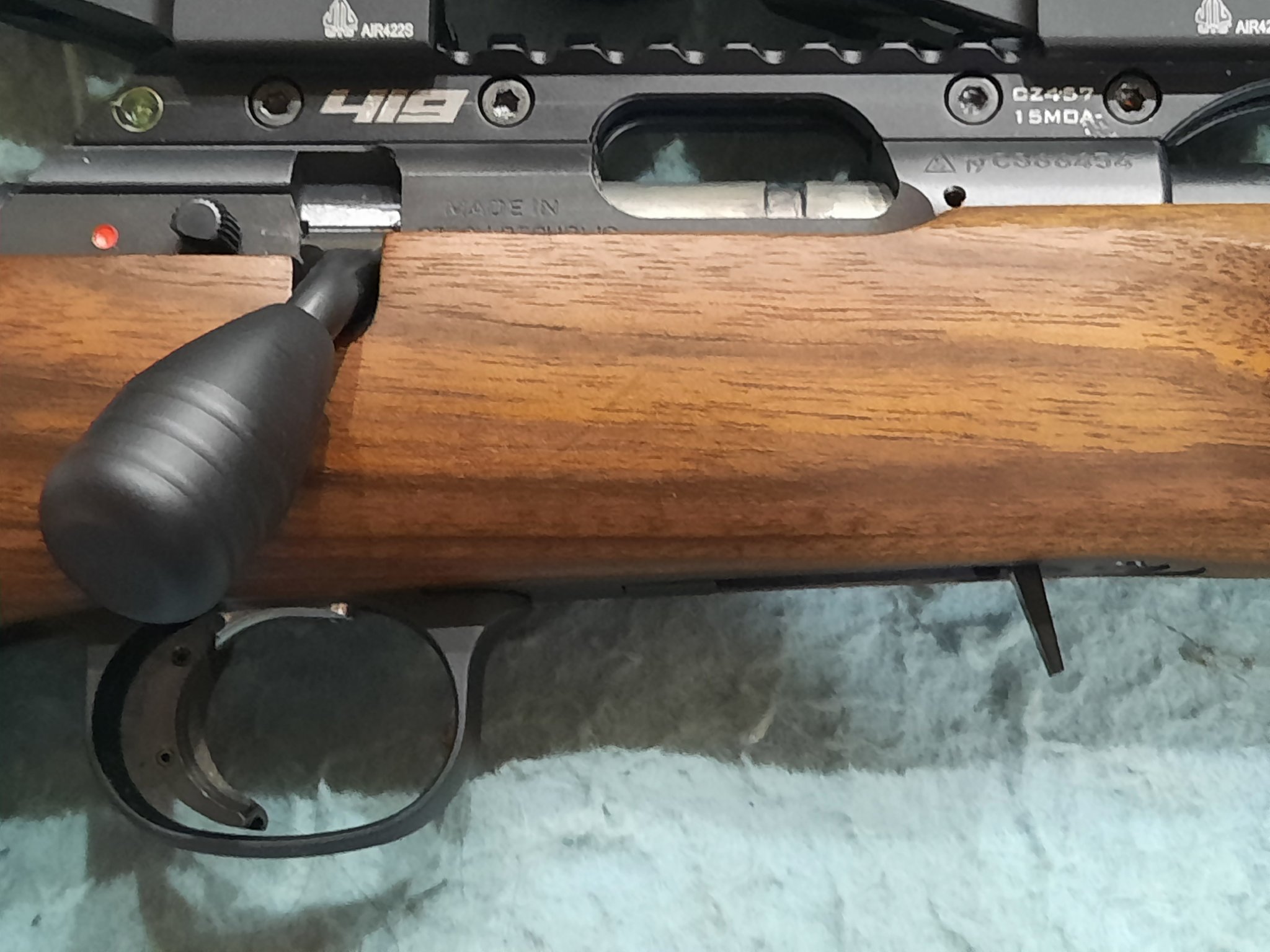

    The DIP release is only .08" longer than the factory release. It may be a huge help in your chassis. The trigger shoe my MTR has is and old Flaig ACE shoe. #21 and #22 both work. I buy them from Gun Broker and eBay. I had a AREA 419 knob for a long time but switched to a Vudoo knob. It feels better to me and has a little more length. You will need a Lumley thread adapter to convert from 5/16-24 to M6 on your CZ.
    She's pretty but does she shoot ?? LoL
    Love the fluted bbl.

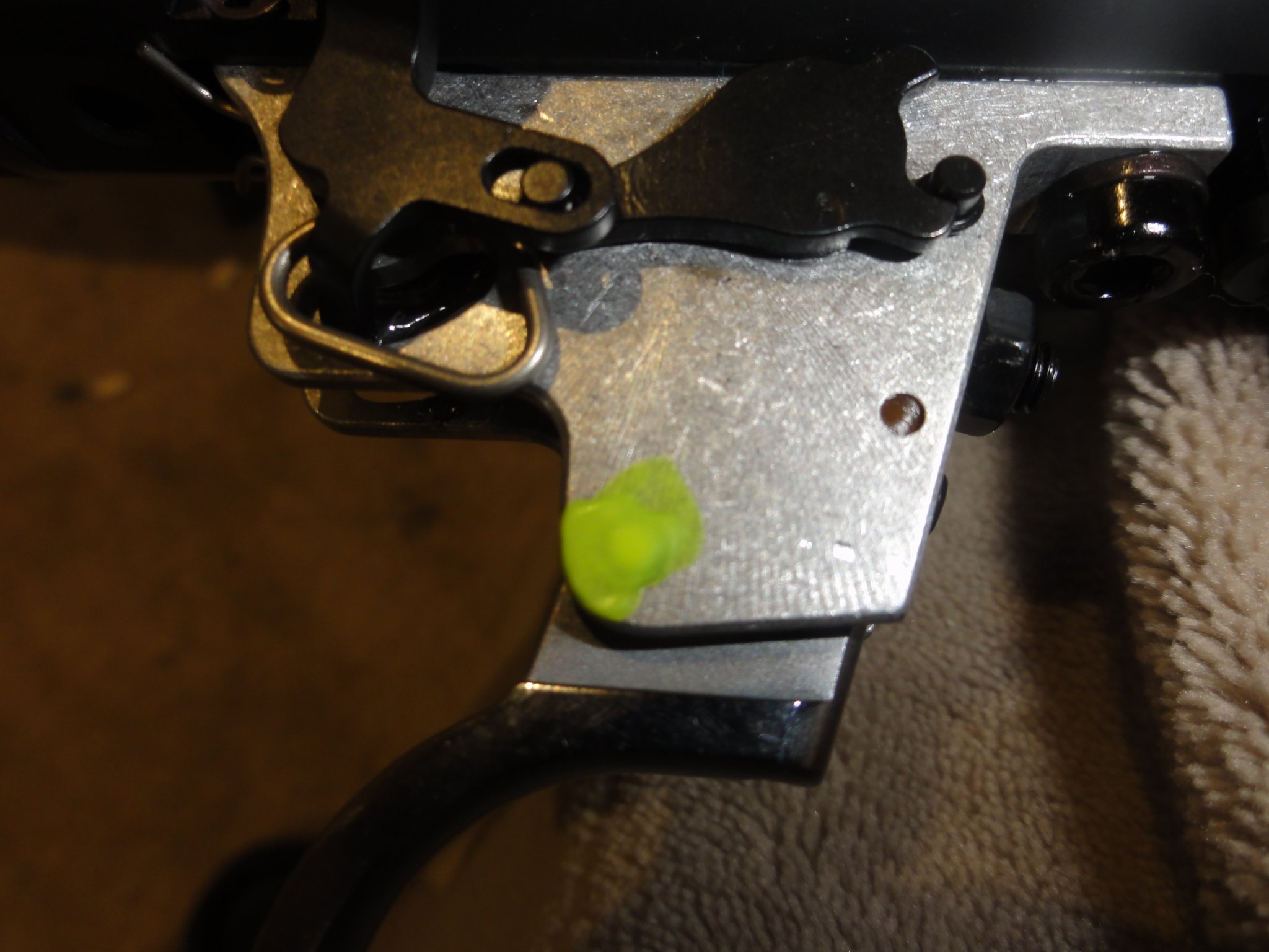

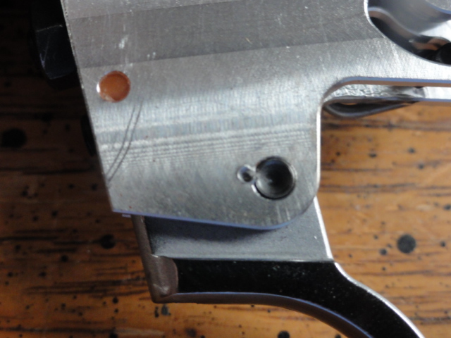

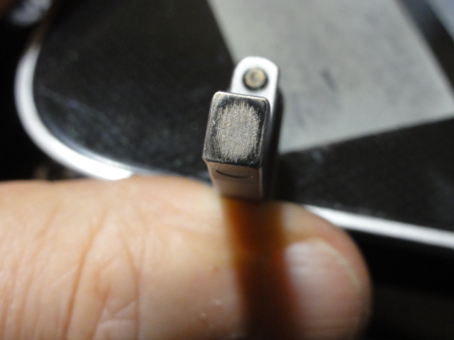

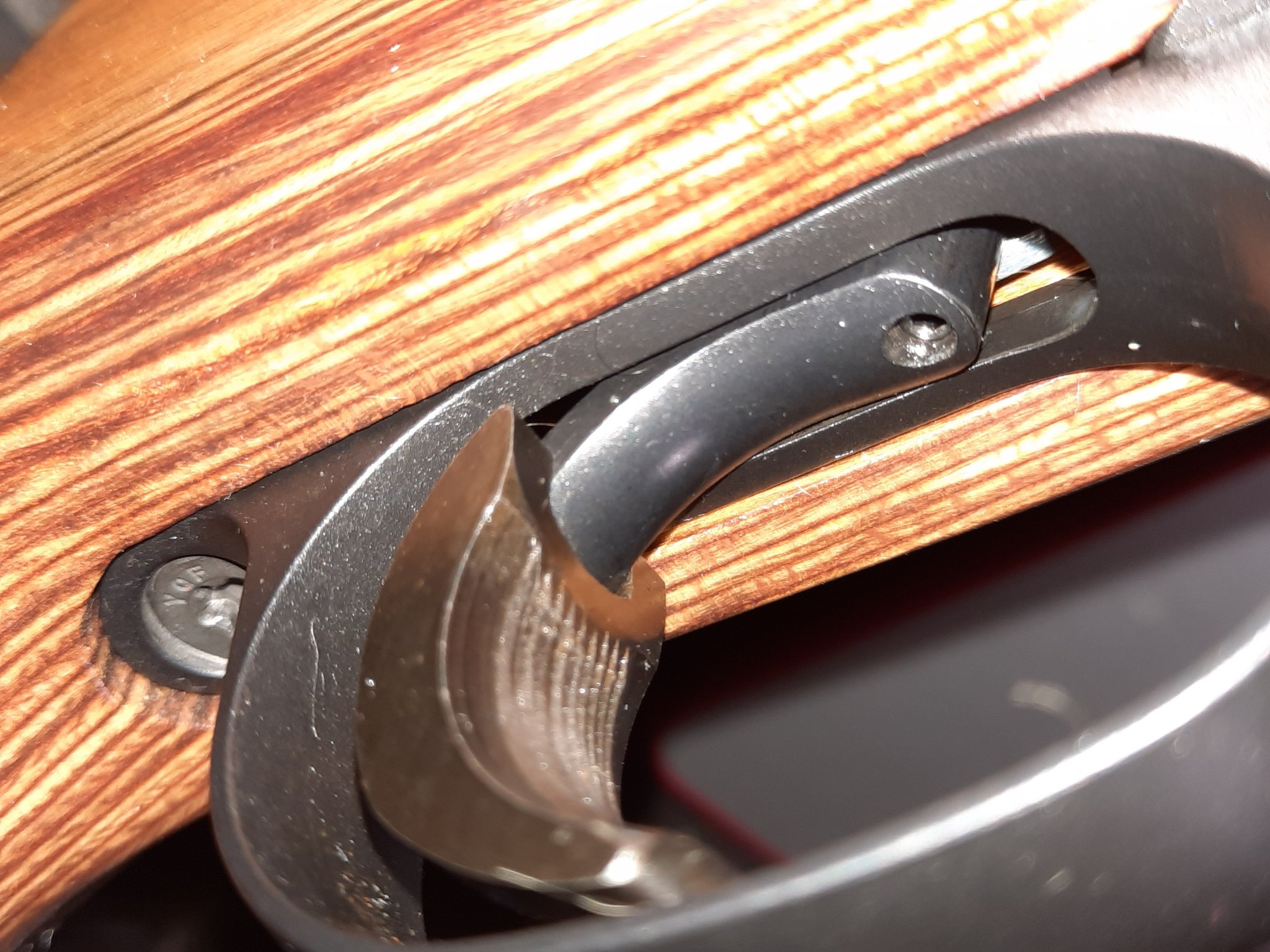

    When people do the spring job I also recommend they sand down the ends of the trigger pin for easy insertion. Once they drive the
    pin out it becomes clear why I suggest it. To retain the pin I use finger nail polish because it wont wick into the trigger joints like Loc-tite
    can or they can stake the pin in place. The stake I show in photo five is huge because I wanted it be clear in the photo. All you need is
    a few thousandths deformation. I also suggest people lap the trigger sear in the same direction as the trigger travel. Or 90* to the trigger
    pin. You can see the faint grind marks in the frosted area of photo number six demonstrating that the factory did it in that direction as well.
    I was surprised to find that the MIM manufactured trigger was concave and not flat. Lappers... one last note: Keep the trailing edge of the
    trigger sharp and crisp. Do Not let it get rounded over !!

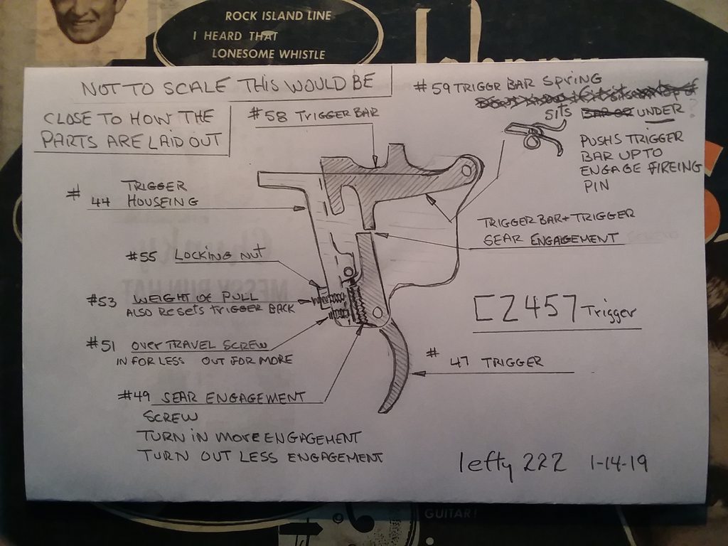

    The #9657K601 spring is the .25" long version and although I have tried it, I decided against it because it was too light for my taste.
    If anyone tries it, they will need to get all of the spring pre-load from the #53 adjustment screw. I have sold or given away a fair amount
    of the 457 spring kits and I felt suppling it would cause more problems than it would solve. I have given the short spring to people who just
    have a burning desire to try it. Be careful !!
    Screw #49 is backwards... In yields less sear engagement. I typically start off the final tune by turning the #49 screw in until the firing pin
    falls and then back it out by 90*
