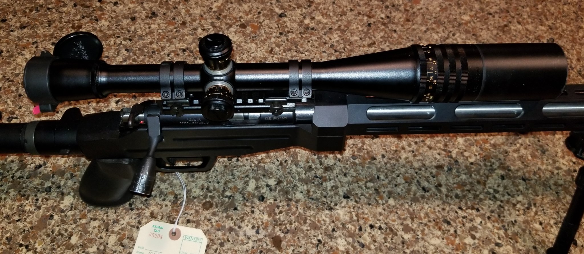

    CZ 457 VPT with factory barrel
    Vortex Razor AMG
    Seekins low rings
    Area 419 scope rail
    Area 419 bolt knob
    DIP magwell, mag release, and block.
    Custom cut full length grade 10.9 action screws.
    Reshaped and polished striker
    Polished bolt
    Manners Lightweight cheek piece
    Pillar bedded with MarineTex
    Atlas rail / Atlas CAL.

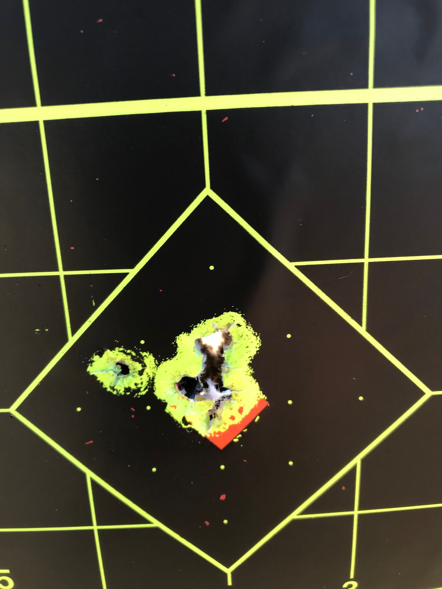

    I wanted to see how much accuracy I could wring out of the factory barrel, something about spending $500 on a new .22 barrel after I just paid $1k for the gun doesn't sit well with me
    7087798

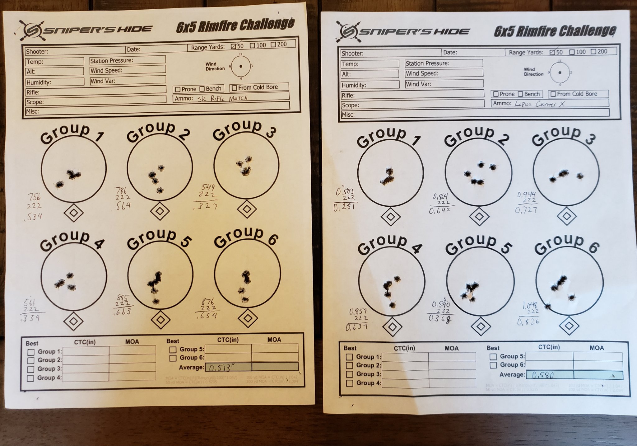

    Pre bedding 0.513" and 0.580" averages
    7087799

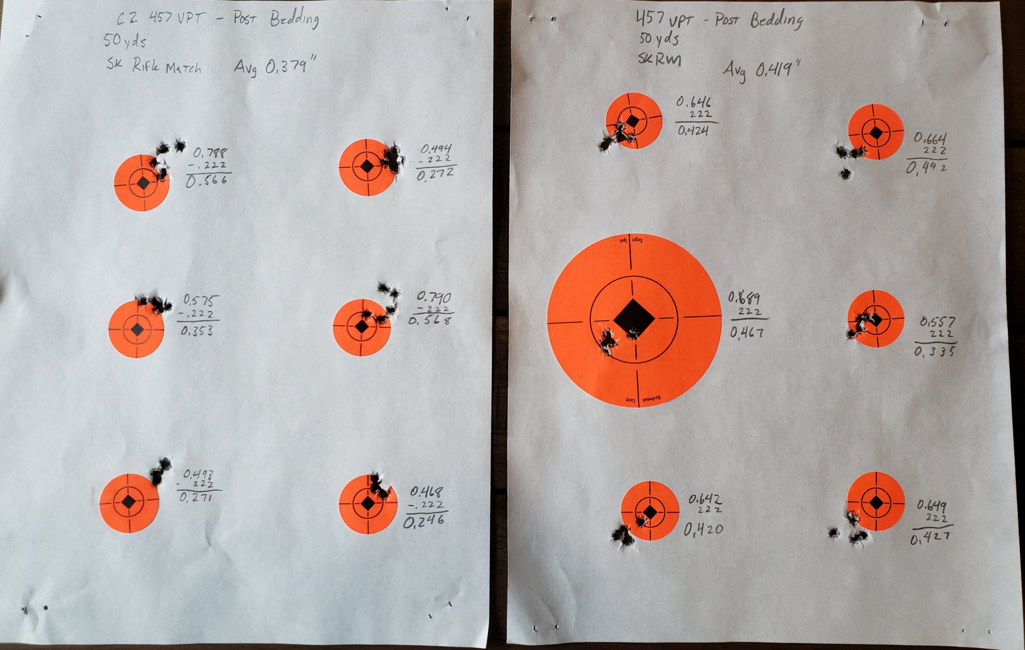

    Post bedding 0.379" and 0.419" averages
    7087800
    It seems to throw a lot less flyers with the bedding job, also the groups are more round and not strung out. All shot with the same lot of SKRM.
    Before bedding it was doing 1.25-1.75" @100yds. I didn't have time to shoot at 100 today, but I am really interested to see the results.

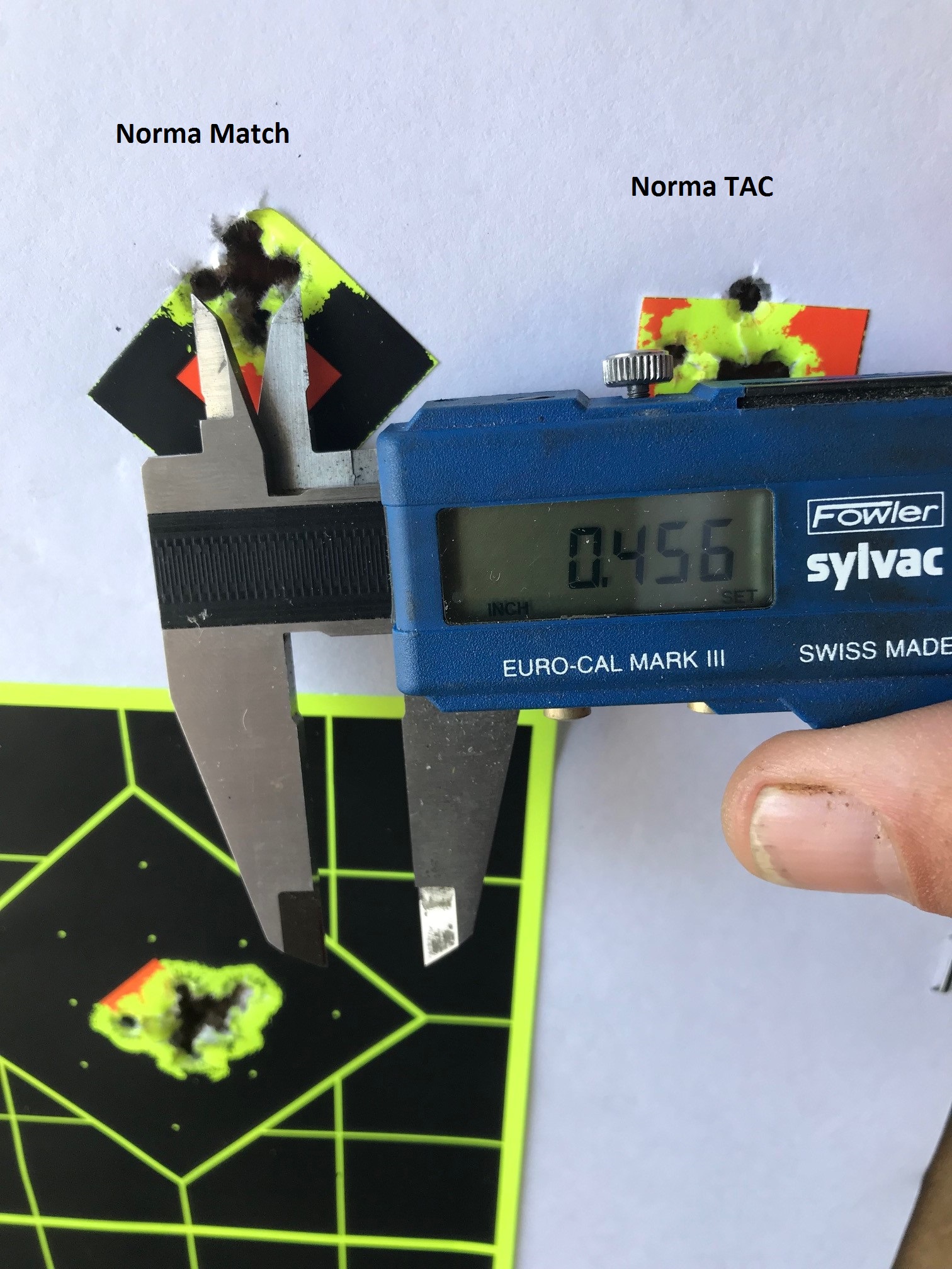

    Currently the headspace is at 0.046" I think I may try shimming the bolt to close the headspace down to0.042-0.043". I ordered some shims, we'll see how it works out.
    Ok guys, I have some results. I was out playing in the wind today, which is not optimal, but you play the hand you're dealt. This lot of SKRM is not shooting as consistently as the last lot, but still acceptable I guess. The rim thickness avg is 0.0435". I shot 18 5 shot groups at 50 yards and 6 5 shot groups at 100 yards both shimmed and unshimmed. wind was 12-15mph from 4:00 but fairly steady.
    50yds
    0.046" headspace 18 group Avg:0.701"
    0.043" headspace 18 group Avg: 0.623"
    11% improvement
    100yds
    0.046" headspace 6 group Avg: 1.454"
    0.043" headspace 6 group Avg: 1.109"
    23% improvement
    Like I said earlier, conditions were sub optimal. I will do further testing later if the wind ever dies down.

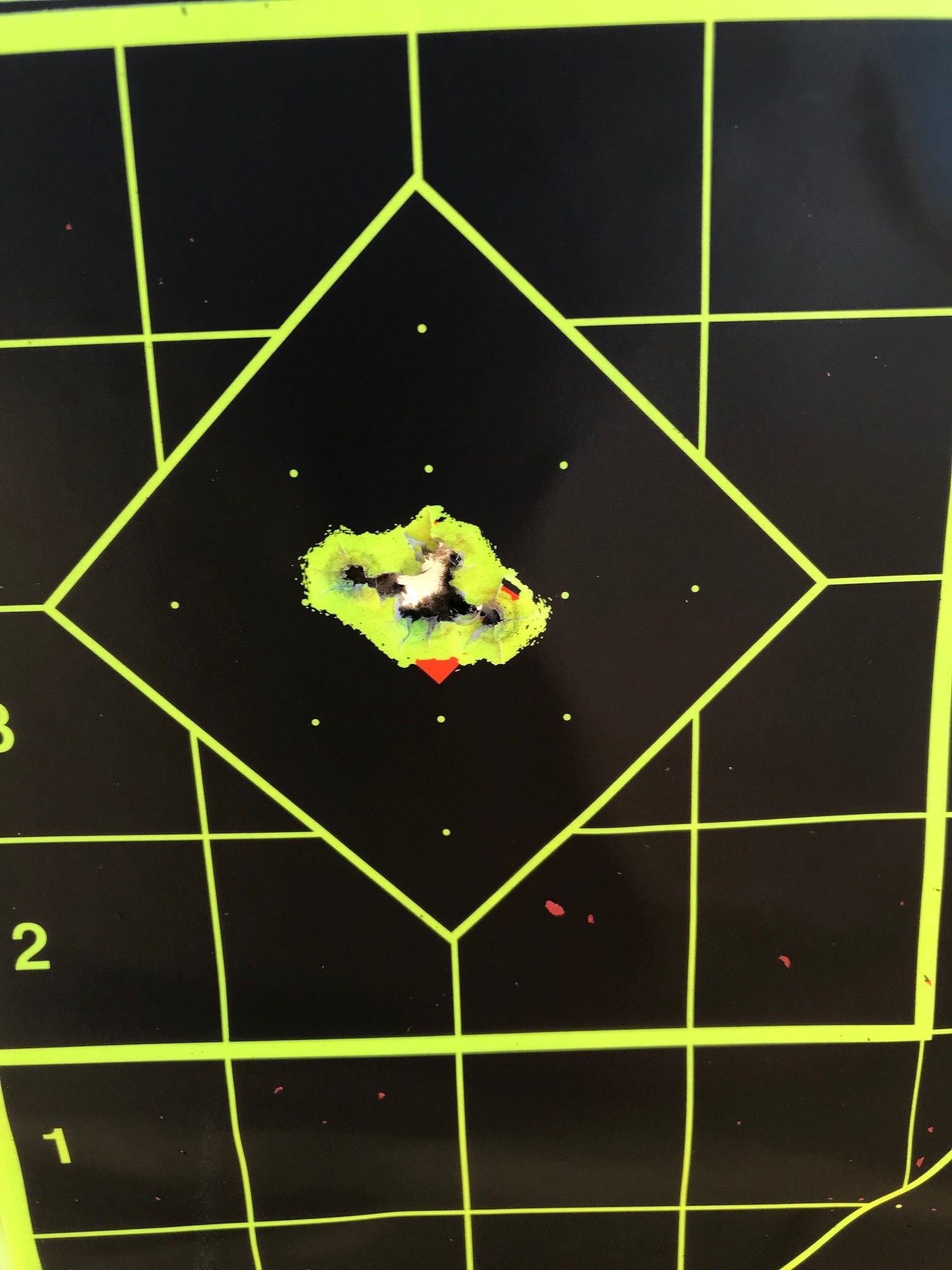

    I decided to glue the barrel in today, after doing so, the bedding under the barrel was not correct any longer so I ground it out. I am going to shoot it tomorrow, free floated and glued in. I may re-bed depending on how it shoots.
    I got out and shot in this final configuration with the same crappy lot of SKRM. It did ok(.5-.7), but most of the groups were vertically strung. I pulled it apart at the house and could see a rub mark on the bedding compound under the barrel, so I ground out some more, enough to get 4 dollar bills between freely. It's going to be a week or so before I get back out, but I got a lot of SK Pistol Match Special and SK Standard + to try as well.

    Every rimfire barrel is super picky so I'd try to be a bit more conclusive with ammo types before concluding it's just the barrel's fault. I got a new match barrel, and went and shot my Eley Tenex ammo that has consistently done .5-.7" at 100 yards with my factory ruger 10/22 and T1X. The new barrel hated all of my Eley Ammo.. Target, Contact, Match, Tenex all shot around .9" - 1.3". I was worried...
    I then went over to SK ammo and it was shooting my SK+ at 1", LRM at .85". My lot of Rifle Match did not take though, and was getting 1.1" with it. I then borrowed some boxes of LCX and shot a 6x5 of .75"
    I just put an order in for 2 boxes each SK Pistol Match Special, SK Biathlon Sport, Flat Nose Match, another few boxes of Rifle Match, and Pistol King to see...
    I have shot SKRM, SK+, SK pistol match special, Lapua Center X, Lapua Midas, Eley Match, Eley Pitol match, Eley Club, Federal 922, Federal Ultramatch, Rws R50, R100, and probably a few more that I am forgetting through this barrel. At least a brick of each. Didn't mean to sound as if SKRM is all I had shot, but SKRM is what it likes best.
    As stated before, the factory barrel shot pretty good at 50 but fell apart at 100 with everything. That is the issue I want to correct.
    Reactions: littlepod
    If you look at all of the 6x5's the group size from 50 yards to 100 yards usually goes up by a factor of 3, not 2. People who are putting in .5-.6" groups at 100 yards, are putting in .172-.2's at 50 yards.
    If you're doing around .37-.4, then you should be expecting about 1.1 - 1.25" at 100 yards. So I don't think it's falling apart, it's just the barrel/shooter. So you should be able to verify if you get a new barrel that if you get down to .25 at 50 yards, then .75 would be generally your 100 yards.
