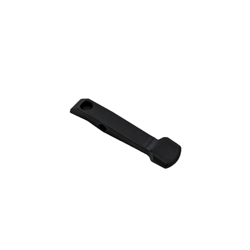

I’m assuming that was a joke since I’ve not heard of a mag extender. I meant extended magazine release. Like this:

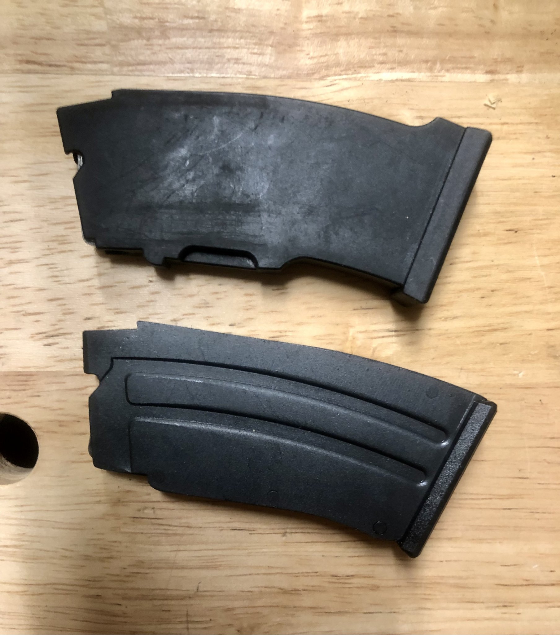

Okay, so some input. I picked up a new metal 10-rounder directly from CZ-parts. First thoughts as received are that it is heavy (a relative thing and meant well in this case), it seems well made as compared to metal .22 magazines from Savage and Marlin, the only two I have to compare to. Here’s a pic next to a plastic CZ mag:
