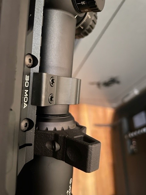

Can someone with this base confirm whether or not your mounting screw heads are flush with the base as in their image from their website. I have one that I bought from them and the screws protrude making the adjacent slots unusable. I called them and they said, yeah they stick out. I'm wondering if all of their bases were made like this, or if some have the flush screws as found on their website image.

Mine are not flush, however I've had no interference with them.
Thanks guys, mine are like Sjfell's. I'm wondering if it only the fastener or also the depth of the recess. I'll try another phone call.
It looks like their are two different style allen bolts. The ones sticking out are machine style and the ones flush are a button head style. I would check your local hardware store and see if you can find ones the same size and replace.
The solution was 6-32x3/8 button head cap screws. Locally all I could find in small quantities were stainless, wanted black oxide, minimum orders are 100. They have 5/64 allen sockets.
