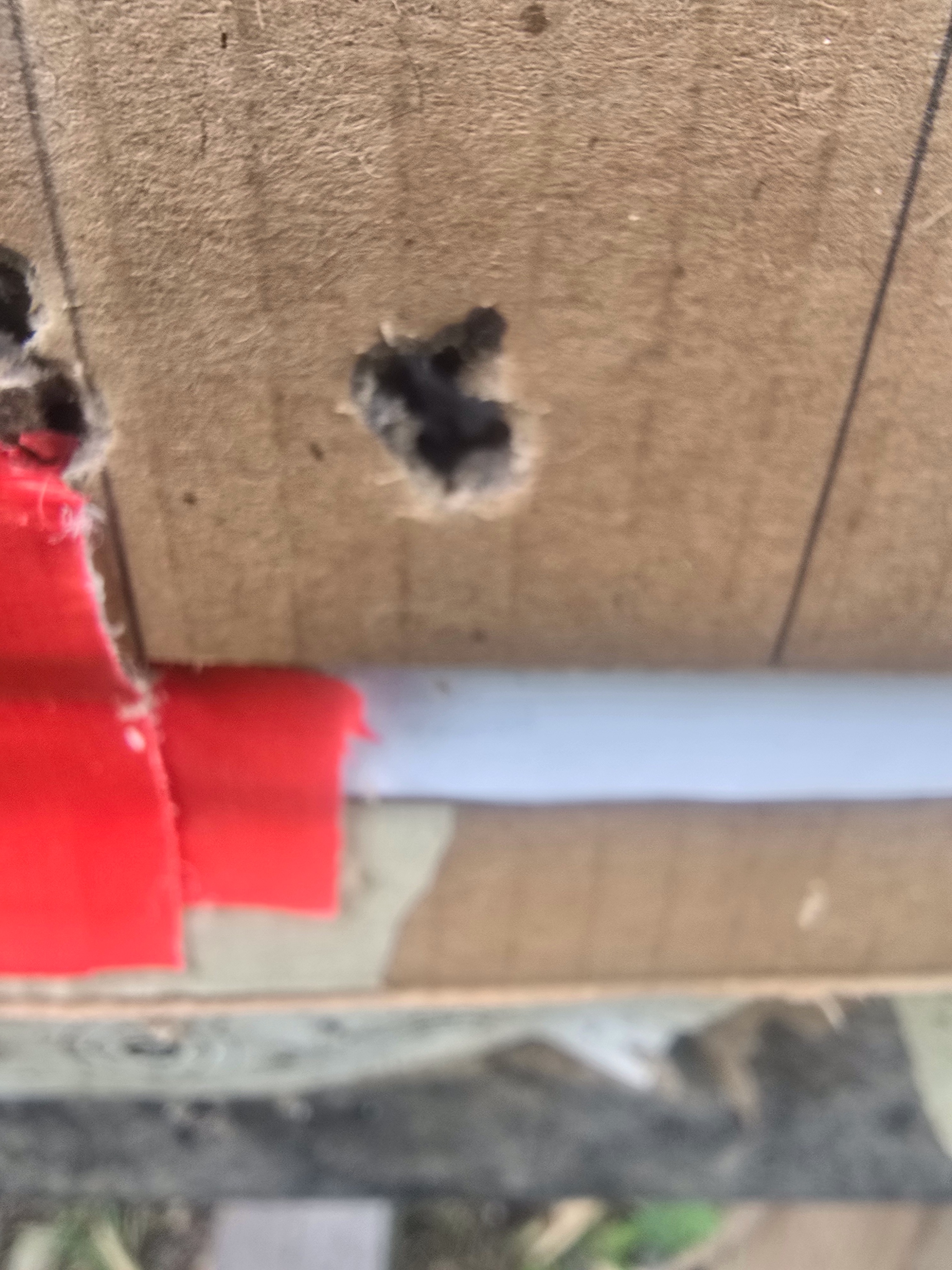

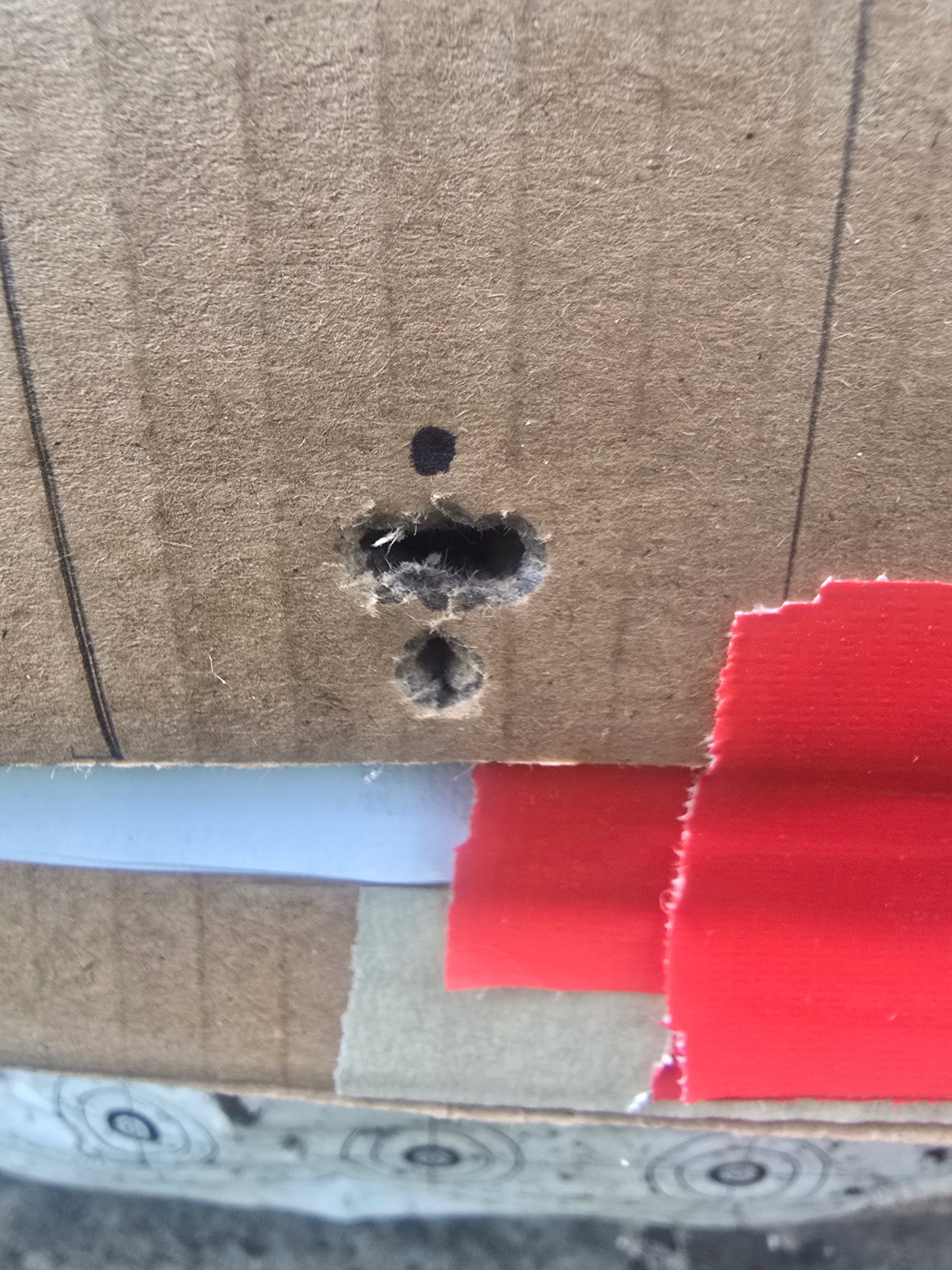

Well I’ve done some testing and SK red and SK orange run great,also Federal gold sv,still CCI not so great ,still waiting for ammo to become available for others.Federalon left,SK on right that’s 50yards can do that consistently with both ammos.
