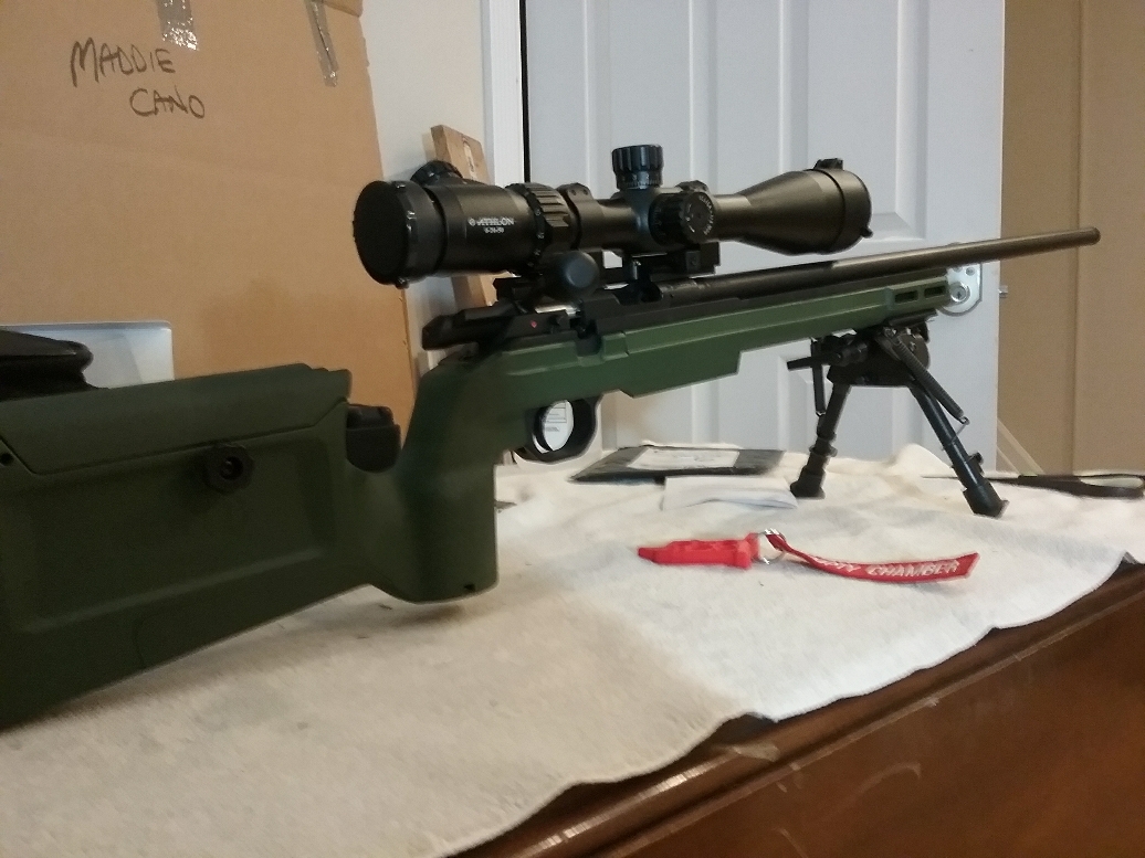

457 Varmint Precision Chassis. Athlon Cronus. Stock trigger.
These were the last groups at 100 yards that I shot with that rifle. I didn’t measure them, but did snap a pic with a ruler. You can see these were all under 1”.
