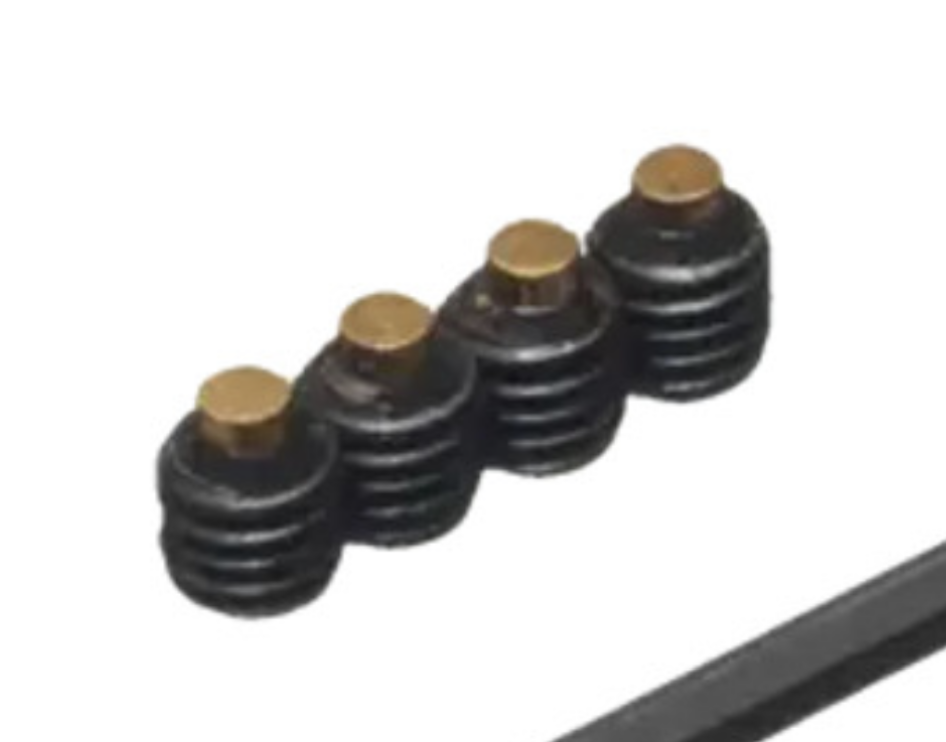

Murphy Precision’s stainless (or titanium) pic rail is vastly superior to the dip rail (and other aluminum rails that use tiny grub screw to immobilize the rail on the dovetail).
Here’s are Murphy’s brass-tipped screws that hold the rail on. Way better.
He can make 0-30moa rails, and I’ll bet he’d do others on a custom basis.
