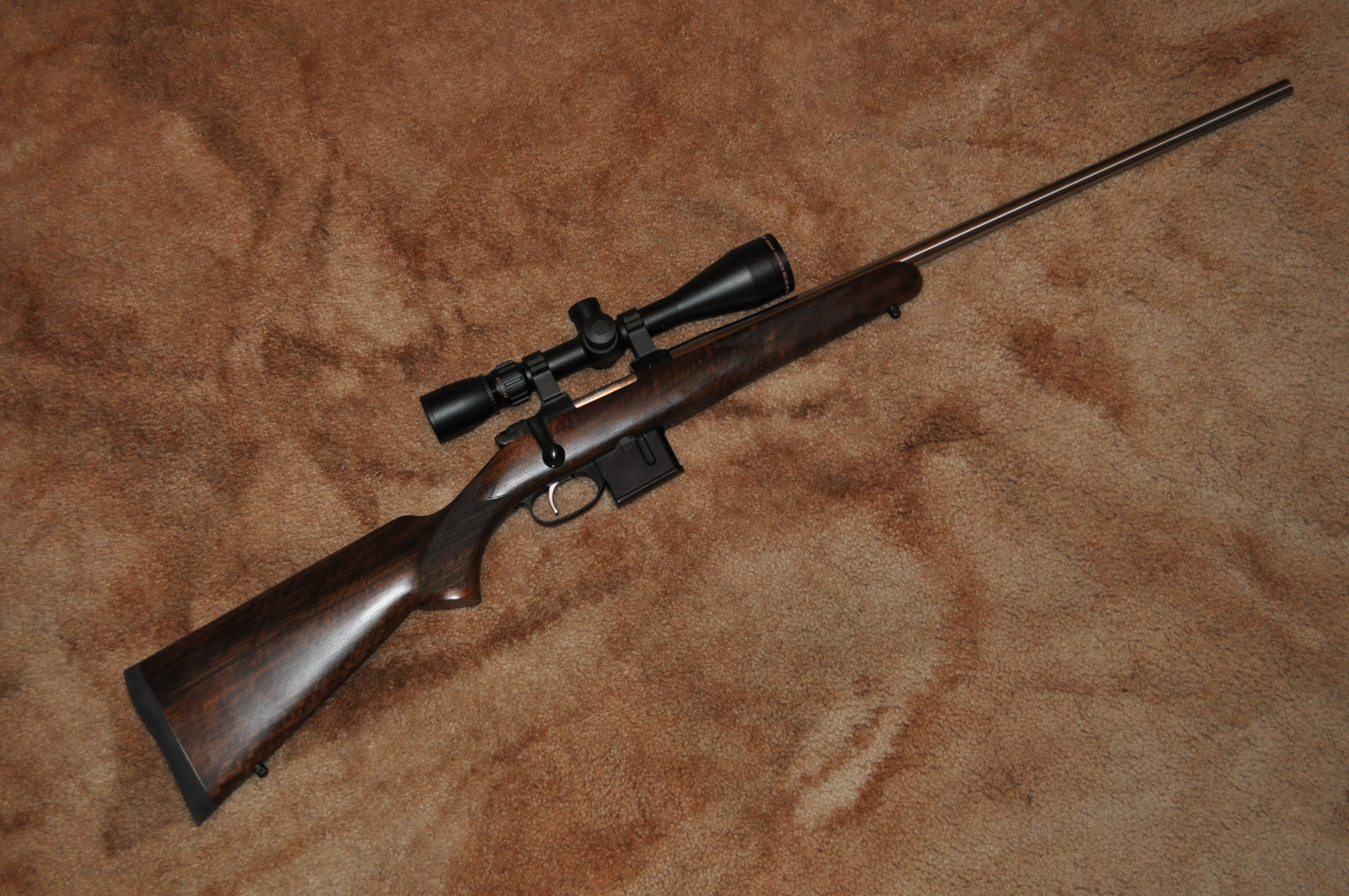

Sweet, Mr Dennis. Ive dreamed of doing a rifle EXACTLY like that for a long while now. 6mm RAT/6mm AR-Turbo/etc in a CZ 527 would make a perfect truck gun/walking varmint rig/WT deer etc. And weight/recoil will be way down. How does it shoot? Think we could get some pics?
Mine shoots good - not as good as my Dashers, but good. I haven't spent much time shooting it from the bench, just enough to get a decent 100yd zero for the scope, nor have I shot it on paper out past 200yds yet. Seems like once I got it finished and the scope zeroed, something else came along, and the CZ got set aside. Whatever - this is the only photo I've taken of the completed CZ RAT so far.
