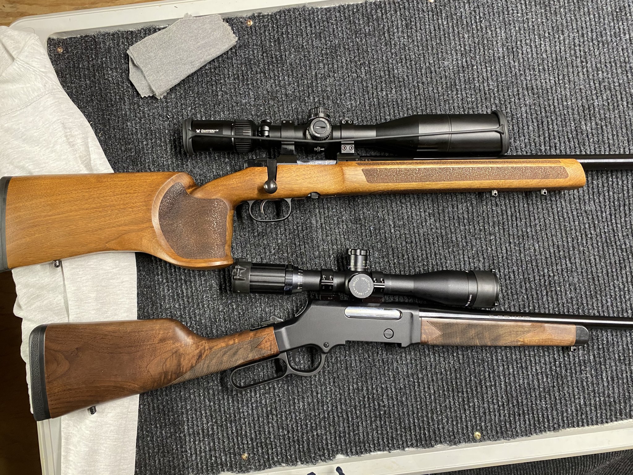

I used warne rings on mine. I can’t remember the details or part number.
This was a 557 Varmint, but the same action as the 527 for all intents and purposes. I used an EGW 20moa base and Ken Farrell “low” rings.
The KF rings are some of the lowest I’ve found and were essentially perfect height with the base and stock pack for me.

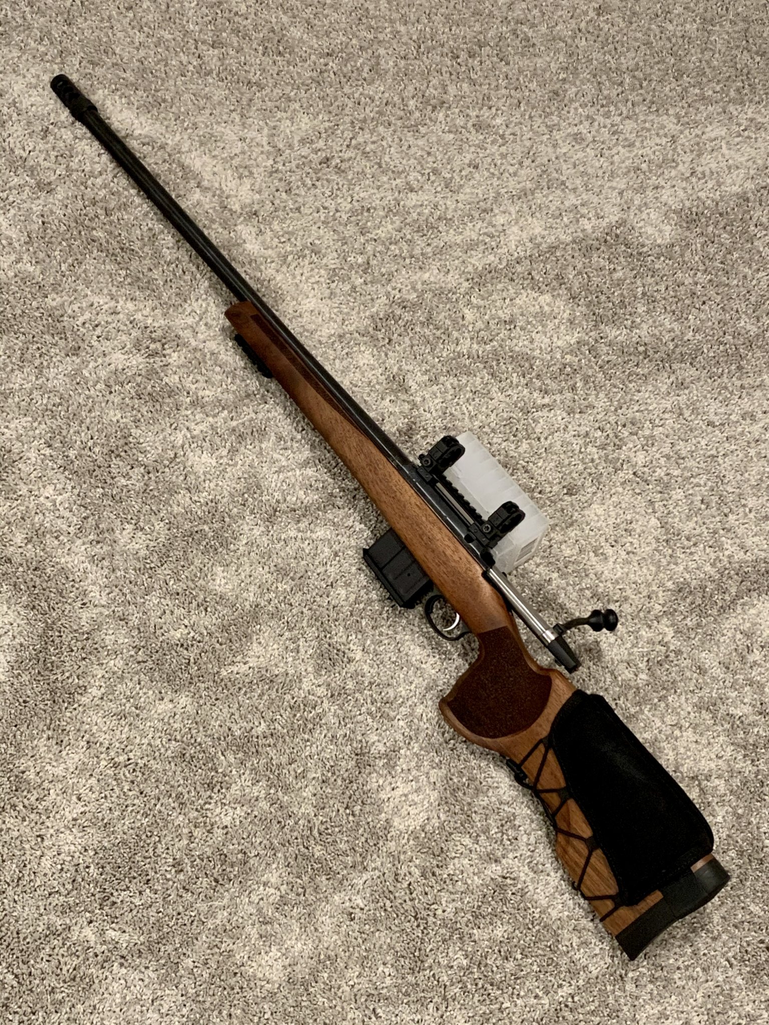

man o man o man, I have researched the ever lovin’ poop out of this topic. For years.
I own 4 CZ 527 rifles.
I would stay far, far away from DIP rails on centerfires. All that is holding them on are tiny grub screws. I had one on a .204 that I firmly tightened (enough so that I left marks on the receiver) and it still slipped.
Rail/scope went forward, obviously, and thankfully the 527’s dovetail cuts end before the edge of the receiver. So all I lost was the rail, which being made of thin aluminum, bent when it hit the dovetail termination.

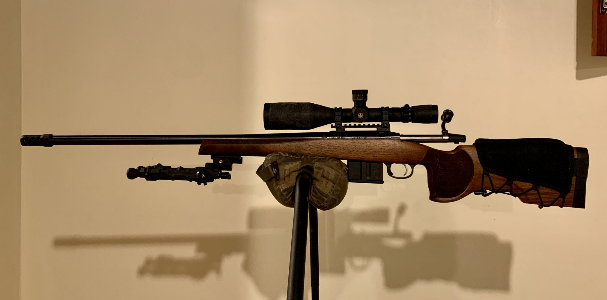

I have literally looked at every single rail out there. The only bolt-on one that is any good is the steel Contessa rail, which is made in different MOA mounts (20 MOA linked). It has a recoil lug, which is key as there isn’t anywhere to screw the rail down into the receiver.
YEAH, I know Optics Planet sux balls, but when I talked to Contessa USA ([email protected] 480-221-9907) that’s who they pointed me to as OP had them in stock.
At the time, only Euro dealers carried them and I couldn’t get anyone to ship to the USA. If you want other MOA cants then you’ll have to special order through Contessa USA. The cants are listed on their Italian site.
If you want a gunsmith drill-tap rail, the Ken Farrell steel base looks awesome. Better know a good gunsmith! Receivers can be hard to drill into, I hear.
Any rail, bolt-on or drill-tap, will stick up a long ways, unfortunately. I don’t know why? But that’s why I don’t use my nice Contessa rail on my 527’s. Looks are somewhat important. Perhaps if I had some ULTRA low rings it would fit my body and my aesthetics.

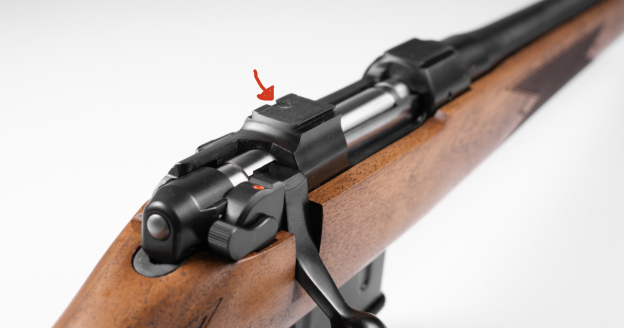

That’s great info. I’d really like a rail system but not sure how much benefit I get with it on a 300 bo. I may give the sportsmatch a shot but looks like they’ll have to come from the uk. I’d like to mount the scope as low as the bolt allows. Do you know where the arrester pin fits in the Cz? Doesn’t Seem to have a place to go like the tikka?
The rear dovetail on the left side. It’s not a hole, it’s a notch. Sorta weird.

That's a Vortex Diamondback, I don't remember which rings though. Yeah not crazy about the vertical split, but the height was right.
Edit: I found my order they are Warne.
