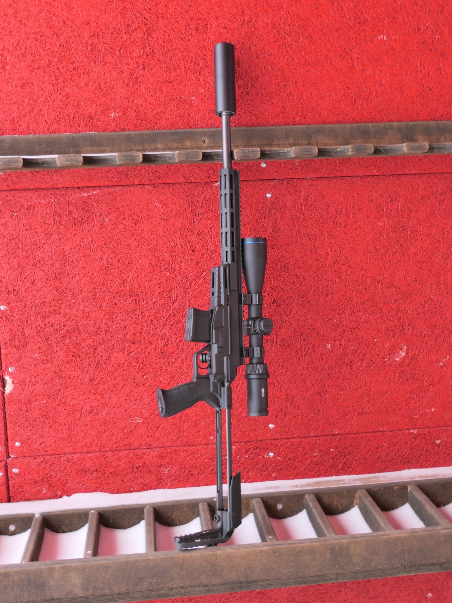

Wondering if anyone else has this problem- the stock collapses from the fully extended position when I fire the rifle. It stays extended if you hit it with the palm of your hand; it only collapses when shot. I’ve contacted CZ and it’s going back to get looked at.
I've only handling one in the shop and believe CZ has failed with the design. It sounds as if the latch is not engaging when extended, it may have a machining error or is something limiting it's travel?

I just purchased a CZ 600 Trail (300blk), I'm having the same issue. 4 shots suppressed and 4 shots unsuppressed and the stock collapsed every shot.
Was there any resolution from CZ on the stock collapsing?
Yes. I sent it to them and they fixed it; I think they replaced the entire stock assembly. They had it for about a month. They were very helpful and sent weekly updates.
Wonder if anyone has a found a solution to this that doesn’t include sending it back to CZ?
I have the same issue but only seems to happen with supers, not subsonics. Mine is 300BLK
