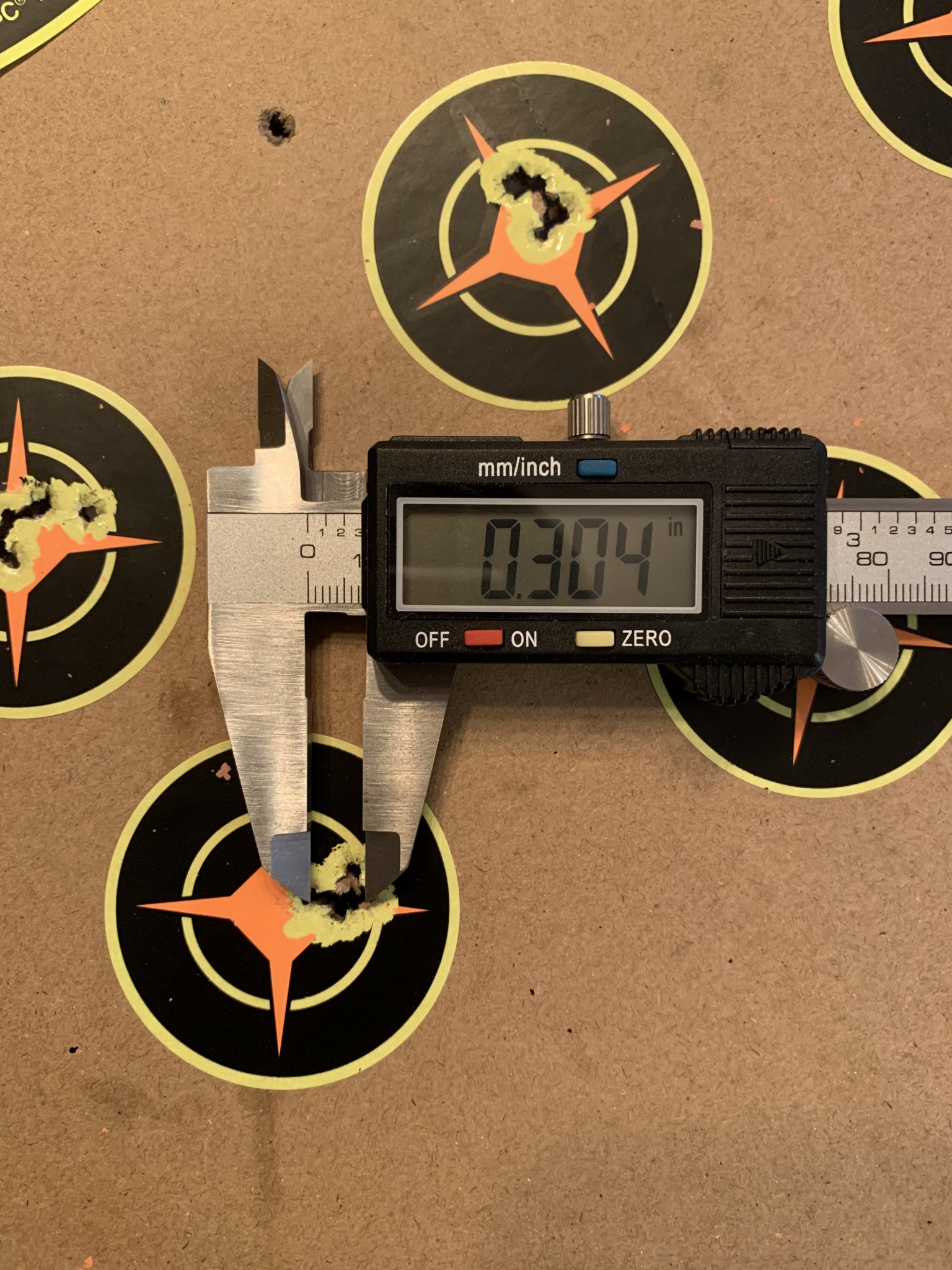

    Bought a used MTR and LOVE it. I planned on buying a scout and just using it for the receiver. Found a used MTR for $550 instead.
    .3” at 50 yards.
    I could get $300-350 for the mtr barrel and stock so I’d be into the receiver for $200-250ish

    View attachment 7810736Bought a used MTR and LOVE it. I planned on buying a scout and just using it for the receiver. Found a used MTR for $550 instead.
    .3” at 50 yards.
    That's some might fine shootin! That's what I'm after.

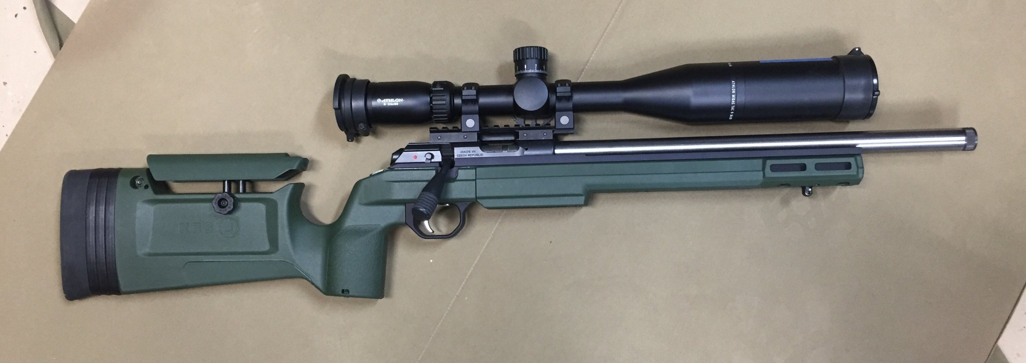

    That is what I did. Got a scout for $360, Walther barrel for $300 and KRG chassis for around $350. I wish I had gone with the Area419 rail mount, but that is a minor item and the EGW mount is reliable. Stock trigger, aftermarket knob. Currently has an Athlon MidasTac 4-24 on it and shoots acceptable 1/2” groups at 50. Sometimes better, most times in the .400-.600. I am satisfied with how this setup performs. The cz457 is a great upgrade over the 455/452 series as it corrects a number of issues while keeping a reliable magazine system. I would build this rifle again if getting another cz 22lr.
    LUV IT! I have that same scope on one of my guns...exceptional scope.
