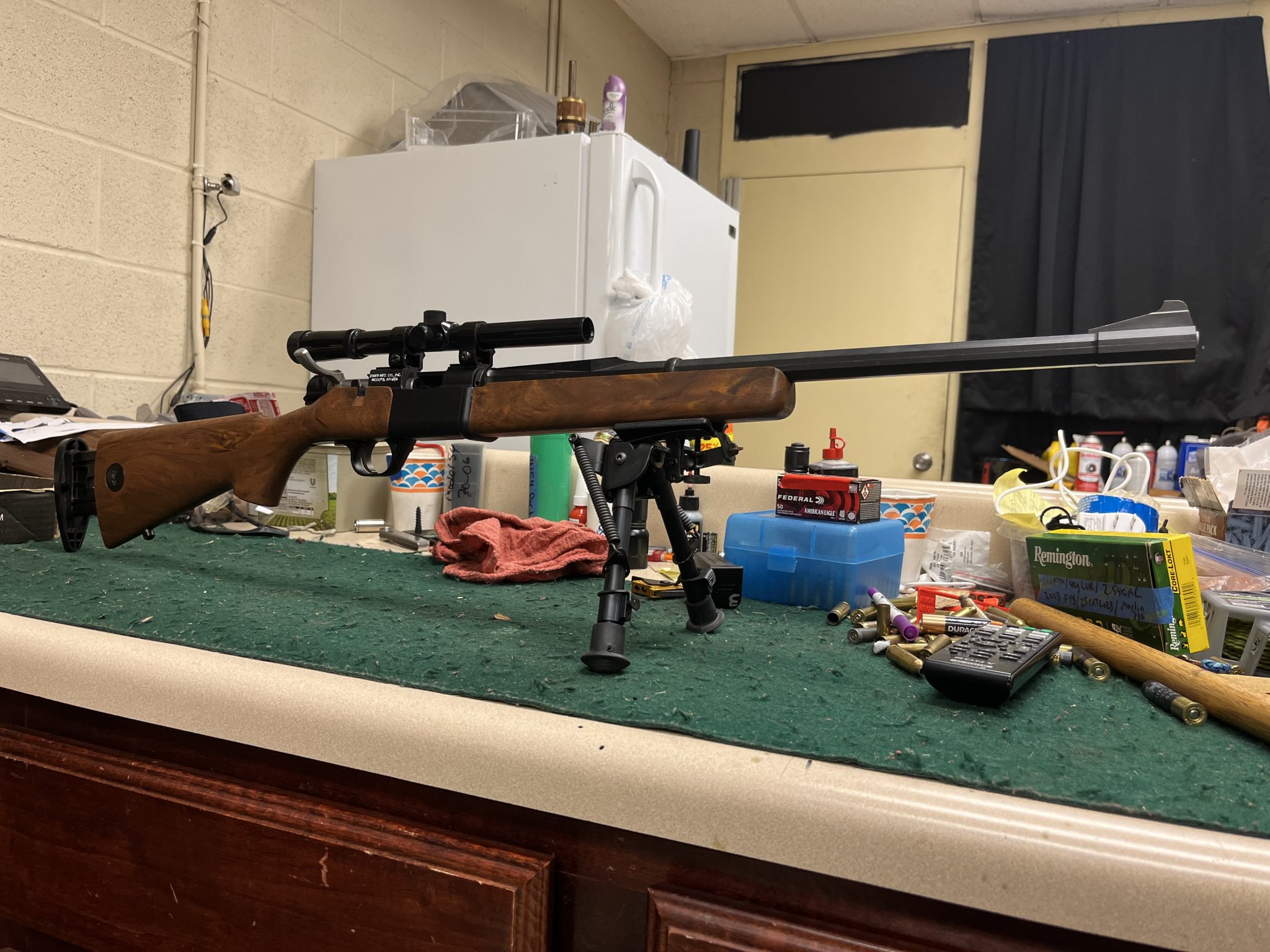

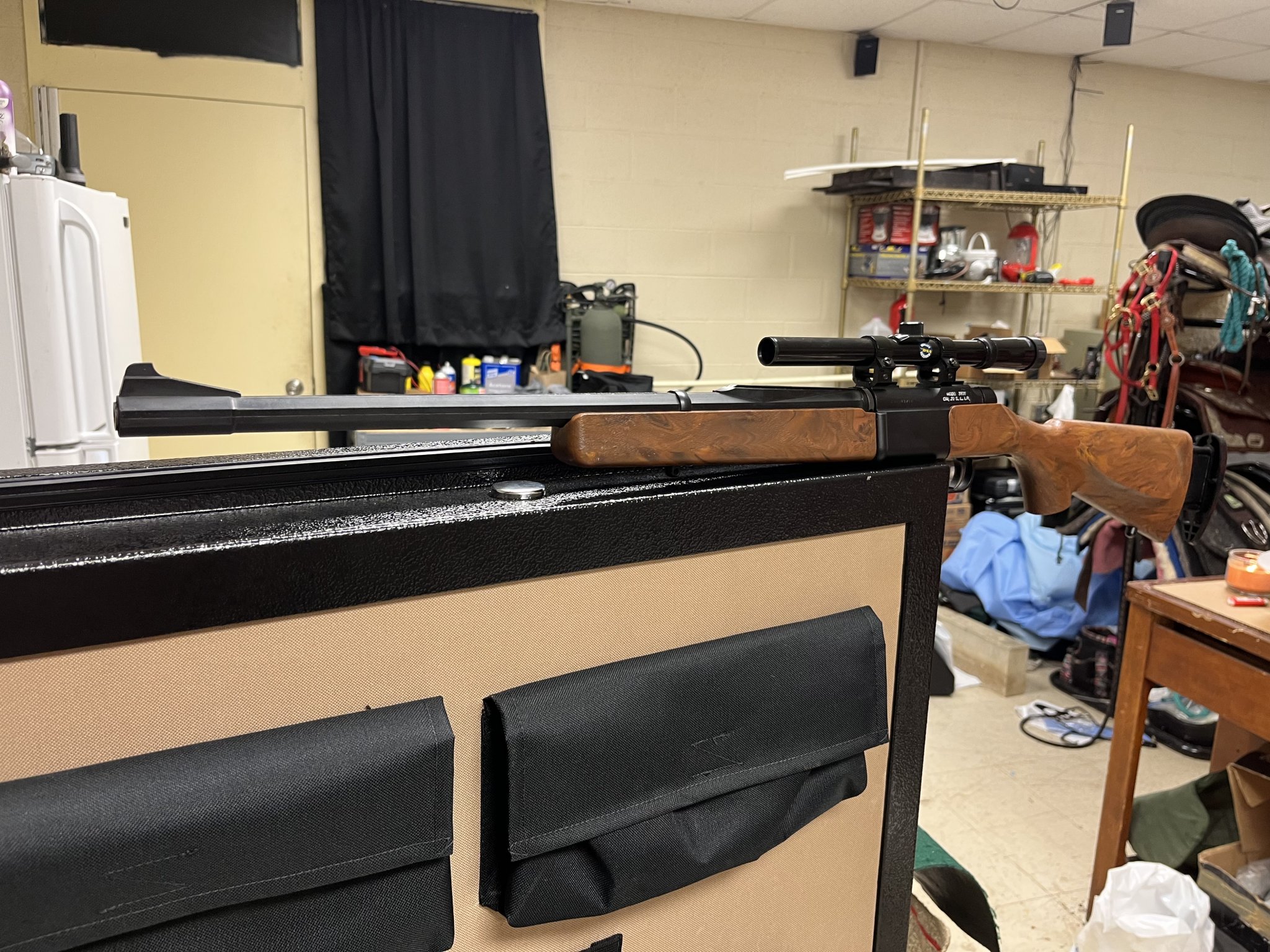

I’ve got a 2201 at the house. The stock coming off is as @Sum Ting Wong stated. It’s just a screw into the rear of the action for that part. The barrel is held on by that castle but looking thing kinda like a remage prefit. There is a plastic sleeve around a small metal barrel insert. When I get home this afternoon, I’ll go take mine apart and post some pics if you still need it.
I don’t remember any type of safety or bolt lock on mine, but it has sat in my safe untouched for a while now.

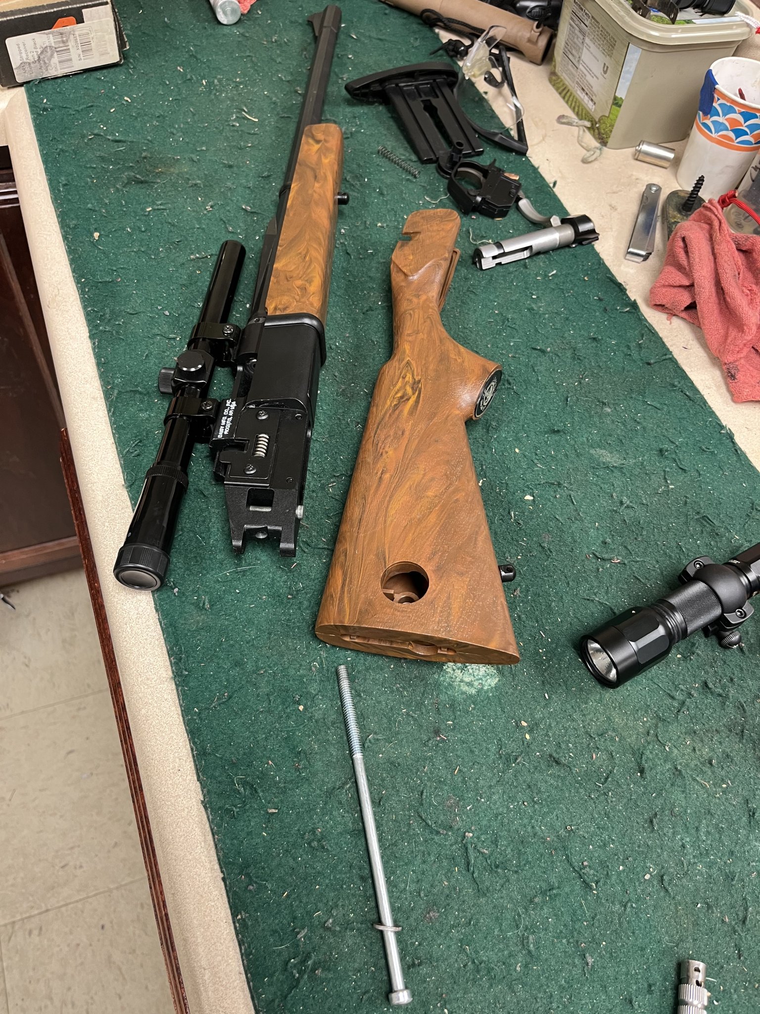

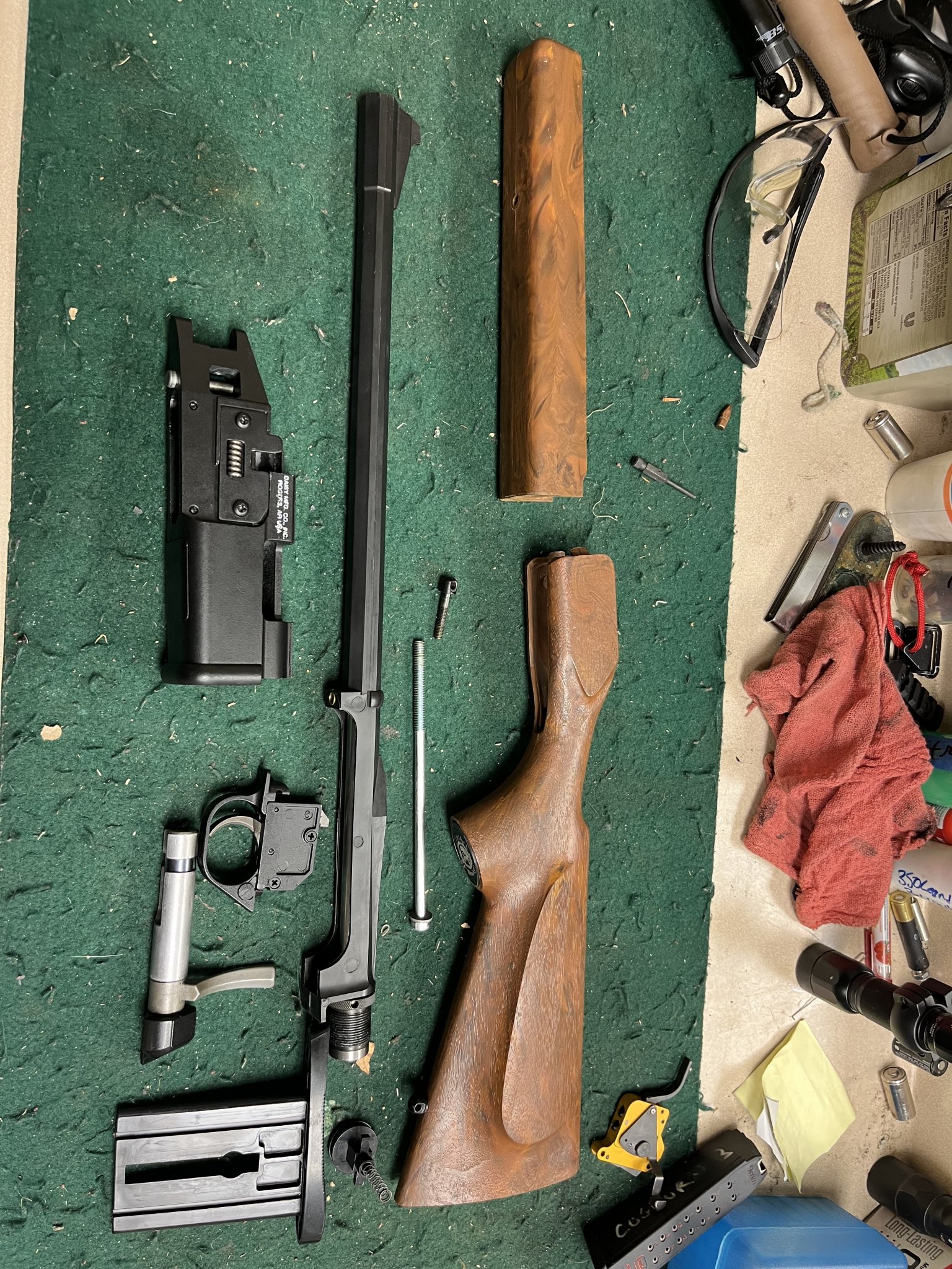

Ok step by step on how to tear it down. I’d probably start with the forearm and barrel in your case. Keeping it pointed in a safe direction.

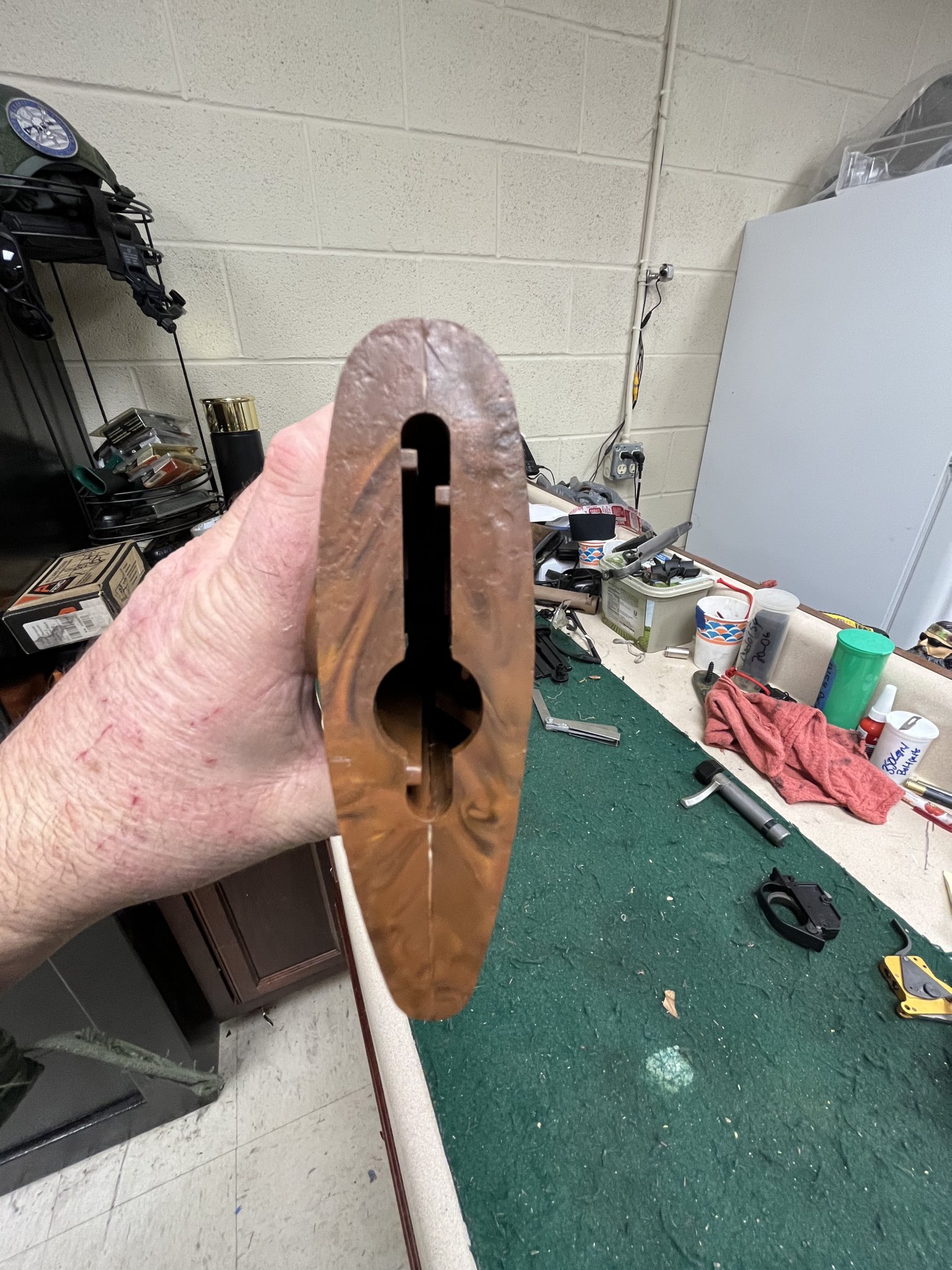

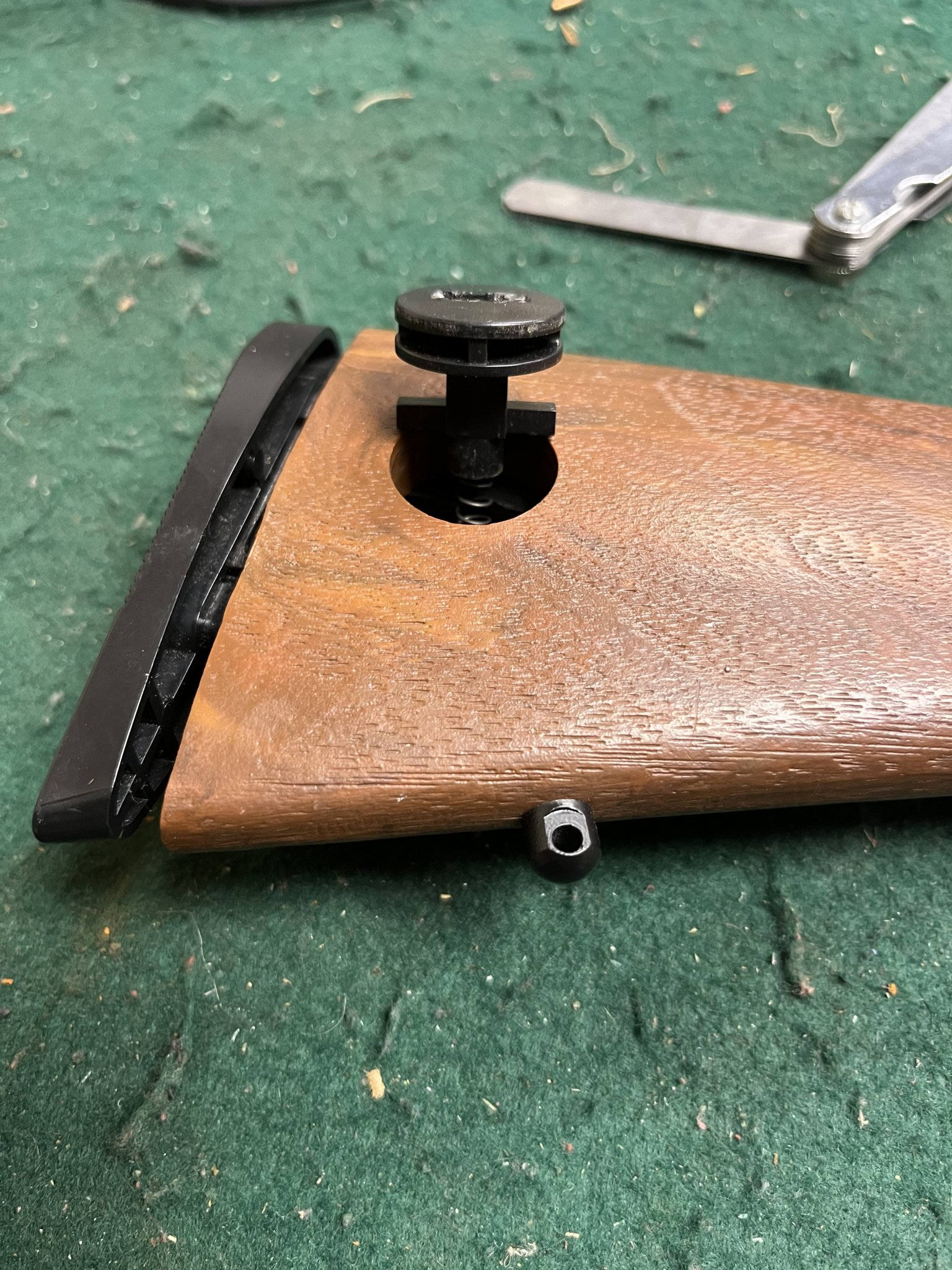

Buttstock: it has to be about 1/4 inch gap open to work. Push the lop button down slightly and turn CCW. Button will pop out with spring, recoil pad will slide out.
Remove phillps head bolt and remove buttstock. It slides to the rear and has tabs that mate with the receiver so don’t use your ape hands, be gentle.

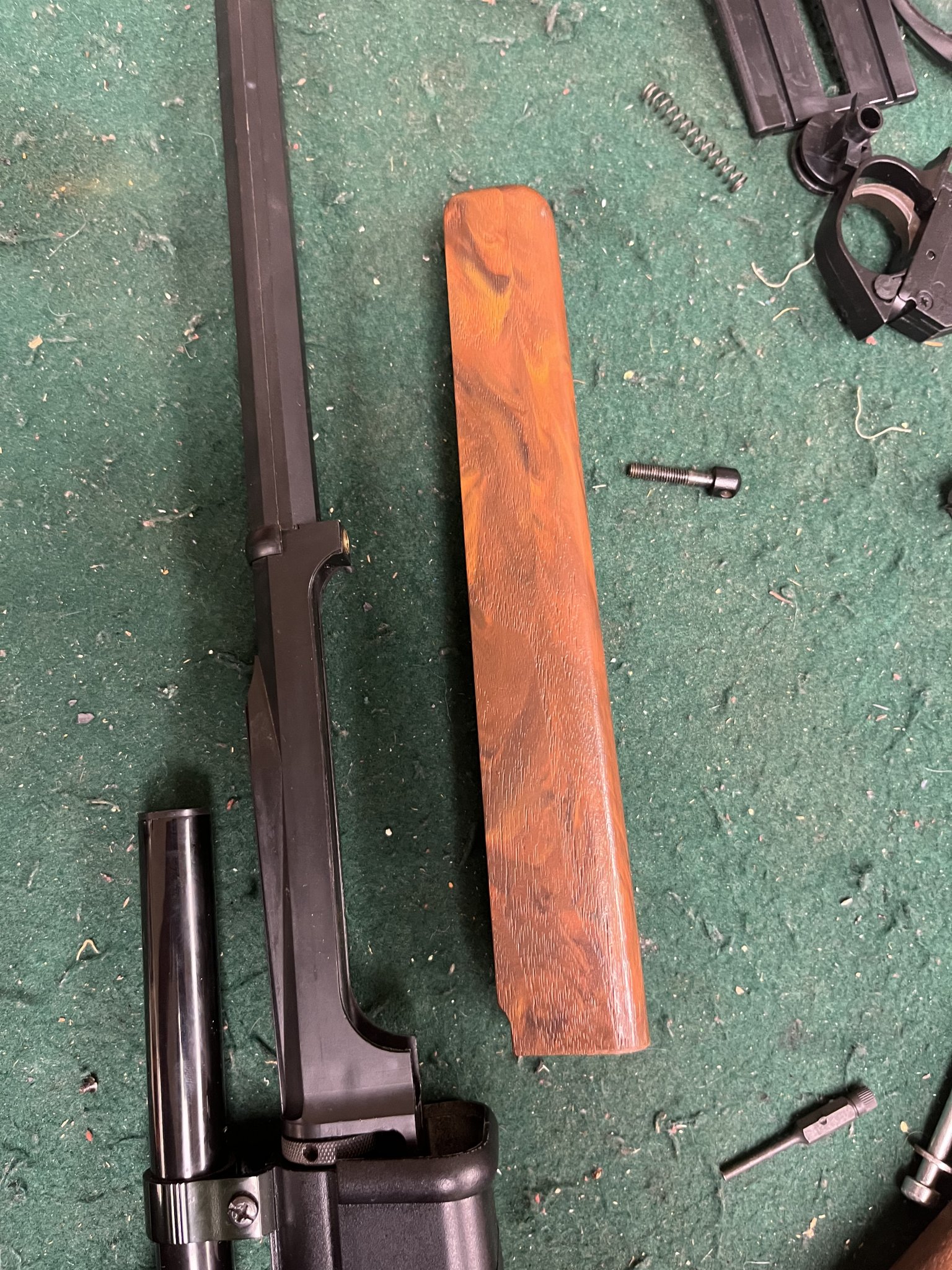

Remove forearm by taking the sling stud out. Pull forward and down.

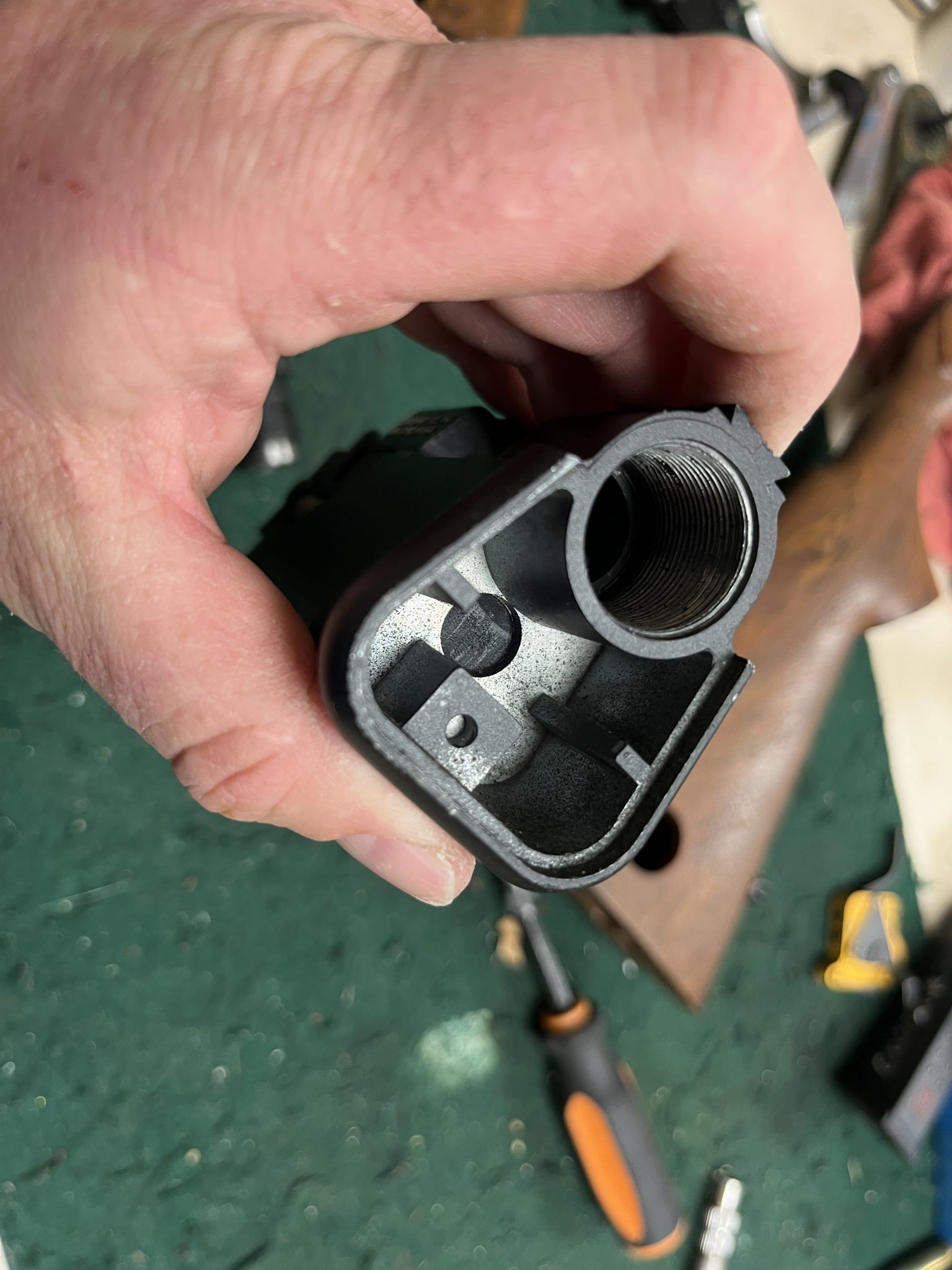

The barrel is held on by the knurled knob, I use a punch and take it loose. It shouldn’t stupid tight or your bolt face and breech face will be too close. It has alignment tabs on it that mate with the receiver as well.

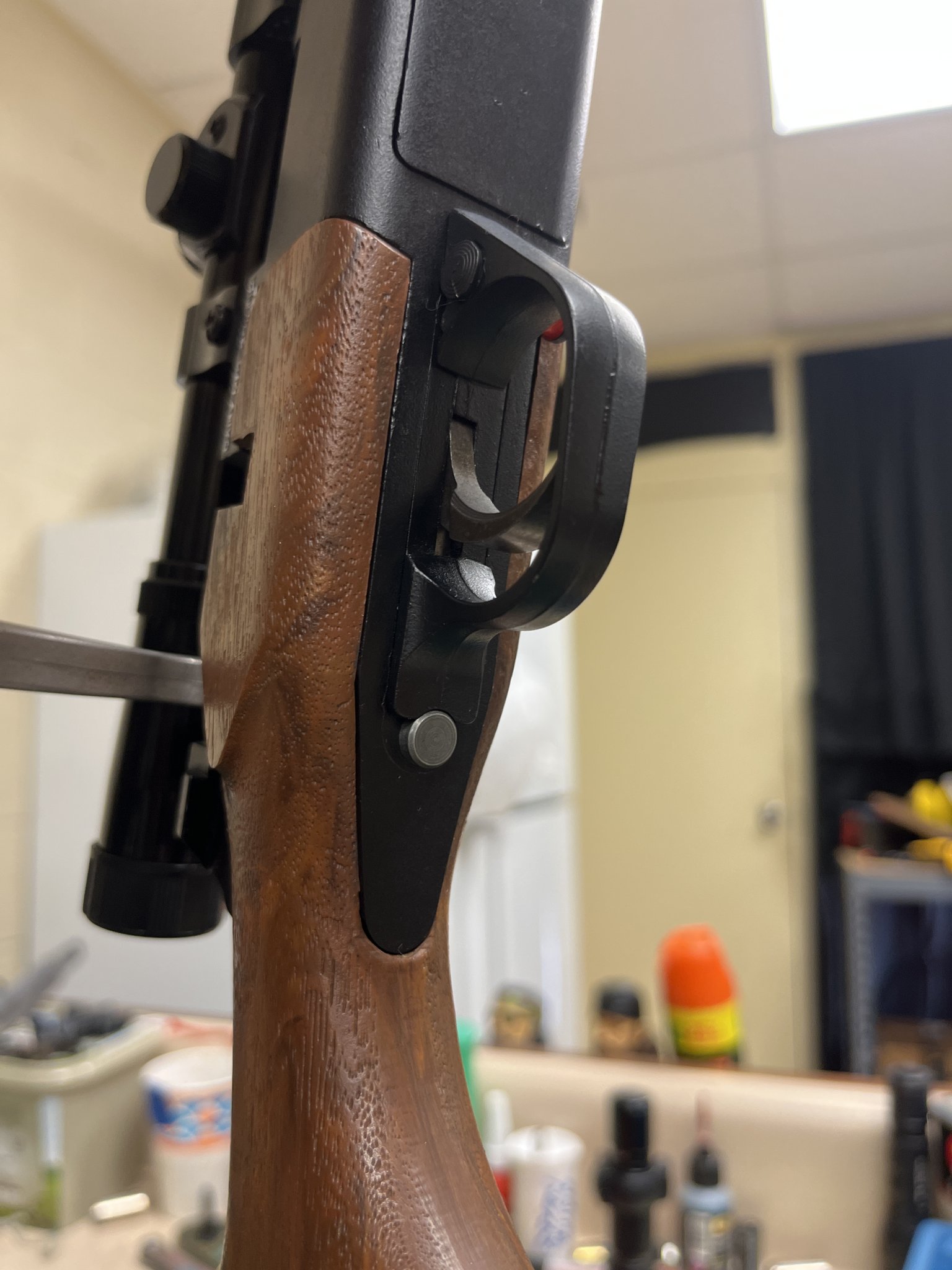

After you figure that out and see if the bolt will move. The bolt has to be pulled back like you are cocking to get the trigger out. Push the little button down and slide the entire trigger pack rearward, it will fall out. The bolt will slide out the rear
Gun should be completely disassembled and ready to clean. Reverse steps to put back together. Give me a shout if you need help
PS
Don’t take that little side plate with the spring in it off. Those parts from my understanding are some of the hardest parts to come across for this model.
