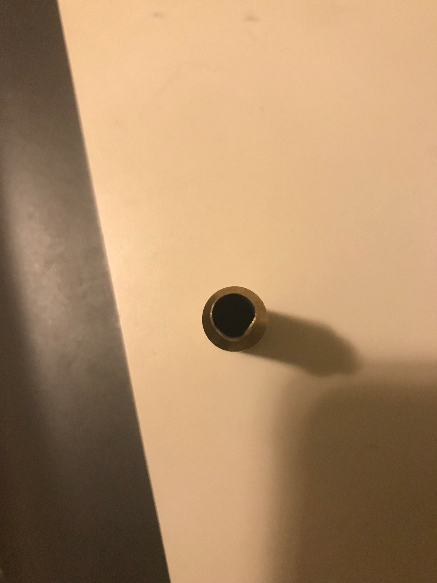

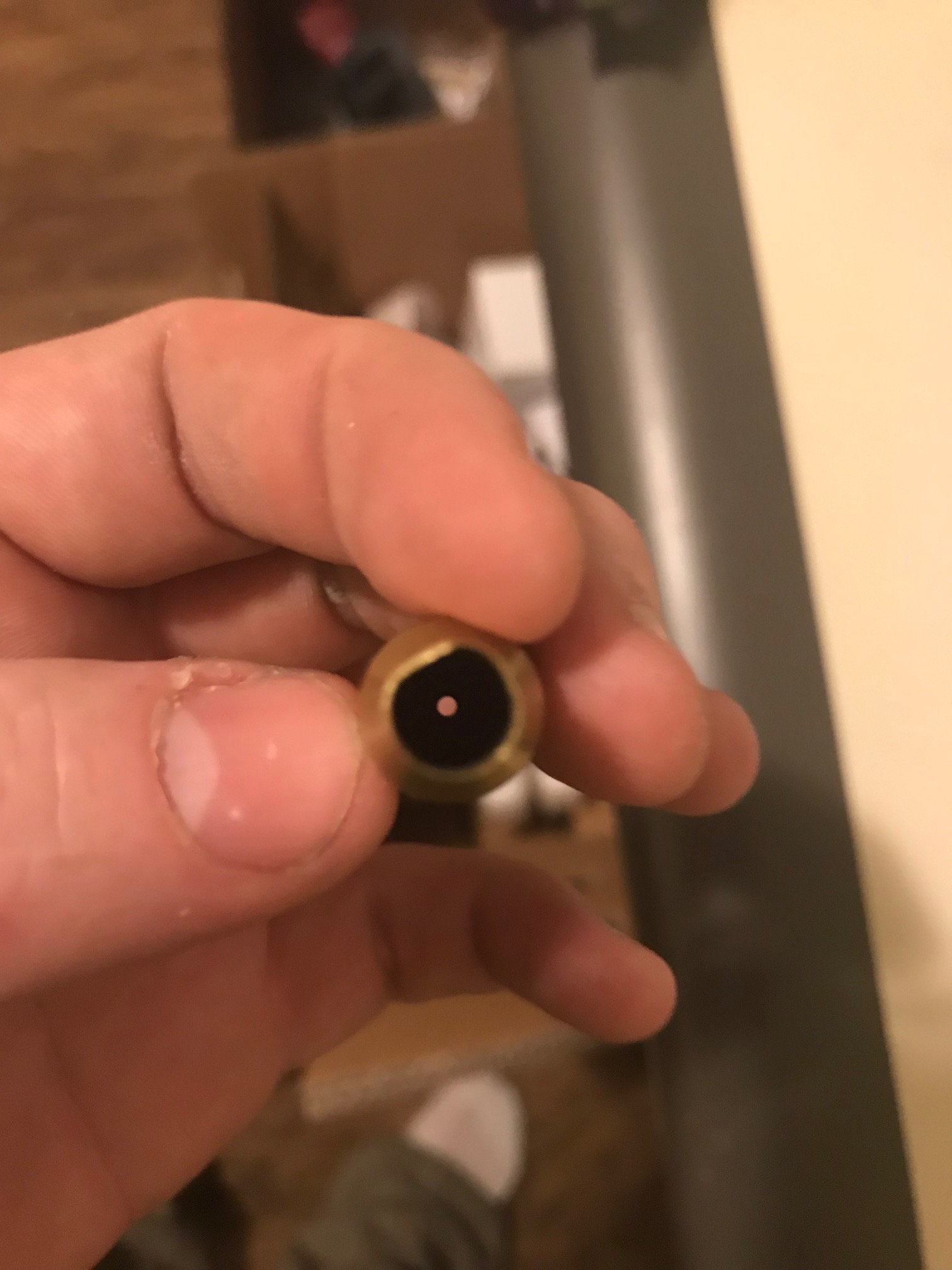

I don't know for sure if this is a reloading issue, or an ejection issue, so I am looking for advice. I am not sure what is happening, but I am having dents at the end of the neck after I eject the case. This has happened to 3 of the last 30 rounds I have fired.
This is twice fired Peterson SRP 6.5 CM Brass loaded with 41.4 GR of H4350 seated with 140 GR ELD-M @ 2.198'' to the OGIVE. No other pressure signs, and I have shot this same round without pressures signs up to 42.2 GR of H4350. I am using an AI 10 round mag.
Could this be an ejection issue? A mag issue? Or a reloading issue...

Look at the windage knob on your scope look for brass,knicks etc on the knob...chamber a fired case and watch from a low view and see if brass is hitting your scope....I had the same dented necks and that was the problem may be your too.
I do not pull the bolt hard, this was at a normal day at the range. I catch the case before it ever leaves action.
Nothing to do with pressure. If you are seeing this at the range it is happening on ejection some way. You don't have to pull the bolt hard it is the ejector spring that flips it into something. Maybe the edge of the chamber, maybe the side of the action, maybe something else. If you are not seeing it until you get home it could be happening inside wherever you are putting your brass or while tumbling.
I saw it as soon as it left the action... I am guessing the ejector is causing it to hit something on the action. What could I do to try and find that location?? And what would I do if I found it?

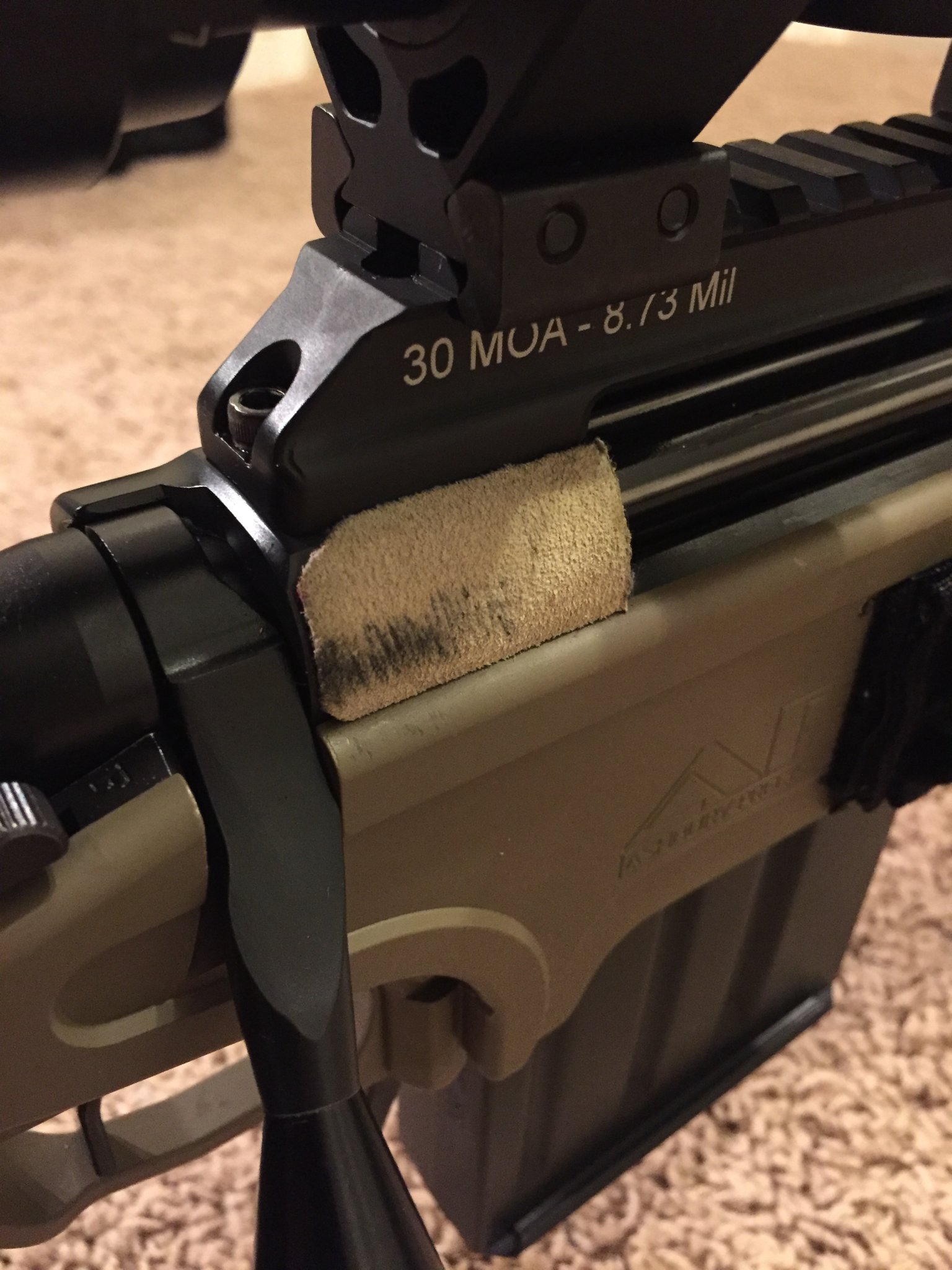

I took a little off my spring as well. It is a PTG bolt so I got the spring from somewhere but man it was stout. Still is pretty stout. I had to put some leather/suede on the receiver to keep the brass from chipping off the cerakote!
