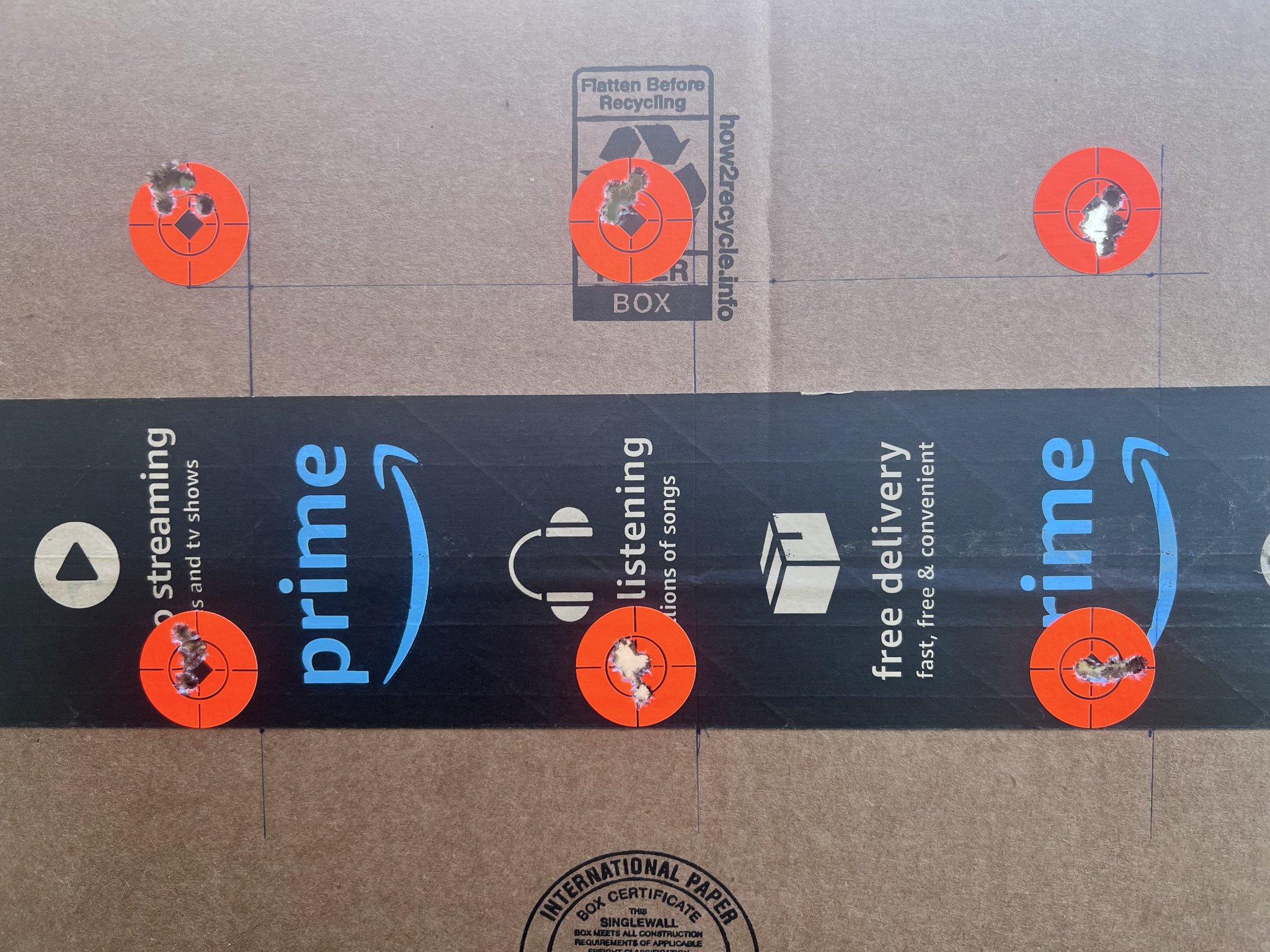

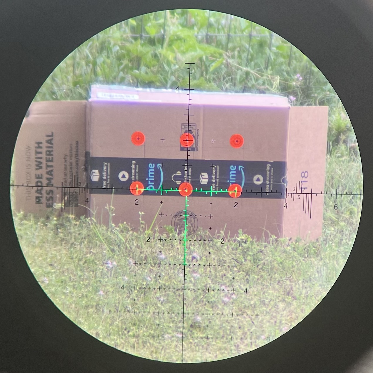

I've attached 3 more images from a quick tracking test. Point of Aim was the lower right target for all 6 groups. 5 rounds on each, shot from upper-right across to upper-left, then down to lower-left and back across to lower-right. Range @ muzzle was 50.5yds. B-14R isn't great with Eley Tenex, all 30 shots are @ 0.8" (1.6MOA).

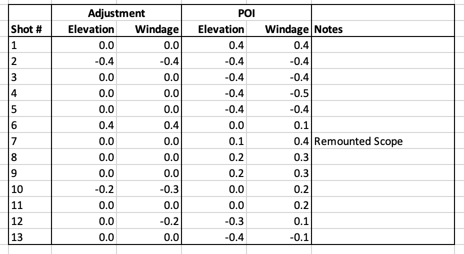

I fired sub-MOA groups @ >600 yards on Saturday, then drove around feeding cattle with the rifle in the passenger seat. I later missed two shots @ 250 yards on two different coyotes & knew something was off. I figured I just bumped the optic & lost zero, so I fired the 13 shots in the chart & recorded the results. I remounted the scope after shot #7.
Does the attached shot progression look like the results from a damaged optic? Or could this be the result from an improperly torqued stock?
I have >700 rounds through this .308 Win M700 5R, ~650 being hand loads. This rifle is my ranch gun & sees more abuse than use. Despite that, has consistently shot ~0.3 to 0.4 MOA through multiple optic changes & removal/reinstall of the factory HSP stock (bedded in 2009 @ ~100 rounds). I also double checked the COAL/CBTO/shoulders on the remaining 50 rounds from this batch of reloads, they're to my specs.

I'll add the following: Shot #1 was cold bore, but a 0.4mil/0.4mil POI shift for cold bore would be far greater than typical. There are about 150 116 rounds through the barrel since the last cleaning. The 13 rounds were fired pretty slowly, so the barrel never got warm. I'm using Varget, so 20 F temp swings shouldn't matter in that department.

I compared the POI to the anticipated POI following each of the adjustments. If I did the math correctly, there's a 0.8mil height variance & 0.5mil windage variance... on a gun that typically shoots around 0.1-0.125mil groups.

This essentially was an informal tracking test, no? Assume I have a perfectly accurate rifle & I achieve the following:
POI 0.5mil low, dial 0.5mil up
POI 0.3mil low
Then the scope isn't tracking; it's off by -0.3mil following the second shot
right?
