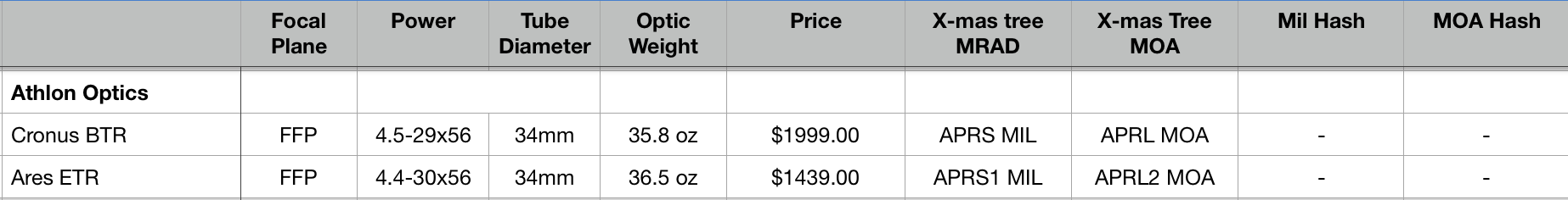

The only way to list these that made sense was Alphabetically, so we’re gonna start with Athlon
Athlon Optics
https://athlonoptics.com
They have several scopes that make this list. I’ve heard good and bad about their optics, but can’t say that I’ve ever shot or examined one in person. Any feedback either positive of negative would be appreciated. Again I’m just reporting on scopes that meet my criteria as explained earlier.

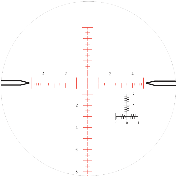

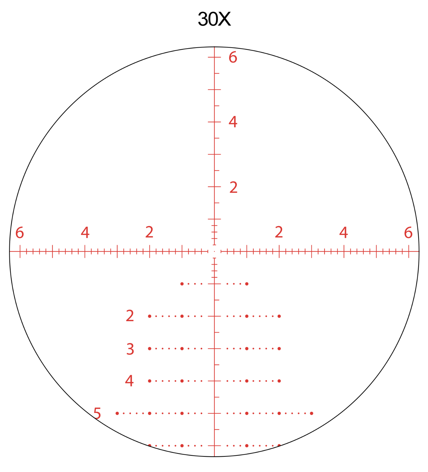

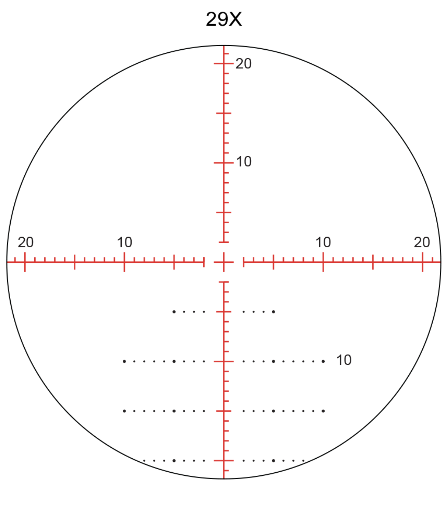

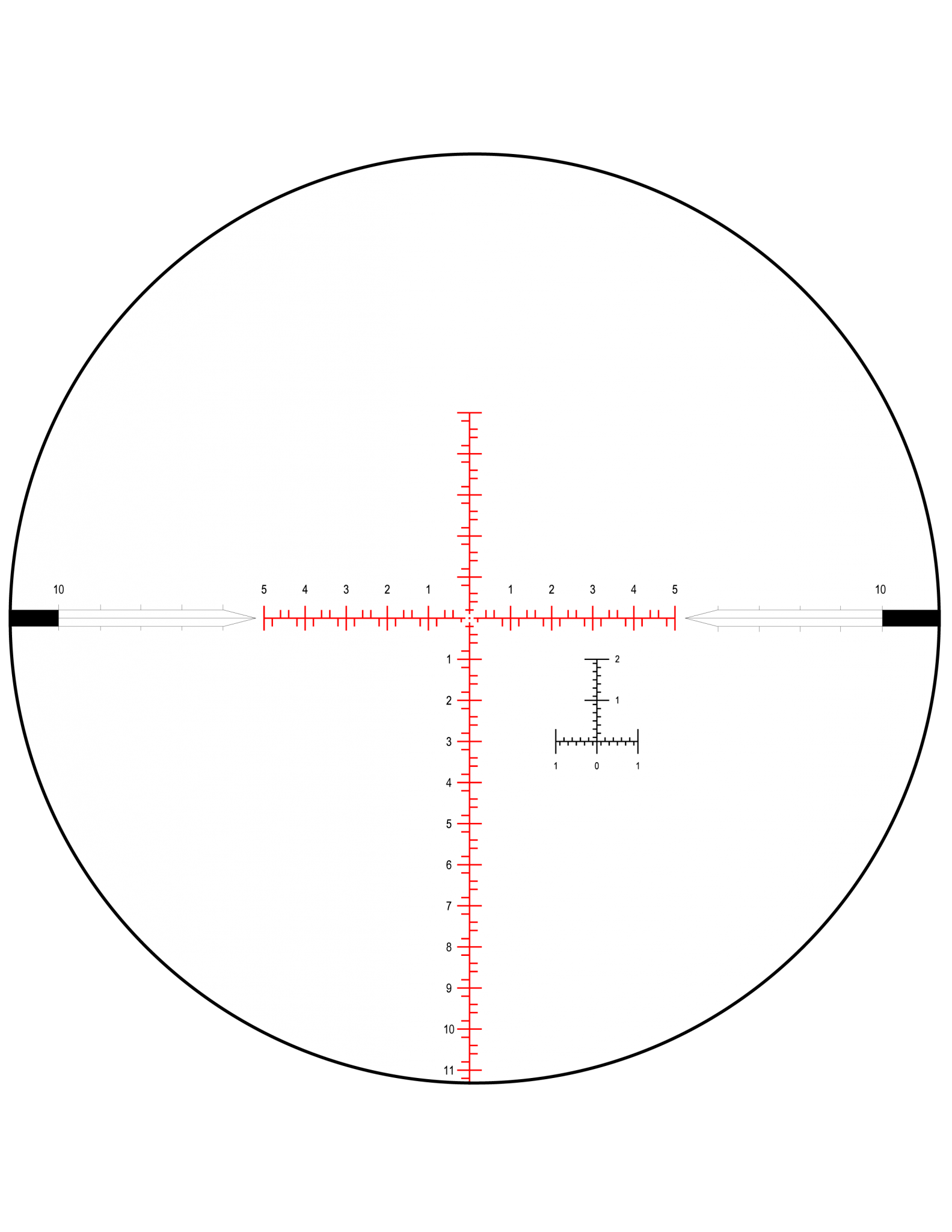

The Cronus comes with either the APRS MIL or the APRL MOA reticle.
APRS MIL
APRL MOA
The Ares ETR comes with either the APRL1 MIL or the APRL2 MOA reticle
APRL1 MIL
APRL2 MOA

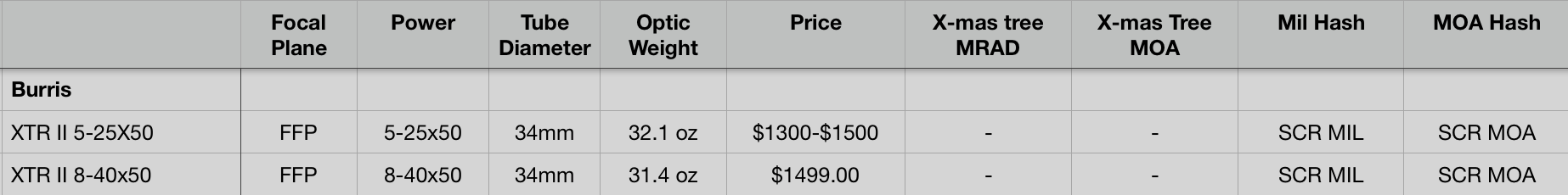

I have never owned or shot a Burris. I can’t say much about quality or longevity. I’d love some feedback on this line.
The Burris XTR II 5-25 and 8-40 both come with either the SCR MIL or SCR MOA reticles.

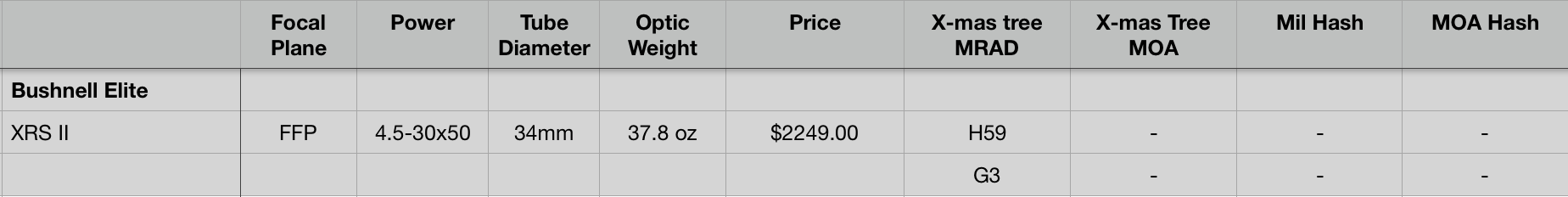

The new Bushnell Elite XRS 4.5-30x50 is a pretty nice scope. I’ve examined one, looked through it in different conditions, and feel like it’s pretty solid. I’d be interested in reports on how it tracks, and how well it holds up.

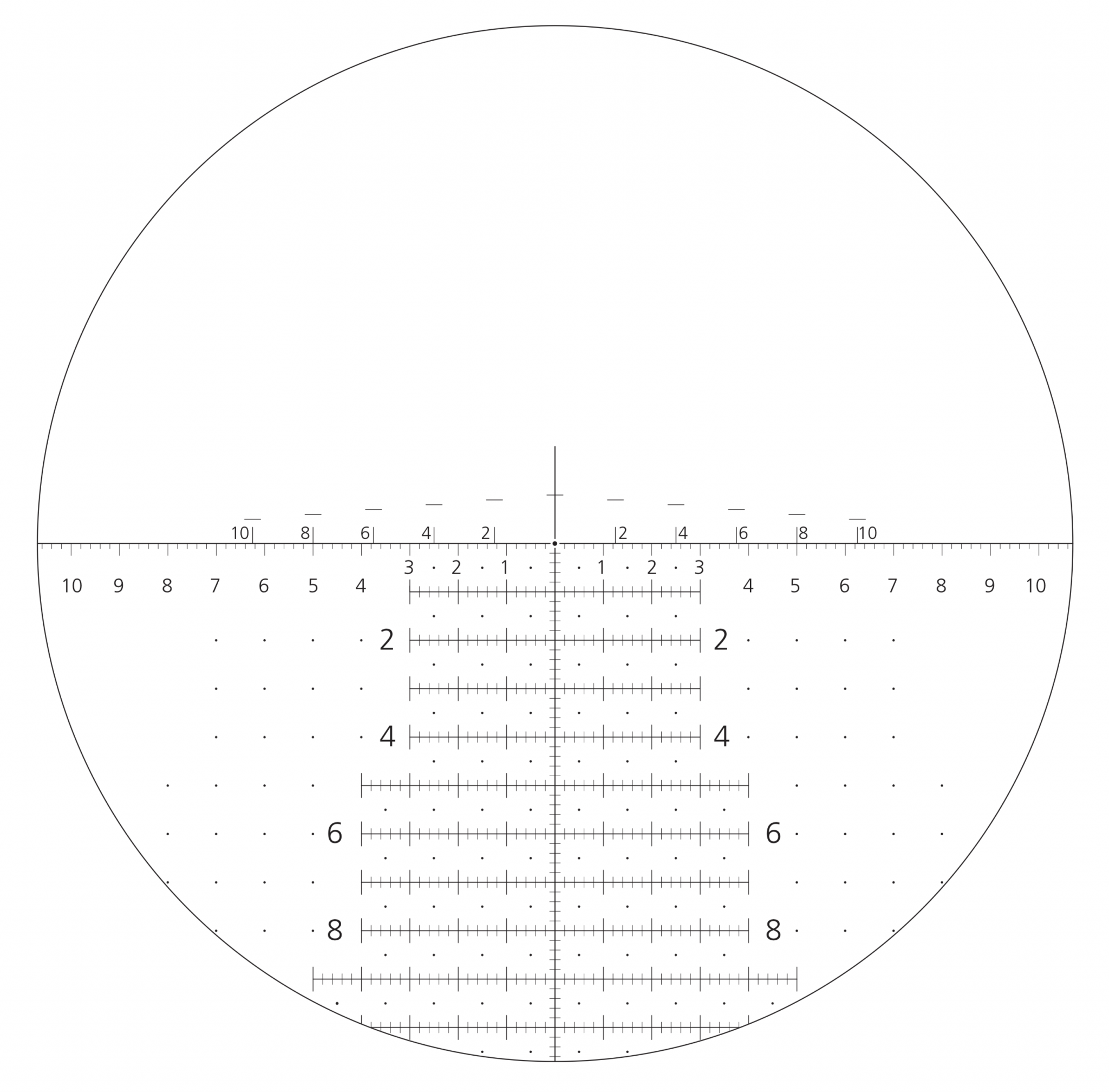

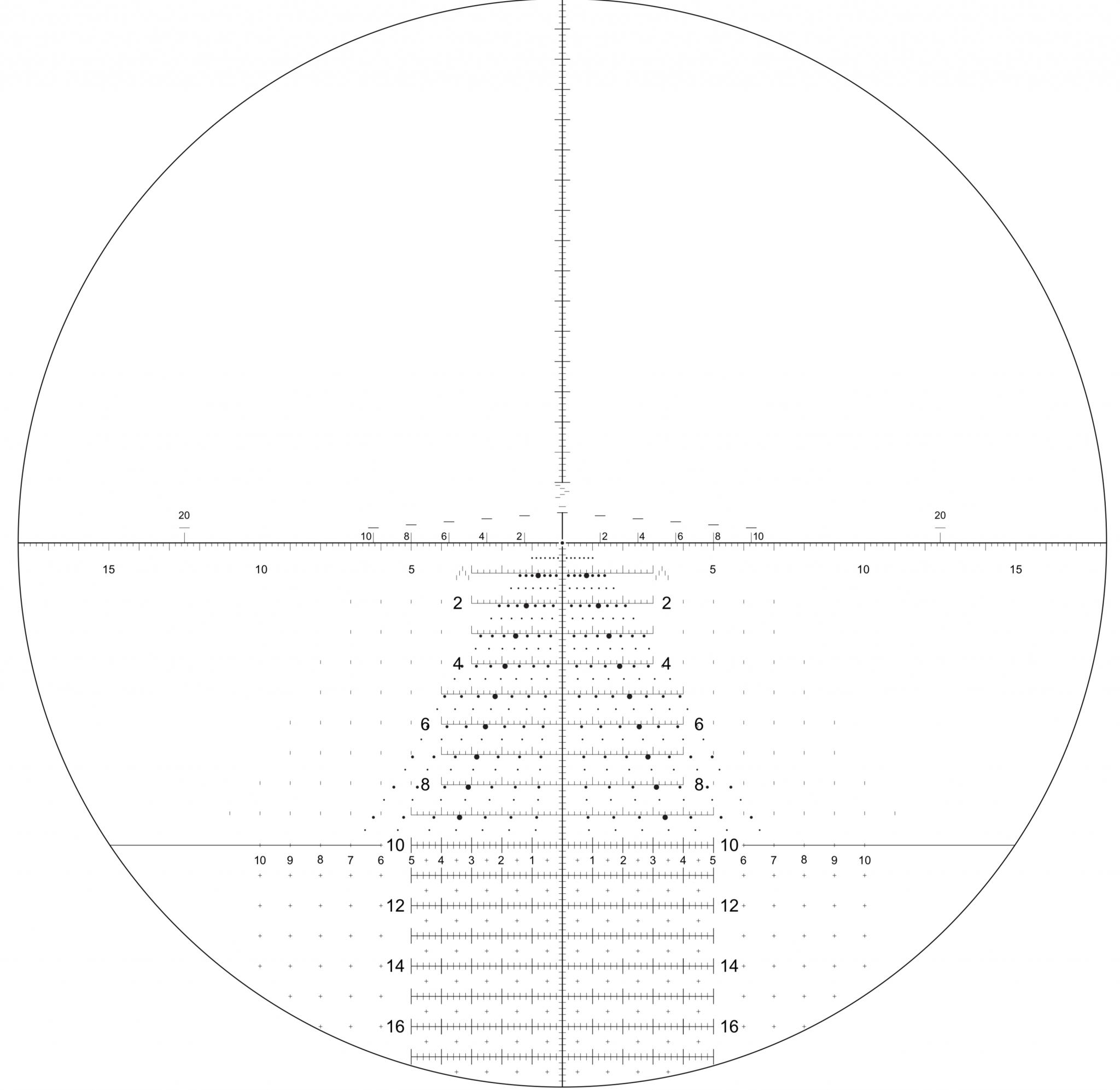

The Bushnell XRS II comes with either the H59 or the G3 reticle.
Horus H59

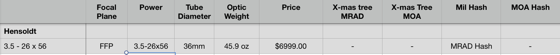

The Hensoldt is likely the most expensive on this list. I have read in the SH forums about the quality of the optic and the clarity of the glass. Never held one – so I’m just going off what I’ve heard, but I don’t think quality is the issue here. Personally, the lack of reticle options is what would hold me back from buying, well that and the price.

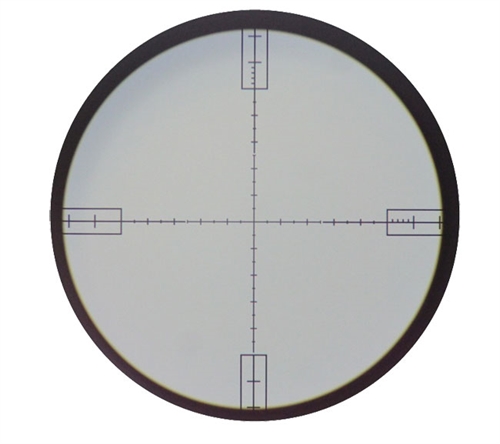

The Hensoldt 3.5-26x56 comes with an MRAD hash reticle.
(this is the best pic I could find)
MRAD Hash

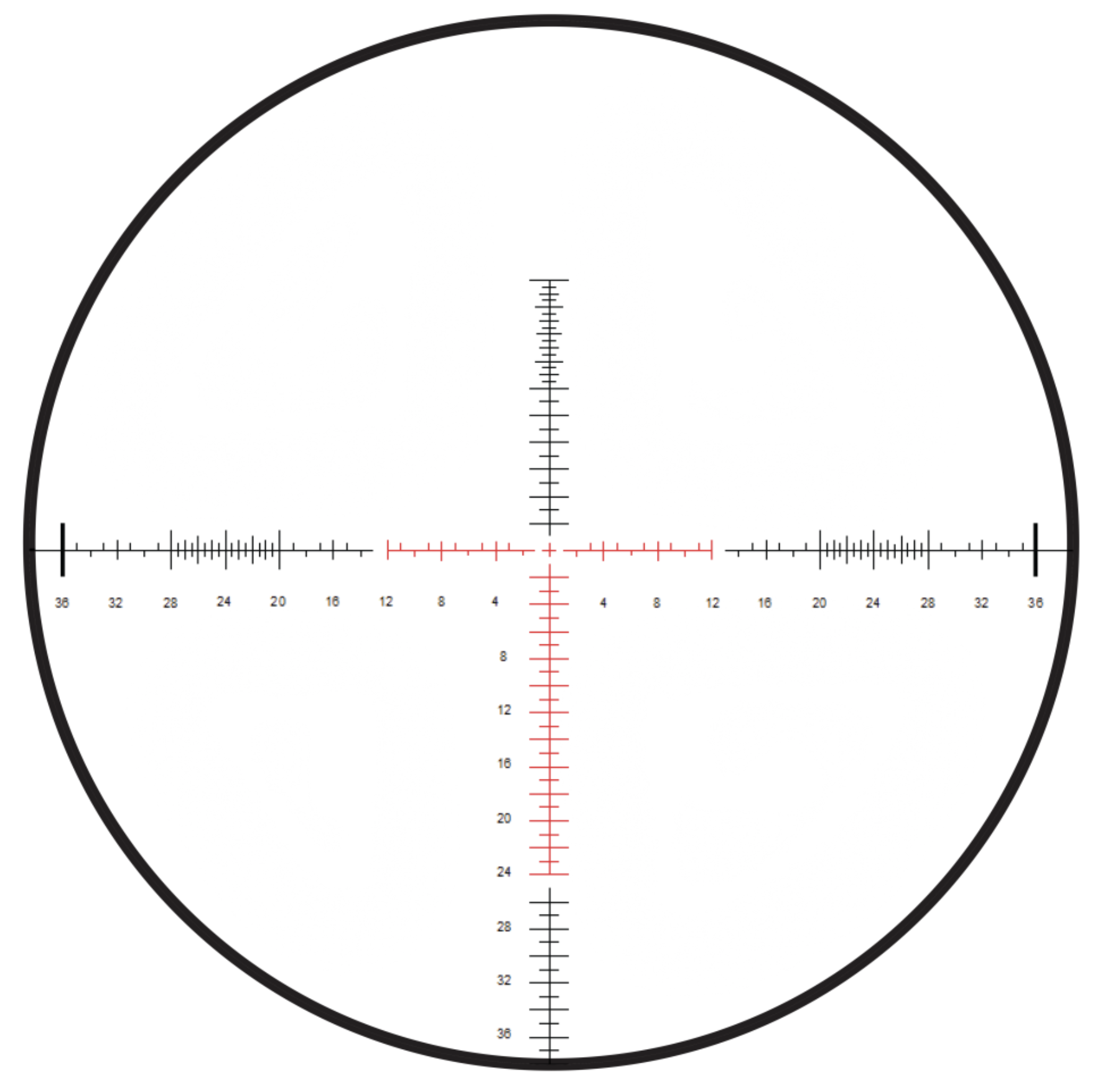

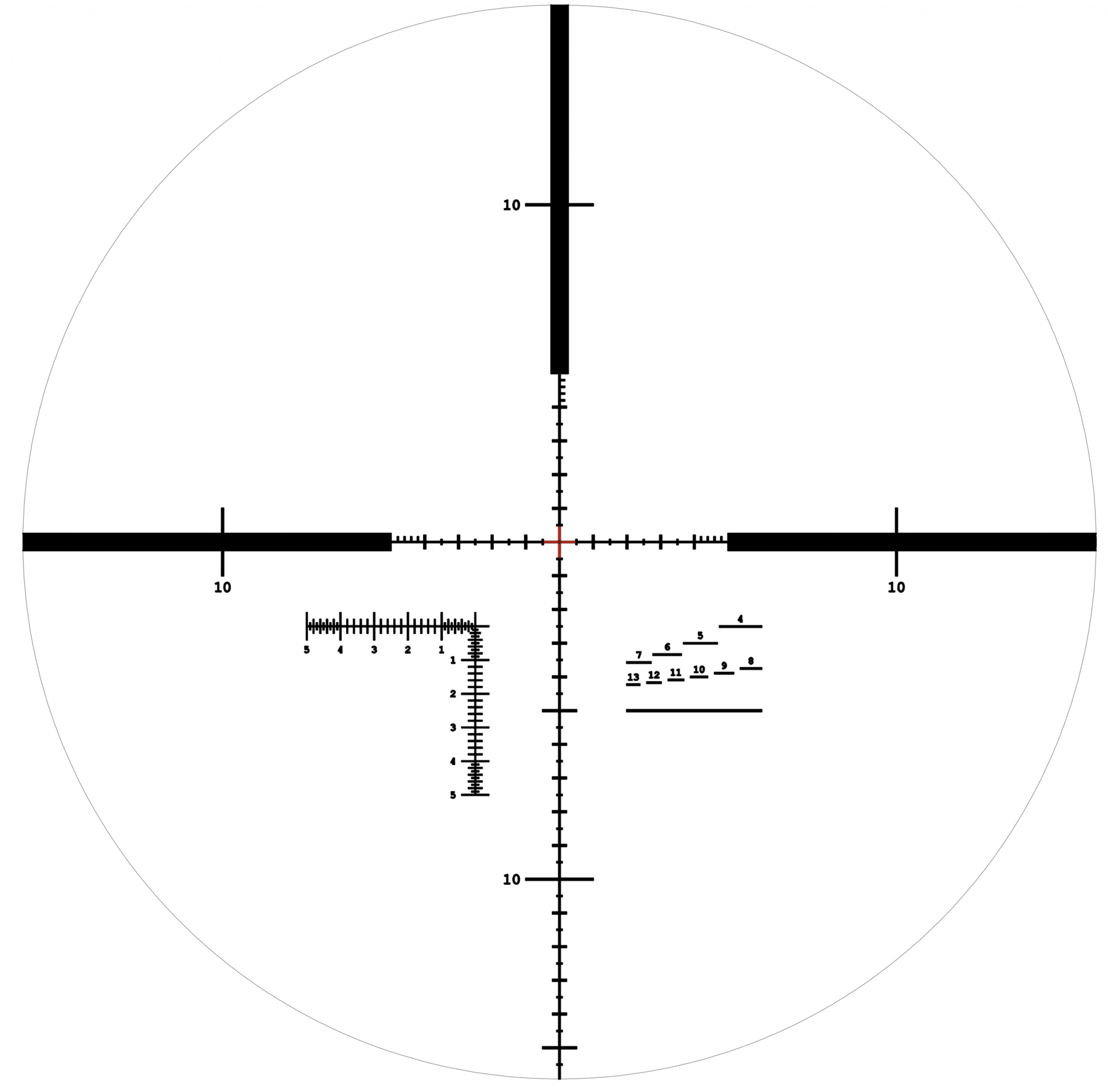

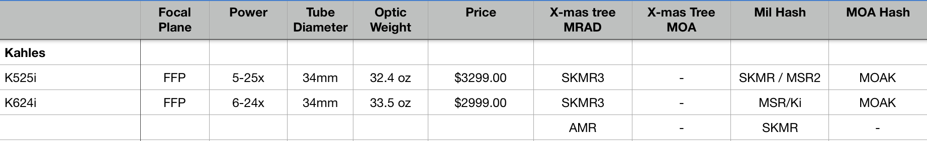

Kahles has 2 scopes that make my list, the K624i amd the brand new K525i.
They are solid contenders, and offer a variety or reticles and options for the tactical shooter. I have never heard anything bad about a Kahles. I haven’t owned one, but I have looked through a K624i and it’s pretty sweet.
Both the K525i and the K624i come with options as shown below.
SKMR3
SKMR
MRS2
MOAK

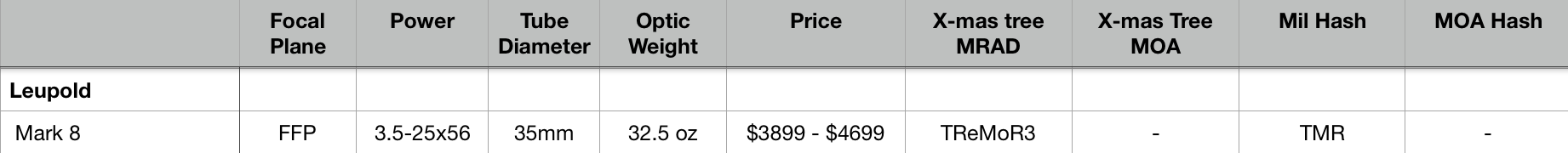

The Leupold Mark 8 3.5-25x56 makes my list.
Leupold has been around a long time, they at one time pretty much owned the US higher end market for hunting optics. They have lost a lot of ground to newer competitors, but are coming back into the tactical arena in recent years. They have been used extensively in the military, and quality has always been good. Any reviews of the Mark 8 would be welcome.

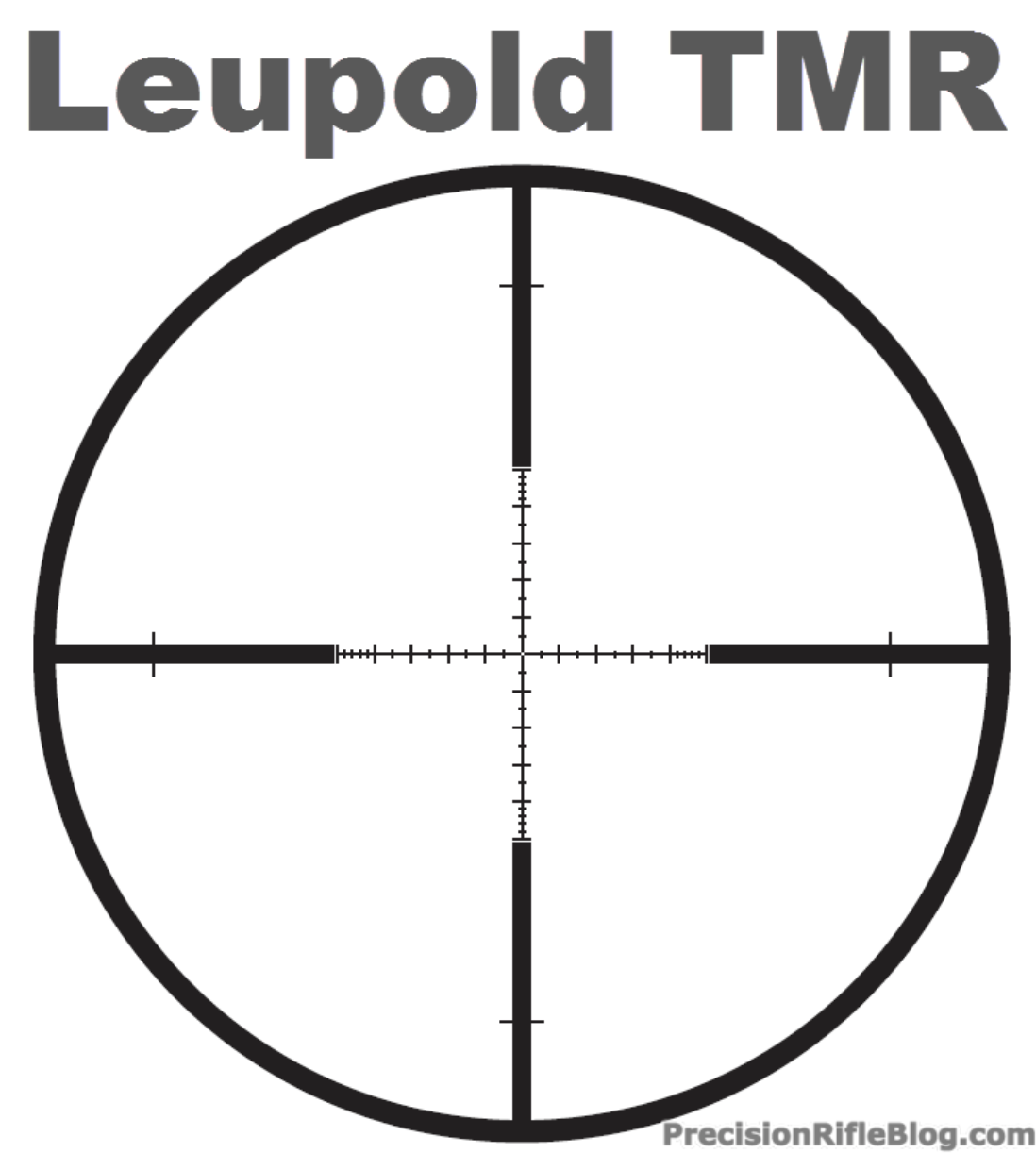

The Leupold Mark 8 3.5-25x56 comes with either the Tremor 3 or the TMR reticle.
(other reticles may be available)
Tremor 3
Leupold TMR

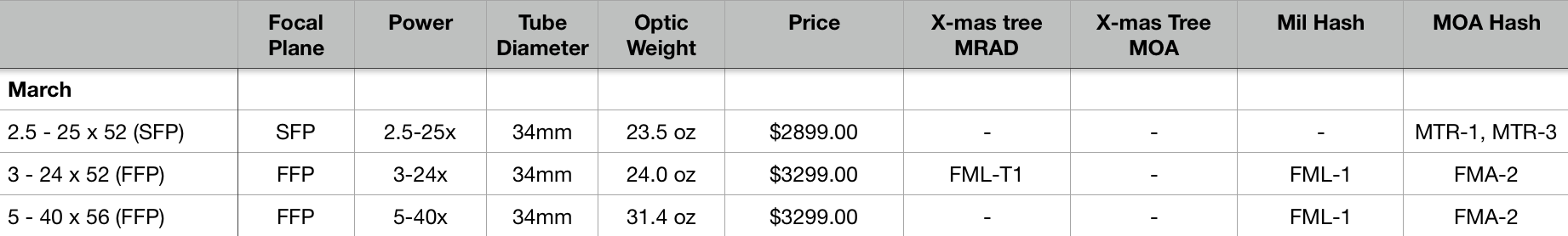

March Optics
http://marchoptics.com/#/

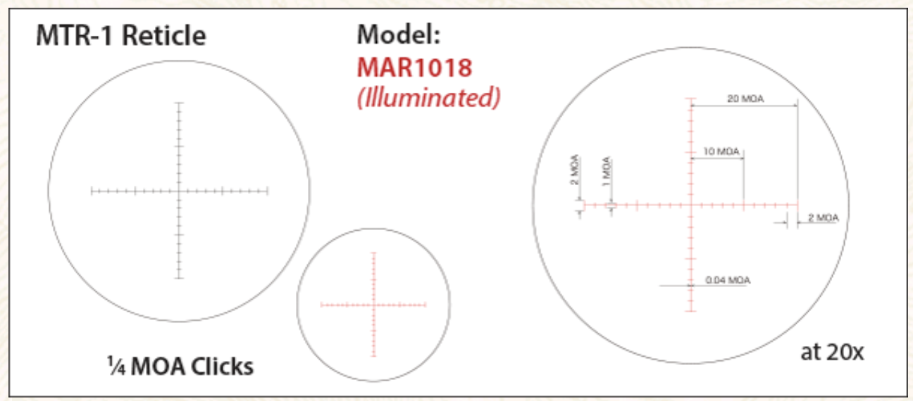

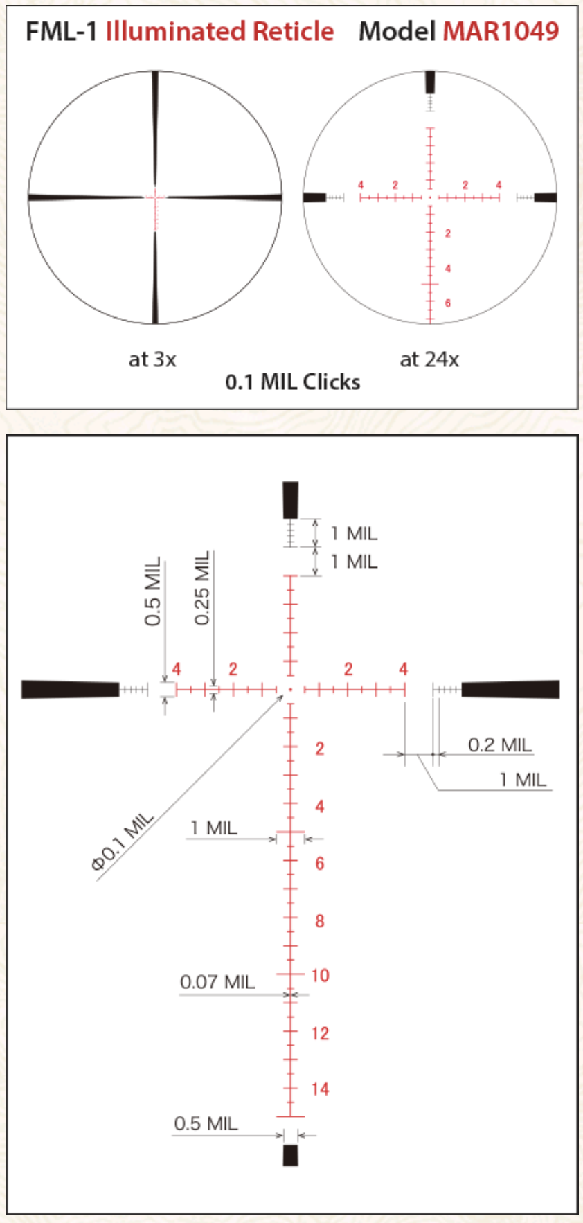

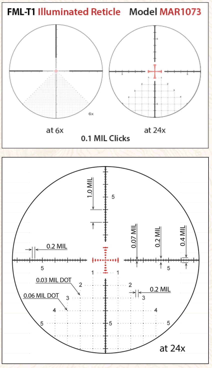

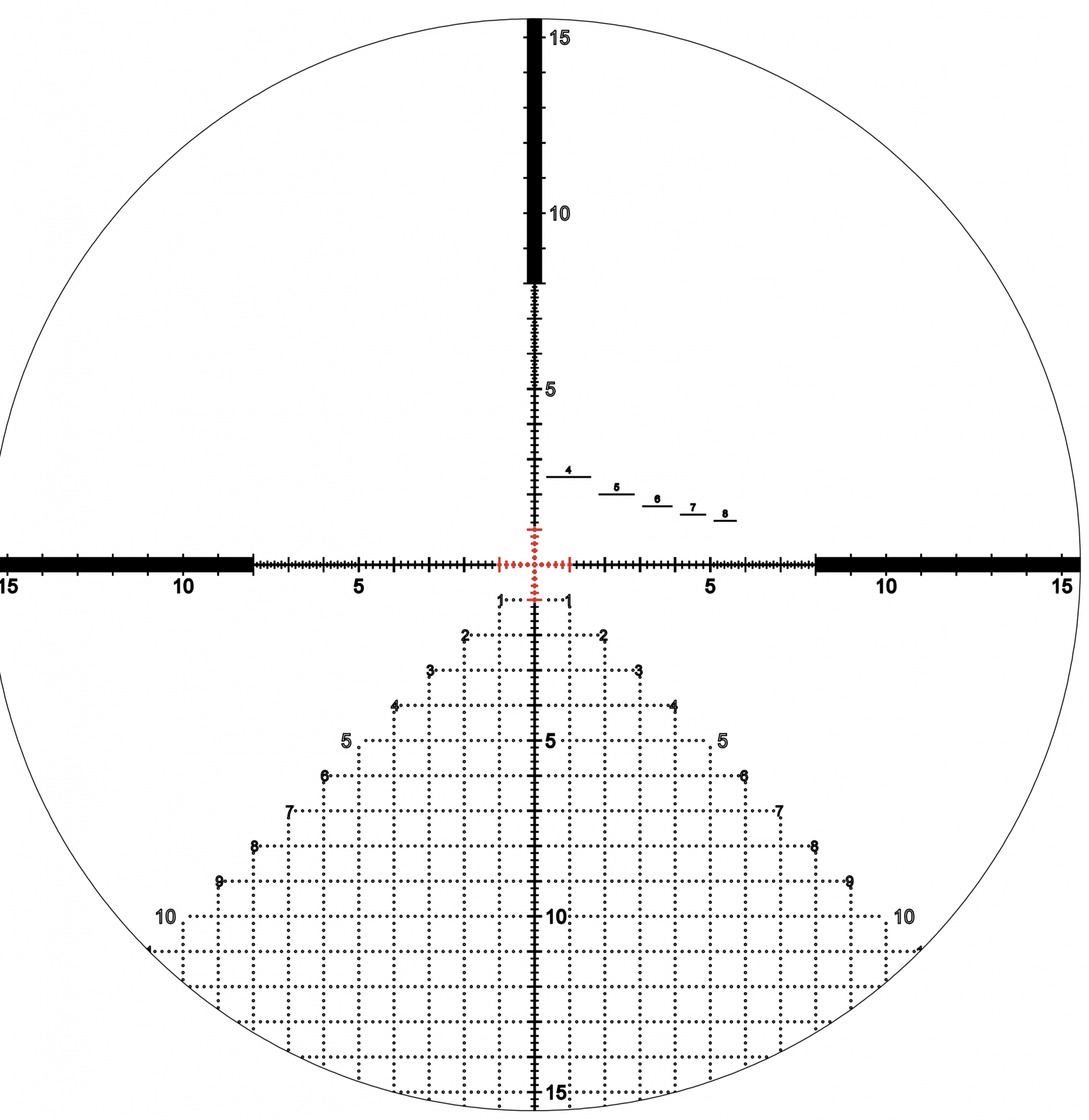

Several March Scopes make my list. March makes good optics, and their glass is top notch. I have a buddy that has a 5-40x56 and he loves it. Its clear, and seems really well made.

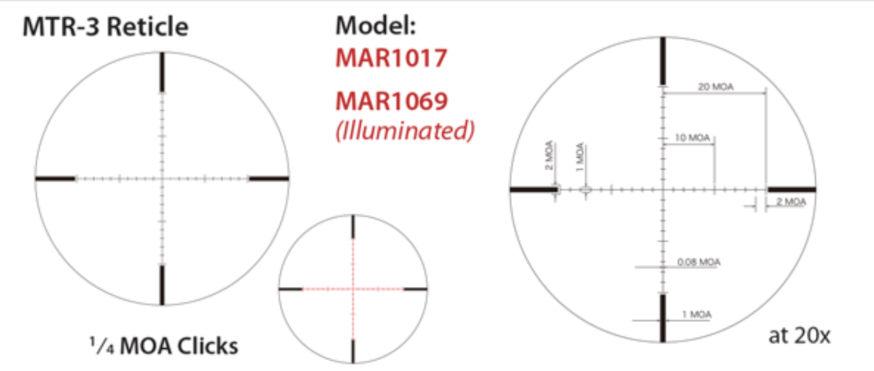

March has several reticles that are available in these scopes.
Reactions: Acer76

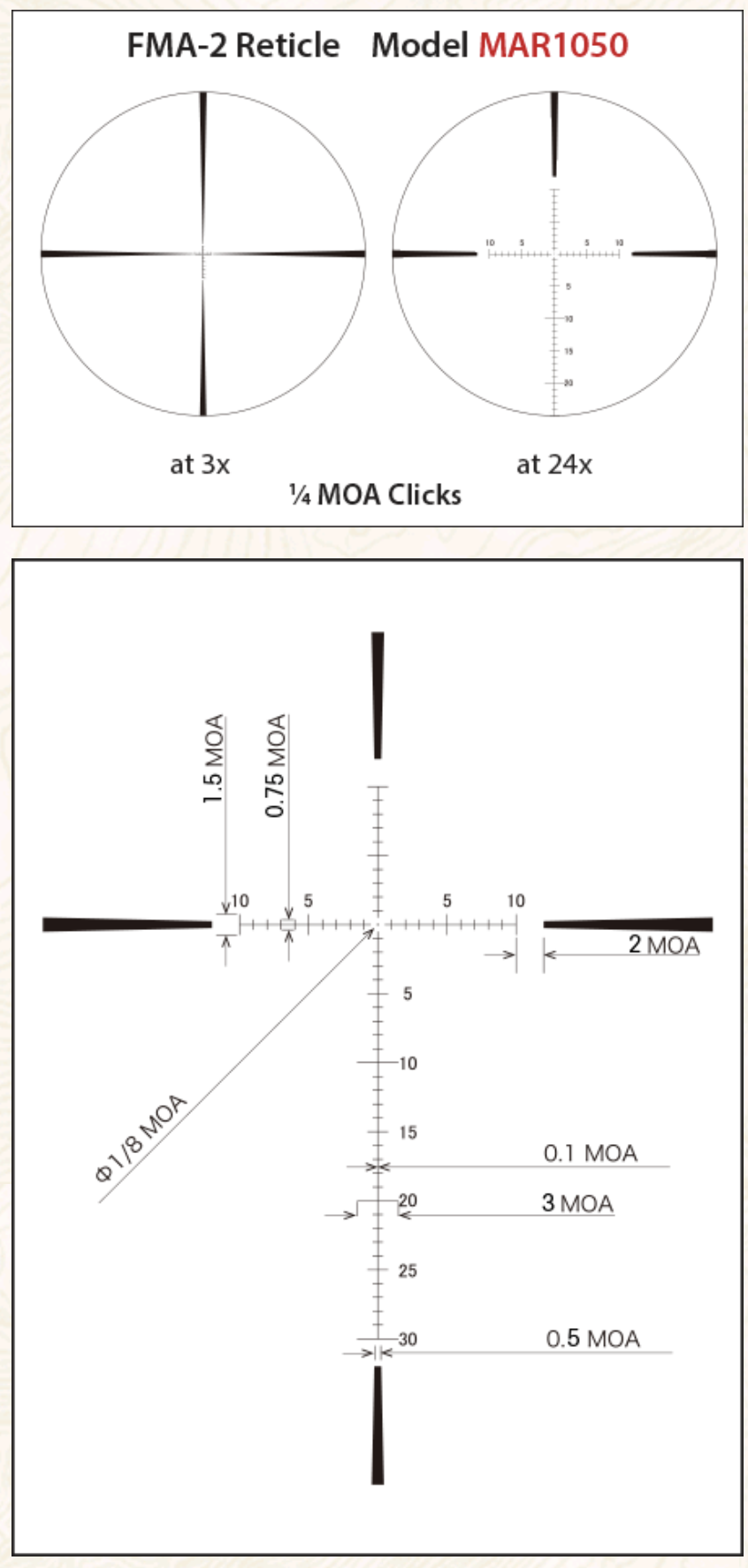

March Optics reticles continued.

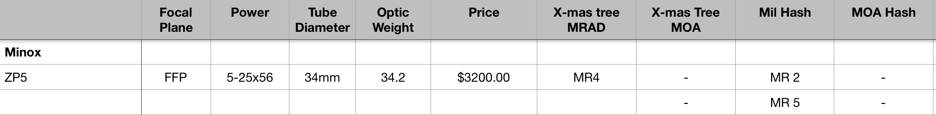

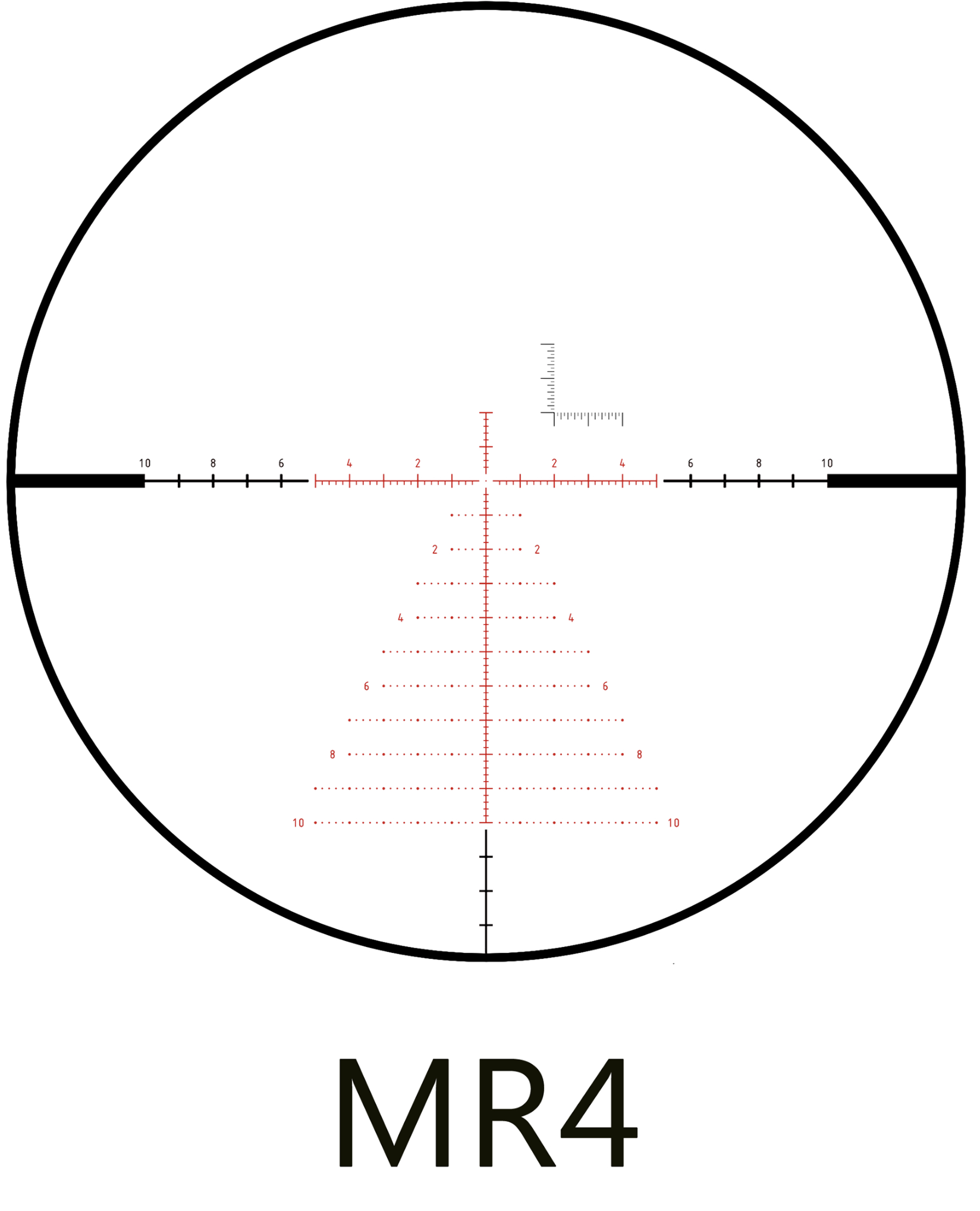

The Minox ZP5 5-25x56 makes my list. I have heard great things about this scope. It comes in several different reticle options, and I believe the quality is very good. I have never handled a Minox, so anyone who has please chime in.

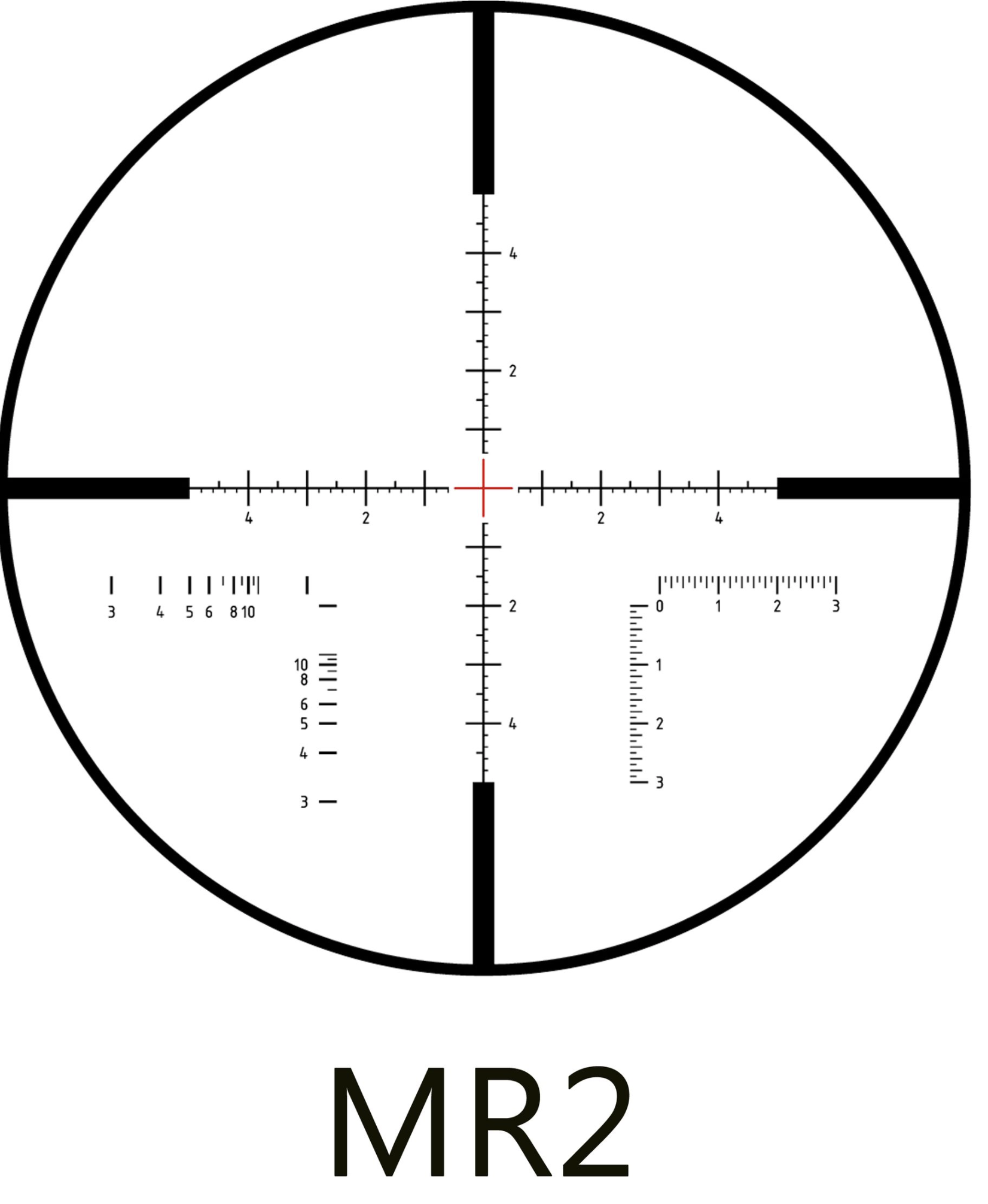

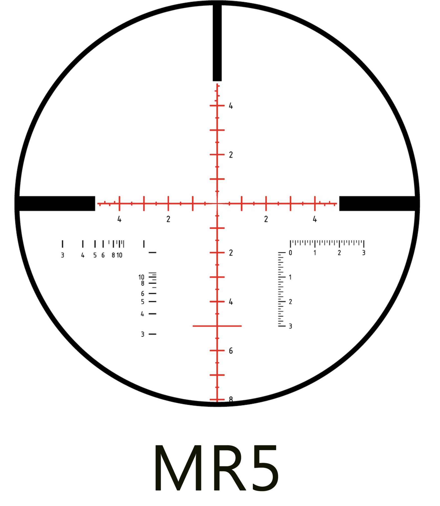

The Minox ZP5 5-25x56 comes with the MR4, MR2 & MR5 reticle options.

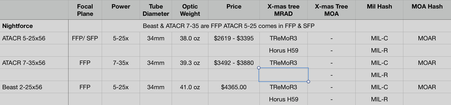

Nightforce Optics
http://www.nightforceoptics.com
The Nightforce Beast, ACACR 5-25x56 and the ATACR 7-35x56 all make the list. The Nightforce NXS would also make the list. (I’ll add it).
No one questions the durability or toughness of a Nightforce. I have owned many of these and have pretty much ZERO complaints. I think this brand speaks for itself.

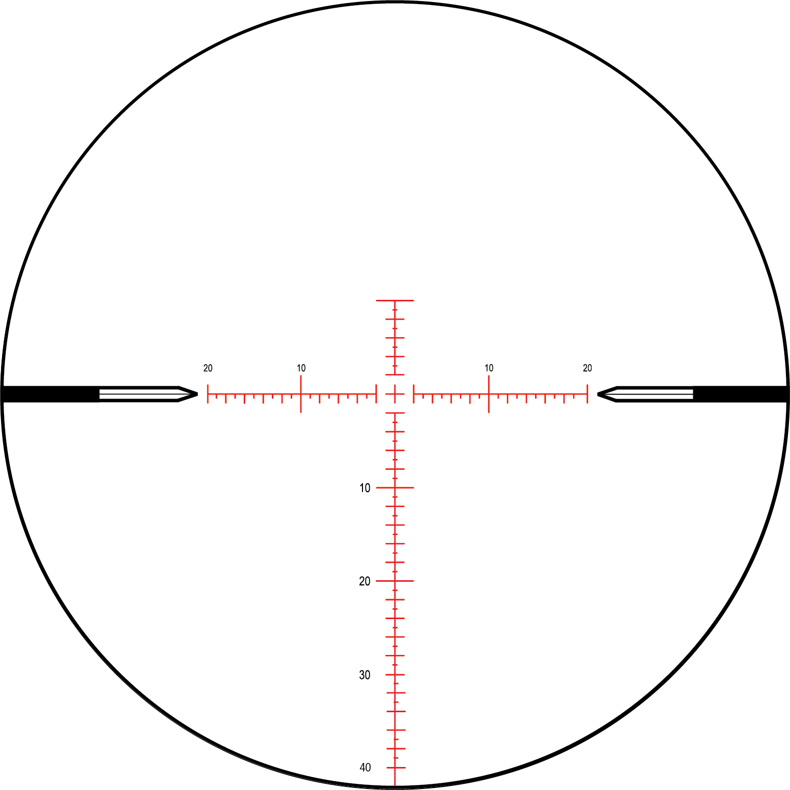

These Nightforce Scopes are available with the following reticles.
Tremor 3
Horus H59
MIL C
MIL R

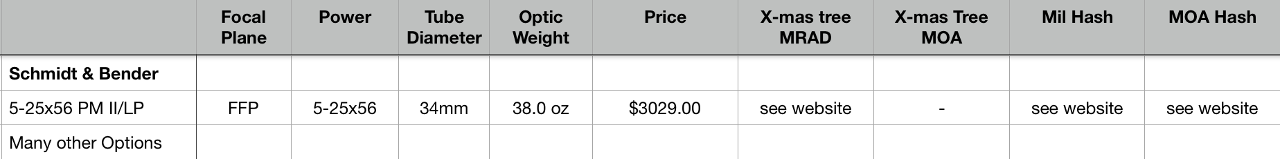

Schmidt and Bender
http://www.schmidtundbender.de/en/
Schmidt and Bender have long been considered to be the best by many. They have a LOT of different scopes they sale, and a LOT of different reticles available. Please go visit their website to see a list of what they have to offer, as its much to exhaustive to cover here. The main scope that I will cover for this list is the 5-25x56 PM II/LP. I believe this is the most popular option among tactical shooters.
Please visit their website to see the plethora of reticles, too many to view here.

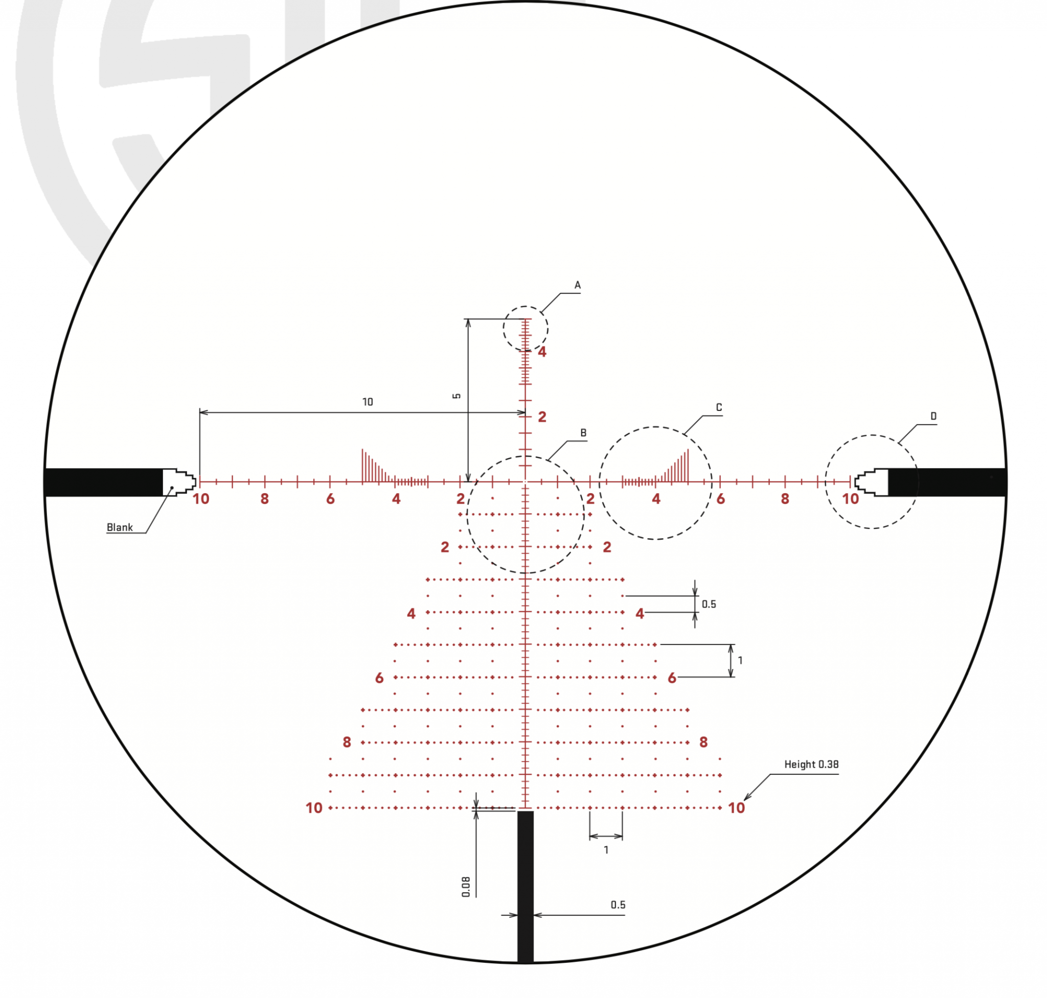

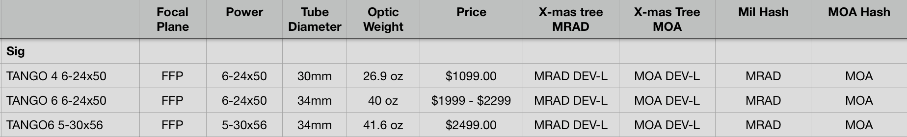

Sig Sauer makes a lot of things for shooters. The Tango 4 & Tango 6 Electro-optics make my list. These scopes are pretty unique as they have several digital components to the scopes. Levelplex is an electric internal scope level. If you cant your scope to one side or the other a light inside the optic will illuminate to let you know. Also they have MOTAC which is a motion activated reticle illumination. Cool stuff.

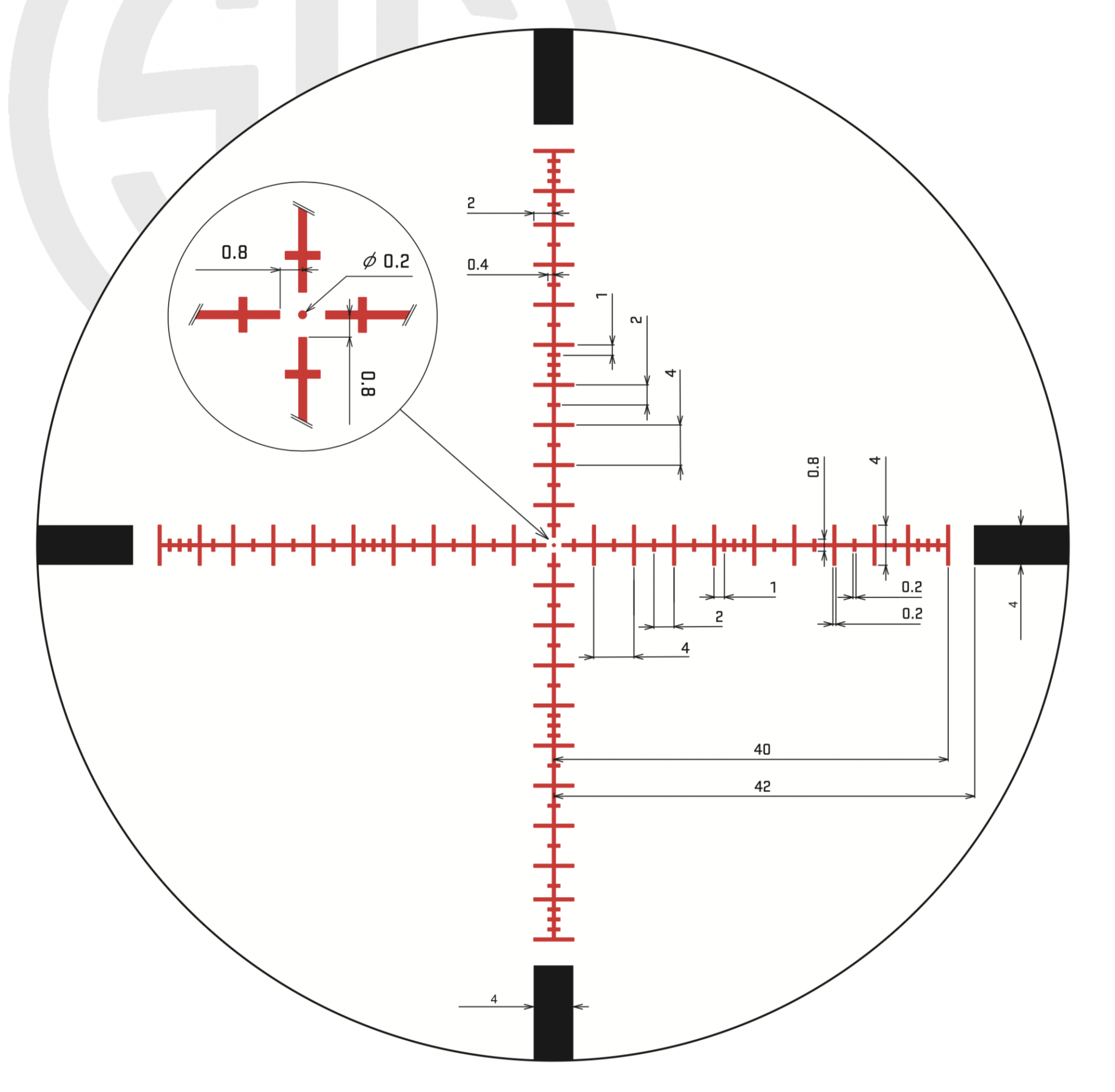

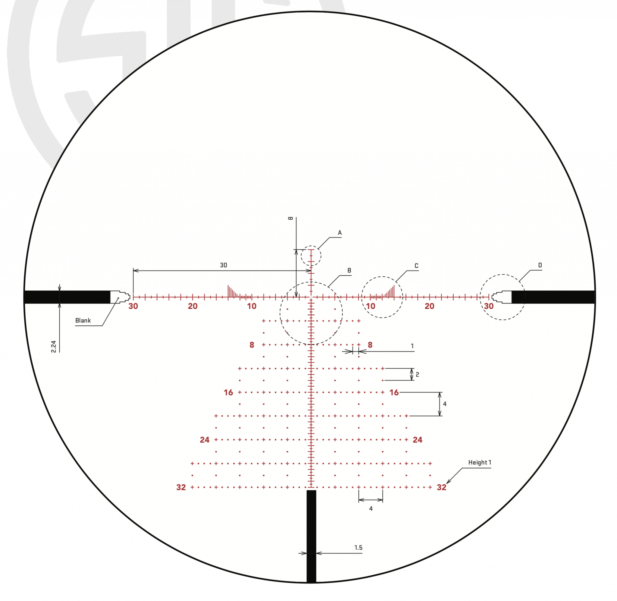

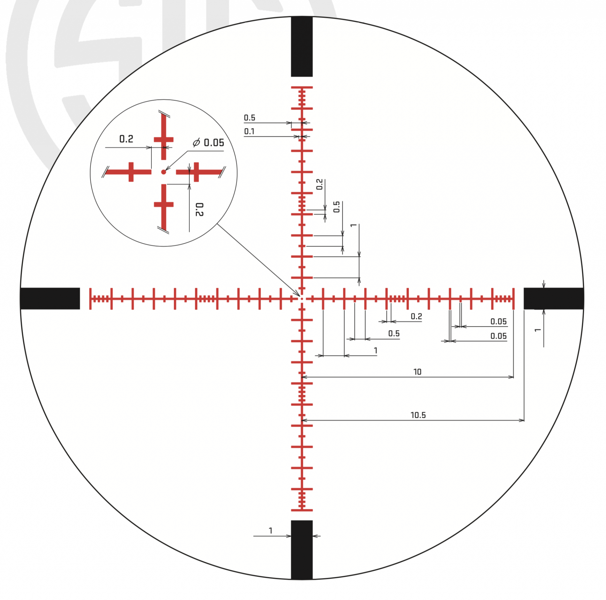

The Tango 4 & Tango 6 have the following reticles.
MRAD DEV L
MOA DEV L
SIG MRAD

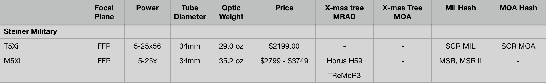

Steiner has 2 options that meet my criteria, the T5Xi and M5Xi. Some people are big fans of Steiner. I have personally never owned one, and can’t make a recommendation one way or the other regarding these optics.
Steiner offers a number of reticles for your selection in the T5Xi and M5Xi.

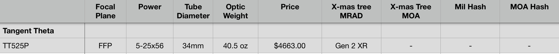

Tangent Theta
http://tangenttheta.com

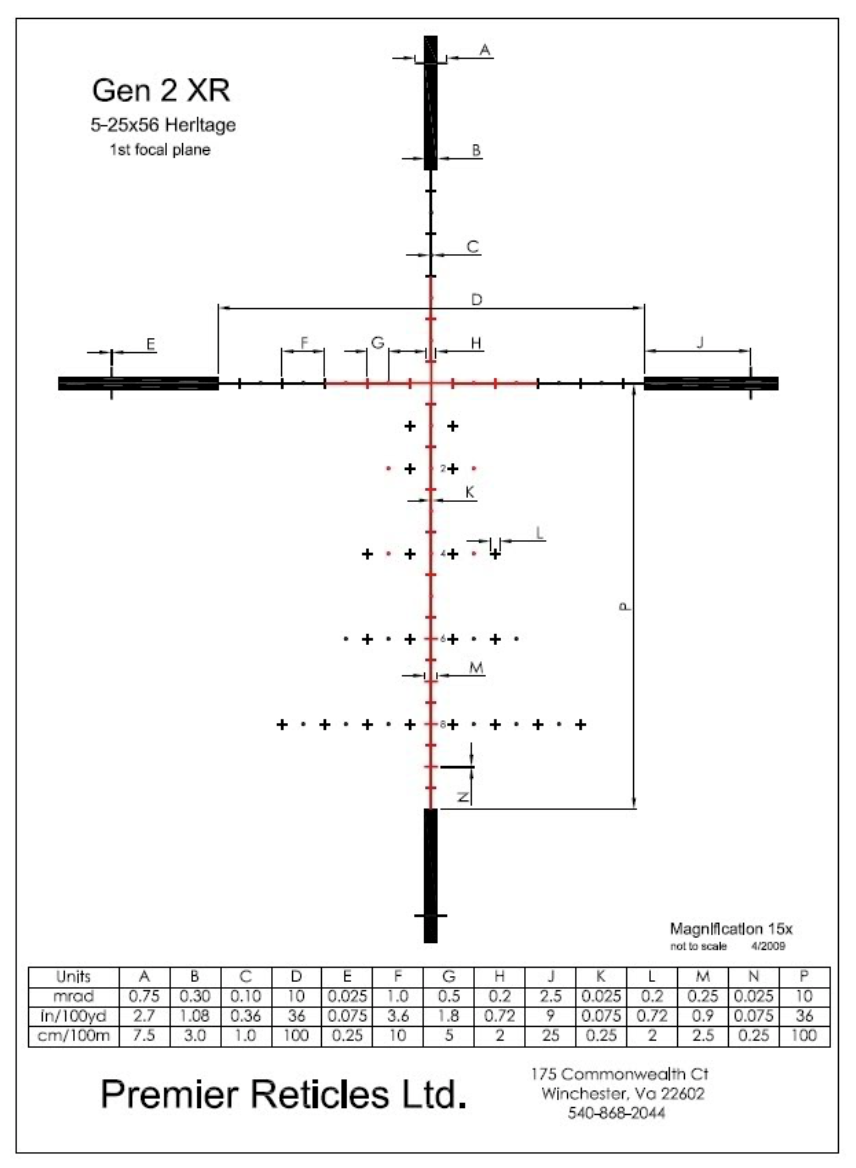

The Tangent Theta TT525P looks absolutely stunning. I hear the glass is like the finest crystal. This scope is truly a thing of beauty. Never seen one in person, never looked through one. The only complaint I have heard besides the price is the reticle selection. Its a little limited for a $4500 scope. If you love the Gen 2 XR, you might lover this scope, otherwise - lets hope they expand their offerings a bit.
As far as I can tell, the Tangent Theta TT525P only has the Gen 2 XR reticle available.
Gen 2 XR

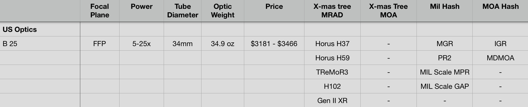

Us Optics makes a lot of different specialized optics primarily for military personnel. Please visit their website, they are a great American Company, with a lot to offer in the area of tactical riflescopes. Their quality is very good. They have a LOT of options available, and will customize just about anything you want on your scope. Please go check them out.
To keep the thread simple, I’m only considering the B25 scope. Please visit their website for a list of available reticles. The table above covers most of what they offer in the B25.

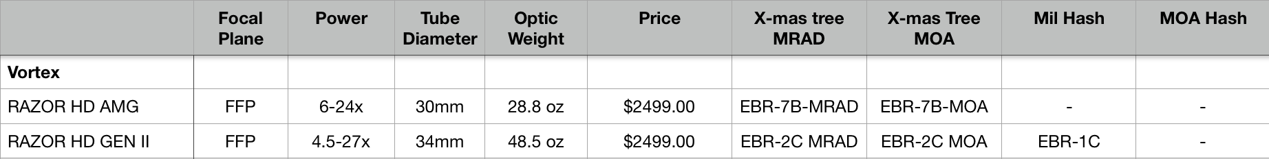

A am covering the Razor HD AMG, and the Razor HD Gen II. What to say about Vortex. They came practically out of no where and turned the optics industry on its head. They make very nice scopes at great prices and their warranty is unbeatable. They lead the PRS matches as the most shot scope in PRS.

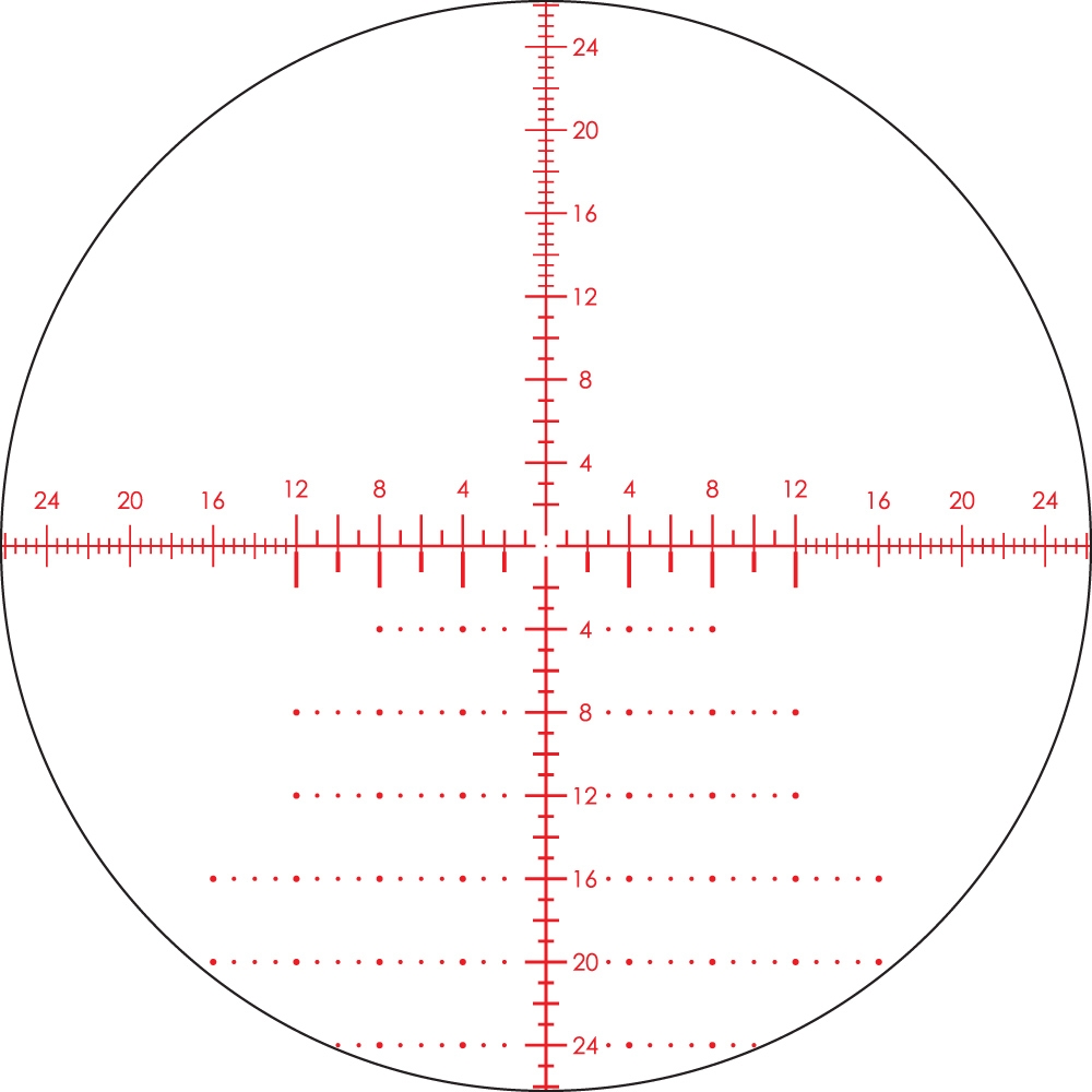

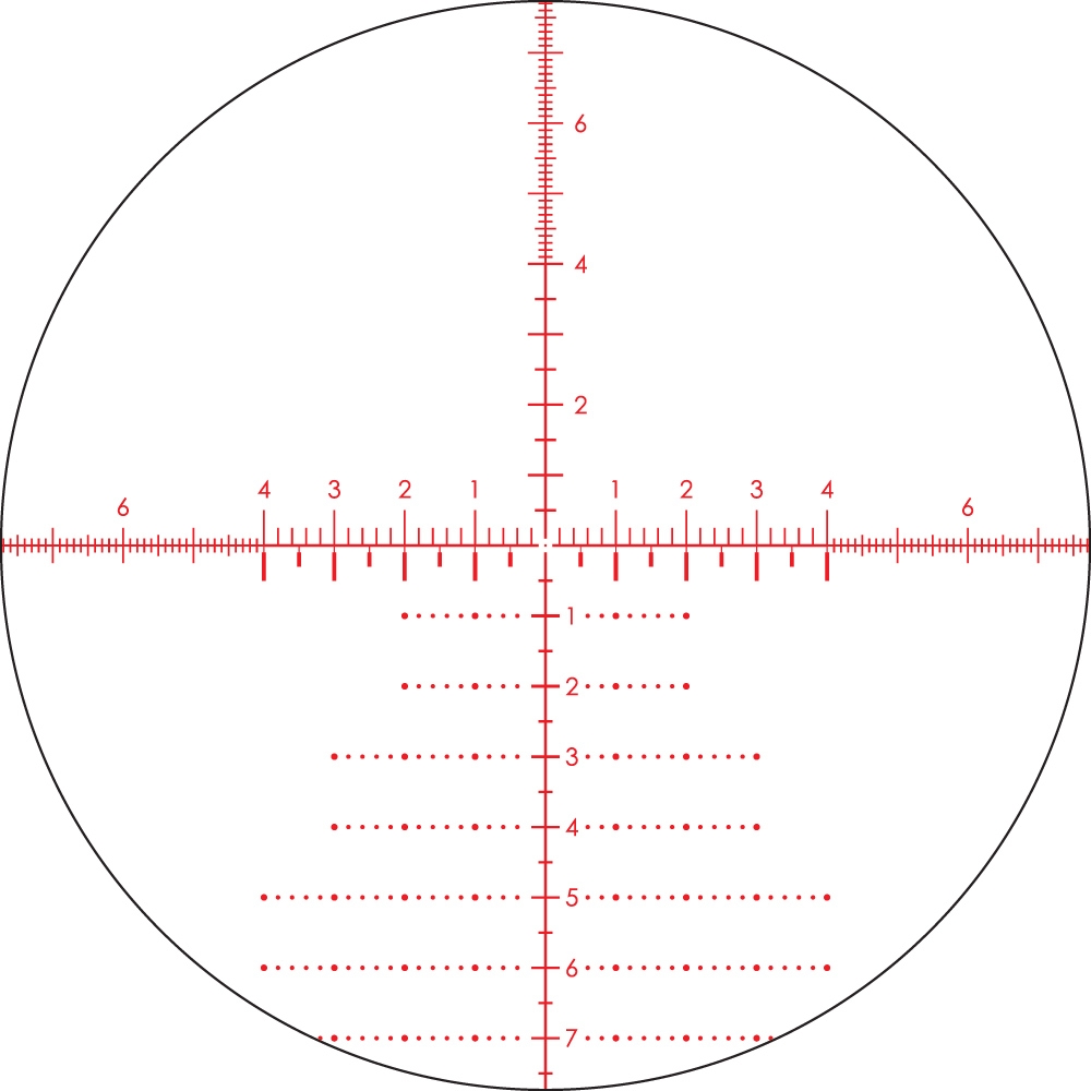

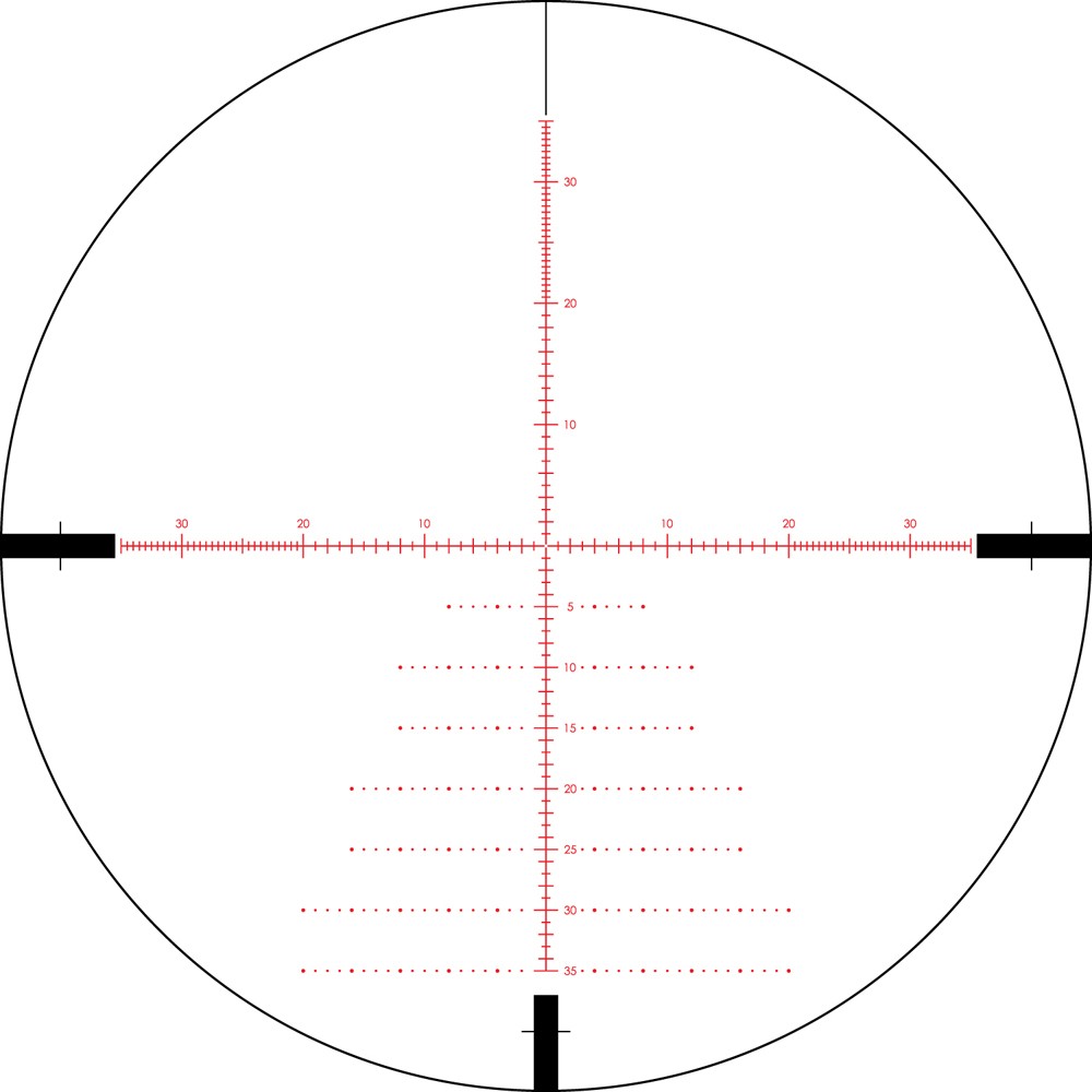

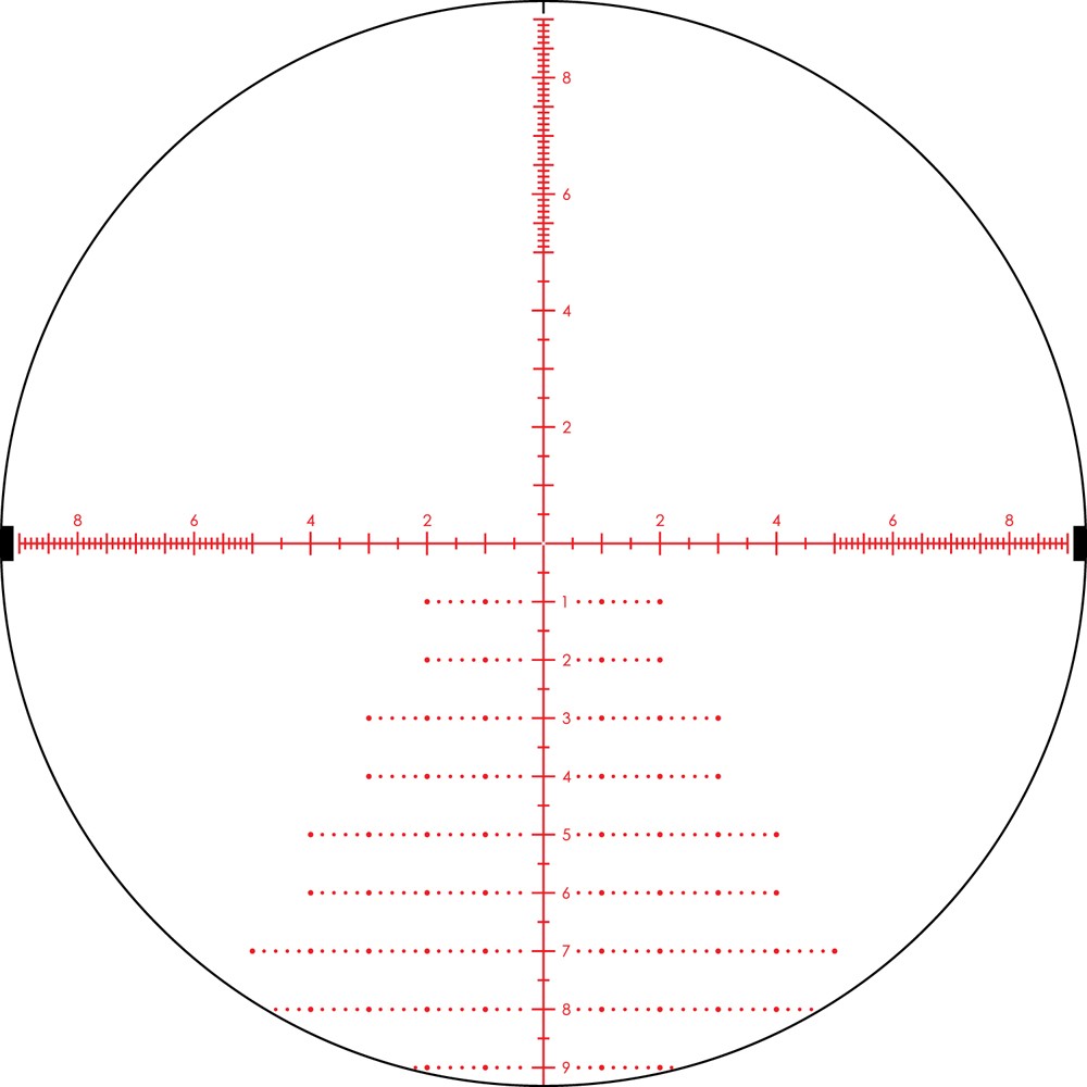

The RAZOR HD AMG and the RAZOR HD GEN II have differing reticles, the EBR-7B-MRAD / MOA and the EBER-2C-MRAD / MOA
EBR-7B-MIL
EBR-7B-MOA
EBR-2C-MRAD
EBC-2C-MOA

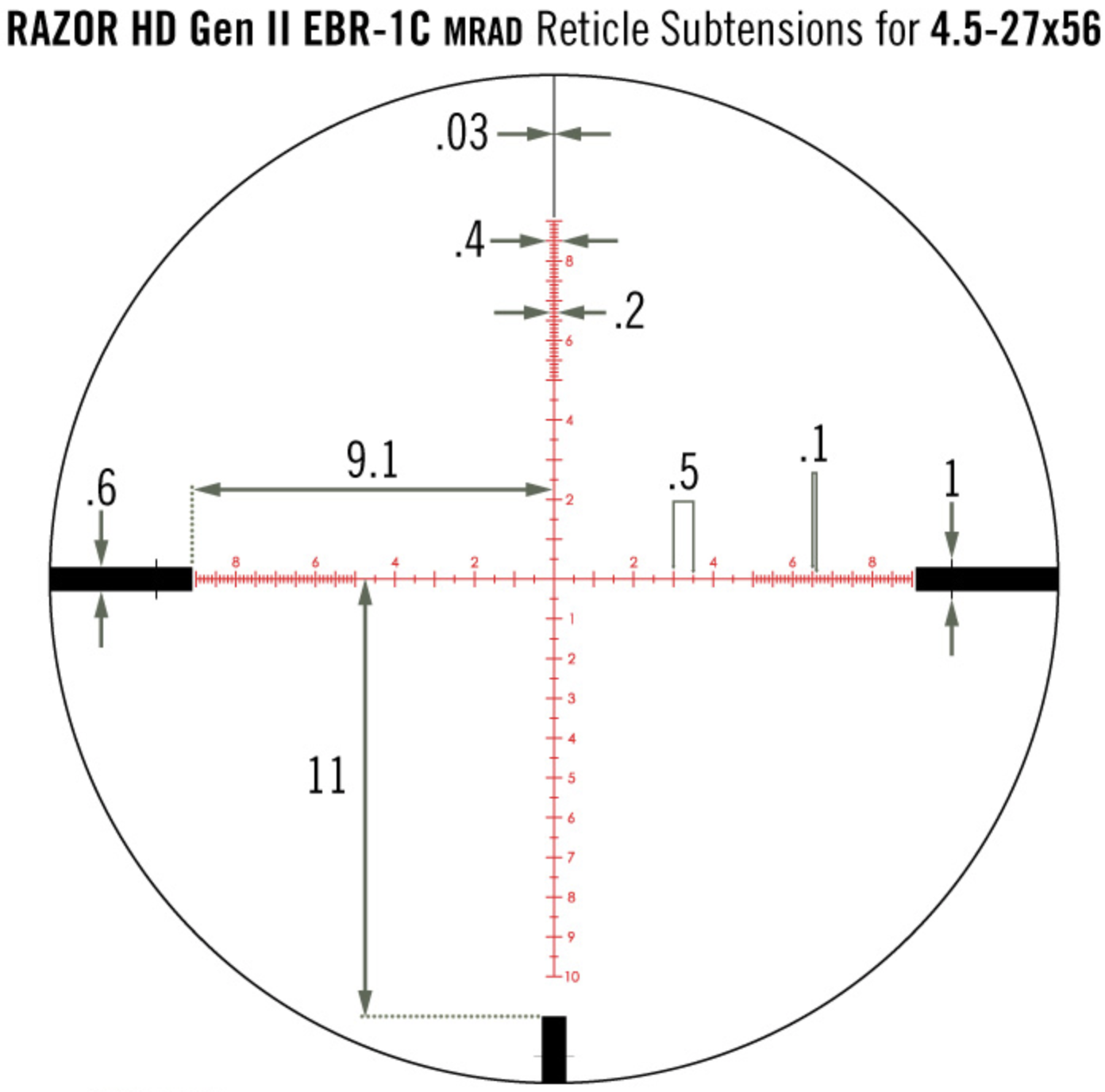

Vortex Optics Reticles Continued
EBR-1C-MRAD

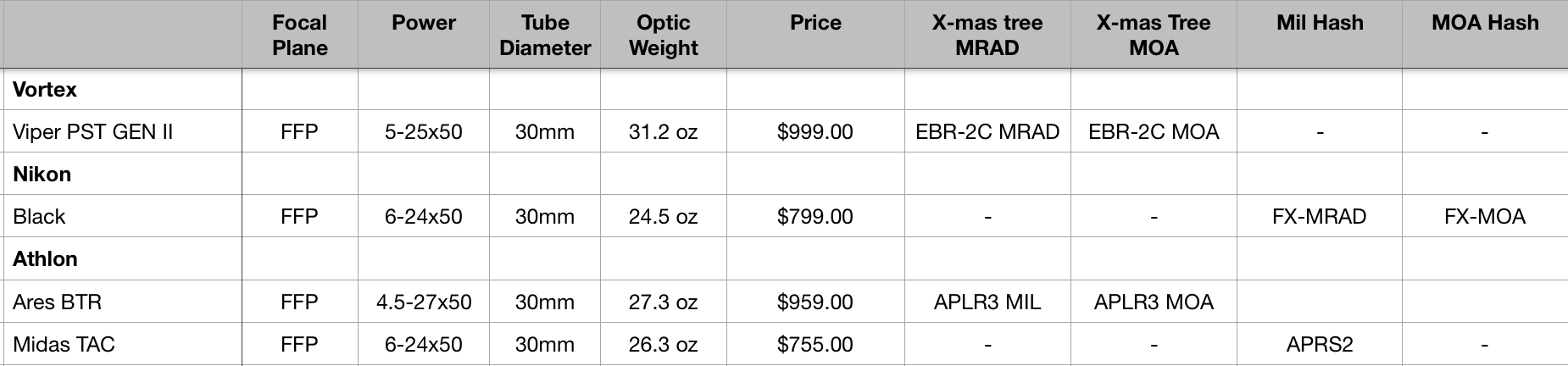

Finally we have the budget category. I tried to find a few good budget options for anyone wanting to try out long range or tactical shooting without breaking the bank. I’m only going to list a few, I’m sure there are many more that would fit this category. Some of the prices listed in this section are MSRP prices, so I’m sure some of them could be had for even less.
Hopefully this scope comparison, reticle review can give you the information you need to make your next purchase. I had a lot of fun writing it, and learned a lot myself about what’s out there. Looking for your comments/ feedback.

Thank you for putting this together this is awesome! I'm going between SKMR3 and MR4 but I think the MR4 is winning. It's just about perfect.

Not to be a thorn but your listing of the retail price of the Vortex PST2 is not correct, it's $1399.99.
The retail price of the Ares BTR 4.5-27 is correct at $959.99
I think it's important for comparisons sake.
That's a ton of work you did, thanks.
Thanks Steve,
I stated above "Some of the prices listed in this section are MSRP prices, so I’m sure some of them could be had for even less."
I am trying to avoid MSRP prices for optics that are readily available for less, so yes the Viper Gen 2 MSRP is $1399, it can be found for as low as $999.
