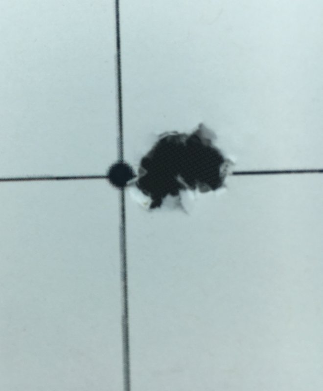

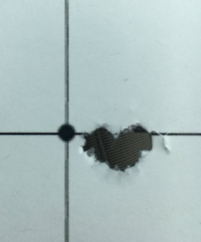

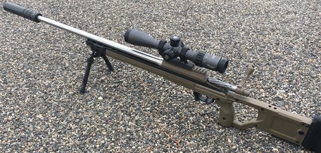

After three 5 round salvos cleaning between each I got a chance to shoot some fireforming loads on paper. I'm sold on the Dasher!
Specs:
Defiance Deviant
25" Criterion remage
KRG x-ray (minus the cheekpiece which I took off for cleaning and left it at the house)
Sig Tango 4 4x16
105 Nosler RDF blems
30 gr Varget
False shoulder plus 20 thou jam

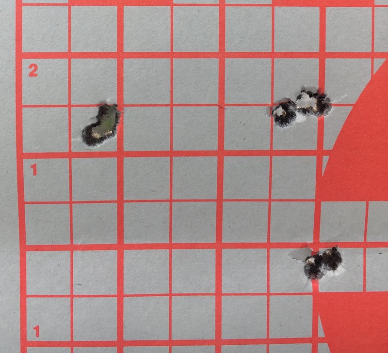

After fireforming. It's liking the Varget and RL16, RDFs are just kissing the lands.
