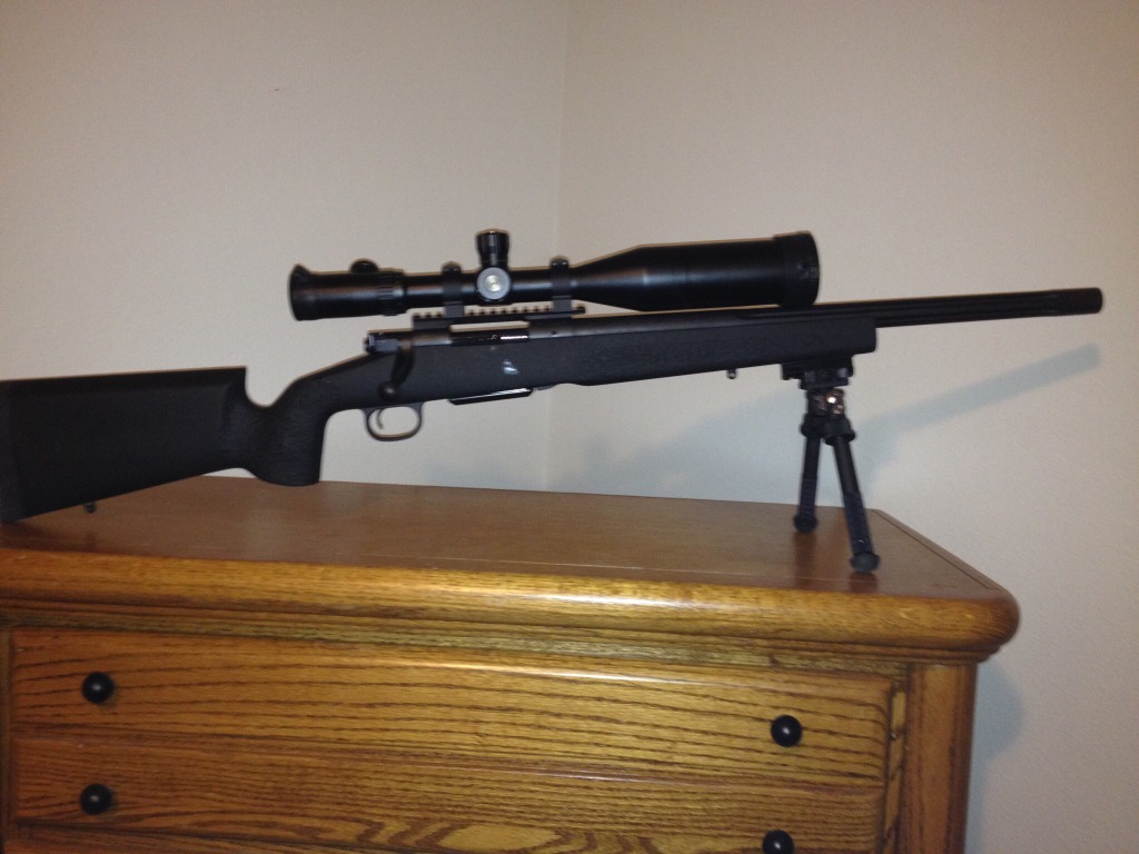

I've had my FN SPR A1a for a little over two years. It's my first bolt rifle. I've put about 400 or so rounds through it. I decided I'd like an adjustable cheek piece, so I pulled the action and boxed it up to send to stockdoc to do his work.
A before shot:
I added the FN drop in bottom metal a few months ago and am happy with it.

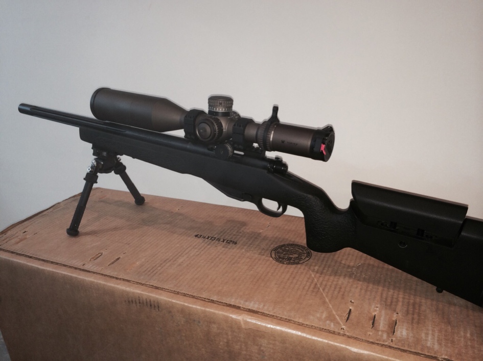

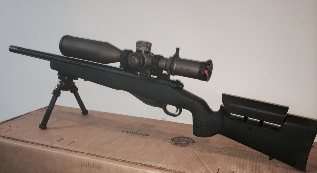

I sent the stock out to Joe Ducos, aka stock doc here on the hide. He does a good job, and his work is done off a McMillan template so your buttstock comes out like it would if you got it from McM that way. However, the KMW hardware is better than McM's factory hardware in my opinion. I think this is what Manners uses. After Joe did the work, I had him send it directly to Branden at custom gun coatings for the paint job. Any imperfections caused by cutting the stock were cleaned up real nice. I got this rifle in 2008, and the stock has been to hell and back. I learned how to paint on this stock, and ended up painting it like 4 times. I broke the stock by dropping it on its forend. I also installed, buried and reinstalled a bunch of flush cups. Last thing I did was sand the entire thing down, filled in imperfections and low spots with devcon, then retextured the grip and forend. Branden killed it; he really brought the stock back to life, and now it looks brand new.
