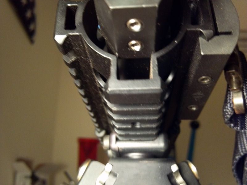

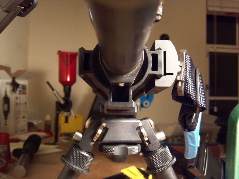

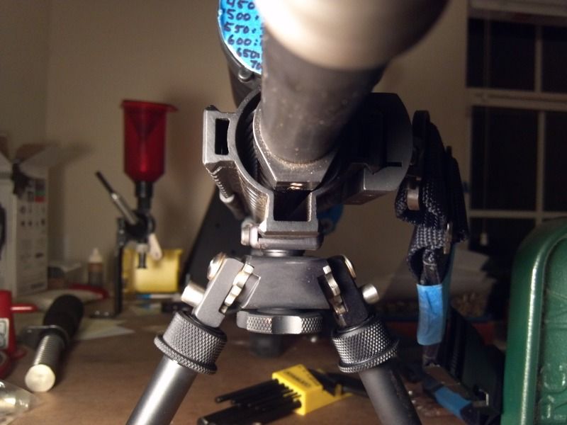

I bought a used GA Precision built DPMS LR308 with this rail on it. I have been getting very inconsistent performance from the rifle and began inspecting things. I found that there is very little clearance between the bottom of the gas block and the rail. So little that I believed that they may be coming in contact with one another when the bipod gets loaded, but I couldn't verify...until today.
After shooting today, I see that there is wear on the bottom of the gas block indicating that they are indeed contacting one another during shooting creating a non-free-floated barrel.
I am FAR from a gunsmith, as I have only basic hand tools. I don't know if it would be advisable for myself to remove the handguard as that would require removal of the barrel nut (and barrel?) and potentially screw up any goodness that GAP puts into their barrel alignment. I haven't the slightest idea.
I've attached a few pictures to try and give some insight as to what my problem is. What are my options? If the rail were only 1/8" shorter, there wouldn't be a problem. Believe me, in my frustrations I've almost taken out the Dremel with a cut-off wheel....
Re: DD 7.62 lite rail question
Disregard, impatience got the best of me. I figured out that the rail can be taken off without messing with the barrel at all. I took off the rail, spent 60 minutes on the gas block with a needle file, and I'm back in business with a free floated barrel.
