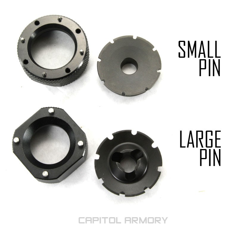

Which one? There are two different end cap tools
One has large pins and appears to be for the flash hider end cap
the other has small pins and appears to be for the stock end cap
I'll probably just use snap ring pliers but does anyone know the pin diameters and lengths for the Dead Air end caps?

Capitol armory shows two
Thats odd. Deadair and Silencershop both sell the one in the first picture on Capital armorys website. I cant find the other small pin or large pin tool that capital armory sells on either Deadair or Silencershops website. the one deadair sells works fine w/ my end caps on my sandman.
but even according to capital armory they say...
"The Small Pin (DA203) tool is compatible with older front caps, and best suited for use on the Sandman/Wolverine/Nomad series.
The Large Pin (DA208) is compatible with newer front caps, and is best suited for use on the Wolfman. "
So the one deadair sells should work fine.
Tho to get to the bottom of it, Youd be best contacting deadair.
also look at the diameter of the pins. could be wrong but it appears the small pin will work w/ either but the large pin will be too large to get in the holes for the factory end cap that comes on nomad/ sandman series.
Don't have all the answers of what takes what but I have both the small and large pin tools. The small will work for both caps with the smaller and larger cutouts. The large would not fit the caps that came with my Sandman K, S, or L. I got the large tool with the Wolfman wipe cap that can be used on Nomad and Sandman as well. They used to include a small pin tool with the ebrake but I don't think they do anymore.
