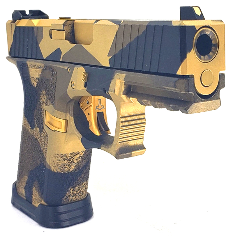

    Since I'm here again, might as well post a pic for OP. Top right is a G17 that'd loosely fit what I think you were describing as a casual/fun use "race gun"; I use it for GSSF unlimited class where it does very well, even if it's not truly a full-on race gun to be competitive with the high dollar stuff. It doesn't have a thumb ledge because I don't really like them, and the optic setup is more "carry/duty" than "race" (although honestly not that much difference there), but otherwise it's got all the basic ingredients and tuning you'd be looking for. I'd be happy to list out details if it'd help.

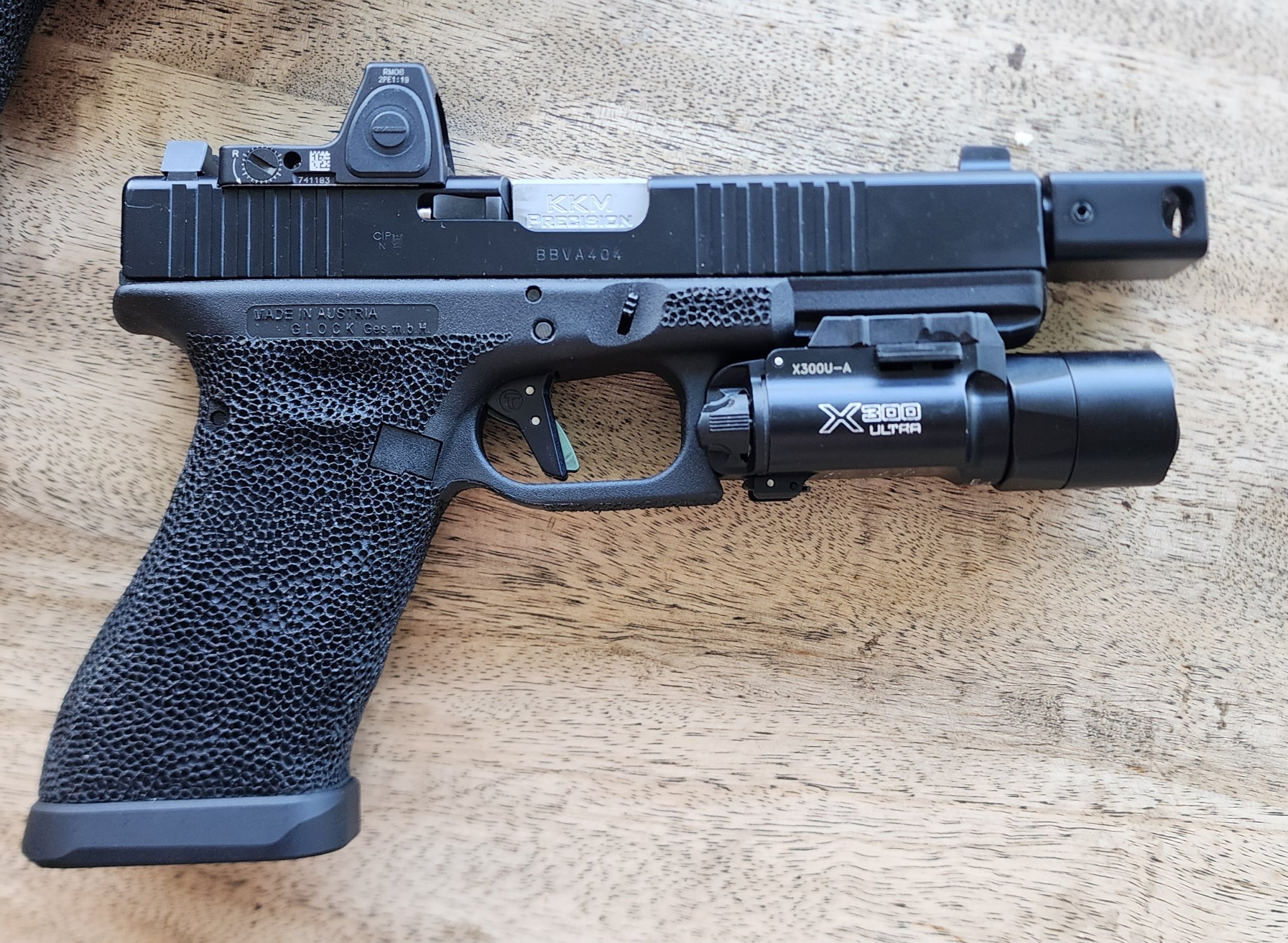

    I also say do some stuff to it and run the snot out of it. I have a gen3 17 with the full zev fulcrum kit, barsto barrel, Dawson magwell, taren mag extensions, captured 13# spring to run my very mild 147 reloads and a Leupold dpp on it. Had Dawson sights before going red dot as I’ve had the thing for 20 years. Gun runs like a raped ape and I’m on my second barrel I’ve shot it so much. Been using for uspsa and multi gun since I got it. Don’t think I’ve ever had a single malfunction period. I think it’s totally worth throwing a few bucks at it especially since you already own the platform. You can always buy something else also if you want the super fast race gun.

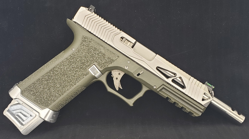

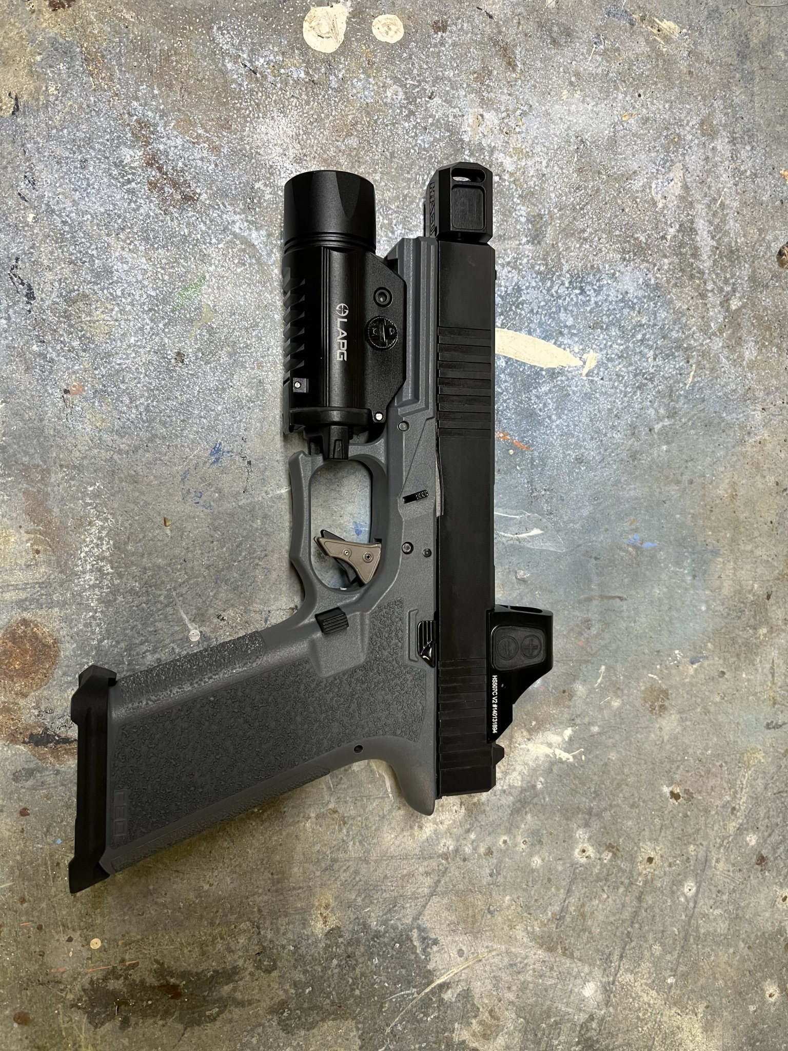

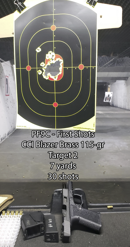

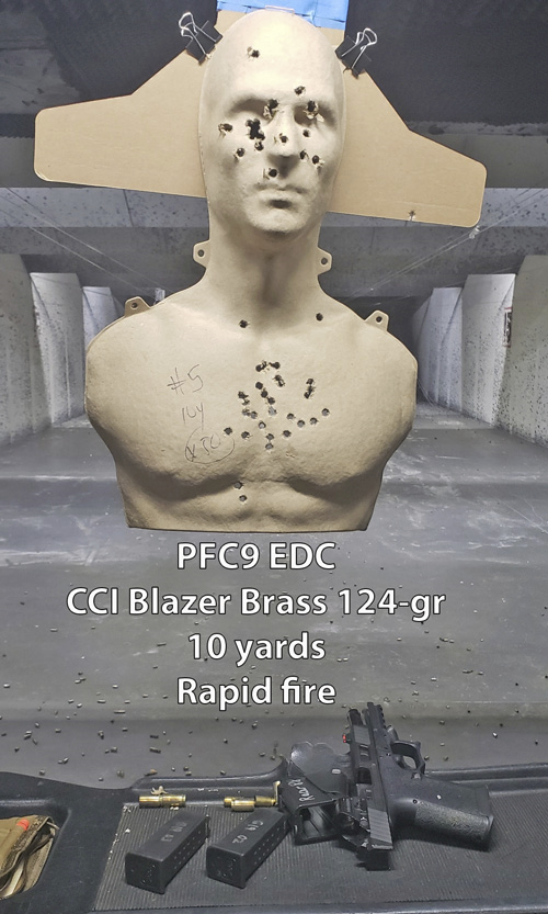

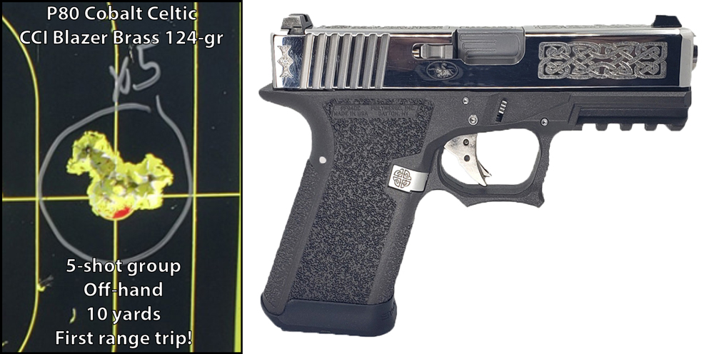

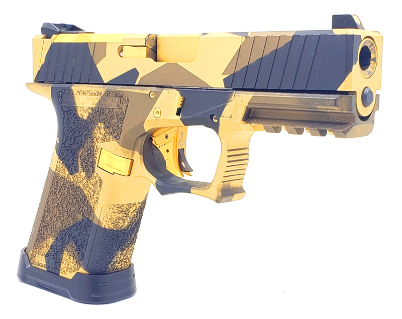

    Depends on the builder, eh? Just like cars on the track. I've seen a good driver in a Mazda Miata run circles around a poor driver in a Porsche 911. I used to have fun giving the 911s a run in my Subaru STI.
    There are certainly some "trash / ghetto" builders out there. But there are also a LOT of serious builders who produce excellent results. Ask me how I know.
    All of my P80 builds are every bit as reliable as my factory Glocks. I've got over 11,000 rounds through my P80 collection. 7,000 rounds through one of them.
    Trash, you say?

    Those fist-sized groups at self-defense distances with sub-0.2-second split times are exactly the goal. This ain't bullseye shootin'. LOL!

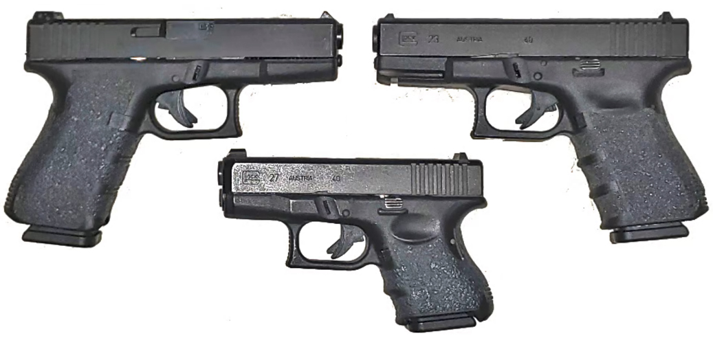

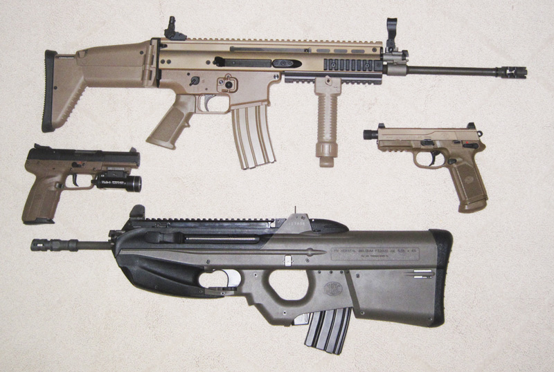

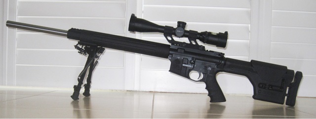

    The bling is for me... I've got PLENTY of good ol' fashioned black guns, eh? A couple FDE factory guns, too. And an ODG thrown in. Here are some of the "family."

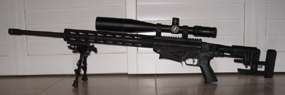

    Some precision rifles, since this is the "Hide."

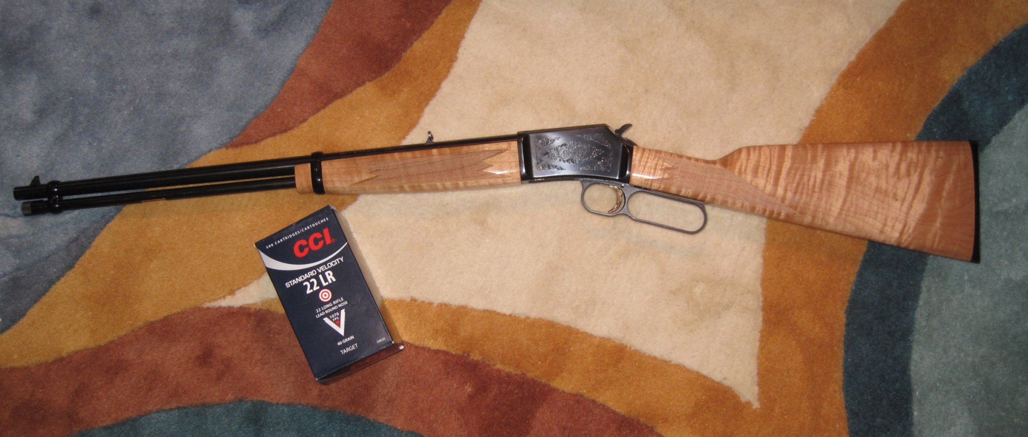

    And.... some "morning wood!"

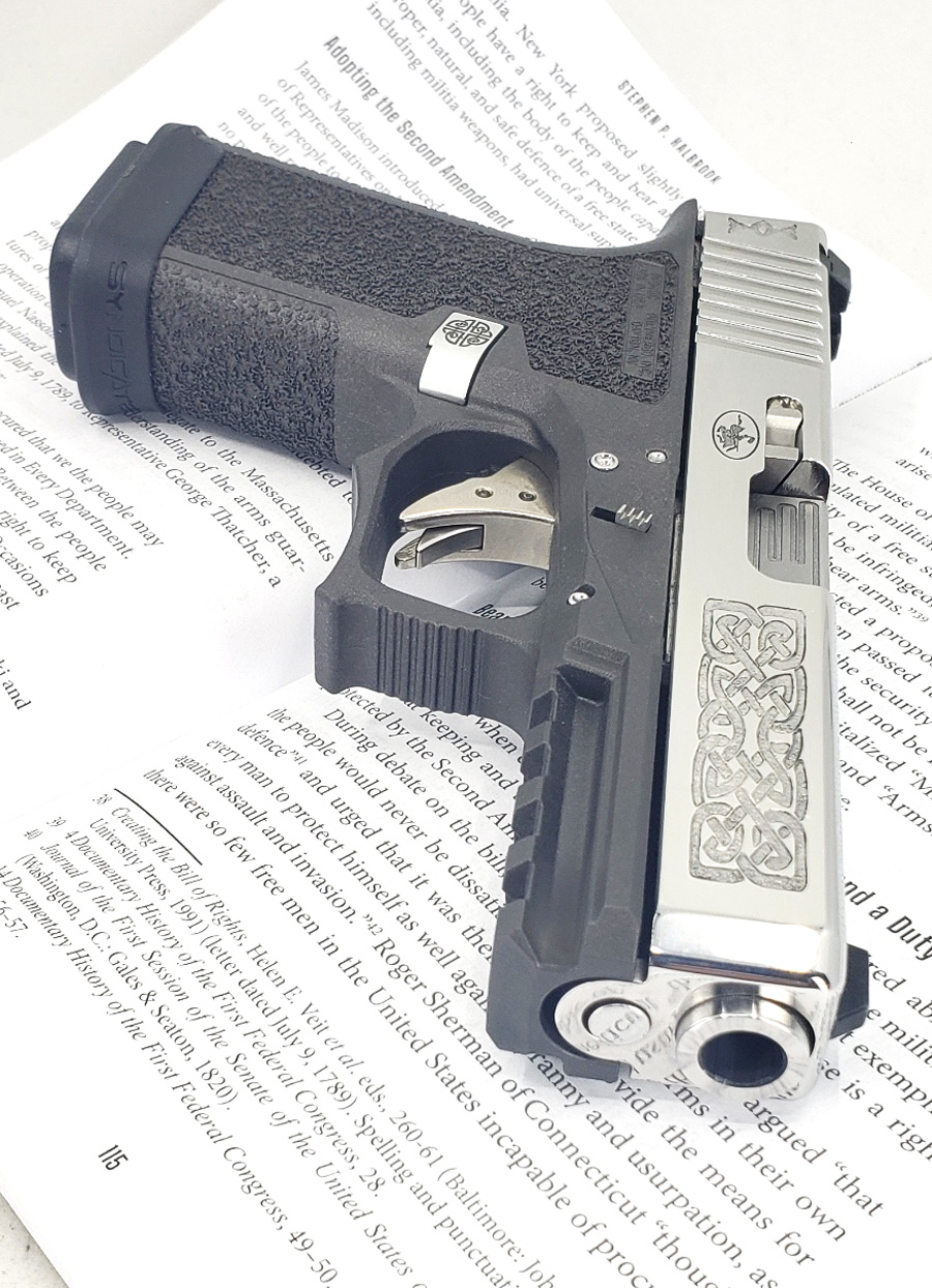

    So, if I'm going to BUILD some guns for fun, why WOULDN'T I dress them up? Plain black? Well, I can just BUY black guns.
    To be honest I bought this frame and slide as a bit of a lark. I wasn't sure whether I would like it or not. But then once I had it in my hands, I knew I had to go full-on blingtastic with it!
    I even changed the RSA to a gold colored metal guide!
    Sorry, but how are those kind of "builds" (LOL, again) any different than little girls dressing up Barbie dolls?

    I'll start by admitting to being a Glock fan-boy with well over a couple of hundred thousand rounds through mostly bog-stock G23s.. I had this Gen 4 17 in the safe and had fun building it out through covid.
    Timney trigger. KKM Barrel and comp. RMR. TTI Magwell. It took some work to get it reliable.. but no more than any other custom gun I've owned and plenty less than some of the options you've been given. I'll take my consistent 2lb trigger over a DA/SA any day and whilst I enjoy my STI, Nighthawks and Hi-powers I love shooting this thing. It'll punch a fist sized hole in a target at 25 yards with good splits and doesn't miss a beat.
