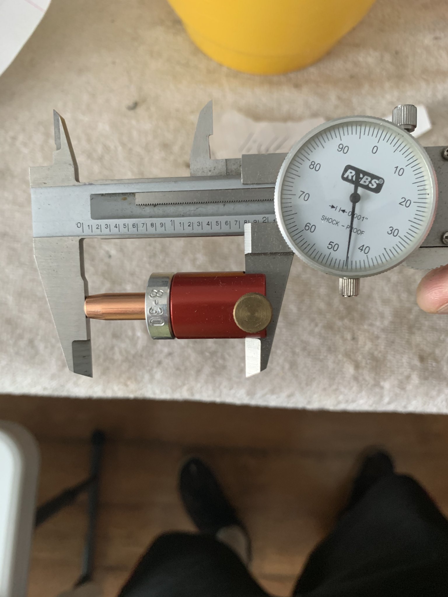

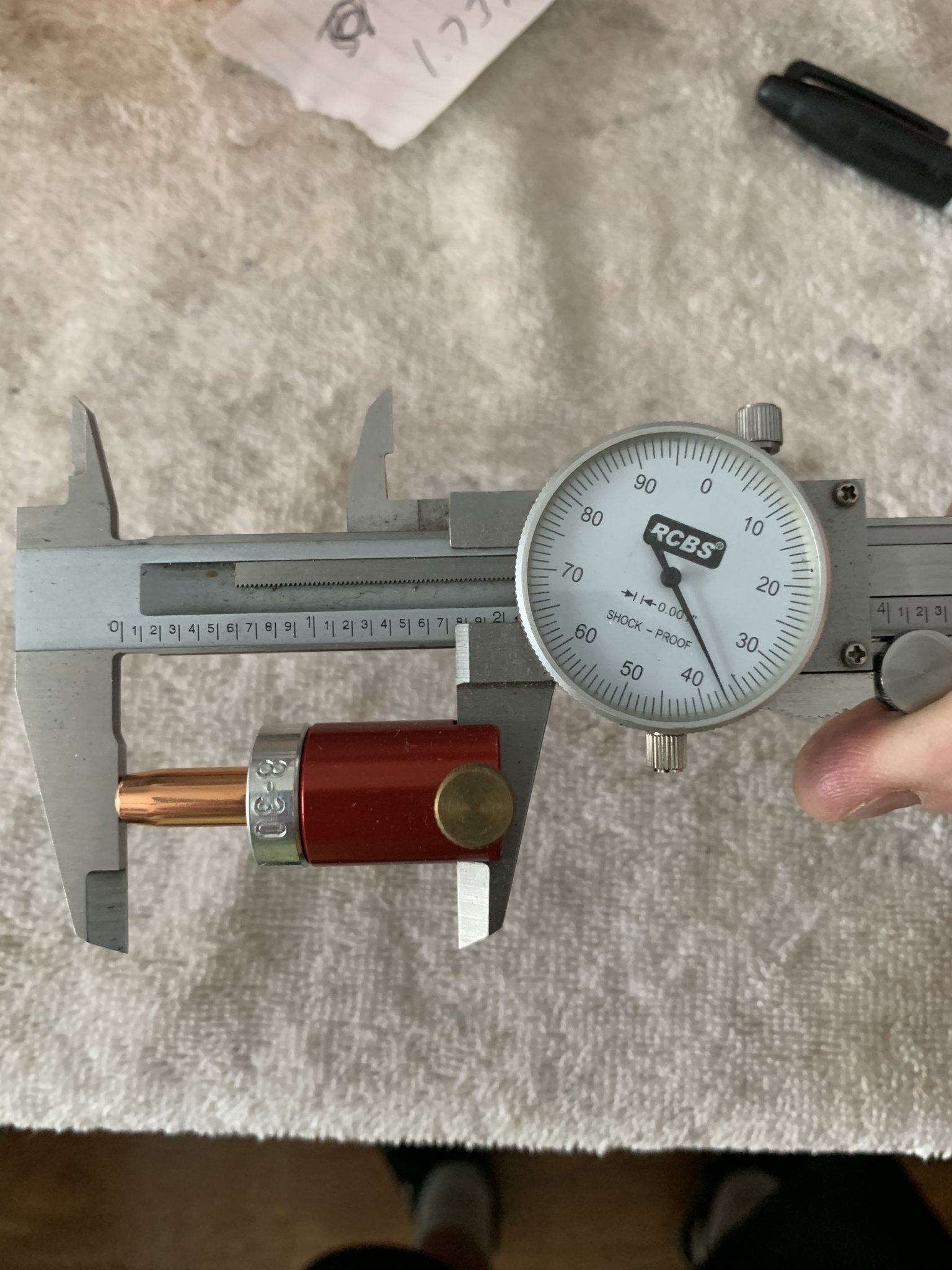

    Measurements are Base to Ogive of each bullet on rcbs caliper with hornady comparator. Then every bullet was weighed on rcbs scale.

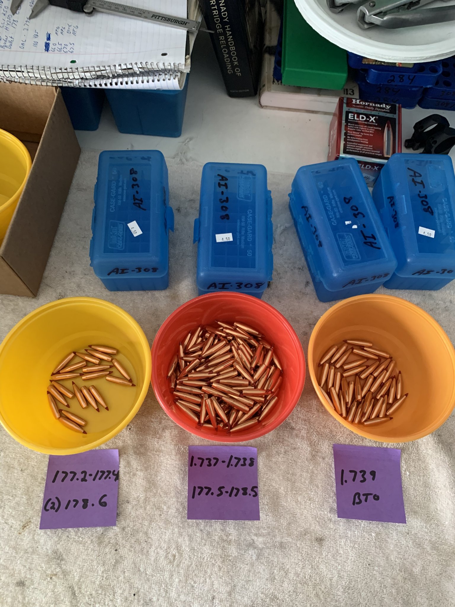

    Results:
    Red Bowl: (249 bullets)
    Base to Ogive - 1.737”-1.738”
    Weight - 177.5-178.5 grains
    Orange Bowl: (33 bullets)
    Base to Ogive- 1.739”
    Yellow Bowl: (18 bullets)
    Weight- 177.2-177.4 grains (2 bullets 178.6 grains)
    The red bowl is obviously the targeted measurements. The orange bowl was bullets that measured just .001” over the target of 1.737-1.738”. The yellow bowl were rounds that met the Base to Ogive target but weighed outside of the target weight of 178.0 +/- .5 grains (177.5-178.5)

    End Results of (3) 100 round boxes of the same lot #:
    All bullets were Base to Ogive- 1.737”-1.739”
    All bullets were 177.2 - 178.6 grains

    I had some SMK's with a variance of as much as .033 and that's when I started to doing as you do in measuring BTO for all whenever I get new box of bullets. The last couple of boxes of 500 SMK's I've gotten (as well as some Bergers), didn't have much of a variation (like .003). Now, rather than measuring the whole box, I'll measure around 30 selecting from different parts of the box (like some from the bottom, top, middle, left and right) to see if there's a mixed batch piled on top of another. If I don't find much variance (like the .003) in my sampling, I find the whole box is pretty uniform, so I don't have to do the WHOLE box of 500 or more of that lot. Sorting by BTO really helps a lot in getting uniform seating.
