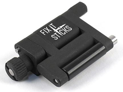

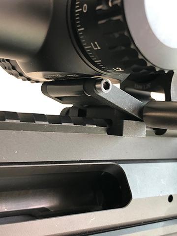

Fix It Sticks sells this: https://store.fixitsticks.com/collections/featured-products/products/scope-jack
Never used it and it 'levels' the scope to your mount. What needs to be level is your reticle. Your barrel doesn't know 'level', it only understand gravity.
